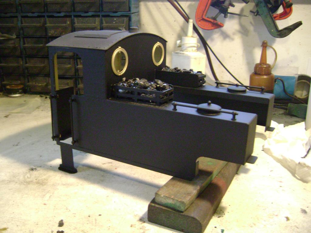

Post by tom_tom_go » Sat Aug 30, 2014 6:08 pm

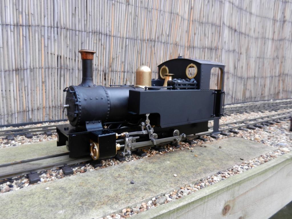

I know it's been a while, so here is the latest.
I didn't get on the with the pop safety valve, it just kept letting off steam constantly.  I have gone back to the RH one and adjusted it.  With experience of firing the loco, you just need to watch the pressure gauge and as soon as it starts getting a bit high you open the coal door to cool the fire.  I have found I am getting much longer runs now as not wasting water (steam) through the safety valve.
Riverdale boilers really are easy to fire.  I even managed last weekend to run it with my gas SL at the same time with my step daughter in charge.  Even after two hours the lubricator on the Riverdale had plently of oil left.
The body is on it's way from Rhos Helgy works where Tony has done a fantastic job building, painting and doing something clever with the roof although I will need to have it in the metal to show you all properly.
Here are some quick shots of it from his workshop though (quality is poor as it was raining outside:

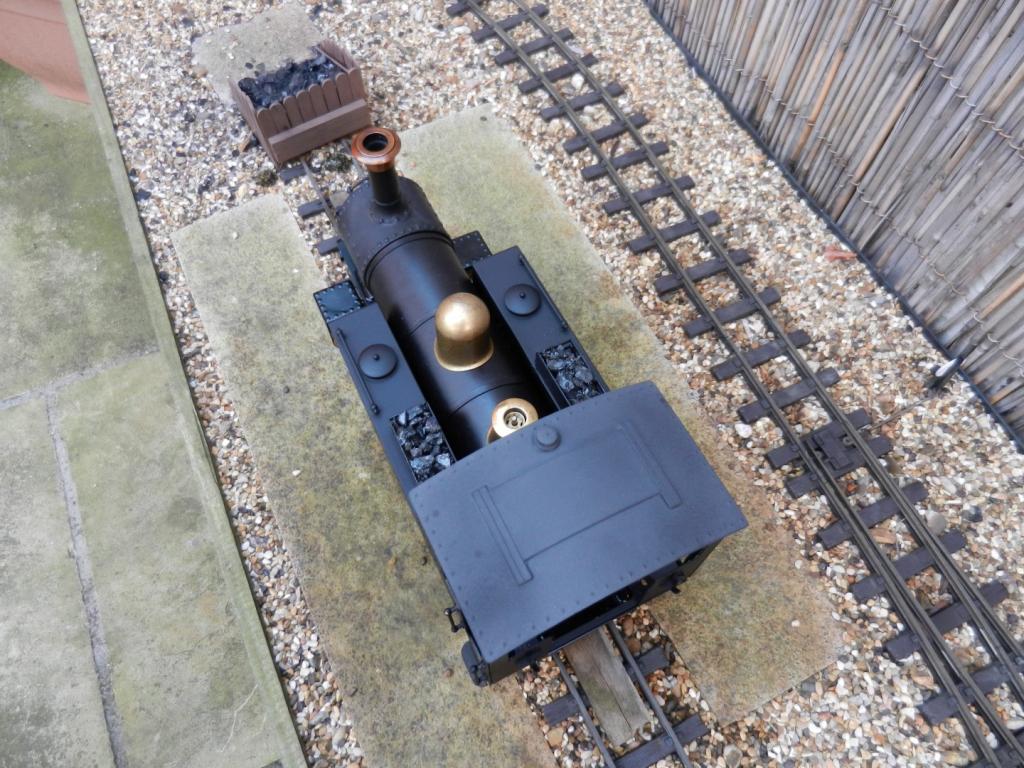

Post by tom_tom_go » Sat Sep 06, 2014 7:10 pm
Test fitting the body:
Tony did a great job getting the roof to fit with magnets and filling all the holes that are normally used to fit the RH hinge and battery holder:
The paint finish will soon loose it's matt appearance after a few steam runs.

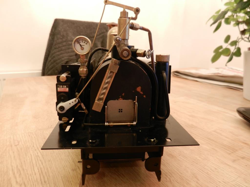

I believe I have now got all the R/C workings sorted:
The dome needs painting I think to the same colour as the body and the RH safety valve is not up to the job required of the Riverdale boiler pressure of 58 Psi, it wastes steam.
I tried a pop safety valve before but could not get it to work properly (could of just been the quality of the product) so Tony has recommended John Shawe which Santa might bring me for Christmas ;) These also fit the RH safety valve bonnet which is a bonus.
Tony has given me great free advice regarding the set up of this loco so I cannot thank him enough. If you need any work done on your locos/stock he really is the guy to contact, proper job :)

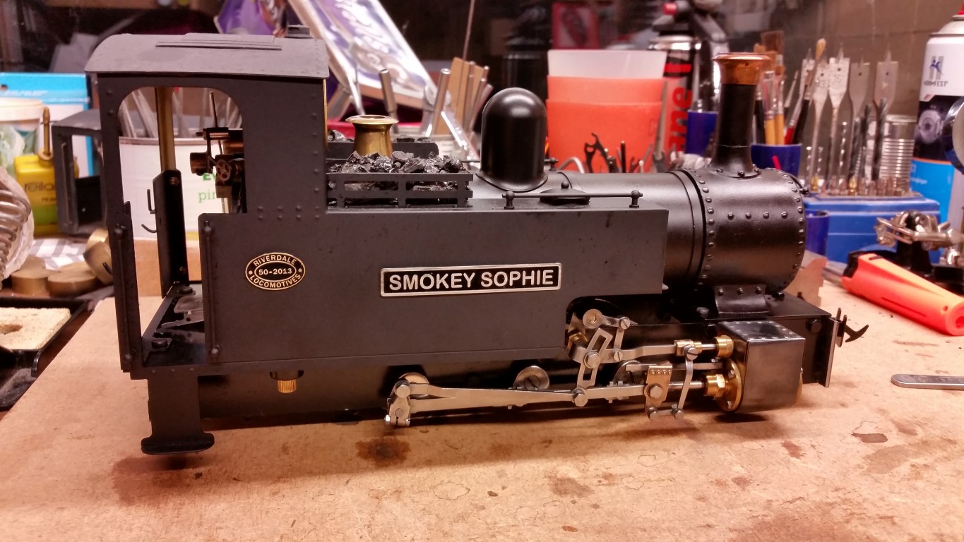

Post by tom_tom_go » Mon Mar 09, 2015 9:01 pm
Front buffer beam shortened (as on my SL) with modified Accucraft chopper:
The painted dome looks much better.
I think the smoke box dart needs painting, looks far too clean :)

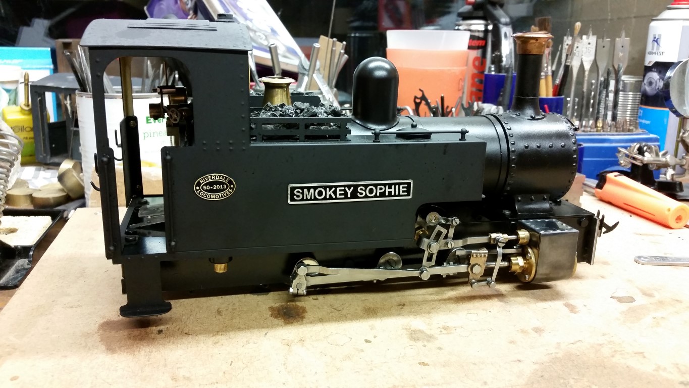

Post by tom_tom_go » Sun Dec 18, 2016 8:59 pm
Narrow Planet had a discount on their site a while back so I ordered a set of name and works plates for my Riverdale loco.
Test fitting this evening:
The works plate is brass and the name plate is nickel silver. I thought the works plate was going to be nickel as well, however, I like the fact they are two different colours now I have seen them on the loco (below photo shows the difference brass/nickel)

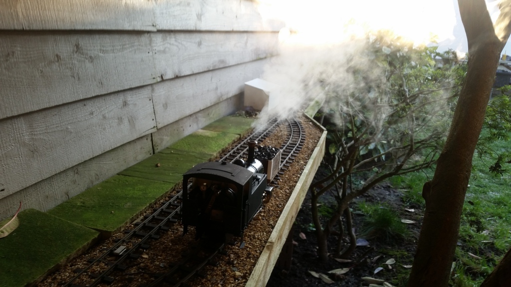

Post by tom_tom_go » Sat Jan 21, 2017 4:56 pm
Glad you enjoyed reading about the loco dizzy. It is certainly cheaper to build one yourself if you have the time...
I am finally happy with the whistle and pipe work so did a short video while running in the cold (excuse the quality, as it was filmed on my phone):
You cannot beat the smell of a coal fired engine, I love it!
