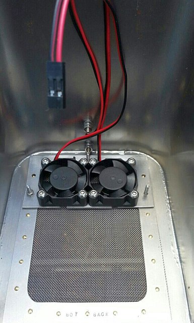

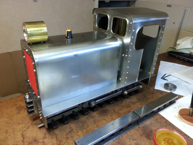

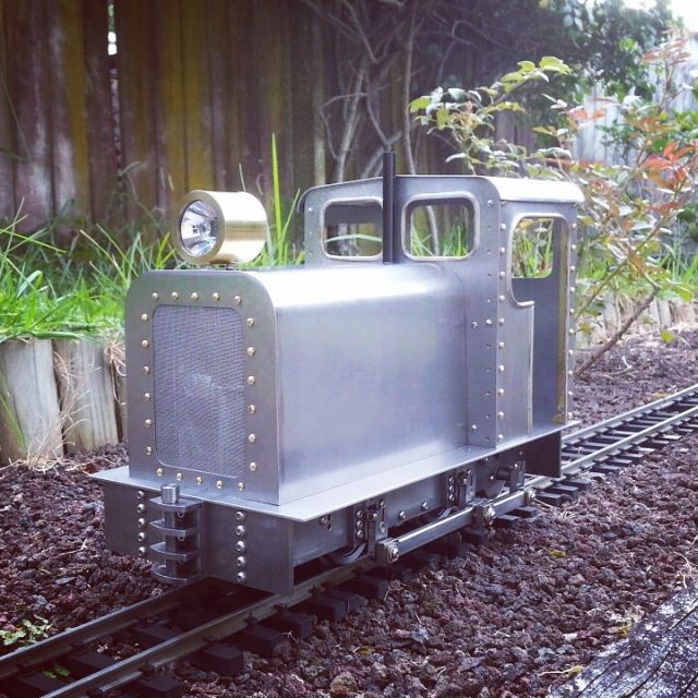

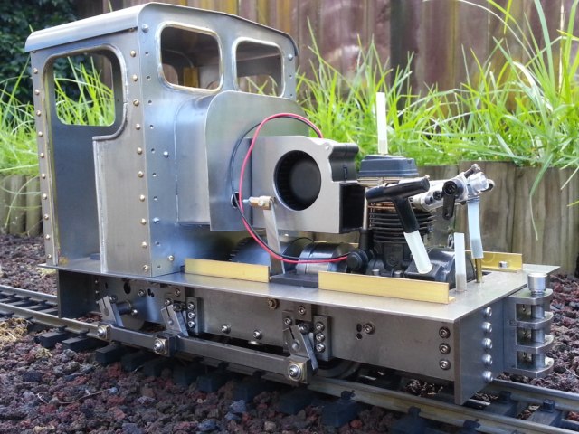

Well, I've finally got a cooling fan to try out, but first I thought I'd better fit the front grille. I didn't want to solder it directly in so had to cut out a steel retaining piece which sandwiches the mesh and is held in place with screws. Two days of sawing, filing, drilling and tapping.

dewintondave:108517 wrote: Two days of sawing, filing, drilling and tapping.
'Fess up, you enjoy that sort of thing or you wouldn't be building a live DM......... ;)
It's looking good, but the engine doors do look a bit plain. Queensland cane tram style mesh openings might be worth considering as an alternative to louvres.
Coincidentally, your countryman Paul Berntsen has an article in the current issue of Narrow Gauge Downunder, showing how he built a 16mm scale Fowler PM. As is his way, he made a punch for forming louvres in the engine doors.

The project was slowed up by a slow delivery from Germany.  I ended up fitting a centrifugal type blower fan to blow air across the cylinder fins.  In all fairness the fan from Germany is excellent and almost silent (but I'm not using it after all, it's an axial type).  Though having thought about it, silence isn't important in a live diesel set-up.
To help expel hot air from under the bonnet and through the mesh, I have installed two small fans at the top of the grille.
I need to sort out the electrics now.  The fans are all 12V dc types

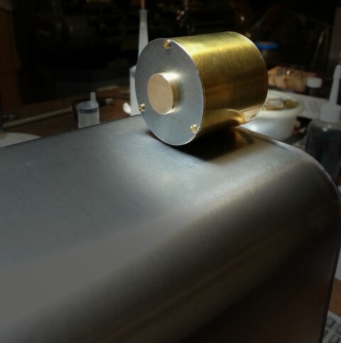

Post by dewintondave » Wed Apr 15, 2015 11:01 am
It's only a small issue, but I accidentally blew the 2.5V bulb in the headlamp by applying 6V to it. When I went to replace it, the new bulb was a good 1mm longer. It turns out that the original bulb was malformed and too short. I based the whole headlamp around that bulb, so I had to make an extender cap to fit over the rear cover. I've shifted to using 5.4 V bulbs from eBay now...
I've got a neat PWM controller from eBay to dim the headlight. I've been unsoldering the potentiometer from the PCB to remote mount it behind the headlight, I need the PCB to be horizontal.

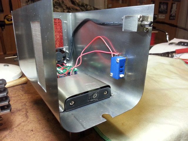

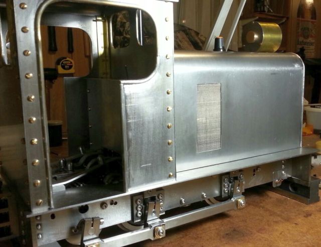

Finally, I have something to show. The cooling arrangements have been wired-up and connected.
As soon as the bonnet is fully slid onto the loco the blue micro switch powers-up all the electrics. The electrical connector provides power for the loco mounted blower. There are 4 AA cells in the battery holder. The toy-like smooth exterior has been preserved with no through bonnet fixings for all the bits and pieces.

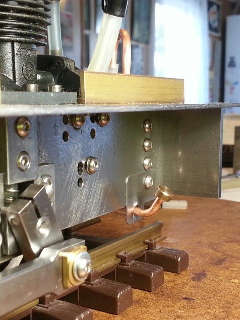

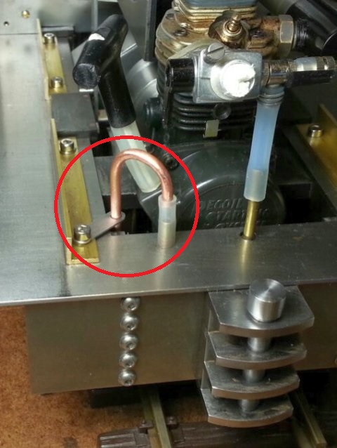

I don't want to have to remove the cooling hood when topping up the fuel so I've mounted an extension filler pipe on the right-hand side behind the buffer beam.

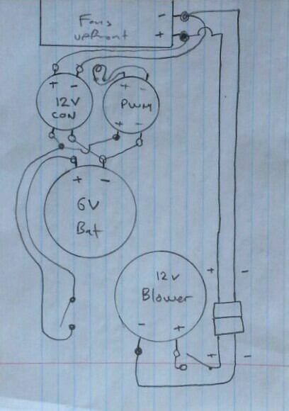

Some people ask if I have any drawings, well here's a circuit diagram I drew to work out the electrics. I didn't use the switch in the blower wiring in the end.

I've just finalised the filler. The pipe needed holding place to resist the filler connection force.

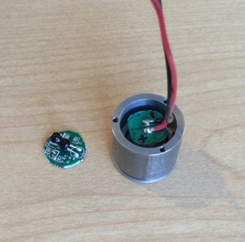

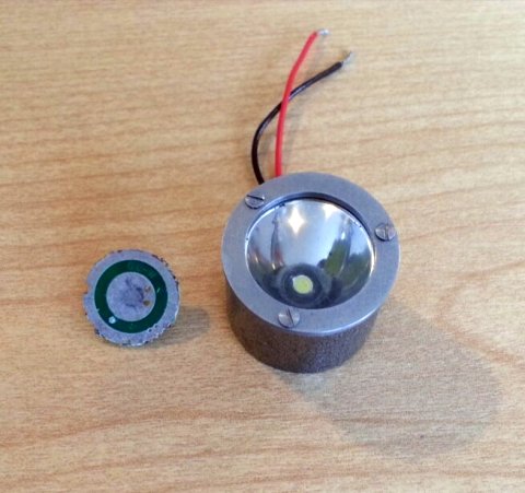

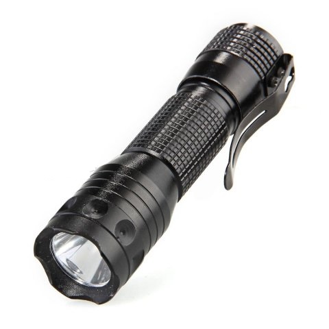

A while ago I bought a small LED torch/Flashlight on eBay. I thought I'd use it for the headlight, but it was rather small. I've just finished converting it to use as the rear light for shunting and reverse running.
Here's what I bought:
I'm just using the LED, reflector, and bezel. This was a single AA cell torch. Interestingly there is a small PCBA that steps up the voltage to 3.7 V. I'm not going to use it as I'll be using the blowers 12 V supply with a step-down module.
This light is very bright, and a cold white. But it responds well to the PWM dimmer. The wiring still needs arranging.

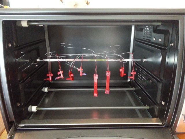

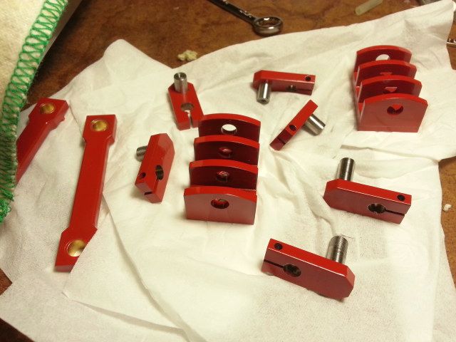

Finally, I have started painting. I bought a benchtop convection oven, on special offer, to bake the paint after initial drying. The setting I'm using is 90 deg C for one hour. The paint is coming out nice and hard.
Because I'm not using an undercoat, the red is coming out quite a nice dark shade
