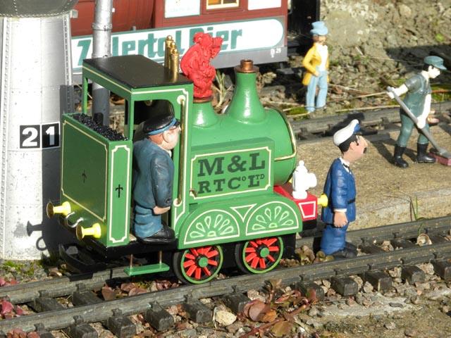

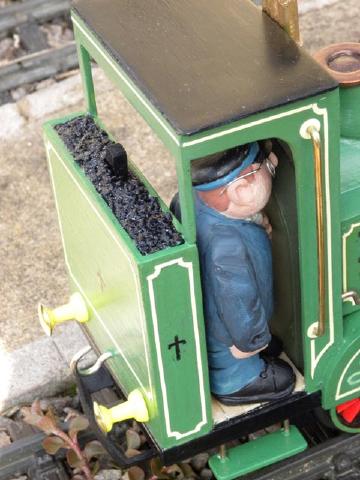

Had a heart stopping moment a few days ago ..... the bunker mounted switch had been blocked in with plasticard to prevent PVA glue and black paint seeping from the "coal" into the switch. After finishing the "coal" (which is only about 1mm deep on a false plasticard baffle plate), I found that the paint had seeped in somewhere and the switch refused to work. Luckily, some coaxing with a little WD40 got the job on track again.
SGP
Post by SGP » Sun Feb 21, 2010 1:31 pm
Jones the Steam (by Busy-Bodies) comes with the Locolines card kit and is not available to purchase separately. However Idris the Dragon and Dai Station can be purchased separately without buying the kit.
The only parts used from the Ivor kit are the chimney and dome ... the 4x yellow push pins (buffer shanks) ... the coupling hooks ... motor & gearbox ... battery holder & switch ... and the lamps. Due to my computer having to go away I couldn't make a transfer for the banner on smokebox door, so it was cut from the original card facing. Brushing on acrylic clear coat started to lift the ink from the printed banner but I got away with it dabbing a bit at a time.

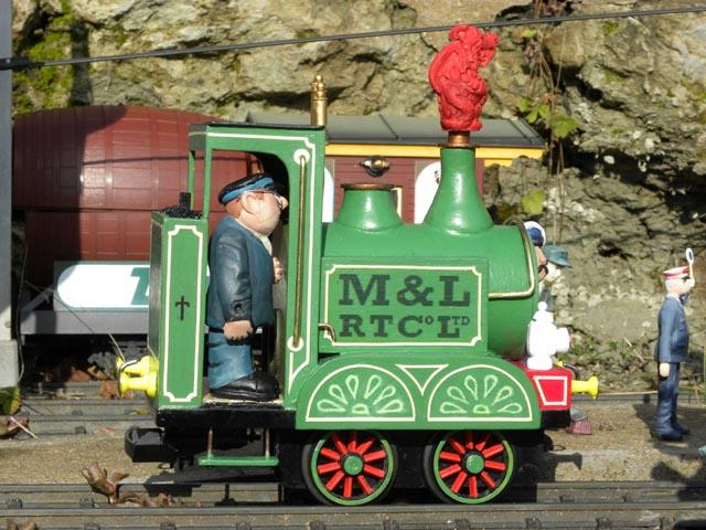

Had a bit of time to spare, so I made an attachment to fit a standard LGB loop coupling ..... (visible in above and previous pic).
SGP
Post by SGP » Sun Feb 21, 2010 1:34 pm
Couple of pics now of Ivor re-enacting a scene from the series. We've decided that Idris looks more comfortable perched on the dome rather than the chimney ...
SGP
Post by SGP » Sun Feb 21, 2010 1:36 pm
The original resin cast organ pipe whistles were thrown away and a new set were made from brass tube, brass strip and ball headed pins ....

Thanks. If I did it again I would change the way I attached the cab steps ... They are separate assemblies attached to the body in two tight fit holes under the cab each side (4mm deep). I should have made the metal rod part of the steps as one long piece bent twice at 90 degrees joining both steps as one.
