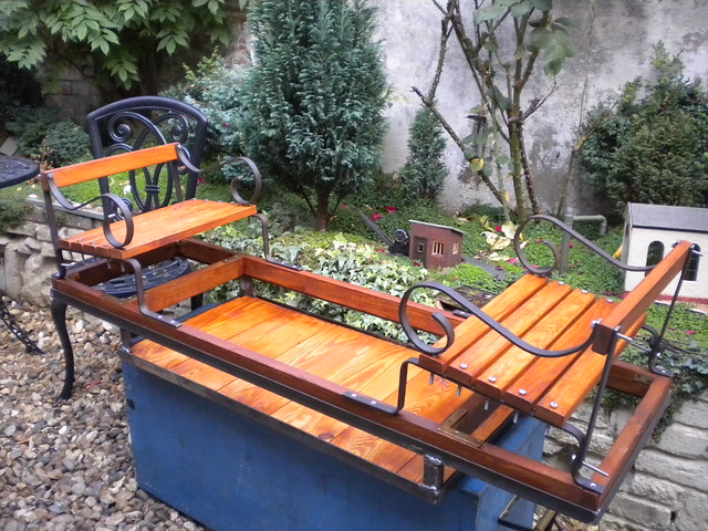

Post by Dr. Bond of the DVLR » Sun Jul 31, 2016 9:23 pm
Carriage no. 3 based on a basset Lowke carriage coming along...
Now we just need some slats and some stainless bolts. I also need to grind down the ends so they are rounded.
(to build)
Posts: 4533
Location: Suffolk
Post by Dr. Bond of the DVLR » Mon Aug 22, 2016 8:28 pm
Slats done today - quick bit of work with a table saw and a router.
(to build)

Basset Lowke carriage progressing:
Varnished mock up to see how the seats feel - also all the holes have been drilled (SOO many holes!)
The wood frame was given another coat of varnish and the bracketry painted black
Then all the metal work had the holes deburred and a final touch look over before priming. I nocked a few nails in the side of the shed to make a drying rack - its a nice sunny spot!
And today the first coat of gloss red to match the other carriages was applied
I also finished servicing the bogies and bolted the bogie stretchers to the frame to allow this mock up to be put together - the paint was still quite delicate so I didn't bolt anything together, just another layer of red to go and the draw gear then it just needs bolting together!
(to build)

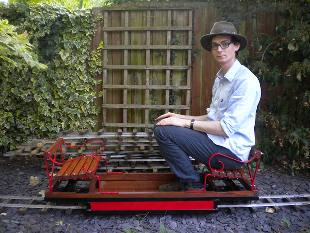

Post by Dr. Bond of the DVLR » Thu Sep 01, 2016 7:12 pm
Sadly I can't do 5" gauge in our garden or any garden at the moment but the second I move into a house with a proper sized garden I should have a pretty good set up!
Carriage all done (except for couplings and lining)
Lots of pictures
The tests for stability were good - the tests for loaded clearence not so - I need to make up some packing pieces to raise the well off the rail head!!
As is now standard - passenger for scale! Quite comfortable for two me sized people to ride up and down in
(to build)
