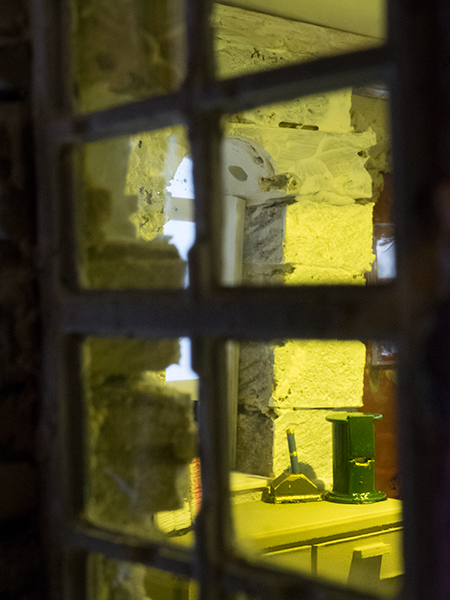

Peering in from the platform side, we can see the Edmondson ticket machine on the booking desk.

Peering in from the opposite side of the building, we can see the Edmondson tickets in their rack.

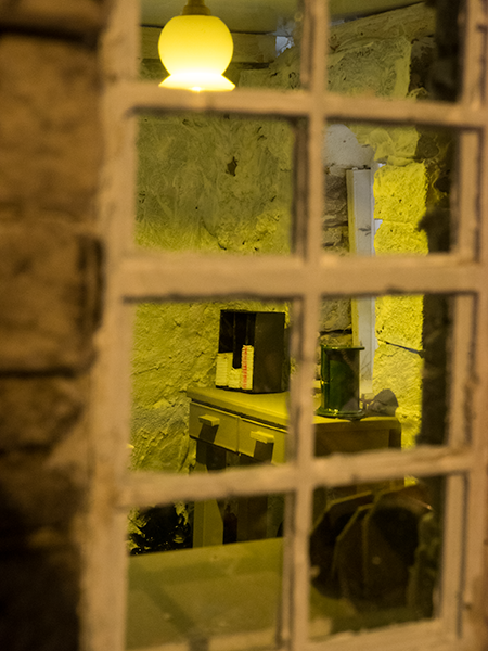

Swivelling round we can see the desk
Office desk.png (393.31 KiB) Viewed 10916 times

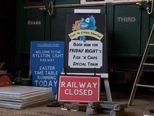

Some signs for the station have been unearthed in cluttered corners of the workshop. I feel the fish adds something.

And finally detail of the Edmondson ticket rack from the window again

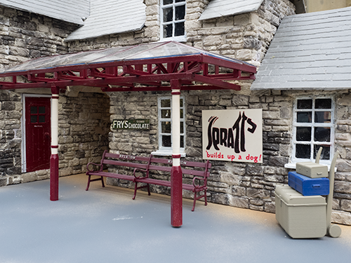

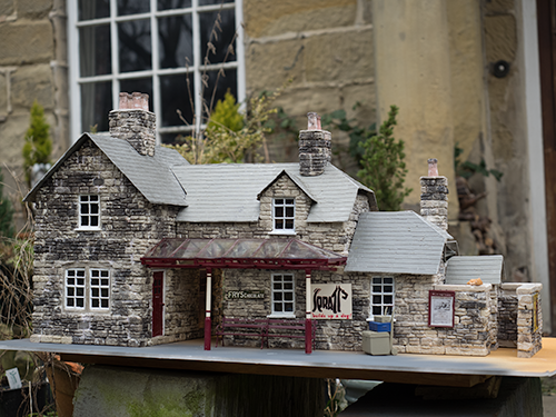

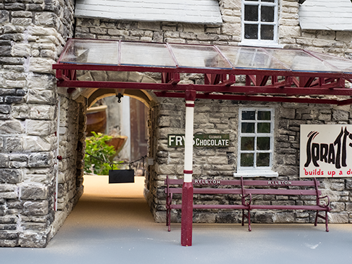

As promised some outside shots of Rylston Station building mocked up on a board. Very much work in progress but I have temporarily dressed it up with accessories to assess its potential. The signs are easy as they are fixed by magnets embedded in the JigStone castings. The idea is to allow different signs when running in different eras. The cat is also fixed this way. Lots to do with barge boards, gutters and ridge tiles etc. Then the new RLR needs to be built for it to go on.
Overall view from platform side:
Rylston platform in development.png (377.5 KiB) Viewed 10856 times
A closer view:
Awning in development.png (392.47 KiB) Viewed 10856 times

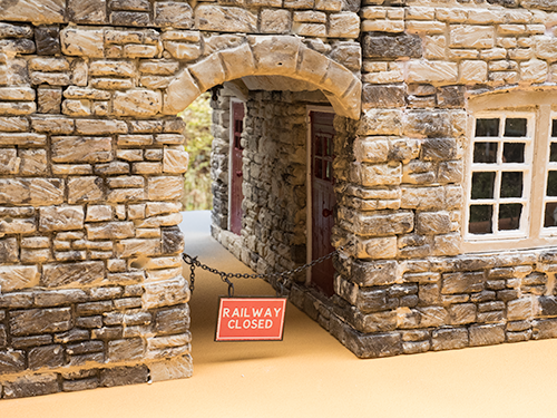

The platform view of the arched passage with ticket window to right:
The town view of the station:
Rylston town side in development.png (446.24 KiB) Viewed 10856 times
Closer view of town side of arch, with a warm welcome evident!:

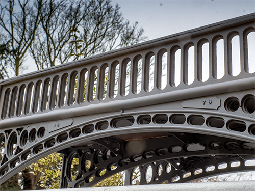

I seem to have a butterfly approach to modelling and so the last two days has seen no more progress on the station building, but this is why:

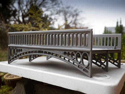

Cast iron skew underbridge.png (384.69 KiB) Viewed 11759 times

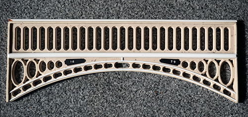

I have been constructing a cast-iron (style) skew underbridge for the Rylston Station approach over the last two days. The starting point were two cast resin bridge sides (no other components) that I picked up from a stall at the 2017 Elsecar show. They were really cheap; I cannot remember clearly the stall or price (put it down to "chemo-brain"), but possibly Classic Cinema from Cleethorpes and possibly £9 each side. If anyone knows otherwise please correct me.
However I decided to add some further depth with styrene half-round rods, some styrene scrap and left-over Slaters styrene numbers. The white (and black) areas are added styrene but the cream is the original resin casting bought:
Cast iron sides unpainted.png (301.6 KiB) Viewed 11759 times
The underbridge detail is a mixture of a cast of the lower half of the bought-in side (using a reusable mould material) and styrene off-cuts for the lateral bracing. The detail is not great (lots of casting defects) but I reckon it only needs to be low-fidelity under the bridge as it will be dark and shaded so won't be seen in too much detail.
A more general view:
Cast iron skew underbridge 2.png (308.13 KiB) Viewed 11759 times
I feel that one-and-a-half days work and under £20 for the bough-in castings have resulted in a passible skew-bridge. Of course stock materials add to the cost.
Andy
