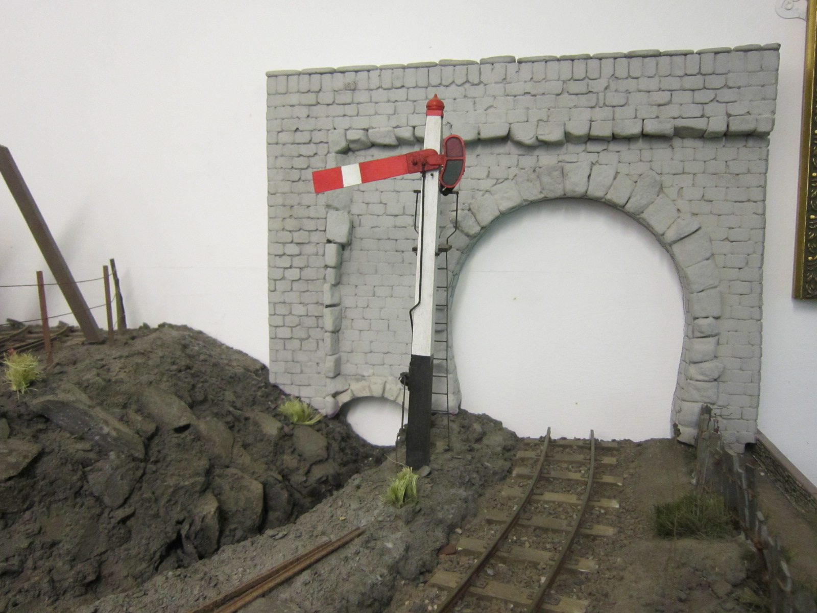

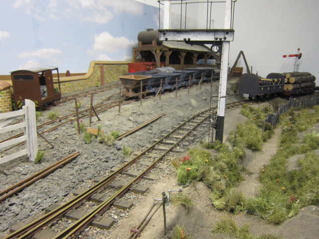

Not sure how useful this is but my indoor layout has Tenmille signals which were made from kits years ago. I didn't make them myself but I know they have wooden posts, whitemetal finials, arms, counter weights and brackets, brass ladders and are operated by brass rodding. They work well even under exhibition conditions and are capable of working still if only I could be bothered! They can be illuminated too.
This is the only picture I can find of a bracket signal, unfortunately with the arms cut off.

Peter, thanks for replying. I might sample a few. I like the idea of illuminated lamps for summer evening steam ups.Peter Butler wrote: Wed Nov 22, 2017 10:44 pm Not sure how useful this is but my indoor layout has Tenmille signals which were made from kits years ago. I didn't make them myself but I know they have wooden posts, whitemetal finials, arms, counter weights and brackets, brass ladders and are operated by brass rodding. They work well even under exhibition conditions and are capable of working still if only I could be bothered! They can be illuminated too.

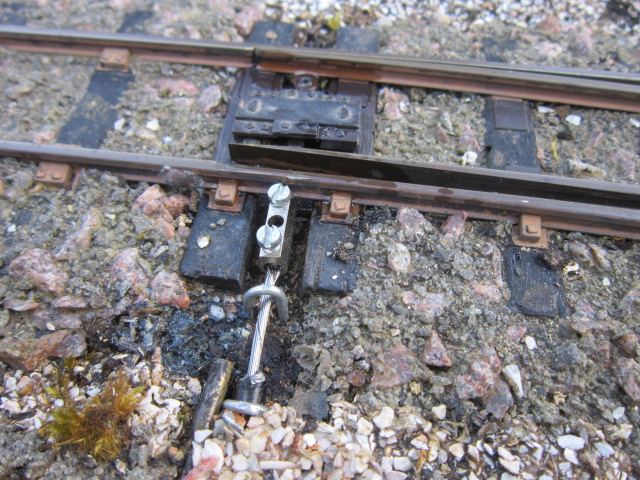

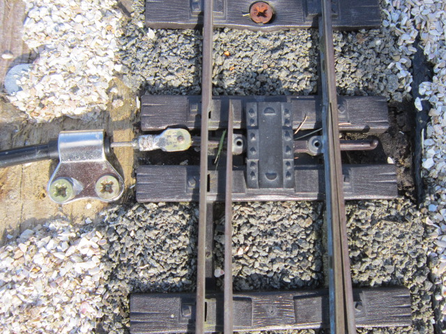

During the past Summer (only recognisable by the fact the rain is warmer) I fitted bike cable operation to two points which are beyond reach. They have no levers fitted as I wanted trains to trail through switching the blades themselves.
The first has a simple crimped ring attached to the cable and popped onto the Peco tie bar 'peg'.... The second had to be a clamp system as the 'peg' had snapped off ...... Both work very well having the cables flooded with oil to keep them smooth in operation.
I know these will offend your critical engineering eye and are only there to show how your idea might be achieved, I'm sure you can improve on this!
