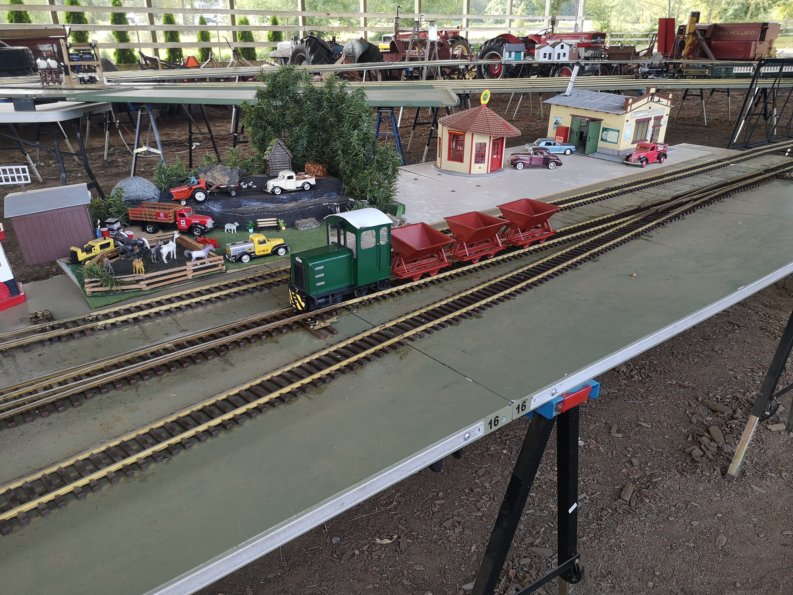

The Reading & Squamish workshops recently commissioned some supporting motive power in light of the increased stock arriving on the line...
The work experience kid already managed to drive it into the workshop doorway, incurring some minor roof damage. The manager had some coarse language to share!

by LNR
Nice one Ted, I like the way the windows drop down either side of the engine casing, very prototypical.
Re: The Reading and Squamish Light Railway Stock Thread
Posted: Sun Jun 07, 2020 5:15 am
by big-ted
LNR wrote: Sun Jun 07, 2020 12:40 am Nice one Ted, I like the way the windows drop down either side of the engine casing, very prototypical.
Heh. It's an IP Glaslyn kit, built exactly per the instructions, so I can't take too much credit!

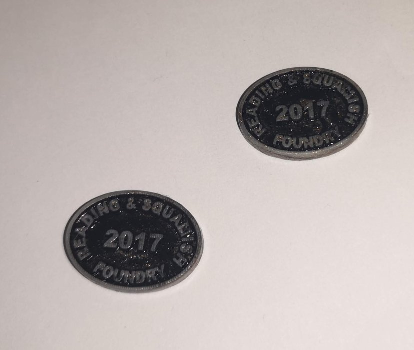

I now have far more stock than I can reasonably store in my apartment, so I'm going to make a conscious effort to hold back on building anything new and instead focus on quality rather than quantity. My Lady Anne is set to receive some detailing bits and get some paintwork done over winter. First up though, some builders plates. I've been trying to 3D print these on and off as time allowed for a while now. The printer I usually use just didn't have the resolution to produce the text, so I had to bight the bullet and learn how to use the new one. You can see I'm just about at the limit, but I think they look pretty good.

Posted: Thu Sep 17, 2020 7:45 pm
Those plates do look very good. What are the dims and what printer did you use for them?
Posted: Thu Sep 17, 2020 8:51 pm
by big-ted
Sorry, I should have left something in the picture for scale! The plates are 17 x 13 mm. I'm using a Form 3 printer. Up until now I had been using an Ultimaker 2+. The Form 3 definitely has better resolution, and gives a smoother finish without visible layering. But it's a bit more involved in terms of handling all the chemicals associated with it. The other thing I struggle with is removing the support structure. I find it impossible to remove from the part without leaving some kind of divot in the surface of the part itself. Fortunately with these plates I was able to print them so that all the support structure was on the back...

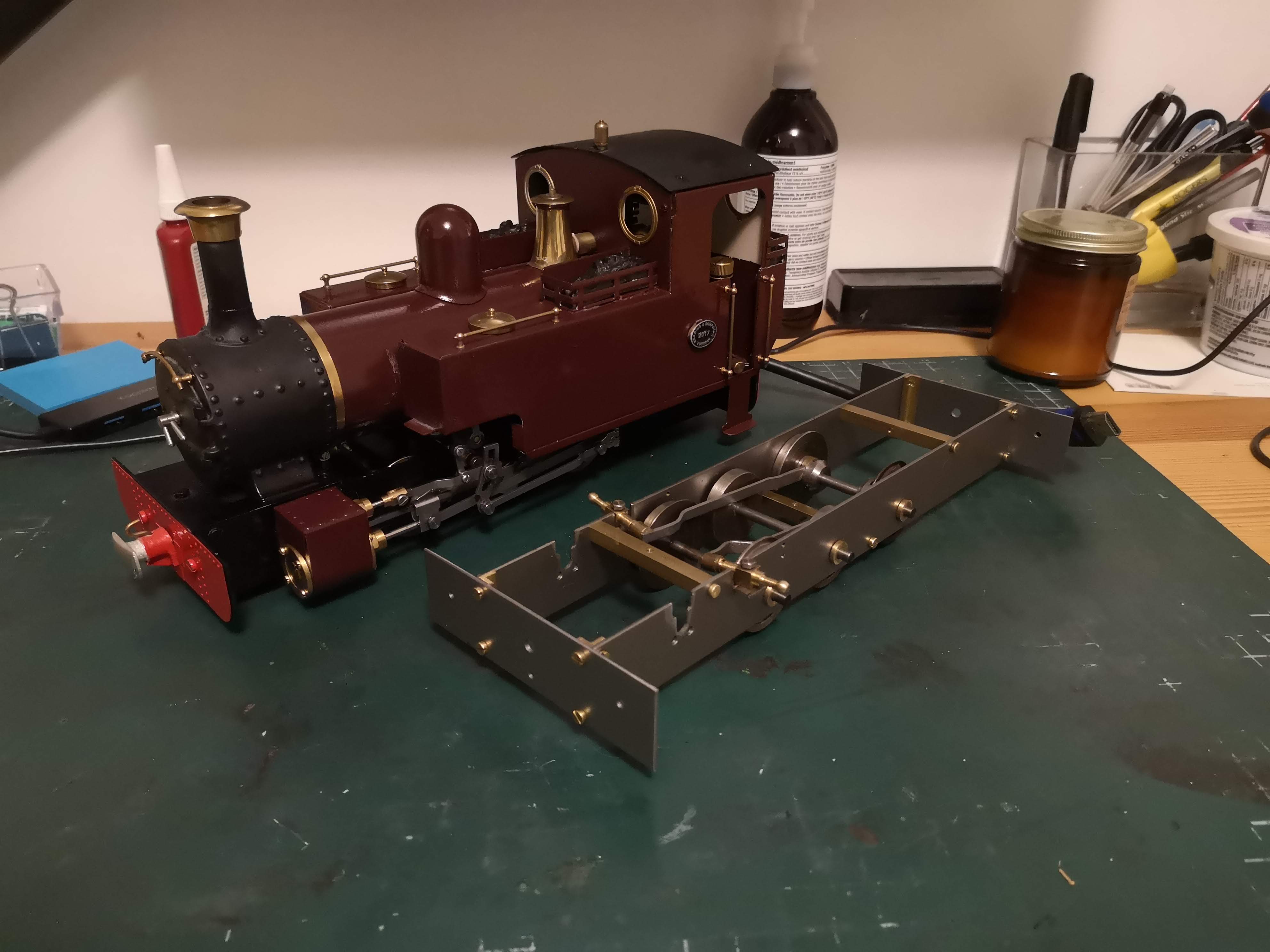

Posted: Mon Dec 21, 2020 6:12 am
by big-ted
Well, 70mm of rain over the weekend meant I had plenty of excuses to get stuck in.

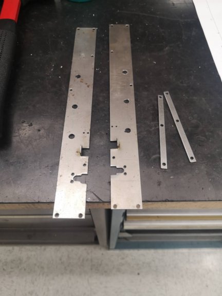

Before starting to put my new loco together, I had to begin by taking it apart. I first checked the wheel back-to-back measurement with my Roundhouse gauge from my Lady Anne to make sure the modern tool was still ok to use with the older wheelsets. Since the 32mm spacing seemed to match the gauge, I figured the 45mm would too. The wheelsets were attacked with a propane torch (I would later find out my little butane torch works fine too) to brake the ~30 year old loctite so that they could be reset to 45mm. Loctite 603 is recommended as it's a wicking grade that will seep into the space around the axle, but it's pricey stuff, and I had some 620 already. This is plenty strong enough, but has to be applied to the axle then the wheel slid over as the 620 is too viscous to seep into the gap.
Then I marked out the frames and coupling rods with where the axle holes needed to be drilled. These early kits allowed the builder to build either a 2 or 3-axle chassis. This does, however, mean that builder has a few significant extra steps to complete before reaching what is essentially 'step one' of a modern kit build. I decided to go for an 0-6-0 as I thought it might look odd to have a loco the same size as my Lady Anne with one less axle. At this point, I relocated to our shop at work. I had it in mind to use the drill press to make sure I drilled everything square. However, once I started setting up I realised that it would be daft not to use the mill, where the linear slide and digital read out allowed me to drill everything in one go with much greater accuracy. So I dusted off my (very rusty) shop skills...
In all honesty, I don't envy anybody who built one of these kits without access to at least a drill press, as it must be very hard to drill everything with good alignment.
The other consequence of my re-gauging the loco was it being necessary to bend the valve rods, as the eccentrics now sat further outboard against the wheels. Not going to lie, this was a royal pain in the proverbial. I'm not entirely sure it would have been much easier without the extra effort of re-gauging, as no matter what I tried, one rod always seemed like it was too long, and one of the eccentrics had a bit of extra solder on it that had to be filed smooth. I ended up having to take one of the rear wheels off the axle to work on the eccentric before re-loctiting it again. Eventually, and with a bit of help from what I thought was a clever trick to run everything in, I got everything running smoothly.
Couldn't resist...
Next I have to take it all apart to paint the frames...
