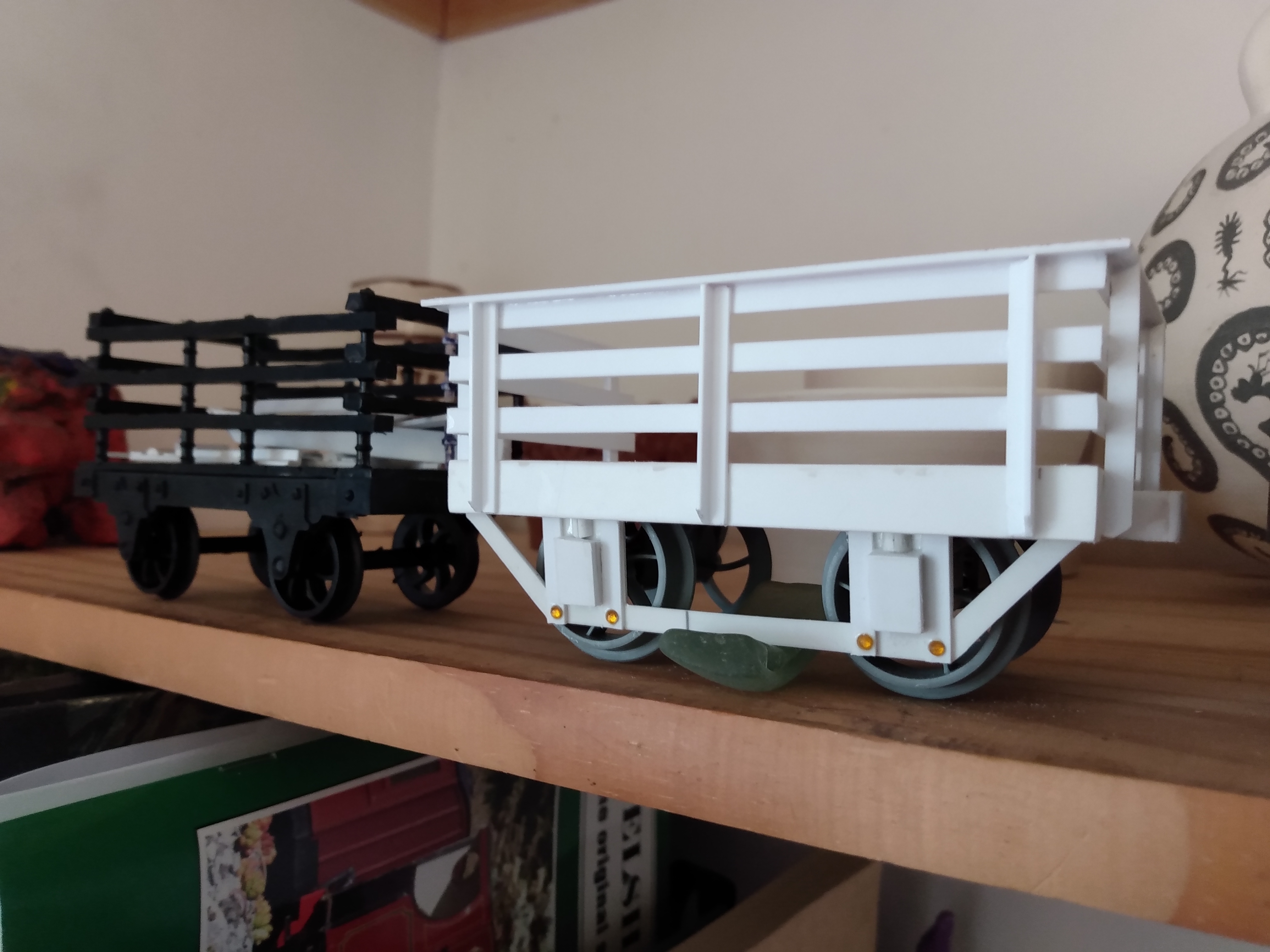

There's no rapid progress to report but I have been plodding on with a couple more WHR slate wagons. One is a slightly modified Binnie kit, the other's a scratch build to represent a wagon of the all metal type that appear once in a makers photo but then take a backseat (at least as far as photographers are concerned) until one puts in an appearance (minus it's body) on the demolition trains that tore up the track in the 40s.
Here they are:
The white one looks more complete than it really is - the other side doesn't exist yet because I've run out of plastic strip, the dummy running gear is just propped in place (with a piece of sea glass that just happened to be handy...) and I've yet to start on the complicated-looking brake gear. On the plus side, I'm going to paint it all black, so that bit should be quick!

Another interesting and unusual prototype, I never knew there were any all-metal slate wagons on the WHR. I'd image they were more expensive than their timber-framed counterparts, and therefore far less common? That was the way with sugar cane wagons down here, anyway.

It is a very smart wagon and beautifully made too, a fine addition to the fleet.

It seems that this type of wagon was unusual on the NWNGR/WHR - most wagons were either all wood, or had iron bodies on wooden chassis.
If anyone's interested there are articles on WHR slate wagons here: https://www.welshhighlandheritage.co.uk ... -No-72.pdf (for the "box" type) and here: https://www.welshhighlandheritage.co.uk ... -No-74.pdf (for the "crate" type).
Reading those will reveal that I'm creating an impression rather than making accurate models (the Binnie wagon should be wider, and the scratchbuilt one narrower, for example), but nonetheless I should end up with a rake that looks the part, with a rake of various types and in an assortment of sizes, with identifiably NWNGR characteristics and a family "look" to them...
Aaron, as I recall, the relative costs of metal and wooden wagons are discussed in the article - I think I've read somewhere (possibly in the attached articles) that the quarries preferred wooden wagons, because they were kinder to the slate, but the railways preferred metal ones, which required less maintenance.
