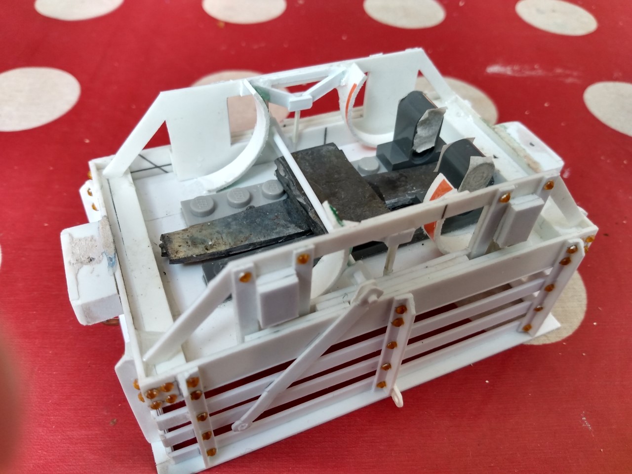

For now, here's a picture of the wagon's underside, which may be of interest, because it shows (some of) the Lego running gear:
NWNGR iron slate wagon underside.jpg (202.44 KiB) Viewed 7653 times
I had considered building the whole underframe from Lego, but the geometry didn't really work. The axles go into roller bearings pushed (well, hammered) into the holes in the Lego parts (masked for painting in this view), two of which I've omitted for clarity. The ability to take the wheels on and off so easily has been an unplanned bonus during construction - I don't think I'll bother gluing the Lego parts together to retain that ability.
The brake gear was a bit of a challenge, because the real wagon seemed to feature brake bands (as I think they're called), rather than brake blocks. I've represented these with slices of a tube that contains vitamin C pills. The tube still has some in, it's just a little shorter than it was before...
Photos of the finished thing at the weekend, maybe?!

Re: (WH)WHR Rolling Stock
Post by Lonsdaler » Thu Apr 07, 2022 7:57 pm
I can't believe the detail you've included there. Can't wait to see the finished item!
Post by FWLR » Fri Apr 08, 2022 6:31 am
Nicely thought out and built wagon this Andrew. Would they by gaugeable wheels by any chance.
Post by Andrew » Fri Apr 08, 2022 9:05 am
FWLR wrote: Fri Apr 08, 2022 6:31 am Nicely thought out and built wagon this Andrew. Would they by gaugeable wheels by any chance.
Hi Rod!
Yes, they'll just be Cambrian wheels on 2mm rod for axles, so in theory they can be set to any guage you fancy.
The Lego's just for the axleguards - it seemed like a good option for this wagon, partly because I had the bits available, but mostly because it meant that I could make dummy representations of the real axleboxes, far less complicated than making them actually work!
Post by Andrew » Fri Apr 08, 2022 9:09 am
Lonsdaler wrote: Thu Apr 07, 2022 7:57 pm I can't believe the detail you've included there
I'm glad you approve, thanks, but actually that's just a lot of bits of plastic pretending to be detail! If you scaled up that brake rigging, it wouldn't work do anything at all - I couldn't really work out what was going on with the real thing, so I represented it as best I could on the grounds that no-one will notice when it's all painted black...

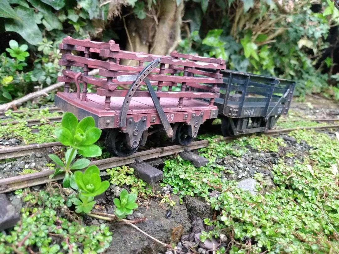

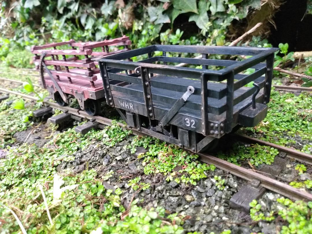

Post by Andrew » Wed Apr 13, 2022 2:03 pm
Hi all,
Yesterday evening I finished (for now, at least) the two latest slate wagons, and here they are:
Finished slate wagons 29 and 32 A.jpg (201.64 KiB) Viewed 8032 times
Finished slate wagons 29 and 32 B.jpg (207.7 KiB) Viewed 8032 times
I now have 12 traditional "crate" type slate wagons (9 FR and 3 WHR) - I think I can feel an England-hauled slate train coming on over the long weekend...
Post by FWLR » Wed Apr 13, 2022 2:19 pm
I do like them a lot Andrew. Have you 3D printed the brake handles.?
Post by FWLR » Wed Apr 13, 2022 2:22 pm
I also like the way you have roughed up the sides of the wagon, really authentic I think anyway. :thumbright:
Posts: 5713
Post by Peter Butler » Wed Apr 13, 2022 2:28 pm
Very nice Andrew, they look like they have earned their keep over the years.
Post by Andrew » Wed Apr 13, 2022 2:35 pm
FWLR wrote: Wed Apr 13, 2022 2:19 pm I do like them a lot Andrew. Have you 3D printed the brake handles.?
Hi Rod,
No, they're just cut from plastic sheet - fiddly, and not my favourite job, but they turned out OK. I currently have no 3D printing skills or equipment. One day, maybe...
