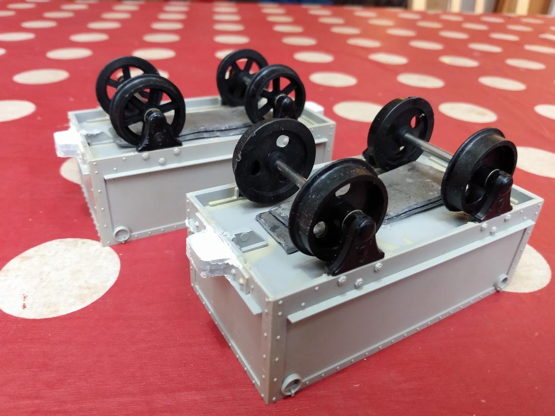

I had the day off today, so spent a fair bit of it working on these. In the end, I've kept the alterations fairly minimal. The perpendicular strip that runs around the lower part of the body is the most noticeable departure from the real thing, but cutting it away wasn't an option because the bodywork below it isn't flush with the rest of it, so I've left it. According to Festipedia, the real things were built for horse haulage and weren't strong enough to be used in long locomotive-hauled trains, so I'm assuming those strips are something to do with strengthening them for use in longer trains...
I did rearrange the axlebox bolts a little, and have also added the distinctive and very basic brake hangers and lever on one of the pair. I'll leave adding the brake shoes and rodding until after I've done the initial painting.

Here's the latest view, with the wagons primed and ready for the next stage. As you can see, the work I've undertaken was relatively minimal:
Croesor 2.jpg (82.25 KiB) Viewed 7814 times
Progress is likely to slow now, but the project feels like it's off to a good start...

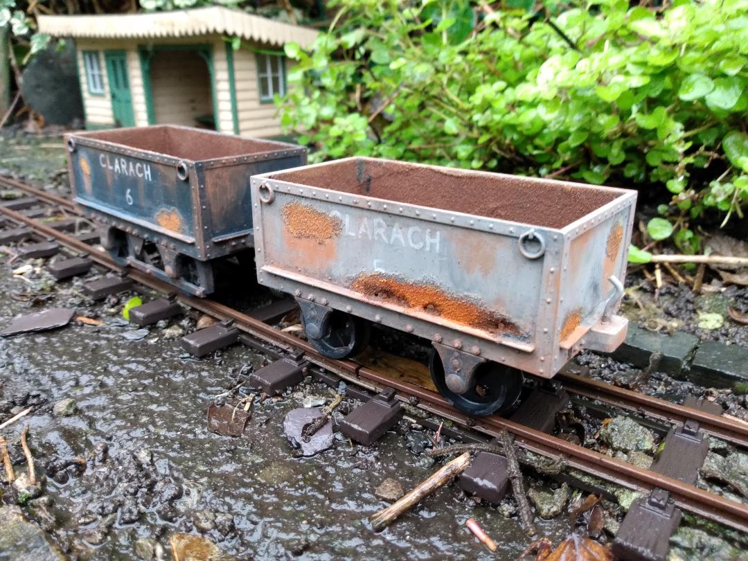

I finished the Coopercraft Croesor slate wagons just before Christmas, haven't given them a test run yet, but I did take them outside for a quick photograph.
Here's a "Before" picture:
Croesoe before.jpg (198.01 KiB) Viewed 8468 times
And here they are "after":
Croesor after 1.jpg (191.18 KiB) Viewed 8468 times
Croesor after 2.jpg (205.93 KiB) Viewed 8468 times
All good rusty fun - I was pleased with how the rather rustic brake gear turned out on the black one. The lettering is in the style of the "Parc & Croesor" wording on the originals but represents the fictional Clarach Quarry instead.

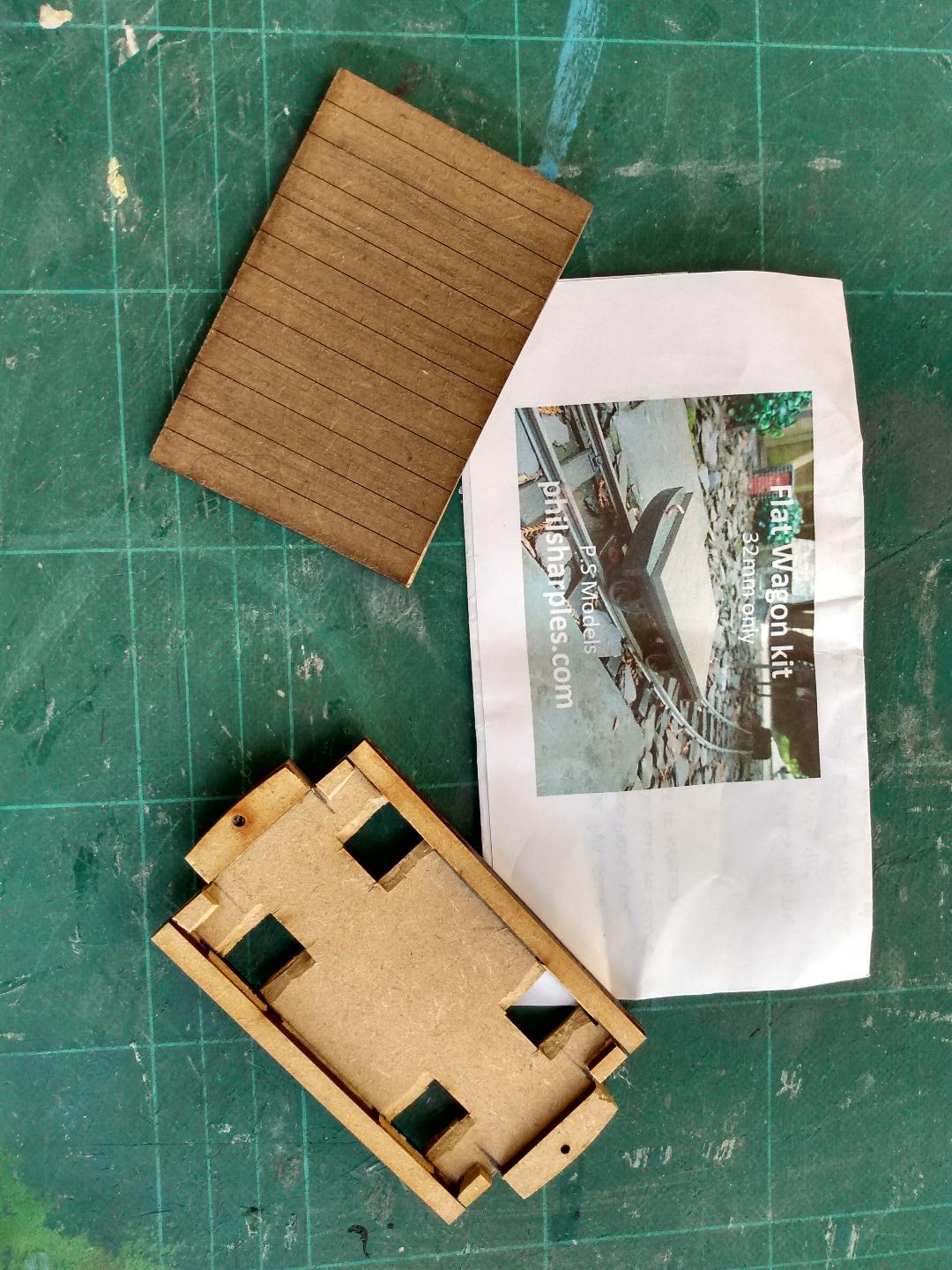

It's intended to become a Welsh Highland slate wagon - that's the conventional "crate" type, the WHR also used simple open wagons for slate traffic. There were a number of different designs, but only one (unusual) type has been drawn, and few photos exist. Mine will be a composite design based on those photos, with typical WHR features, most notably an iron body on a wooden chassis, and a lack of bracing on the corners - I'll dig out a photo at some point.
My idea is to build this around a cheap flat wagon kit, for speed and reliable running, and because in the absence of drawings no-one can tell me it's wrong! I opted for the Phil Sharples kit, and so far I've opened up the slots for the solebars to accommodate larger wheels, cut down the bufferbeams to made curved buffer/couplings, and hacked the original dummy solebars around and glued them on to thicken the frame. I've also stained the deck and coated everything in MDF sealer. Here's what it looks like so far:
WHR slate wagon 1.jpg (267.46 KiB) Viewed 8379 times
If the whole project works I plan to build another 4 or 5 of these, so I might see if it's possible (and cost-effective) for Phil to cut the parts to incorporate the modifications I've made, and to supply them with larger wheels - he's happily done the latter for me before.
The next step will be to tidy up the chassis and add dummy axleguards, then I'll need to tackle the ironwork, which is where the whole thing might fall apart, literally.

Glad you like the rust effect.
Yes, it's iron filings, applied while the paint was wet then "activated" with copper sulphate solution, which appears to create a far more orange rust than using vinegar. I think I could probably vary the colour by changing the strength of the solution - some experimenting is required... The darker rust inside of the wagons is just diluted black paint sloshed over the top, to represent coal dust - it seeped through some holes I'd made in the side of the grey wagon (to represent more extreme corrosion), which wasn't really what I'd planned, but it does serve to vary the colour of the rust.
I think the best effect I've managed is where I've painted over the edges of the patches of filings before applying the copper sulphate - the rust then appears underneath the paint, looking like it's taking hold of the next bit of the iron. The streaks and other surface rust are just dilute acrylic paint brushed on - the overall effect is better than if you look too closely, I think!
Incidentally, I discovered after I started using it that copper sulphate is pretty nasty stuff and should be handled and disposed of with care - there was no warning on the packet, or on the website I purchased it from, so I assumed it was fairly harmless. Luckily, I seem to have survived...

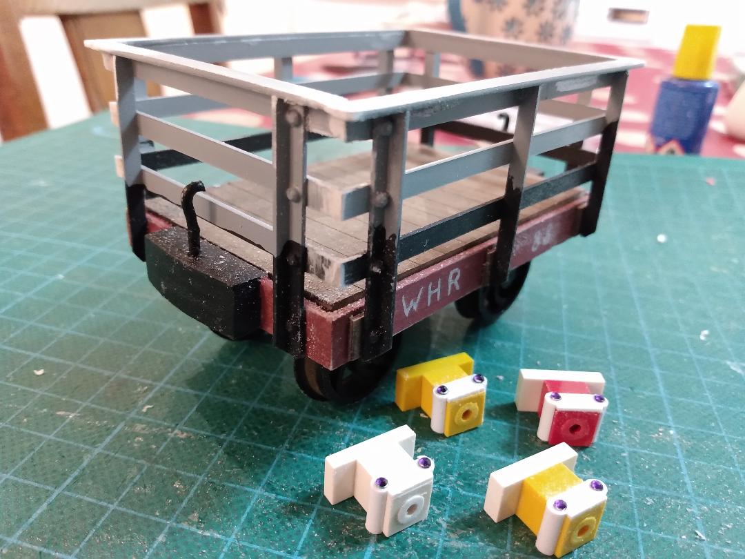

I'm hoping to get the WHR slate wagon finished this weekend. Here's where it was up to last night, with (plastic strip) sides and ends assembled, and the (primarily Lego) axleguards awaiting painting. The upper part of the bodywork needs a coat of black too - I did the lower bits because they'd be fiddly later, but left the rest because I knew there's be filling and sanding to do .
WHR slate wagon 4.jpg (118.43 KiB) Viewed 7931 times
It's actually progressed a little more since then, with painting complete and axleguards affixed - just weathering to go now...
