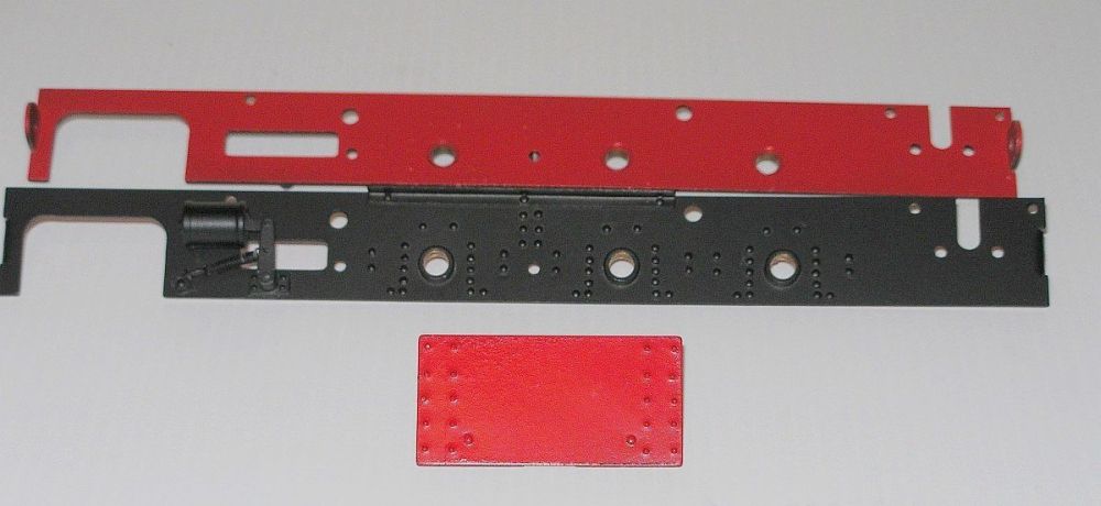

So following Aaron's lead, the frames were drilled with the dozens of No. 57 holes which are a fit for
the escutcheon pins I use for small rivets. I also wanted to avoid the two large bolts fixing the front
drag beam to the frames, so two 3mm countersunk brass set screws were turned up and soldered into
the beam then an overlay with the appropriate rivet pattern was soldered over the lot.
Frame 3.JPG (45.69 KiB) Viewed 21485 times

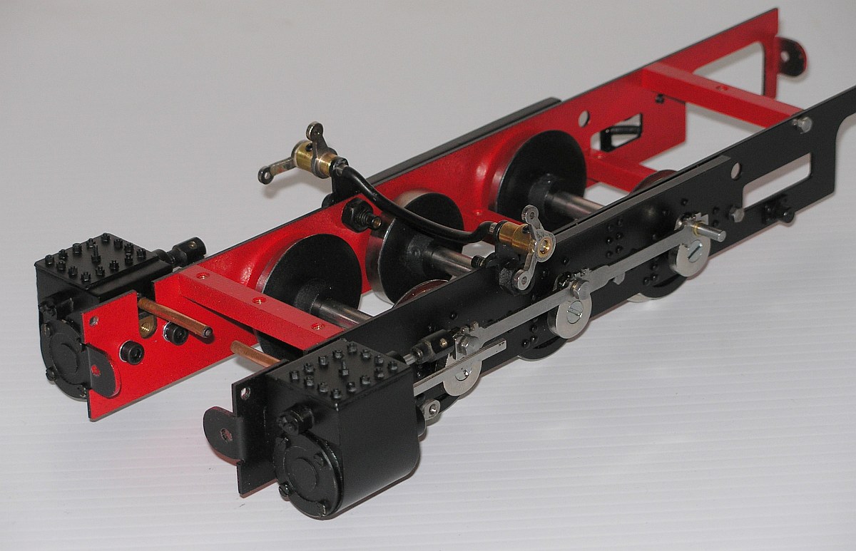

The frames assembled and with the reverser swapped to the right hand side (haven't removed the left hand arm yet)
Frame Cyls. 1.JPG (140.63 KiB) Viewed 21485 times

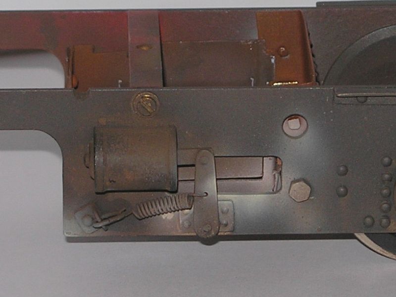

Just to cover some of the other detail changes, I made up an ash pan with hopper doors and a couple of washout plugs,
Ash Pan Damper Doors 2.jpg (62.78 KiB) Viewed 21337 times
Pure luck that the washout plugs ended up central in the frame holes (you gotta have a win sometimes).

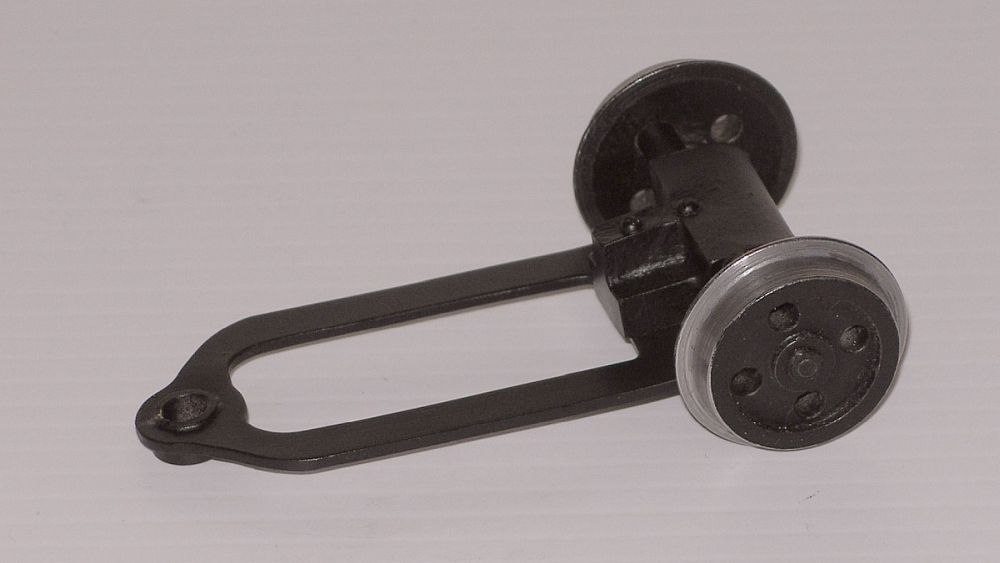

The blueprints show two different trailing truck arms, so went with the one that suited best, plus drilling the holes in the wheels.

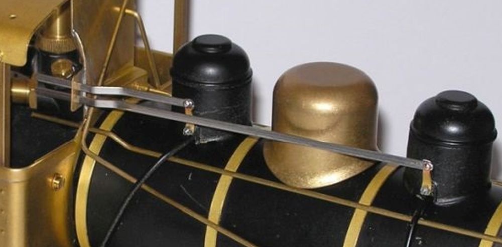

The kit only provides a single operating lever for both sand domes, so by drilling the domes for a 12BA bolt put in from the inside and cranking the operating levers out then fixing two separate levers(from SS windscreen rubber inserts) it looked more prototypical. Unfortunately because of the addition to the boiler they ended up having to stand further away from the position provided hence the extra bends at the cab front.
Corrected Sanding Levers.jpg (60.29 KiB) Viewed 21337 times

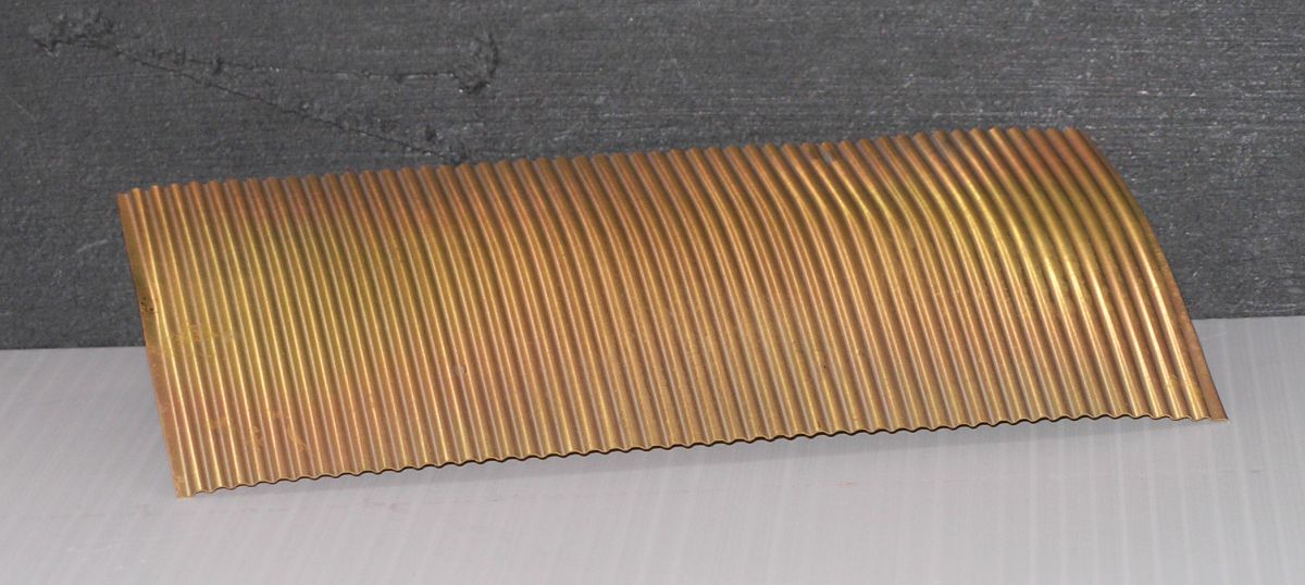

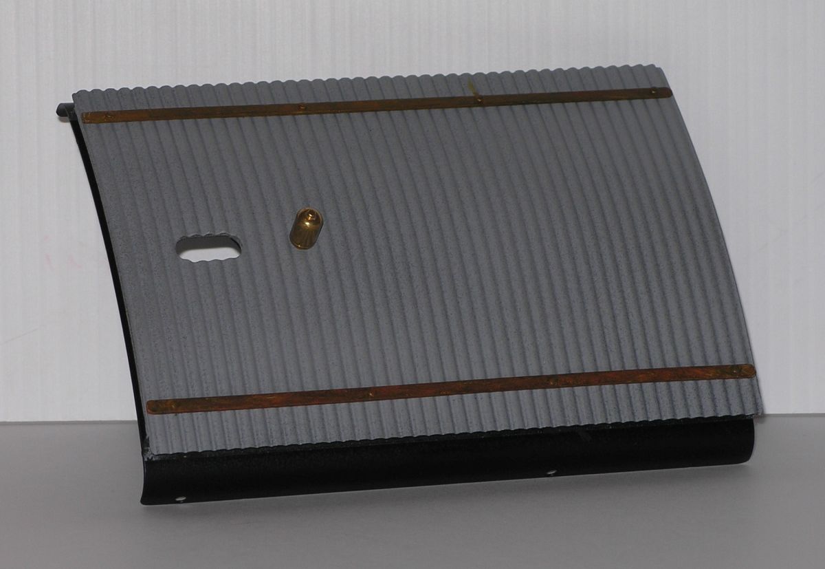

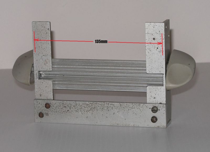

Many of the prototype photos show corrugated iron over the roof. Using the paper crimper I've got is sufficient for aluminium, but I wanted something more substantial, and using it in its present form proved that the rollers would flex so corrugating the edges but not the middle. The rollers were put in the lathe and shortened so I could still roll an 8ft. sheet for buildings.
Shortened Corrugated rollers 1.JPG (44.77 KiB) Viewed 21259 times
Then I successfully passed 10thou. brass sheet through it after annealing, with a second annealing for the camber.
10 thou Brass Corrugated Roof 2.JPG (116.28 KiB) Viewed 21259 times
A couple of thin steel strips pinned formed the strapping to hold it down.
Cab Corrugated Roof Finished.JPG (97.7 KiB) Viewed 21259 times

Posted: Thu Jun 13, 2024 6:32 am
How do you anneal a largish sheet? Does the whole thing need to reach the required redness at the same time or can you heat it up in sections?
Posted: Thu Jun 13, 2024 7:30 am
by LNR
Rik, I just did it over the big gas ring in the kitchen and as each part came up to heat I moved on to the next. Not ideal but the tray of brass shavings that I have for clock hands was not big enough.
Posted: Fri Jun 14, 2024 3:54 am
by Old Man Aaron
Might have to follow suit with my own roller, I have the same issue.
Might even give it a proper crank handle, and replace the vice grips I've used the last 7 years. :lol:
Posted: Fri Jun 14, 2024 8:06 am
by LNR
Graeme (GTB) has put a crank handle on his, it makes sense. I have to use both hands on the plastic handles provided on mine, when they break I'll go the crank handle way too.

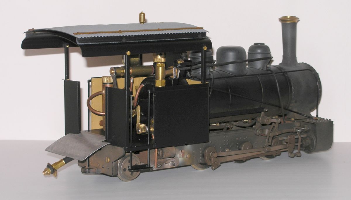

Posted: Thu Jun 20, 2024 7:34 am
by LNR
I'll have to boil some water in this soon. Coming up the back straight finally.
Final Assembly 2.JPG (91.84 KiB) Viewed 21132 times
Posted: Thu Jun 20, 2024 10:57 am
Absolutely amazing Grant, what a beauty!
Posted: Thu Jun 20, 2024 4:33 pm
by Old Man Aaron
Superb!
Out of curiosity, is the motion weathered to represent red paint under an inch of grime, or is it rusty? Nailed it either way.
Posted: Fri Jun 21, 2024 12:23 am
by LNR
Hi Aaron,
There's a coloured photo around of No. 11 sitting in QGR's Innisfail yards in black livery with traces of red lining and in a fairly
dirty state. The motion doesn't show any traces of red so that's what I was trying to emulate. I haven't completed the weathering yet.

Posted: Sat Jun 22, 2024 4:17 am
by LNR
Some more finishing touches.
At Last 2.JPG (151.99 KiB) Viewed 21058 times
Will have to tone back dirt on the tender. It's by far the cleanest engine in my fleet.
