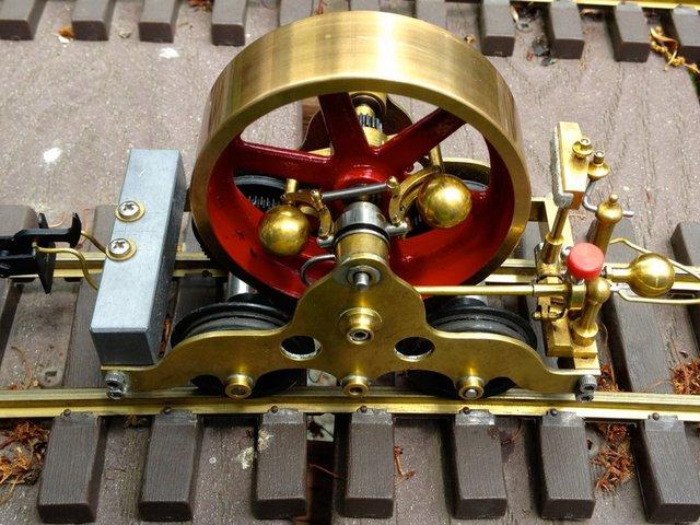

Alan P:110506 wrote:The second one looks like it's been made from parts taken from a computer hard drive.
Yes, quite so. Apparently, the lever to the right adjusts resistance by moving magnets in or out of the space between the disks.

ge_rik:110505 wrote:
Beautiful little piece, this. It appears to have a centrifugal brake, too!

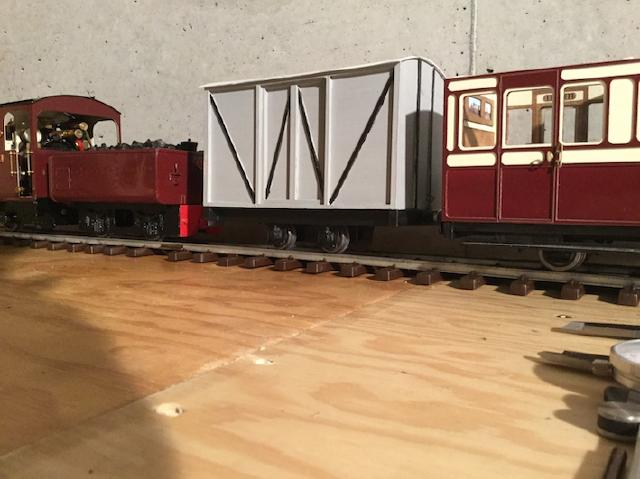

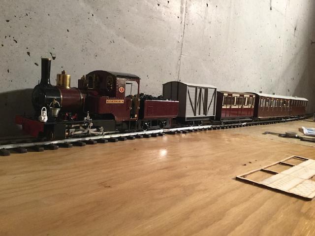

Well, I've finished my version of the wagon. It's just an IP "panelled wagon". It's very plain, even for an IP wagon. I wouldn't mind some suggestions for making it look a bit more finished?
Anyway here it is. The short wheelbase is a little silly-looking, although I don't suppose it will be too obvious when the wagon is part of a train. I've included a picture of it in my rather haphazard little "passenger" train.
