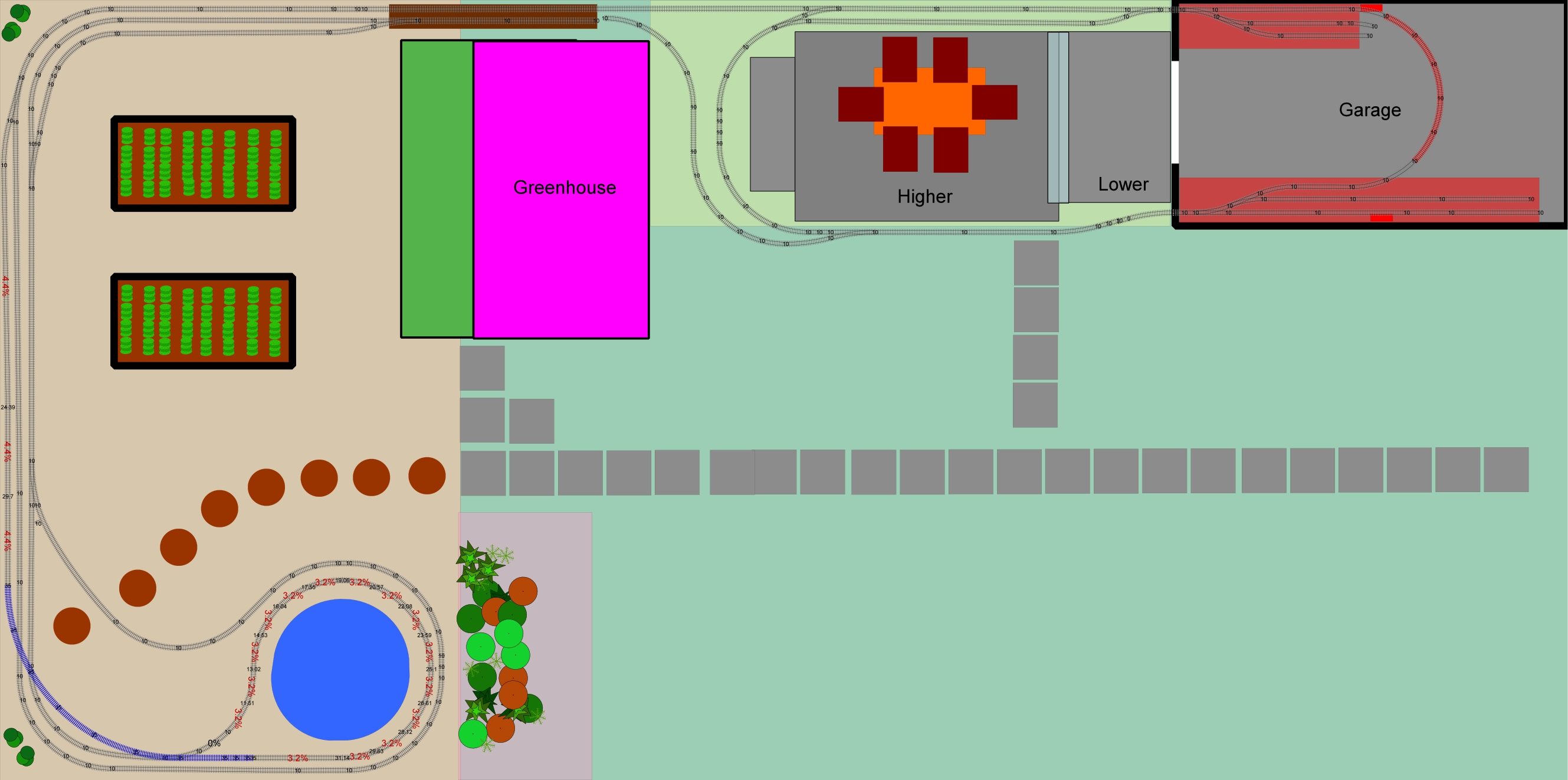

and the current plan
Post by stevenfitch » Sun Apr 10, 2016 9:14 pm
The current track plan, the photos in the previous are the section of the garage at the top of the plan.
Click to see full size image

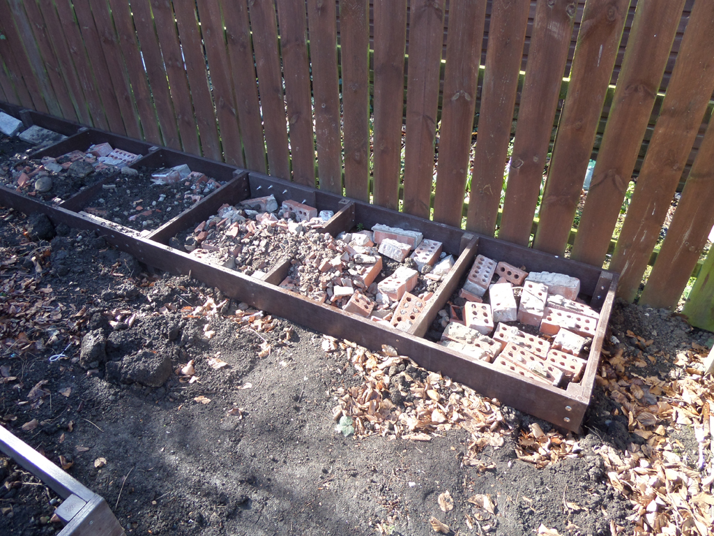

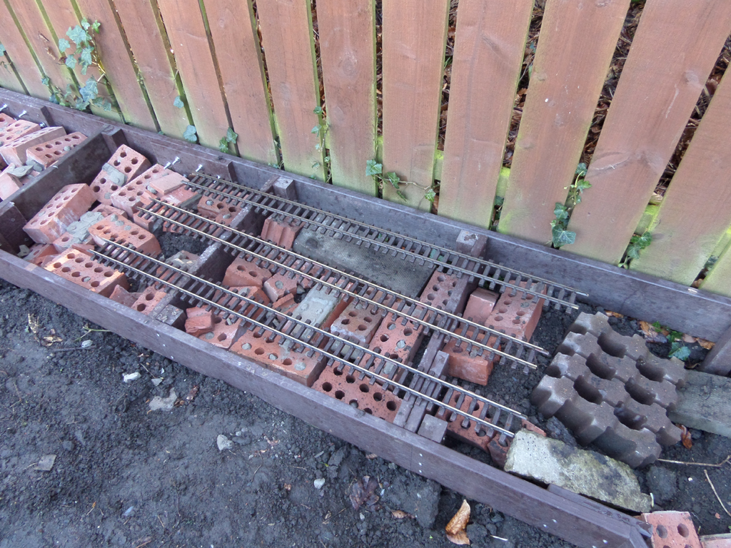

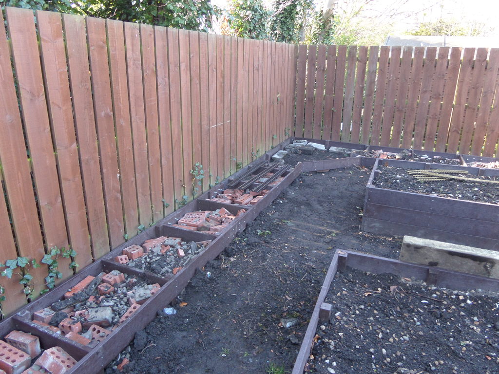

More progress on some other parts of the ground works, whilst waiting for the block paving to start and also needing to reduce the amount of plastic / wood stored in the garage i've put together the raised bed which will hold some of the trackwork (top left corner of the plan a few post previous).
Filled with the bricks removed from rear of garage when adding the door, to be landscaped once the track is all down - the track will most likely be on boards with UPVC trim sides to hold ballast fastened to this structure rather than the posts and stringers as the rest will be.
stoker
Post by stoker » Thu Apr 28, 2016 12:36 pm
I'm imppressed with your work!
However,I would suggest that you break those bricks up into smaller pieces...the theory is that the smaller the hardcore content,the less likelyhood of the substrate holding gaps that will cause the top surface to fail.

stevenfitch
Posts: 223
Location: Northumberland UK
Post by stevenfitch » Thu Apr 28, 2016 2:45 pm
stoker:117764 wrote:I'm imppressed with your work!
Have a wander through this guy's site;
pavingexpert.com
fair point, the sledge hammer will be coming out

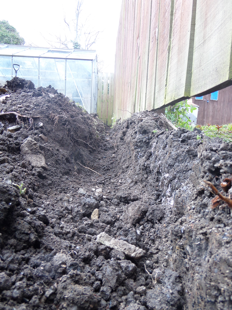

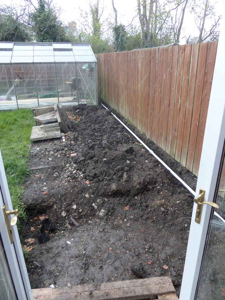

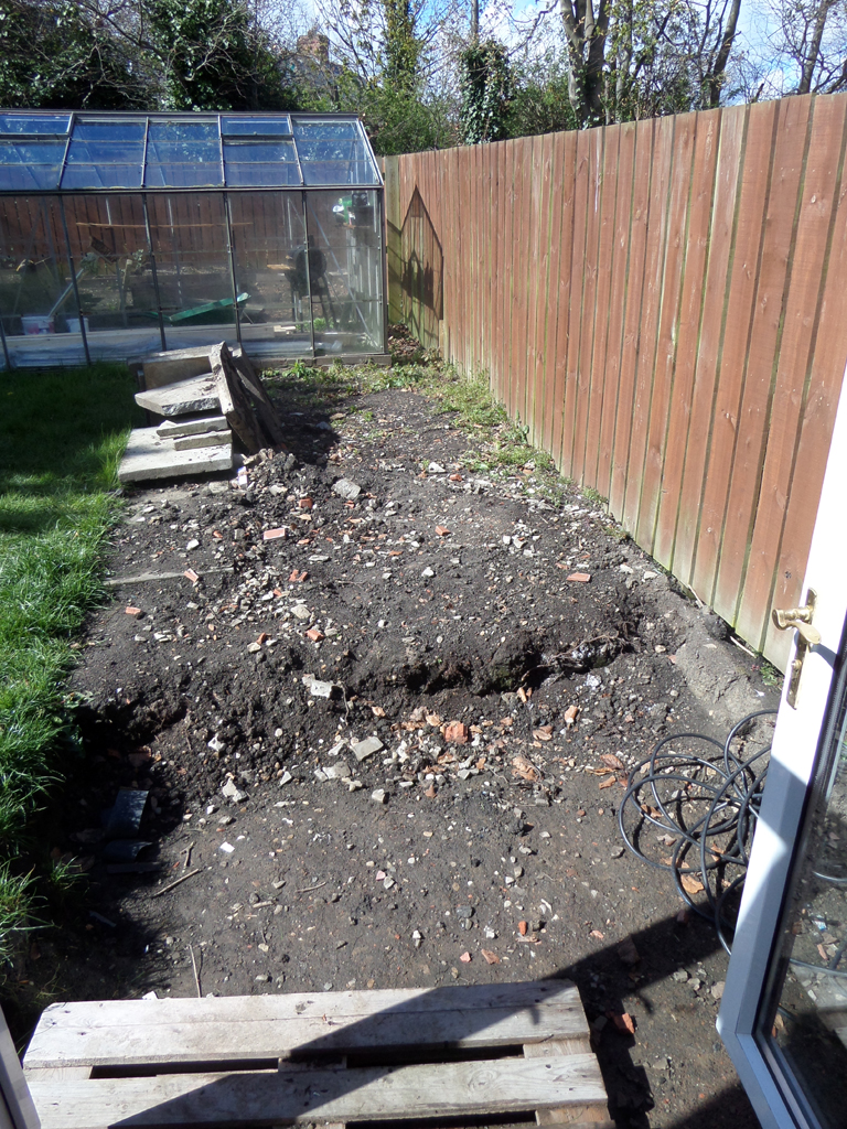

Post by stevenfitch » Sat Apr 30, 2016 1:30 pm
Trench digging weather returned this morning...
Mains power for an outdoor socket in the rear of the garden (yes its armored cable, yes its got an RCD etc etc)
Running alongside some 40mm waste pipe to carry a bunch of multicore and data cables to the back of the garden. This pipe will also have a draw string for future use and possible some of the compressed air lines for points / signals.
Before.
During.
Hail stones.

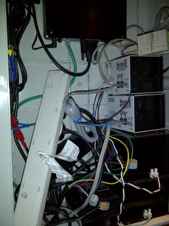

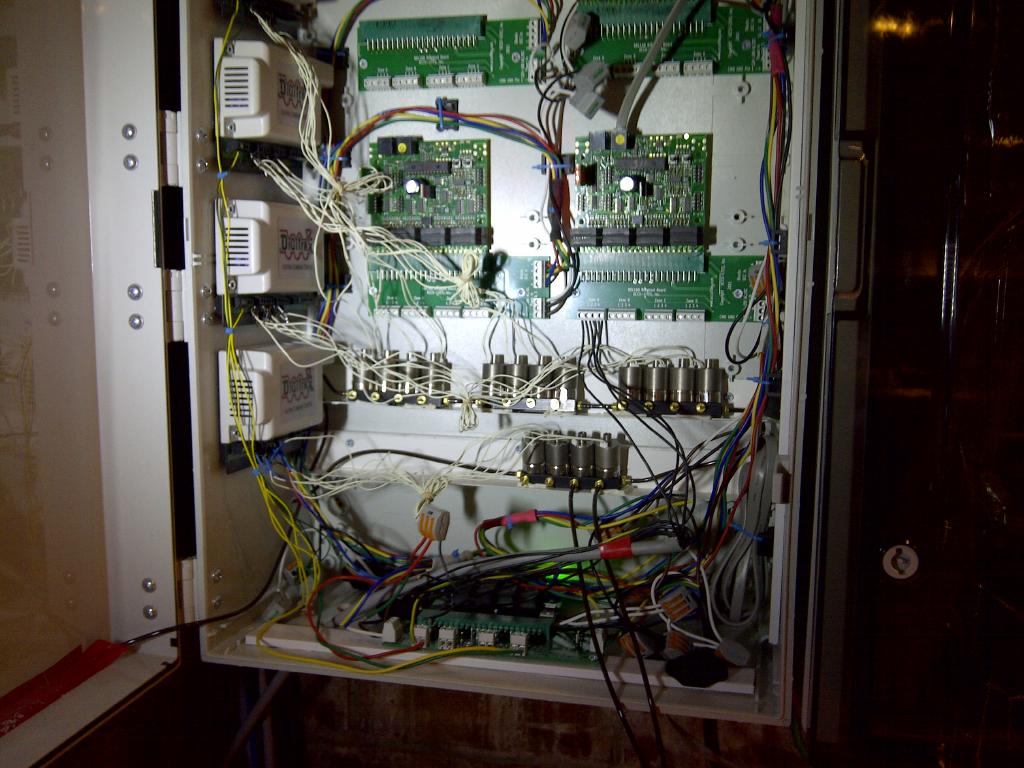

Some more wiring and control gear
Post by stevenfitch » Sat May 14, 2016 2:34 am
This is pretty much done now.
The cabinet with all the power and the computer.
(its a bit more tidy than this picture now)
The cabinet with the detection and point control gear, 16 solenoid valves for the air operated points in the middle operated by the 4 x Digitrax DS64's on the left hand side.

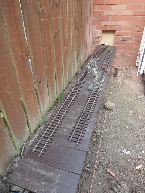

and some progress outside!
Post by stevenfitch » Sat May 14, 2016 3:14 am
The ladder rack to take a double track on top.
Construction includes brown electrical trunking / conduit along the sides of the 'ladder' to carry the air lines and any cables for that local area (The cables which run to the back of the garden are already buried and surface into a weatherproof junction box)
Posts: 5713
Re: Some more wiring and control gear
Post by Peter Butler » Sat May 14, 2016 11:07 am
stevenfitch:117995 wrote:
Oh!!!!! so much to go wrong...... I admire your technical skills but have not a clue about your installation there. Do BR know about you?
stevenfitch
Posts: 223
Post by stevenfitch » Sat May 14, 2016 12:38 pm
That's nothing compared to what my (indoor) N Gauge used to be like! As long as you keep the bare wires covered it actually all works without many issues.
On wiring, those 'Wago' connectors are brilliant compared to your normal screw terminal connector blocks. Available from Screwfix & RS Components
http://global.wago.com/en/products/prod ... /index.jsp

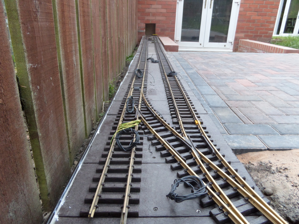

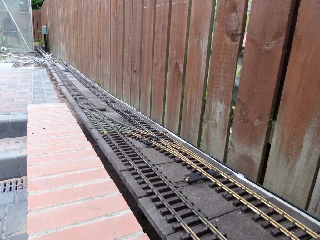

Post by stevenfitch » Fri Jun 03, 2016 9:00 pm
Progress can now continue as the paving is completed
