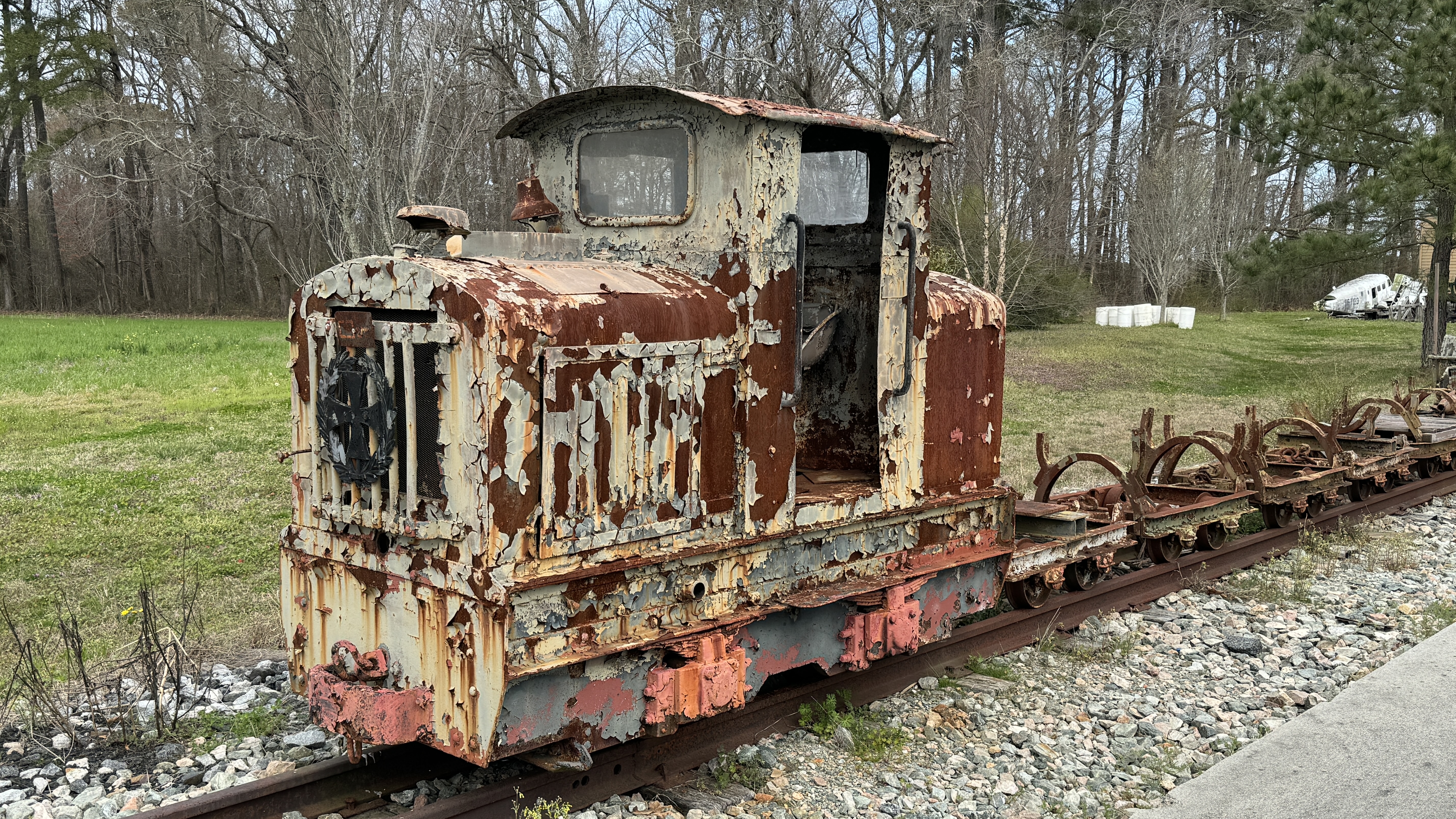

philipy wrote: Wed Mar 13, 2024 12:43 pm I'm fairly happy with the overall proportions, but I've been a bit bothered about the actual dimensions and I've juggled them around several times. I even tried to make contact with the museum to ask, but there has been no response at all, which was a bit disappointing. Anyway I think I've settled on the final version ( till next time!).
Back earlier in the month I said that I'd had no reponse from the museum re dimensions, but that was very unfair, I did get a very helpful response which promptly went straight in my junk folder and I've only found by accident this morning! I have of course apologised to them for not acknowledging it. :oops:
I'm actually quite chuffed with my scaling of the original photo because, allowing for the inch measurements he sent, converting to mm and then scaling to 16mil:
The overall buffer beam width should be 64mm and I've got it at 63mm,
The door height should be 67.5 and mine is 68.5.
The door width is a bit out - it should be 26.75 and I have it at 30mm.
Overall, I think that isn't too bad. :D
However, he also sent me a couple of pictures, which I hadn't asked for, and one is a better view of the inside of the cab and I can see where the extra 3.25 on the door width is. The seat appears to be actually fixed to the back wall of the cab, whereas I have it about 3mm clear. Also, because the seat is fixed to the back wall, there doesn't seem to be any sign of the two back legs that I thought I could see on the original pictures! I'm too far along now to make any changes just for those little details, unfortunately, but it won't affect the overall appearnce too much.
The poor loco has been sadly neglected since the museum received it and is in a terrible state now, which is a shame. He said it was never properly primed last time it was painted and has just been left exposed to the sea air.

Posted: Tue Mar 26, 2024 10:01 am
by Phil.P
Now there is a challenge for the weathering experts!
A little sad, when the custodians of heritage let it rot, but I suppose there is only some much time, money, and man-hours?

Posted: Tue Mar 26, 2024 10:09 am
by -steves-
Such a shame :oops:

Posted: Tue Mar 26, 2024 11:03 am
Phil.P wrote: Tue Mar 26, 2024 10:01 am Now there is a challenge for the weathering experts!
All true, plus, I suspect, being basically an aircraft museum, they aren't overly bothered about an old German diesel loco. He did also say "Hopefully it ends up on the restoration list at some point!" :dontknow:

Posted: Tue Mar 26, 2024 11:43 am
Wow. That is a sorry spectacle. You did amazingly well on those dimensions, Philip. My model is more of a compromise as I had to make it fit the HGLW chassis and cab.

Firstly, my normal fixation about colour, isn't too much of a prob this time. :lol: :lol: I have 4 choices:
Lightish grey and rust, as per the original picture,
Heavy rust and an assortment of other colours as per the latest picture,
or take it back to its original WW2 colour, which gives me two choices. As far as I can make out, Luftwaffe ground vehicles were painted a very dark blue/black up until 1943 and then the colour changed to a dark greenish black after that.
Nowhere can I find any specific reference to the light grey with red trimmings, so I wonder if that was a post-war repaint to disguise it's military origins? - As we all know, "Continental" railways were very fond of painting wheels etc red. :lol: However, Vallejo specifically do both of those wartime colours. Looking at the original loco picture, at the bottom of the frames is a dark/black area, which could be black or it could be the dark blue/black of the early period, so with nothing else to go by, thats what I'm going for.

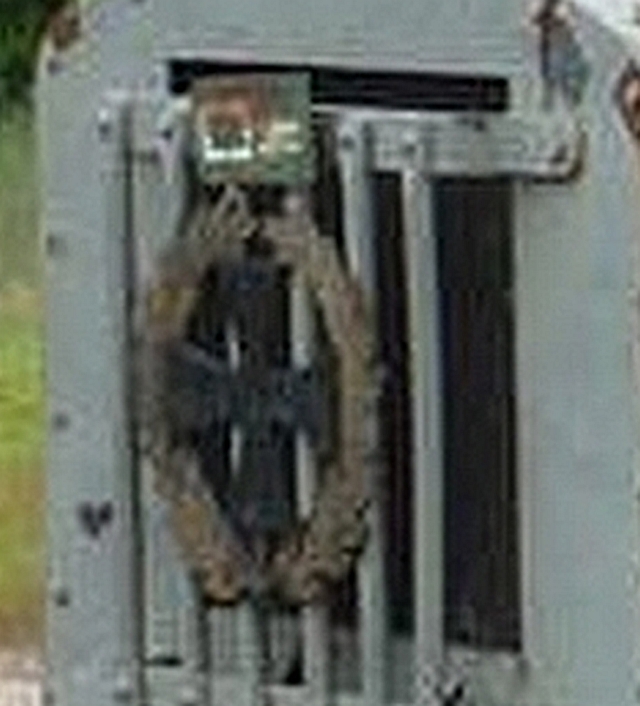

Next, a question for anyone who knows or wants to guess. The front of the loco is clearly wearing and an 'iron cross' surrounded by a wreath of leaves, and above it is a small rectangle which looks to have a picture/photo on it.
Any offers as to what it is? I'm tempted to think that it is a memorial of some sort, but it seems a very odd place to put a memorial

Looks like this, maybe? I've not found the significance of the oak leaf wreath

I'd not seen that specific pic, but there are loads of variations on the theme. It's the little plaque and apparent picture that puzzle me. TBH, I don't really want to put it on unless there is a good reason to, and I suspect that this is maybe referring to a wartime death somehow associated with this particular loco - a "Hero of the Reich" type thingy?

It's an iron cross and a laurel wreath, so it might be a memorial or a symbol of the locomotive's use. Searching "Eisernes Kreuz im Kranz" yielded similar results:
https://www.akpool.de/ansichtskarten/27 ... ichenkranz
Also, https://www.alamy.com/war-memorial-of-t ... 70378.html
Most wreathed iron crosses I've seen are either oak or half oak and half laurel, so it's interesting that the one on the loco is all laurel. The oak is a symbol of strength and longevity and closely connected with Germany.
As for the plaque above it, my best guess is a number plate unrelated to the cross and wreath. They don't seem connected at all in the clearer photo, and here's another Gmeinder with a number plate mounted in that location:
https://freundeskreis-feldbahn.de/freun ... inder.html

Thanks Drew.
I've seen them with 1914 on as well.
Unless somebody can advise differently, I think I'm going to forget about it. I can't believe it was a standard fitting!

Posted: Thu Mar 28, 2024 9:14 am
by Phil.P
I don't think it was standard, and may be considered as a step too far, in authenticity?
I think I would leave it off.

Posted: Thu Mar 28, 2024 12:33 pm
by drewzero1
philipy wrote: Thu Mar 28, 2024 9:04 am Thanks Drew.
I've seen a lot of Gmeinders at this point and only this one has it... Unless you're attempting to recreate this particular display, leaving it off seems appropriate. :thumbup:

Posted: Sat Mar 30, 2024 1:10 pm
Iron Cross & Wreath...gone, from the to-do list!
