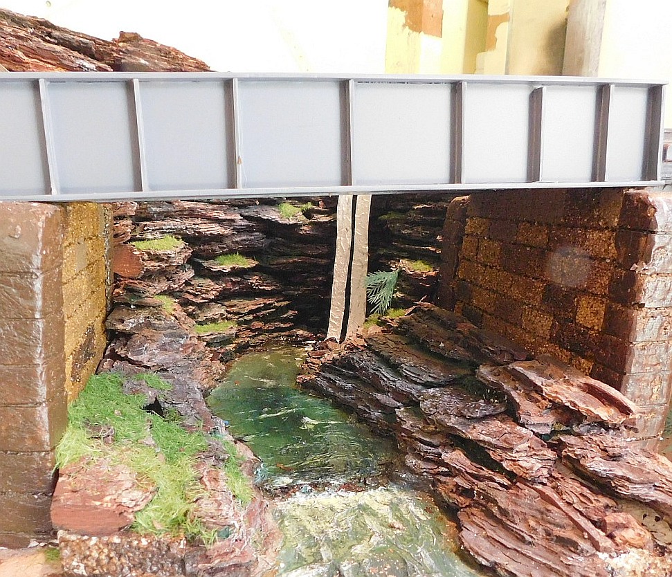

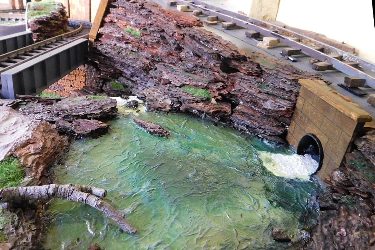

Scenery progresses slowly on the line, with a 'lake' and waterfall and river gorge complete. Some track ballasting done too.
Here's a video of a 'pretend' operating session showing just the scenicked bit.
https://youtu.be/b3jd8w6tz28
and the gorge (not happy with the waterfall yet)
and lake
I still haven’t progressed on any backscene painting, but have ‘finished’ the pine bark rocky gorge, lake and waterfall. The lake is more of a pond – only 12” across and the river more a creek as it is only 3” (ie 6’) wide.
The waterfall is PVA glue poured onto clingwrap plastic, painted with thick acrylic white. The lake and river are made using marklinofsweden’s web tutorials with toilet paper and white glue over a timber base – thus giving ‘ripples’ in the water, then painted with acrylics and a couple of coats of clear polyeurethane (which I use on my house slate flooring)

- Posts: 6022
Re: A tiny G gauge indoor layout
The outfall from the culvert and the final section of rapids both look brilliant, but the two main waterfall drops don't yet 'work' to my eyes, they look too 'solid' and white. IMO you need to inject some transparency... maybe go back to using the good old 'crinkled cellophane' type base with white flecks added to taste?
Having said that, the overall effect is fabulous.

Thanks Philip. I did make some 'test' pieces using the PVA system but discarded them - now I think they look better than what I finally used.philipy wrote: Sun Mar 12, 2023 6:18 am
........ but the two main waterfall drops don't yet 'work' to my eyes, they look too 'solid' and white. IMO you need to inject some transparency... maybe go back to using the good old 'crinkled cellophane' type base with white flecks added to taste?
Cellophane is an idea. And I just noticed the opaque corn flakes 'bag' might be good too.
First problem is how to remove the existing waterfalls.

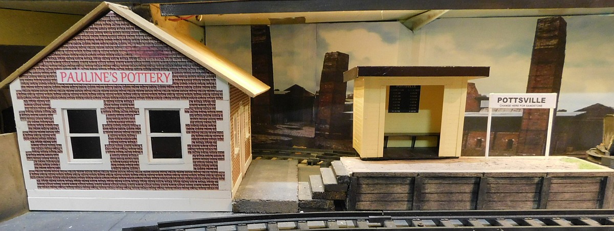

Meanwhile, after much experimentation I have got a backscene for the pottery works at Pottsville. And I have made an office building and a new station waiting shed.
The pottery scene is a picture, much repeated, and stretched - four A4 sheets in portrait as only 220mm high under the shelf. I will build a 'real' chimney where that shelf support is behind the loco, to hide it.
This scene has the station building removed to give a better view of the scene.
This is the Pauline Pottery Office building. MDF covered with printed brickpaper (the internet is amazing for resources!), and lots of styrene. Note the backscene here was my first attempt and too small)
The waterfall is great Greg. Brilliant idea doing that, it takes the water to a different scale of view.
The building are nice too. The backdrop I feel needs altering a little bit I think, maybe make it a little taller
The fields of wheat look good, will you be joining them so the white line disappears. You may have said something about it I think...
I agree about the posts and wire, with perhaps some bits of grass or sheep wool maybe.

The scenery looks pretty good.gregh wrote: Tue Apr 04, 2023 12:00 am Fences should be just a few strands of barbed wire, but maybe a post and rail would be the ticket in front of a wheatfield. I'll try raising the scene up a bit and then add some bushes (not hedges !)
I'm not that familiar with NSWGR practice. The VR usually used wire fences along the railway reservation in country areas and only used post and rail fences on country station grounds. In the steam era there wouldn't be much long grass around, as the track gangs regularly burnt off any fuel build up before summer.
In livestock country any grass, bushes and trees within reach near the boundary fence would be grazed/browsed back by the stock. Even if the paddock was empty, you could always tell from the distinctive way the trees were browsed if there were cattle around.
You'll also need to work out how far this pottery is from Sydney, so you can get the right no. on the Griffiths Tea sign......

Thanks for the ideas. Not sure what you mean by taller. The 3rd (ie last) pic above has the old smaller chimneys etc, but the 1st two have the final size. The scene can't be any taller because of the shelf above.FWLR wrote: Tue Apr 04, 2023 6:51 am .........The backdrop I feel needs altering a little bit I think, maybe make it a little taller
The fields of wheat look good, will you be joining them so the white line disappears. You may have said something about it I think...I agree about the posts and wire, with perhaps some bits of grass or sheep wool maybe.
Yes the white line in the wheatfield will go - this is just a test piece held up with blue tack, till I try manipulating the pic some more.
This pic is what I will try printing next next. Maybe the fence will be printed or maybe real posts and real wire

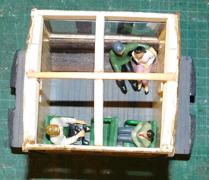

I saw a picture of a tiny passenger carriage, which immediately said “I need one” for my indoor line. It was in this Topic Yr Hen Felin & Yr Orsaf Newydd by gilfachphil.
https://gardenrails.org/viewtopic.php?f ... &start=120
so thanks to you and Plateway Models for the inspiration!

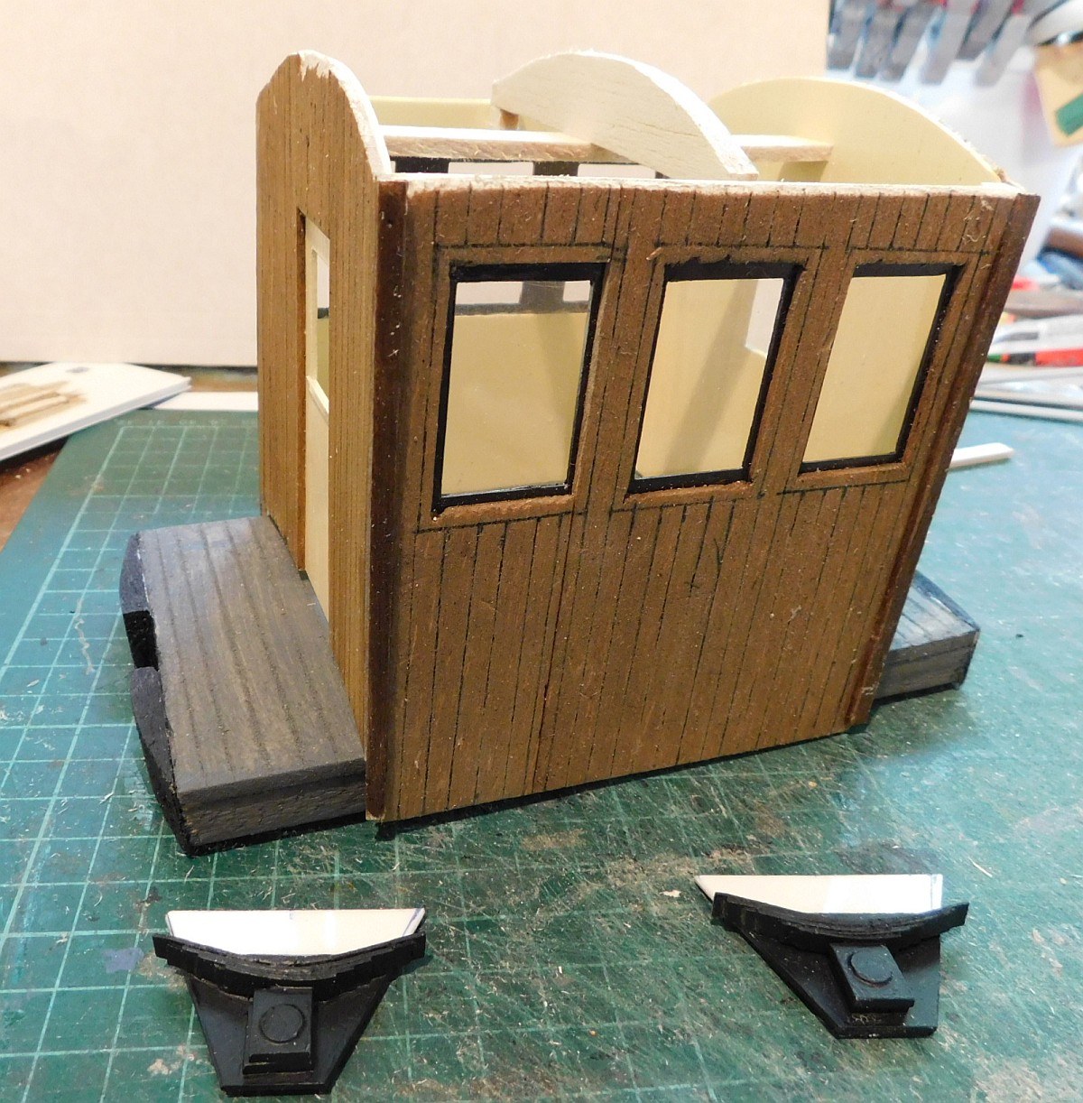

It’s been a while since I scratchbuilt anything and I seem to have ‘lost my touch’, but finally I have completed it. (Not to my complete satisfaction, but good enough.)
I built my standard frame from 8mm thick pine and 3mm MDF floor. I decided to build the passenger compartment separately to ‘slip on’ to the base.
I made the carriage from a laminate of styrene sheet and balsa on the outside – a big mistake as the contact adhesive I used caused the ends and sides to warp. So lots of bracing was used!
There is 1st and 2nd class seating
So it’s finally complete and had its first revenue run from Pottsville to Claymine.
And the video. https://www.youtube.com/watch?v=h1CIK_pZYvc
Notice the new backscenes too – more on that soon.
