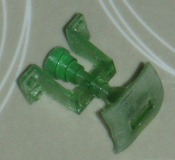

Well it's drawn up and I think is pretty close to the drawings /pictures. Getting the double curve on the face was abit ofa mare though! Also the helical spring... it is possible in Sketchup but I decided the learning curve was too steep for what it is. I'll print them without the link, obviously.

Would it be possible to print a hexagonal recess, in the base of the 'cone', with a hole at the back?
You could fit a bolt, a threaded spacer behind, and then a spring and washer/nut.
Hey-presto! A sprung link and pin coupling..
Or would it be just too fragile to be practical?

Certainly possible to draw and print, Phil. Not sure about the strength though. The diameter of the cone at the small end is 2.5mm and the diameter of the shank to the head is also 2.5mm, all as drawn, ( but could be a wee bit flexible I guess).
That means that your rod would need to be only about 1.5 dia to allow enough 'meat' around it and that might look bit skinny where it is visible.
It's an interesting thought though, thanks, but I have enough on my plate atm! :lol:

philipy wrote: Fri Oct 14, 2022 1:42 pm Also the helical spring... it is possible in Sketchup but I decided the learning curve was too steep for what it is. I'll print them without the link, obviously.
The technical term for that type of spring is a volute spring. Used a bit in railway work, such as buffers, as they have a longer compression range than a garden variety helical coil spring, due to the coils telescoping, instead of just closing up.
In this size, you could get a reasonable simulation by stacking four cylinders of decreasing size. Once it's painted dirty black it won't be obvious it isn't really a volute.
I suppose you aren't planning on pulling heavy loads with this thing, so plastic might be strong enough.

I tried stacking decreasing cylinders, but it just didn't look right which was why I originally settled for a simple cone. However your comment prodded me to think about it again and I realised that a set of decreasing cylinders with angled joins would look much closer to the real thing, and this is the result:
Screenshot 2022-10-15 11.05.56.png (28.68 KiB) Viewed 12404 times
It looks fine from the top but the apparent twist goes the wrong way underneath, of course, but thatdoesn't really matter, and it can't be seen from the sides. Don't know how well it will print, but will find that out later this afternoon.!

ge_rik wrote: Sat Oct 15, 2022 7:42 pm I hope it prints OK
It seems to have done. I haven't had chance to clean all the supports off yet but it looks pretty good, if I do say so myself. :) I'll try to get a pic in the morning.

Yep, I'm really pleased with the way the buffer/coupling has printed.
Graeme, the spring cone is 8mm long so I'd guess you'd be able to see it!

Wow! That has turned out well. I like the old glass bottle effect.
Re: Austro Daimler Build project
Posted: Mon Oct 17, 2022 7:45 am
ge_rik wrote: Sun Oct 16, 2022 8:55 am I like the old glass bottle effect.
Anycubic 'Tough' Translucent Green resin!
