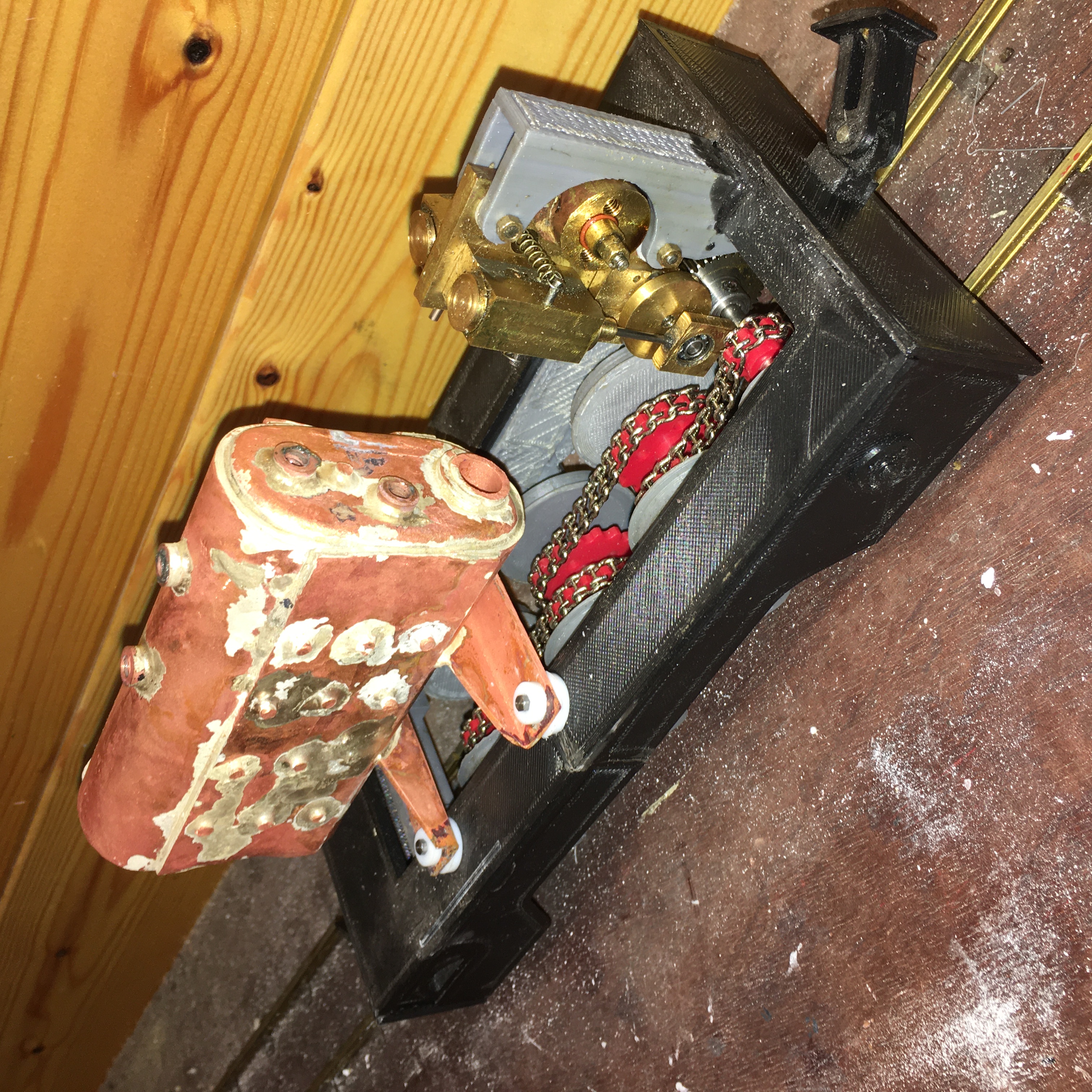

I have checked that the boiler is fit to use. This is my arrangement for checking it:
I am studiously avoiding the word "test" because it isn't an official test. The pressure gauge is not calibrated - and you can't do it yourself. But a tiny boiler like this doesn't need an official test (in the UK anyway).
So I have filled the boiler with water blocked off all the bushes except one and fitted the rig to the boiler. Pump it up to 5 bar in this case and shut the valve to isolate the pump from the piping (to avoid the slight leakage back through the pump).
The first time I did it was disappointing - a drip from one stay and a jet from another. So it was all dismantled and drained before re-soldering the offending stays.
The second attempt was much better. It retained 4.5 bar (about 75psi ish) for 5 minutes, with slight leakage from the thread connecting the pipework to the boiler.
I think that will work fine on 30psi - which is what I intend to run it at. (I don't think its fair to expect a steam motor with a simple reverser like this has to cope with more than 25 to 30 psi.

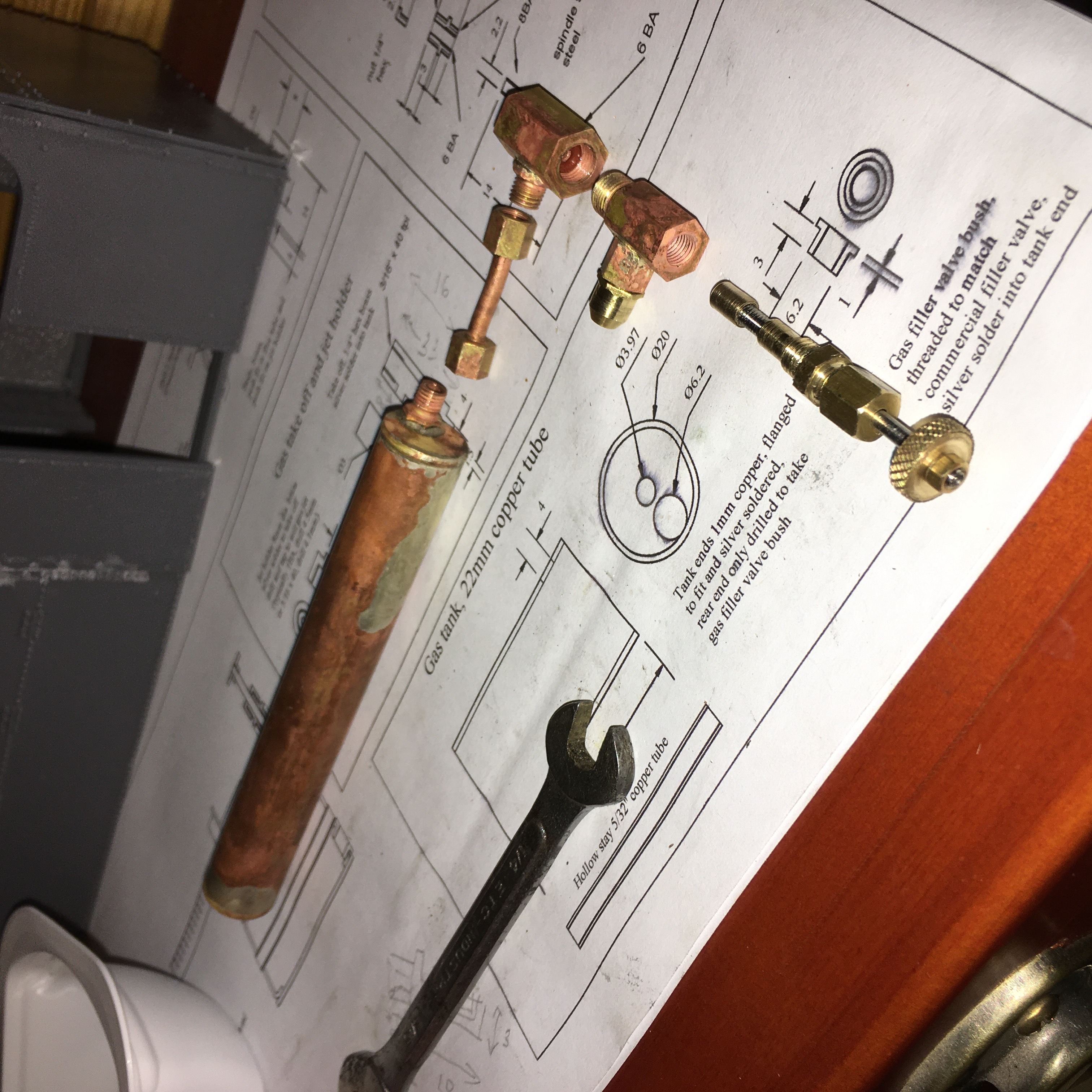

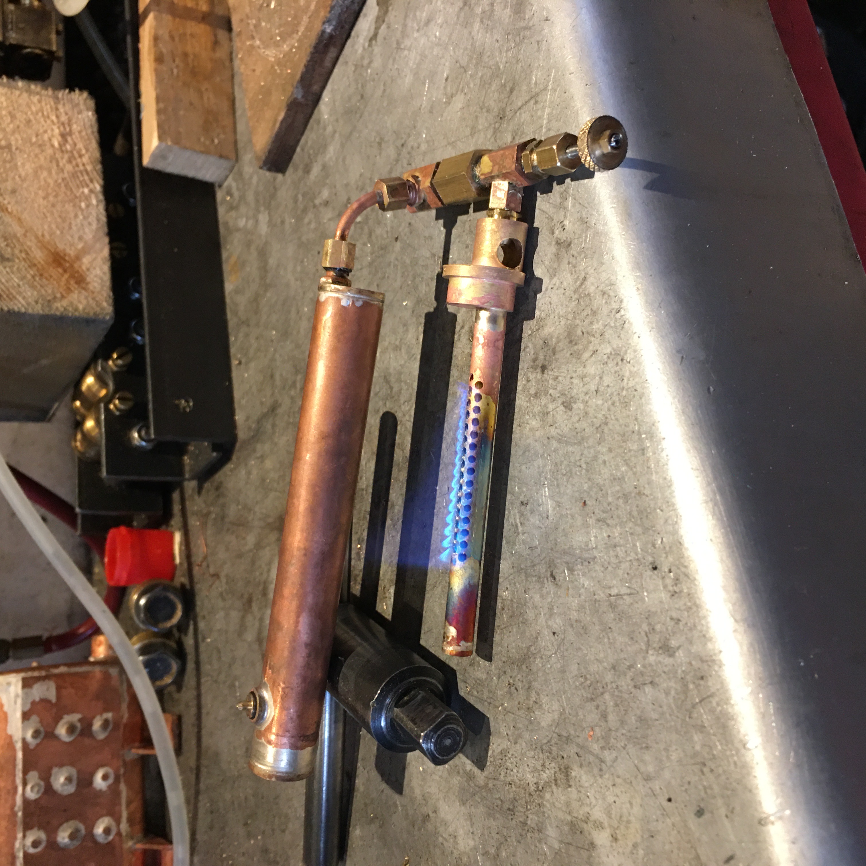

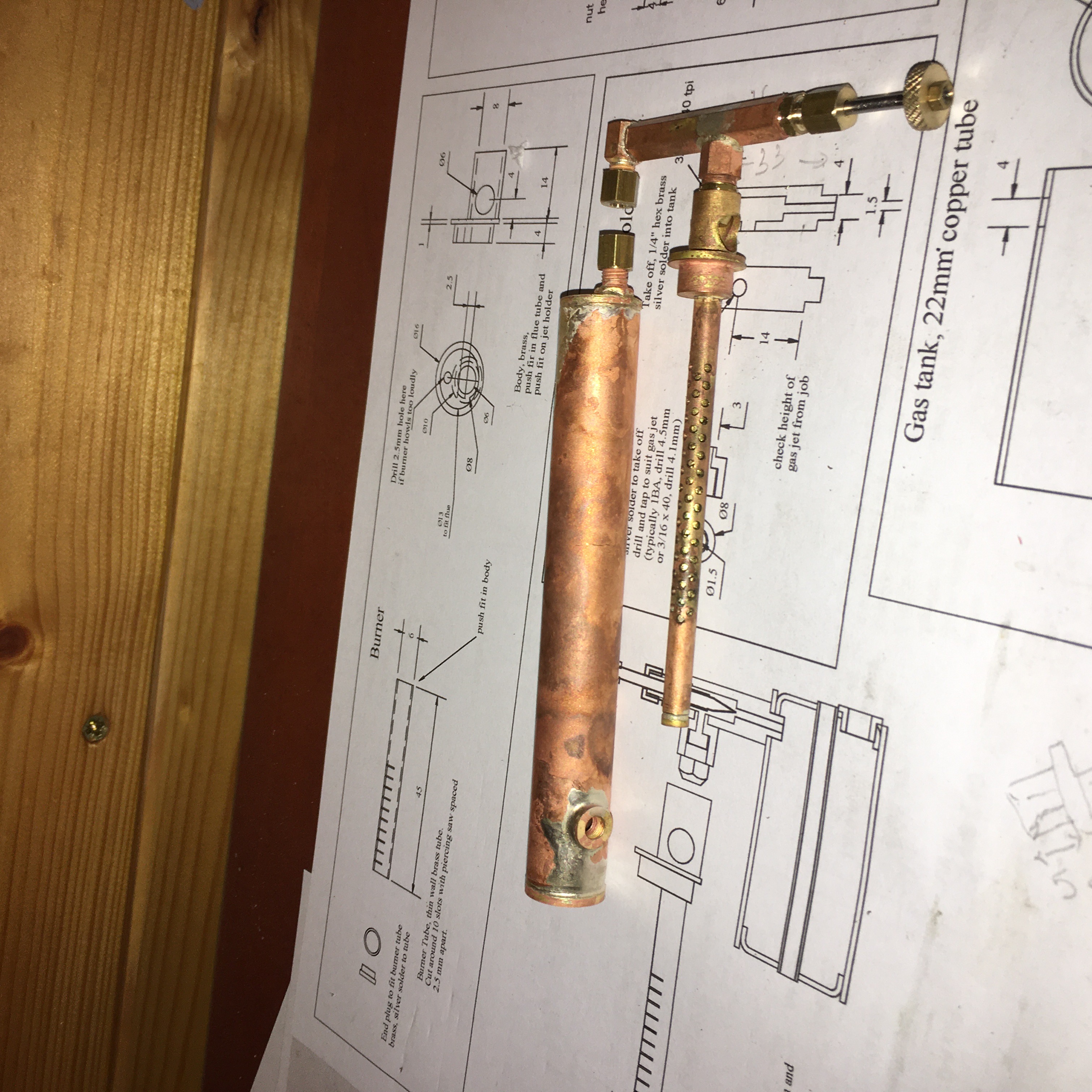

I have made the tank, control valve and burner:
It is a modification of the drawing for "Brick" from the 16mm Association website.
It works fine in the open. Nice flame pattern and blue flames. However inserted into the 12.7mm tube in the boiler and it doesn't work. The flame goes out, or it acts like a flame thrower! Tony Bird did say that he thought it was too small a tube - and of course he was right. So a bit of an adjustment. I used a stepped cutter to open out the tube, basically cutting it free at each end of the boiler and removed it. I have a 15mm diameter tube ready to silver solder into place.
So some adjustments to carry out - and this time I am sure the burner will work in place. We know 15mm tube works.

Modified burner control and:
Modified burner lit outside the boiler:
And you can just see the flames inside the boiler burner tube:
I can see on looking at this again that I put the burner into the wrong end of the boiler. It doesn't make any difference it was just a test - but you might wonder why there were bushes in the front of the boiler!
So that is a success. I will draw up the components and add them to the thread when I have it all working. On to the boiler fittings.

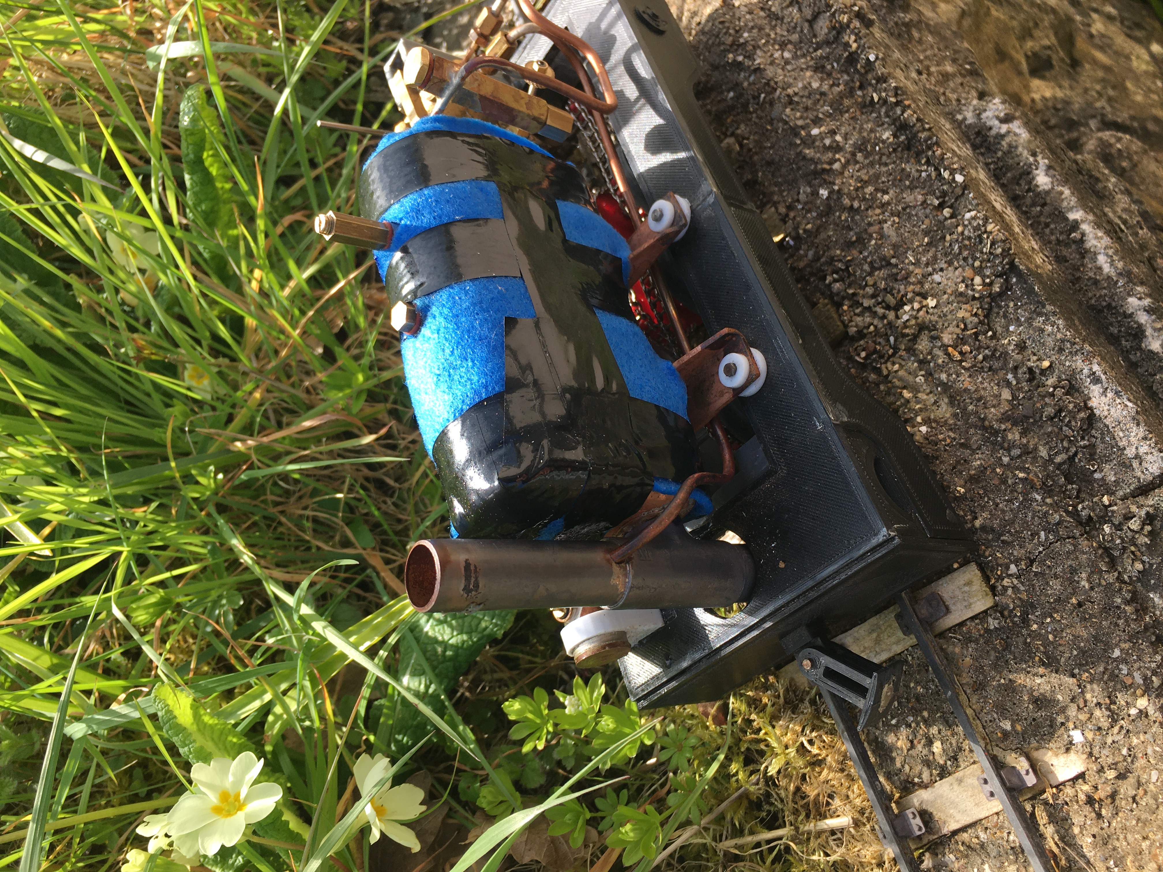

and finally the boiler has 2 layers of wool felt wrapped around it. It is just held in place with insulating tape:

Firstly more detail of areas where it got too hot. The "smokebox" consists of a 15mm copper pipe "T" piece, with a length of 15mm copper pipe extending upwards. I used a hole cutter to make a hole in the footplate underneath it. Crude but I am experimenting. When I lit the burner the flame didn't move to the burner correctly - it went down out of the bottom of the "T" piece - charring the paper covering on the bench before I smelled it. Adding a short length of pipe on the bottom leg of the "T" stopped that. Of course the front buffer beam was damaged by the flame playing on it. With the pipe on the lower end that has not reoccured. I suspect the boiler is not quite square on the footplate - because the "chimney" isn't quite central in the hole in the bodywork, and that has resulted in the exhaust pipe touching the edge of the hole it passes through. I can correct that. I will make a turned "chimney" with a smaller diameter perhaps tapered to fit into the top leg of the "T" piece. The "T" piece was only "bonded" to the flue tube in the boiler with lock tight bearing retainer. That requires over 300 degrees to make it let go and it certainly hasn't fallen off so far!
When you look at the video you may notice that the body isn't quite down on the footplate. There is a gap os 1 or 2 mm in some places. Also it isn't sitting on the footplate squarely. So some components need moving slightly. The steam supply pipe, for example, could do with being bent to clear the cab side. The gas filler is probably touching the bodywork as well. I want to make rectangular blocks to bond to the footplate so that the body just drops over the blocks which will hold the bodywork in line with the footplate. I want the body to just sit there held only by friction.
The wool insulation works on the boiler itself. Wool is naturally fire retardant. However any insulation on the "smokebox" would have to be the type used on coal fired locos - totally fireproof. It might be better to do that to avoid accidental damage.

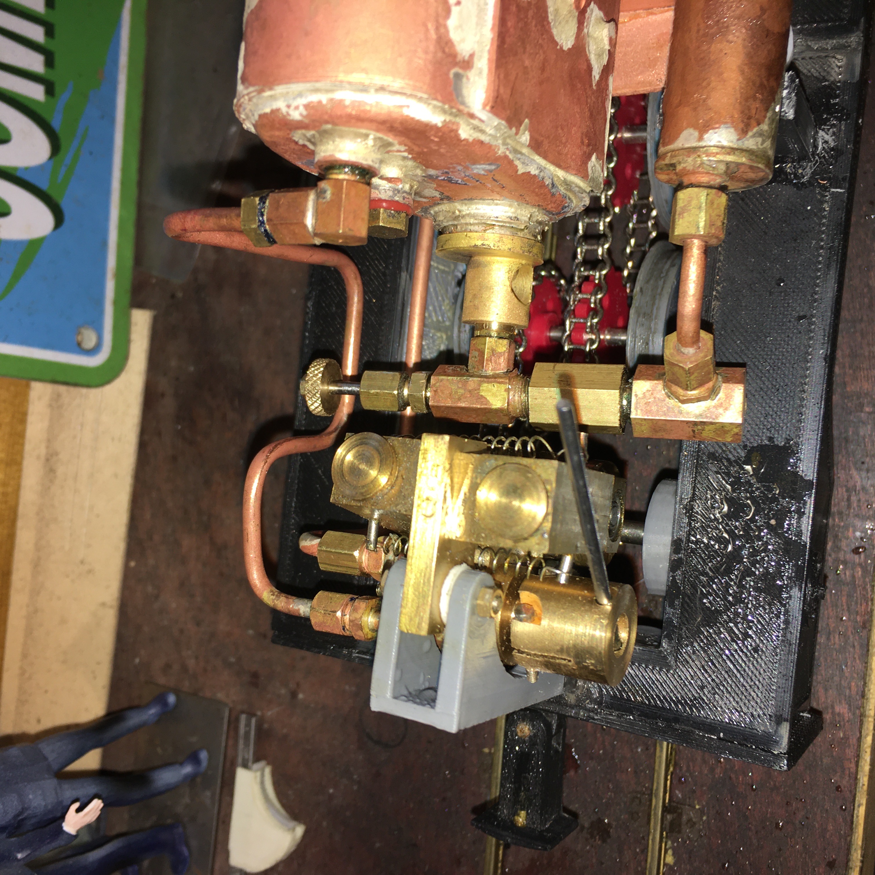

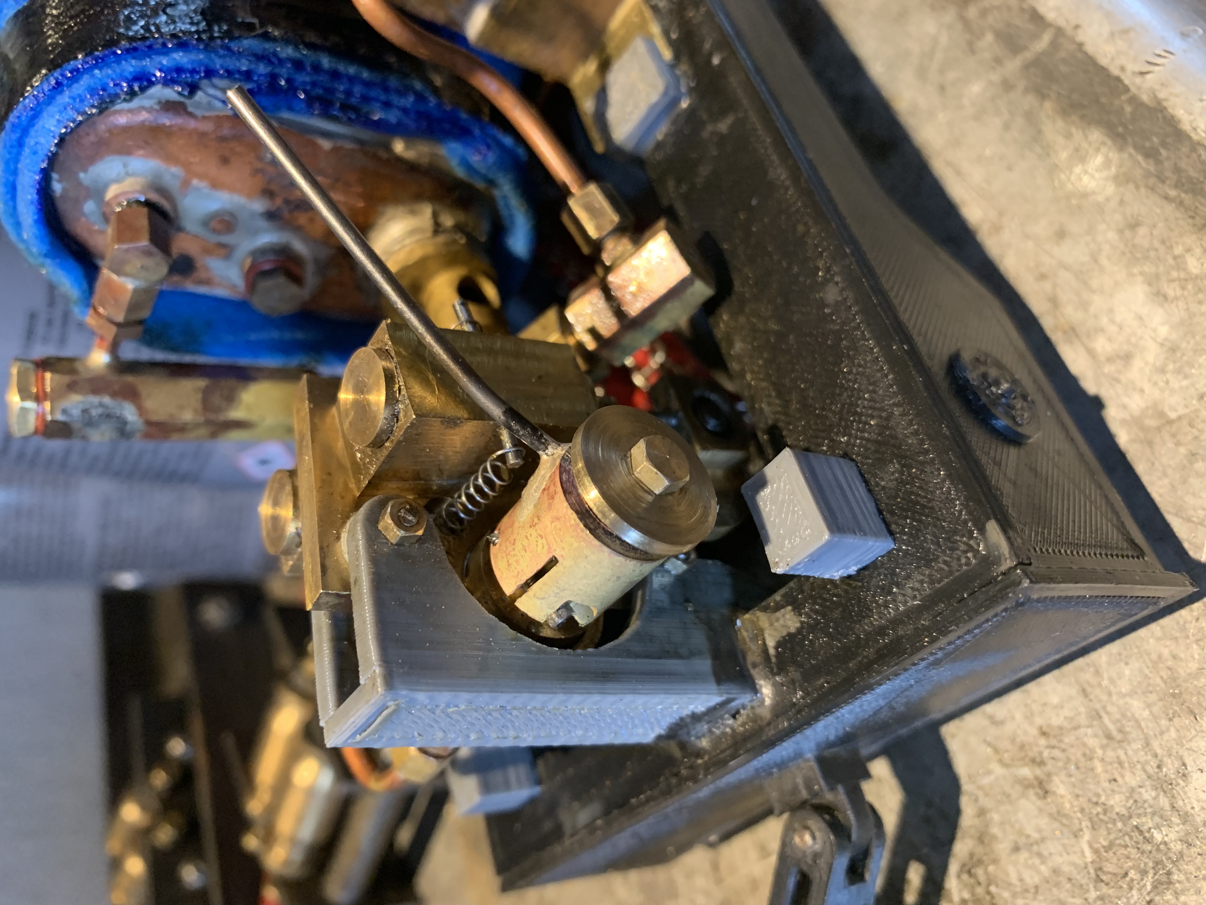

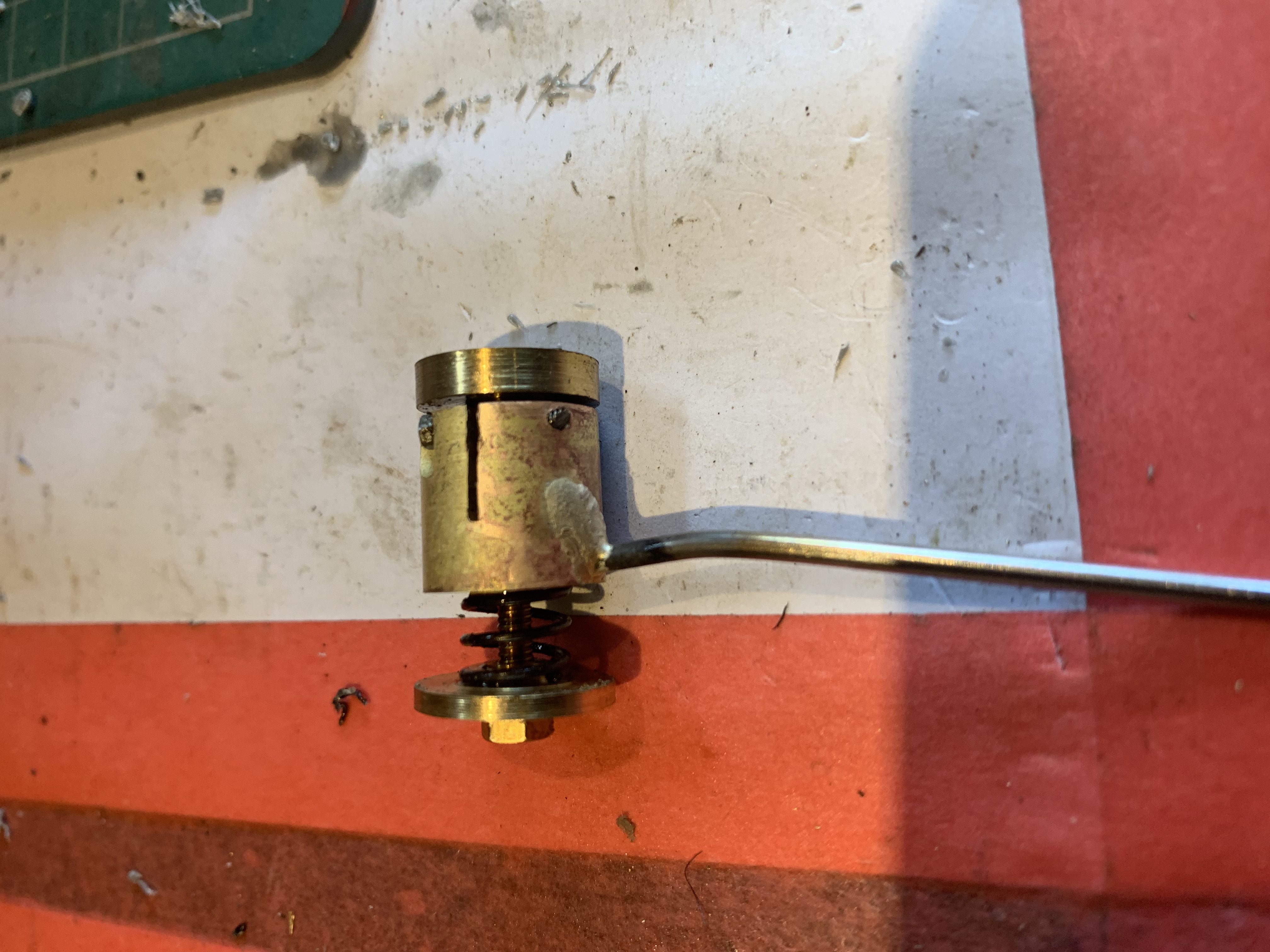

Firstly I have "fettled" the steam motor. One piston was a bit stiff in its cylinder, the cranks were hitting one of the bearings on the layshaft, and actually hitting the layshaft at the bottom of their motion. It is running more smoothly now. The reverser was leaking steam - which had the effect of limiting the steam pressure in the boiler. So I have changed the spring holding it onto the port face:
Originally the spring (an O ring) was on the back face interfering with the steam pipes. I have tapped out the hole in the centre of the port face 6BA, and drilled a clearance hole right through the reverser block. I made a washer to hold the spring and cleaned up the hollow mounting disk which holds the lever. So when assembled a much stiffer spring significantly increased the force stopping the steam escaping. When assembled:

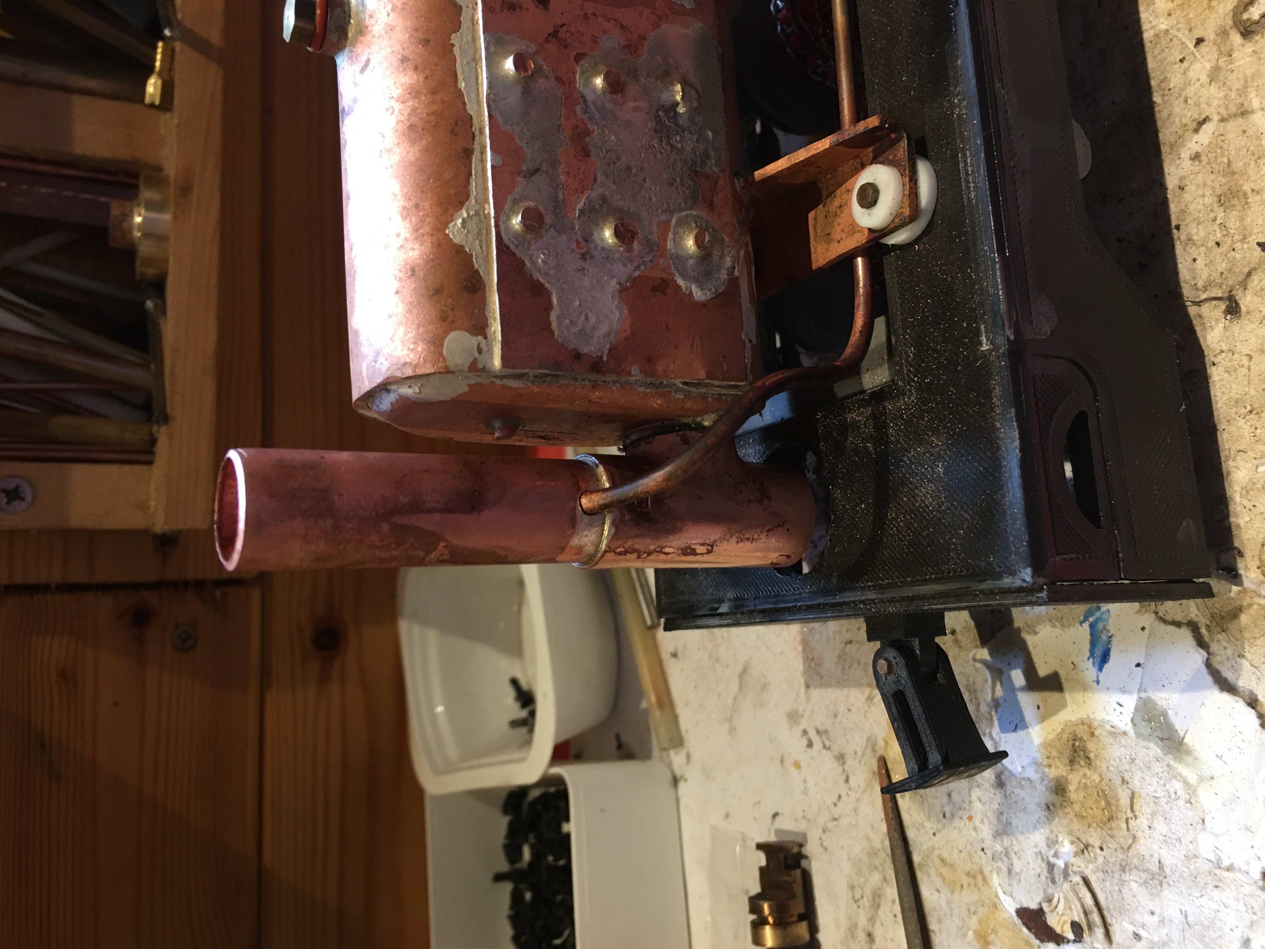

The gas tank I had made wasn't really big enough, so I started again and made one from two lengths of square section hollow brass. Run time is much improved:
You can see that there are two outward facing brackets on the bottom ends of the tank. They slide under the plastic brackets (there is a cut out in the bottom to each bracket). That holds the tank firmly yet allow it to be removed easily by sliding it sideways. That works well - I will use that idea again! In the photo you will see one error I made. The "o" ring on the gas filler valve sits on the surface of the gas filler bush. I really should have counterbored the bush when I made it so that the "O" ring is supported on the outside and it can't be forced out by the gas pressure. I was reluctant to un-solder the bush to modify it with the risk of ruining it in the process, so I counterbored it VERRY CAREFULLY in the milling machine. Thankfully that worked OK.

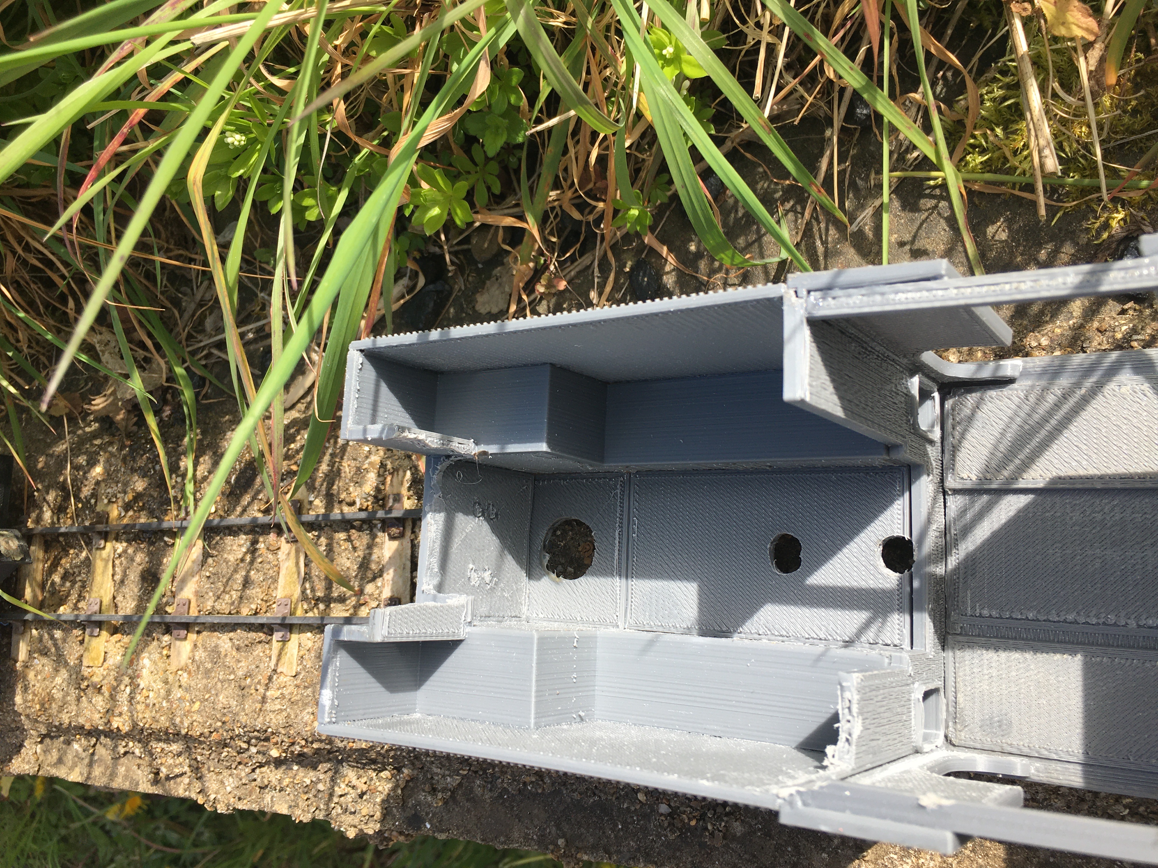

I have been running on the track a few times now with the body in place - and broadly speaking the body is withstanding the heat well. The only signs of melting are near the "smokebox", firstly where it passes through the footplate and secondly where the other end passes through the top of the body. It doesn't to it all the time - its just when I get impatient and increase the gas flow - and probably its low on water and the extra heat goes into the smokebox rather than the water.
I am going to make a different "smokebox" to reduce the diameter of the top and bottom pipes - increasing the clearance between hot metal and plastic.
At least the body as it is is just a prototype. In due course it can be remade.

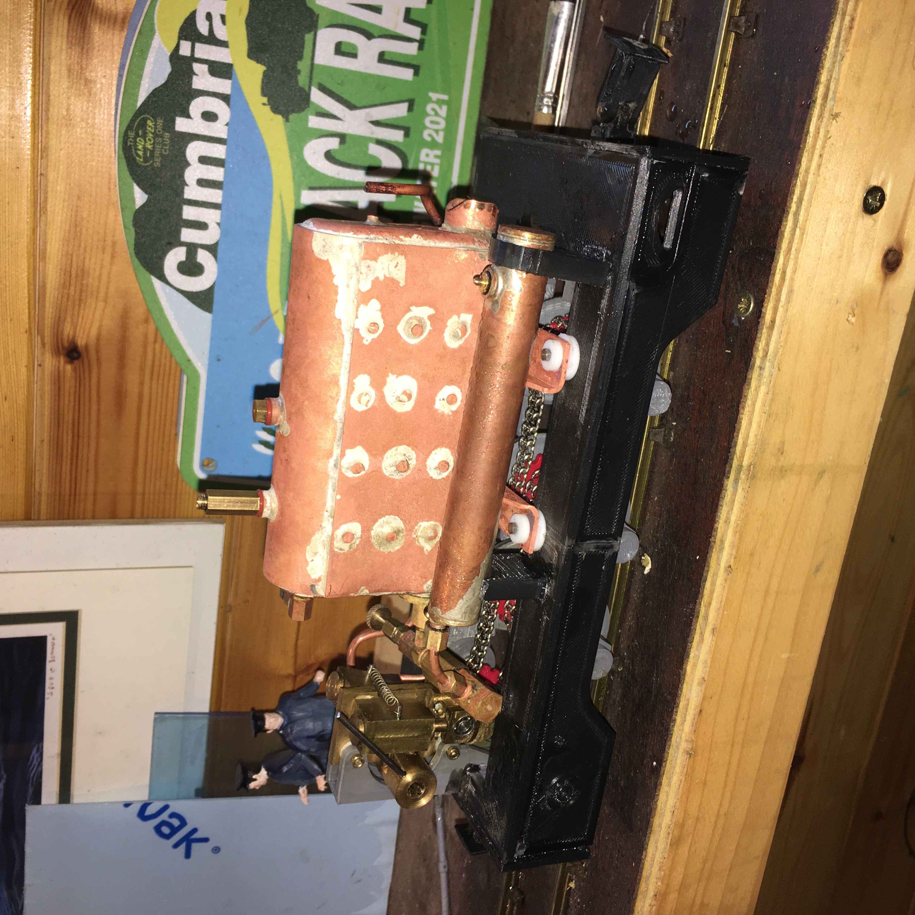

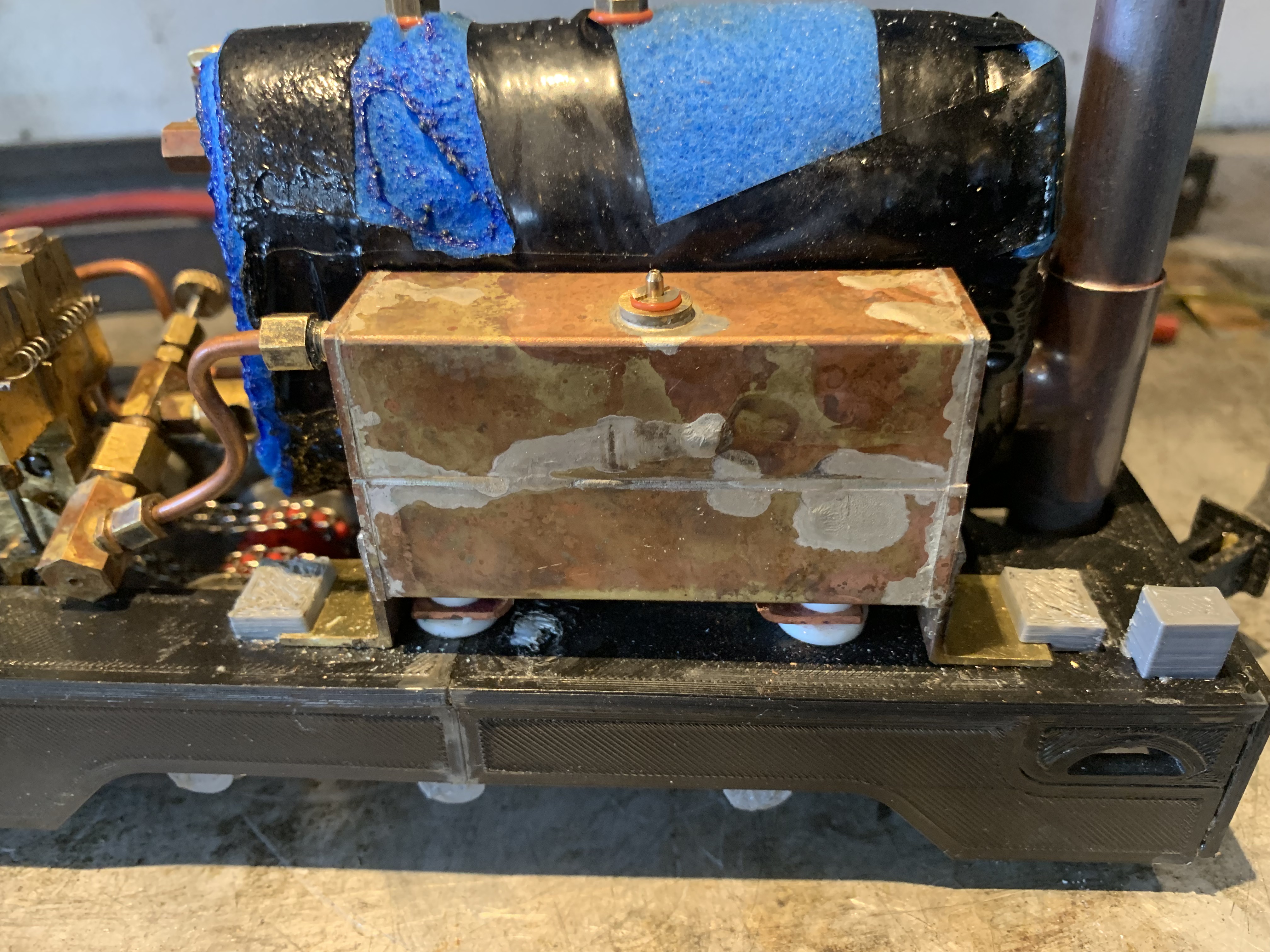

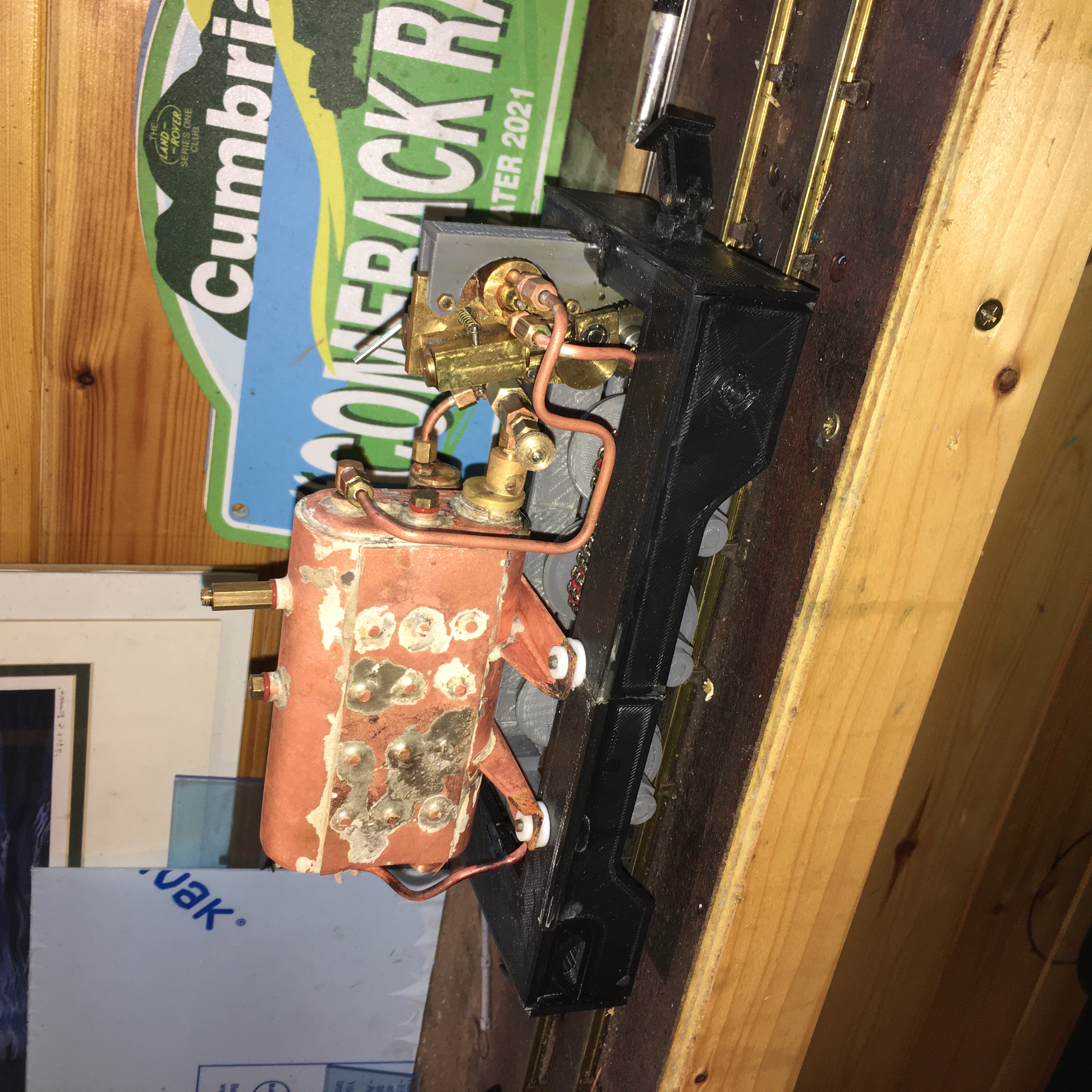

I have made a number of minor modifications to the boiler and steam system.
Firstly I have found and removed all the minor steam leaks in the fittings. I have fitted a pressure gauge, a filler valve, and a "gauge cock".
In case you haven't come across the gauge cock before - it is a valve or "cock" which Sits at the minimum water level on the front of the boiler. It has a narrow pipe running off to one side. when it is opened either steam or water will come out of the end of the pipe- depending on whether the water is higher or lower than the cock. Prince and all of the Ffestiniog early engines all had one gauge glass and a pair of gauge cocks when new. Photos in the next post.

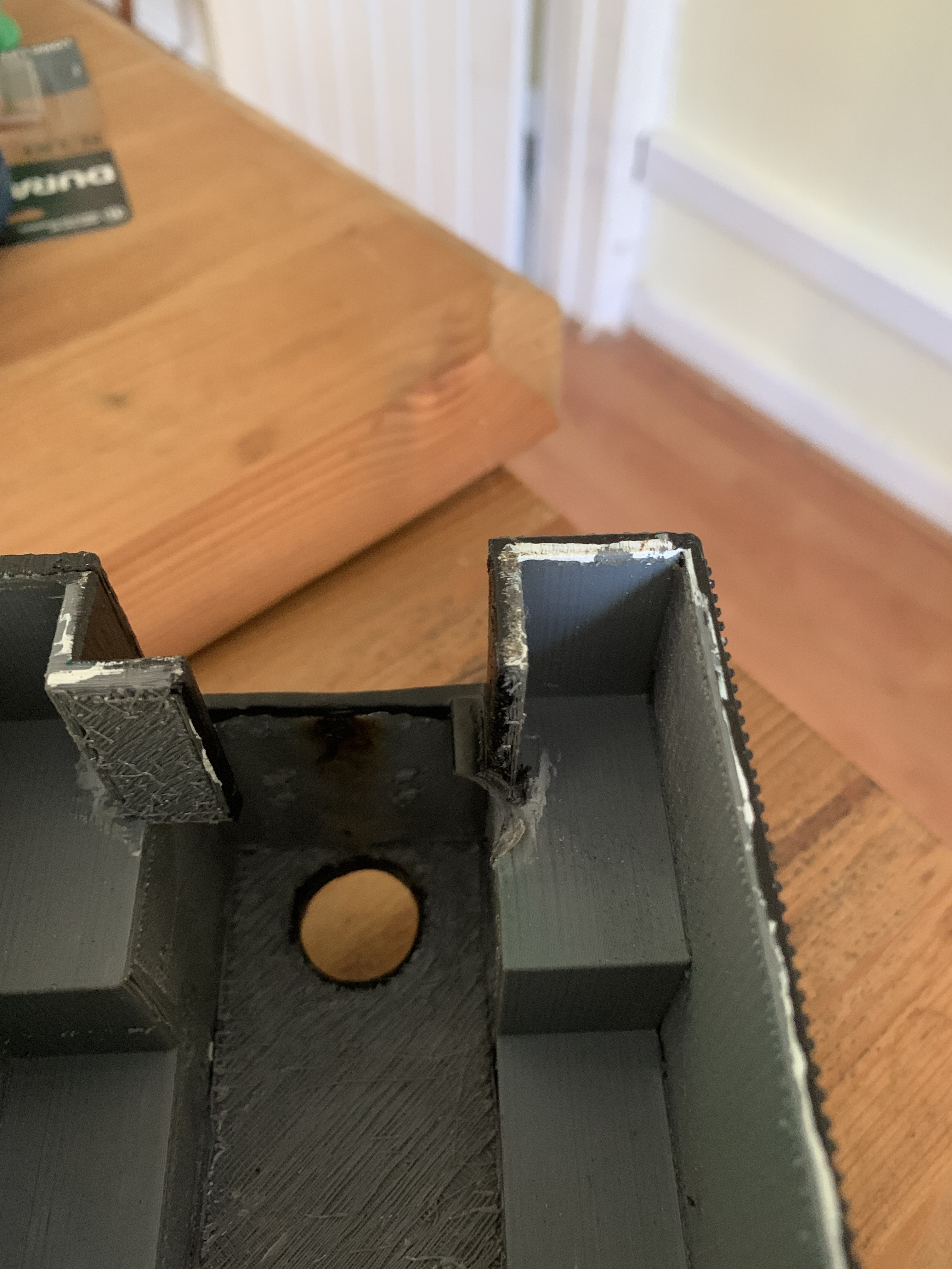

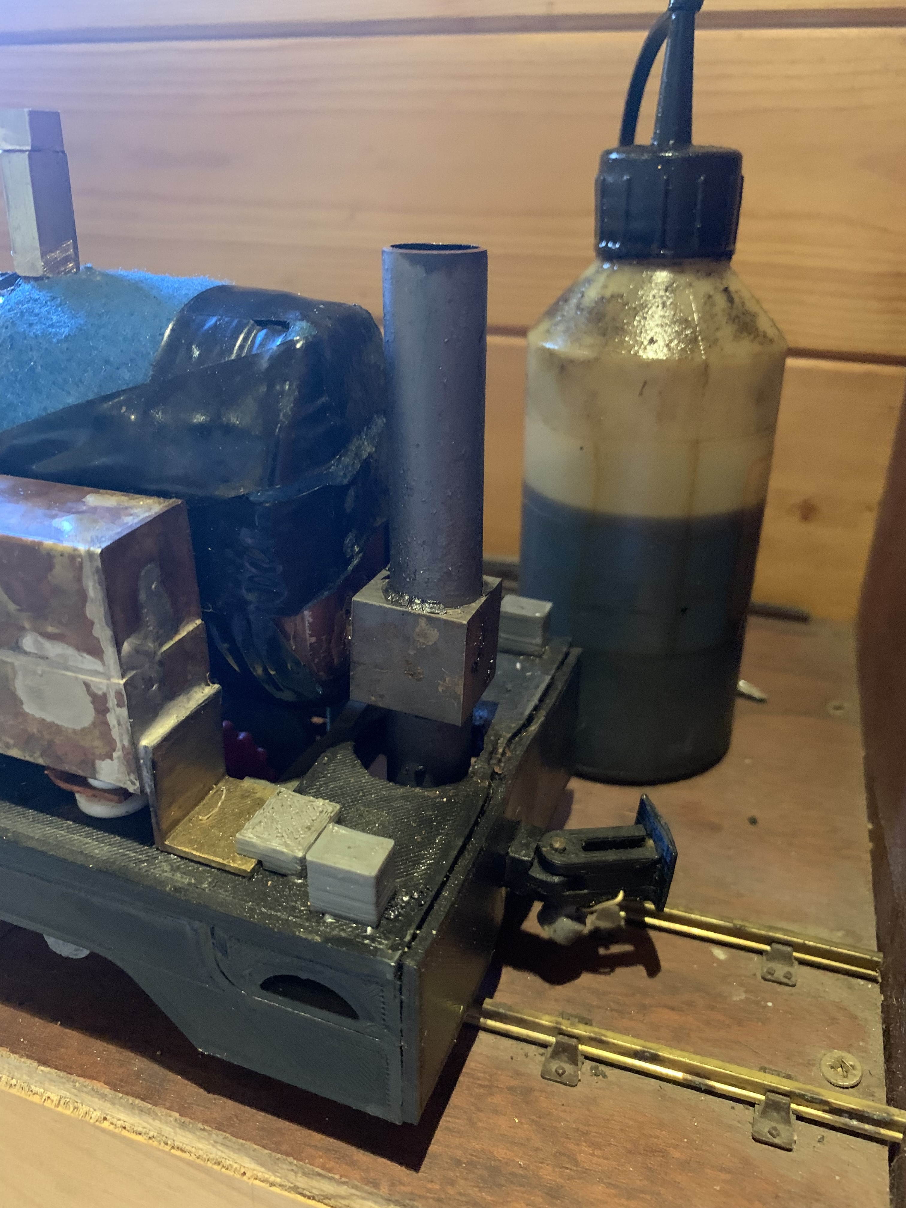

The biggest issue with heat and the plastic is around the firebox. The boiler and steam motor do not over heat the plastic. So photos of the heat damage:
You can see a black and distorted area at the front of the body - which is close to the smokebox.
You can see that the bottom of the buffer beam is distorted.
If I am honest I have been opening the gas valve too far - until the point where I can see the flame if I look down the chimney. Mondays run was the first time that I resisted the temptation, and it ran well holding steam pressure with a much lower flame. So that is part of the problem. However it is still possible for me to over open it again.

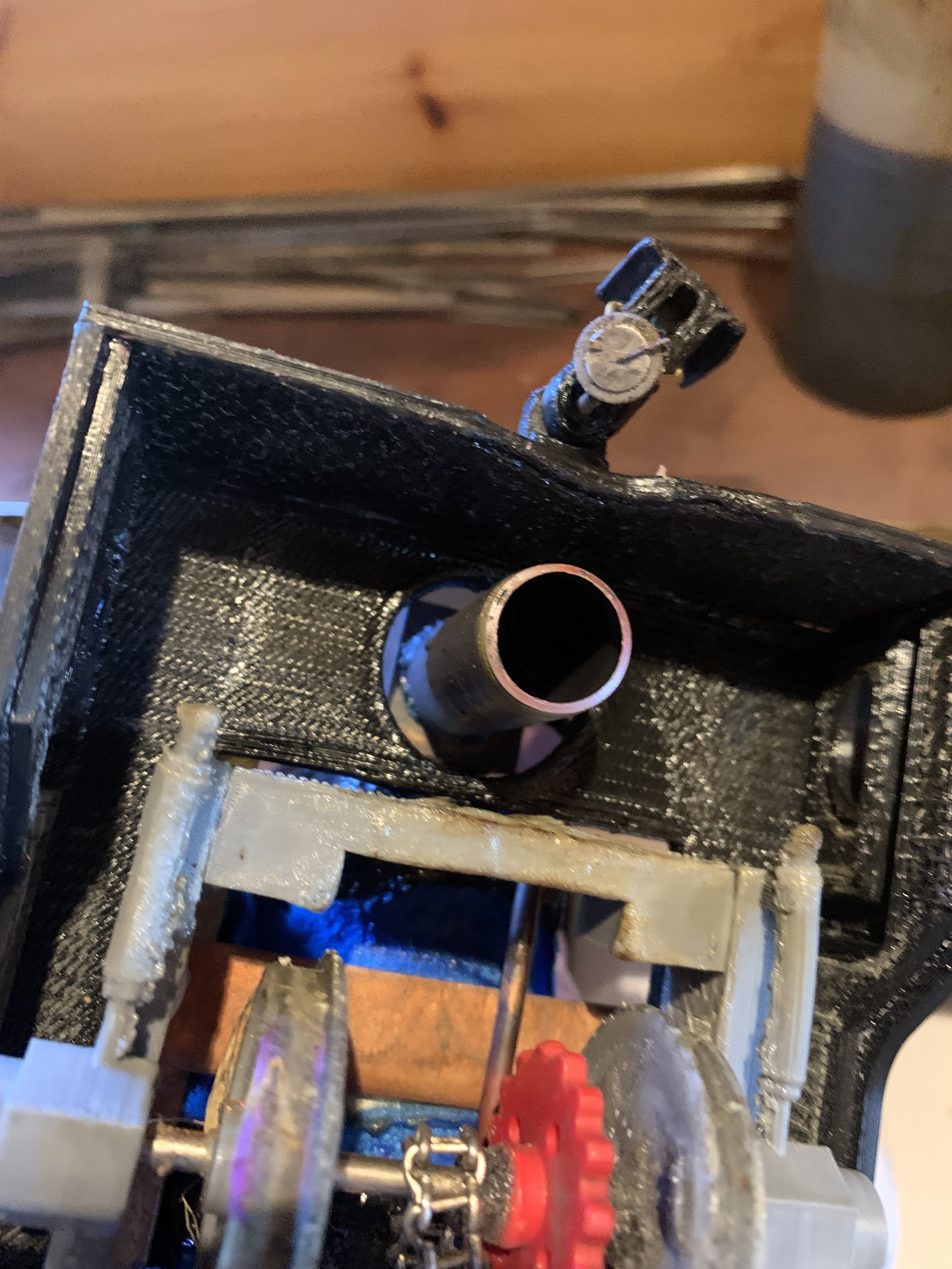

Now a photo of the current smokebox, which sits closer to the boiler than the original built around a pipe fitting:
You will see that it extends below the footplate - (all boilers with a single tube and a poker burner have open bottomed smokeboxes).
