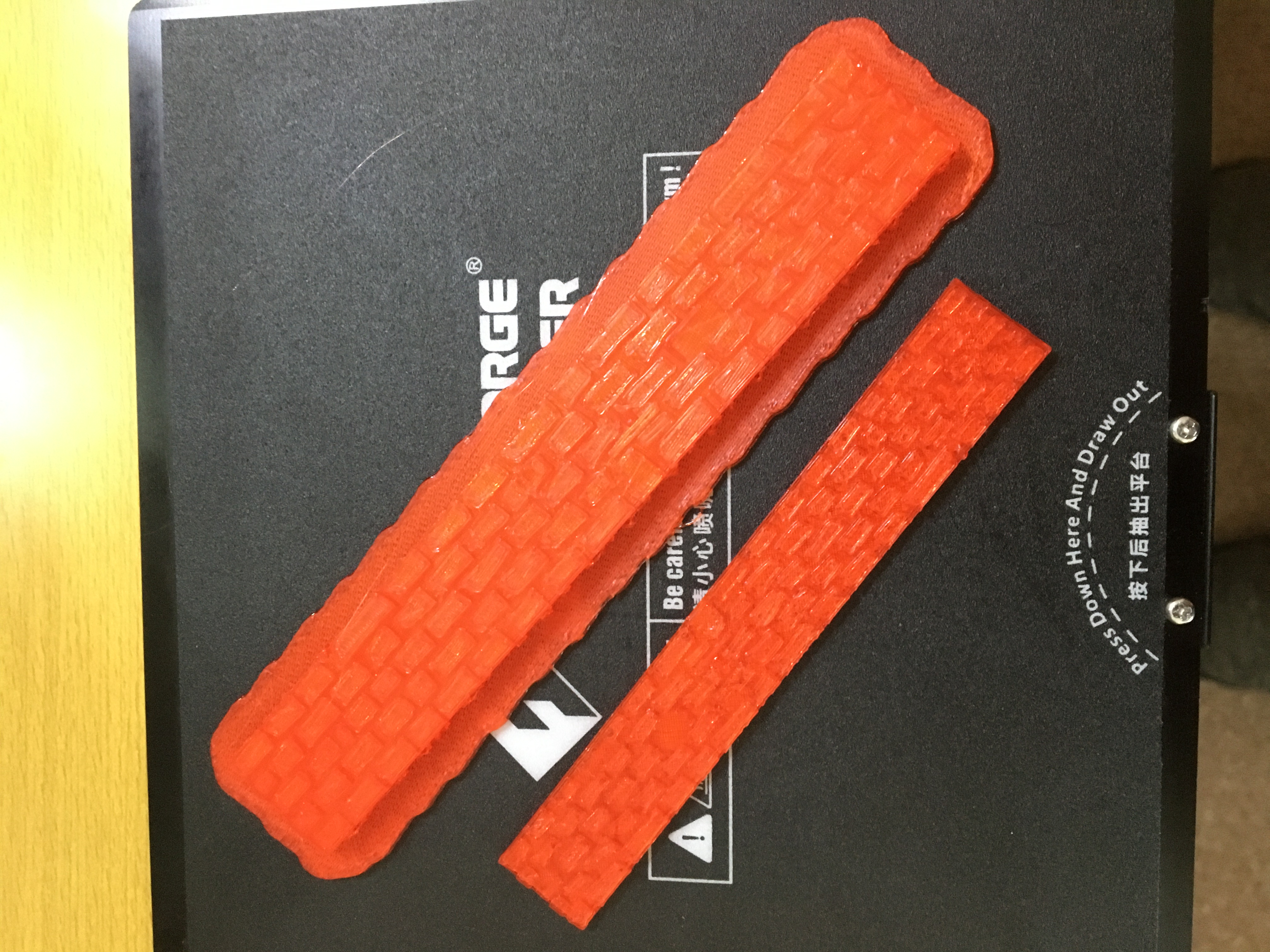

I have done what you have posted Trevor, but with two cut off and turned the bigger print to 45deg's. That is it printing in the photo I have just posted....

Well that didn't work out at all. The platform stones print on the right was the cut and the one on the left was scaled...A complete disaster both of them. The cut one did two rafts and went on to do the longer one, it got to the stage it decided to go over to the smaller one and it missed the raft completely so I had to abort it. The scaled one is self explanatory...To small..
I am going to try with Trevor's way of doing it later on...

I wonder if the second one wasn't quite on the bed before you sliced it? I've had a similar problem when multiplying things and arranging them before slicing ( i.e. draw one axle box then copy & paste 3 times and move them around on the bed to fit). They may LOOK as though they are on the same plane but if one is just a couple of pixels higher than the other, when the Slicer sets the base level one of them actually has a minute gap under it and won't print properly or even not at all.FWLR wrote: Sun Jan 03, 2021 11:05 am it got to the stage it decided to go over to the smaller one and it missed the raft completely so I had to abort it. The scaled one is self explanatory...To small..
Since the slab size was just what I decided it would be for my own platform, not any particular scaled size, it doesn't really matter what the actul dims are and your scaled down one looks fine to me.
OTOH, I generally get worse results when trying to print different sized objects at the same time, so I'd try just printing the larger one by itself. The actual print time will be the same for each so you only lose a few minutes whilst removing the first print and then setting it going again.

I tried to print one only but my machine said the other was not on the platform so it wouldn't start....How do I delete the other one so I can print the one on the platform.

The fact that it says one is not on the platform lends weight to my suggestion above.FWLR wrote: Sun Jan 03, 2021 11:51 am Hi Philip,
I tried to print one only but my machine said the other was not on the platform so it wouldn't start....How do I delete the other one so I can print the one on the platform.![]()
I don't know your slicer and it appears to have abilities that I've not come across before. However I would suggest that you neeed to go back to the point where you split my original drawing and then, when you move the two parts around, I would expect that you can delete one of them. Then save it and re-slice the one thats left

Select then one you want to delete by clicking on it. The selected item is white, other items are grey.FWLR wrote: Sun Jan 03, 2021 11:51 am I tried to print one only but my machine said the other was not on the platform so it wouldn't start....How do I delete the other one so I can print the one on the platform.![]()
To delete: Cmd-Backspace (or via the menu Edit > Delete). Only the selected (white) item will be deleted.

Thanks guys. I tried doing it Trevors way and it did it easily. There was no stopping me from then on
Although I did see another way, before I downloaded to Tinkercad, it put a popup with some setting on which had something like width, height and length. So I shorted the length from 200mm to 120 and then downloaded it to Tinkercad and it seemed to work. Haven't got around to printing it yet though, still looking after Anne, who is not very well indeed. She comes first before anything else....
