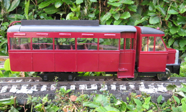

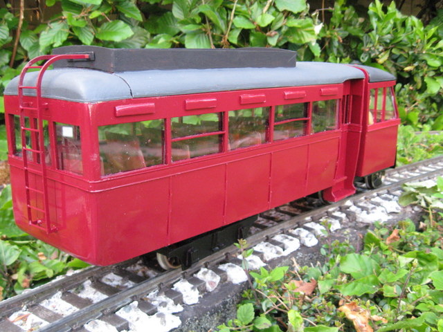

Further update. It's been a while since I posted on progress, but I have been steadily tinkering away with the railcar. I tend to have around three projects on the go at any one time so I can get on with something else while waiting for paint to dry or for stuff to arrive.
All seats now printed, assembled, painted and installed and she's been through the paint-shop. There's still more to do - mostly tweaking and finer detailing - and (as is always the case with my projects) a bit of remediation. However, she's now looking more presentable.
A bit more work needed on tidying up the bonnet and the cab roof will be screwed into place once I've finished tinkering with the electrics. The loose cable in the cab will eventually provide lighting for the passenger compartment.
The steps need painting and weathering and handrails need adding. I'll also print out some luggage for the roof rack. I'm looking for a basket of chickens or geese which I think will add a agrestic touch! I can't disguise the join in the roof, unfortunately. Maybe, once I've peopled the interior and installed the lighting I'll just fill it, sand it and paint it and hope I won't have to reglue the passengers or sort out lighting problems!
My hard work on the filing, filling and sanding of the tail end seems to have paid off - as long as you don't look too closely! I'll add a swivelling coupling to the rear as initially, I want to tow a luggage van but eventually add a dummy railcar to make it double ended - thereby avoiding having to install turntables at each end of the line!
It's been a challenge putting together a bare bones etched brass kit without instructions and with no additional fitments and fittings, but I am quite pleased with the result. I know there are modellers on the forum who would have produced a far finer model - but this has very much been a learning experience. I'm not sure I will rush to make another brass kit. I am much happier working with plasticard - particularly as I can more readily cover up my mistakes - or maybe avoid making them in the first place.

Brilliant Rik..... I think you have worked wonders from the materials you began with and have had to learn new skills on the way to completion. The final touches you propose will all help to take the eye from any slight imperfections, which probably only you would be aware of..... stop pointing them out!
The overall effect is what we are aiming to achieve and when in the garden doing its day-job it will be something to be proud of.

I agree totally with Peter, considering what you started out with, missing items and instructions etc. you've ended up with a nice working model. Well done.

Very nicely done Rik.
Re the roof joint, rather than seal it and hope you don't need access in future ( you know you will just as soon as it's sealed!) you could disguise it with 'joint strips' running from eaves to the luggage up rack on one side of the joint. Matching dummy strips at the front end would act to draw to eye away somewhat as well. Not prototypical, but who knows what repairs the PLR engineers might have dreamed up over the years!
I like that idea, Philip. The PLR workshop crew are always coming up with fanciful ideas and modifications. As you say, who will know the difference?

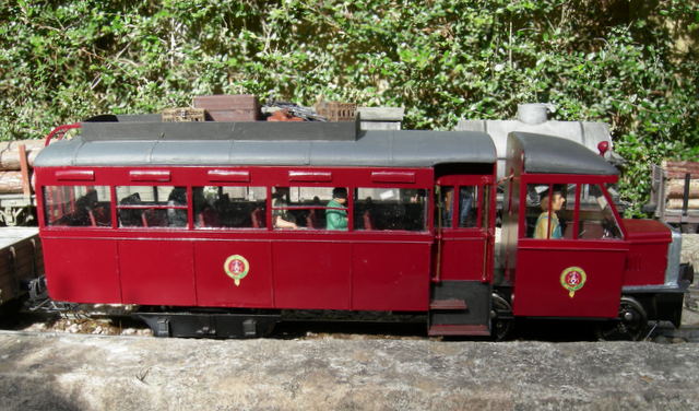

I decided against the CDR colour scheme in favour of the PLR's. It fits my story of the directors travelling on the Clogher Valley Railway where No.10 originated and being so impressed with the CVR railcar they immediately ordered one just like it for the PLR.
Here she is now resplendent in full PLR passenger livery.
As you can see, the paintwork around the bonnet has been tidied up as has the wiring on the cab
The tractor and trailer units now sport the PLR's crest and handrails have been added for the convenience of the passengers - who are now seated inside (enjoying electric lighting)
I followed the suggestion of adding strips across the roof to disguise the join - thanks, good idea.
And there is now luggage on the roof - mostly 3D printed including the bike (but don't look too closely it's a bit too modern for 1932. Eventually I'll find a sit-up and beg model with a basket on the front!)
And, as requested, here she is in action
I am pleased to say she negotiated the trackwork on the PLR without issue, though I had to remove a packing case from the roof rack as it wouldn't fit under the bridge!
