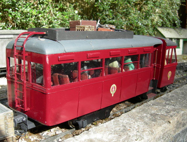

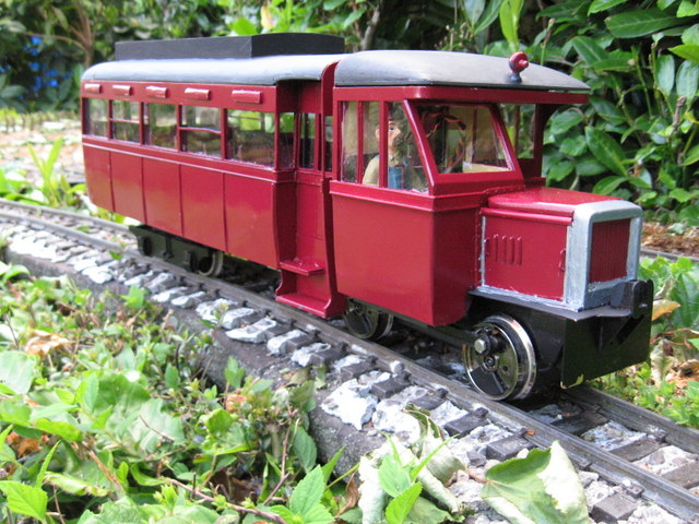

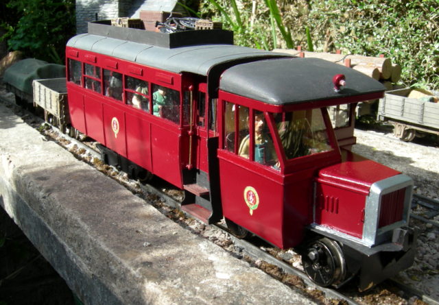

I decided against the CDR colour scheme in favour of the PLR's. It fits my story of the directors travelling on the Clogher Valley Railway where No.10 originated and being so impressed with the CVR railcar they immediately ordered one just like it for the PLR.
Here she is now resplendent in full PLR passenger livery.
As you can see, the paintwork around the bonnet has been tidied up as has the wiring on the cab
The tractor and trailer units now sport the PLR's crest and handrails have been added for the convenience of the passengers - who are now seated inside (enjoying electric lighting)

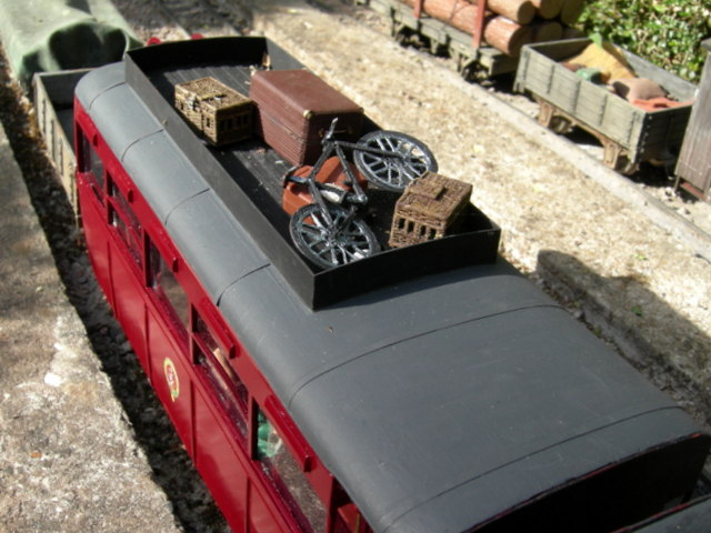

I followed the suggestion of adding strips across the roof to disguise the join - thanks, good idea.
And there is now luggage on the roof - mostly 3D printed including the bike (but don't look too closely it's a bit too modern for 1932. Eventually I'll find a sit-up and beg model with a basket on the front!)
And, as requested, here she is in action
I am pleased to say she negotiated the trackwork on the PLR without issue, though I had to remove a packing case from the roof rack as it wouldn't fit under the bridge!
