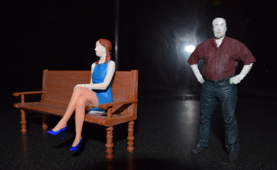

Something a bit different this time...
Last weekend, having got the fire and gas light sorted, I realised that the waiting room really needed somebody actually waiting in it. I have a few figures in stock but none of them are seated, which is what I wanted. I went to the 'DSP 3D' website with the intention of buying a couple of suitable characters. However they were displaying a notice saying they were working on the site, "please come back later". This went on for 3 days and in the end I got fed up and went off trawling the 'net. I hadn't realised before but there are loads of companies producing 3d figures for various computer game, CG film, architects and other designers. I think they are intended as the starting point for customisation in the various industries, so needless to say they are pretty pricey. However, a lot of them offer a few freebies to entice the potential customers in. Most of the freebies are standing, arms akimbo, but I did find one rather tasty young lady, sitting down. So this is the result, alongside a fella I got at the same time. It isn't exactly high resolution, but she has been rather viciously scaled down and the printer has given the poor girl a fairly ropey looking face, but it will be Ok indoors where she is difficult to see!
Actually, I had a bit of a problem printing her, because if you imagine the machine working up from the floor, it has to print quite a lot of supports because she is sitting on nothing, with her legs crossed and off the ground, so the first bit of 'her' that it comes to, is the point of a stilletto heel. It was then trying to print the rest of the leg, balanced on that point and it just ain't feasible! In the end I solved the problem by drawing a solid box under that foot, so that the shoe was resting on something solid, and then cutting it off when the print was finished.
DSC_0002 (1).JPG (172.14 KiB) Viewed 10016 times
BTW, she is sitting on a lump of BluTak which is why she appears so high.

Phillip where did you get your figures from? One thing I have been looking for are generic sitting figure stl's.
At the end of this week I hope to post pictures of a customers bridge sides that take 88 hours each to print!
Re: More on 3D Printing for a complete beginner
Posted: Tue Aug 08, 2017 4:41 pm
JMORG wrote: Tue Aug 08, 2017 3:28 pm Phillip where did you get your figures from? One thing I have been looking for are generic sitting figure stl's.
Now you are asking! I spent an evening trawling Google for " free 3d printable figures" and variations on that theme, and got odd ones here and there as I went. However I only found one or two seated figures.
You could try https://www.artec3d.com/3d-models/healthcare which is where the chap in my piccy came from.
There are thousands of amateurish scans on https://3dprint.com/138134/redwood-data-3d-scan/ but not sure if there are people.
These two are statues that I thought could be customizable https://www.myminifactory.com/object/ca ... razil-5111 and https://www.myminifactory.com/object/ma ... gium-13699
This one is a sort of search engine/catalogue site with all sorts on it http://www.yeggi.com/q/3d+scan/?s=tt
A guy called fredini has a number of scans on Thingiverse https://www.thingiverse.com/thing:102202
These look to be quite good but I had a prob with the downloads. http://www.cgvray.com/3d-scanned-people-free-models/
These are nice freebies but not seated. They do a pack of about 8 nice looking seated figures - if you've got $299 going spare! https://www.hdri-hub.com/hdrishop/freesamples
There are probably more, I just got those by going back through my browser history.

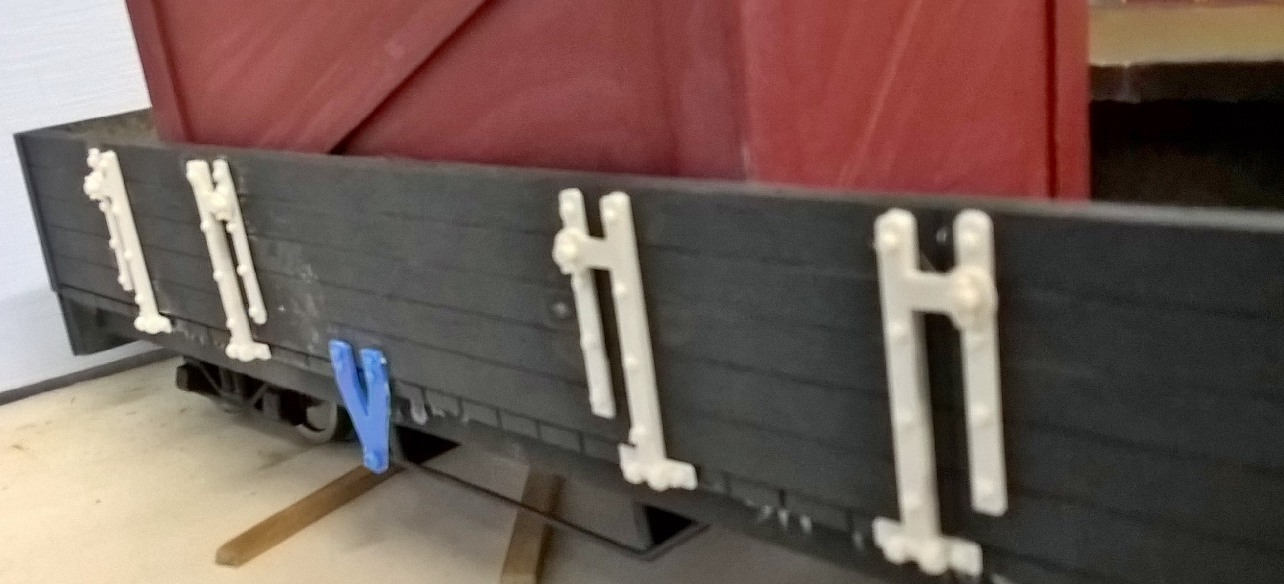

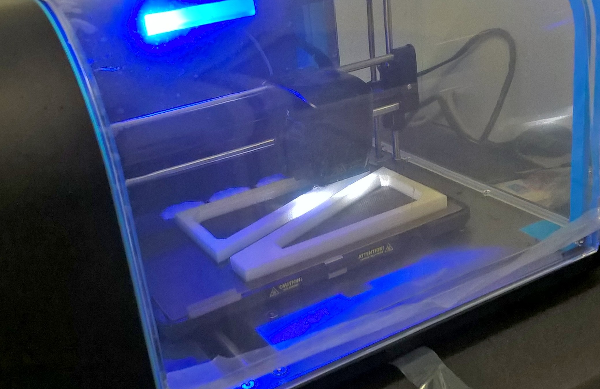

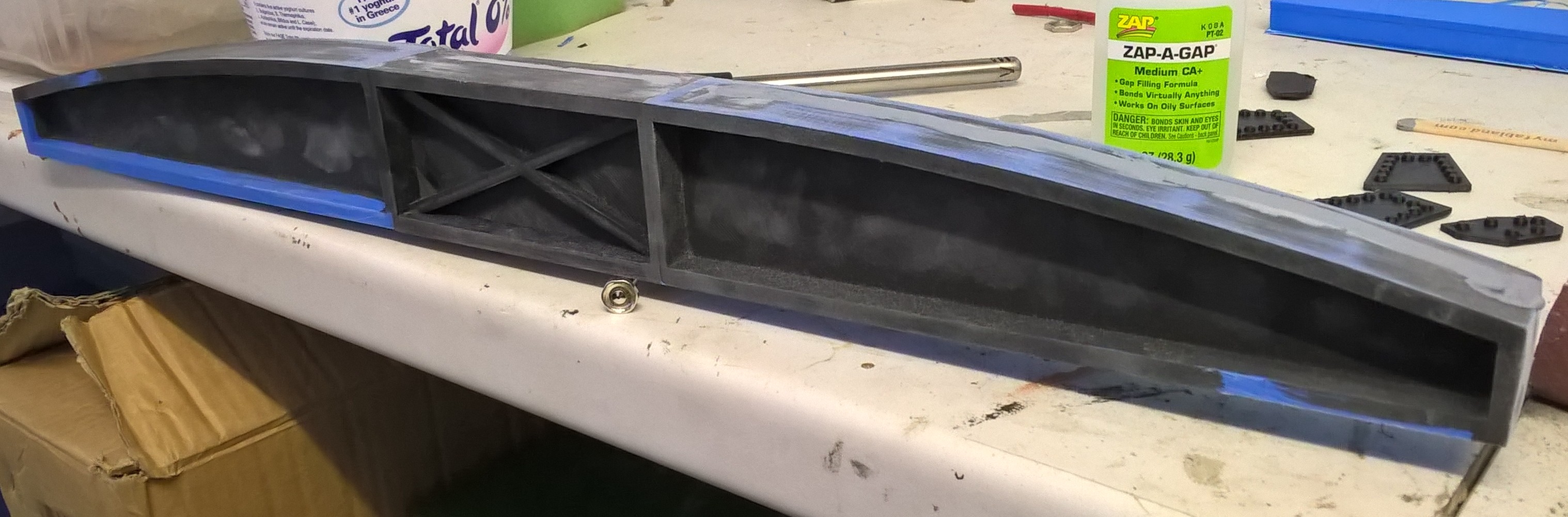

The two faux bridges being made are made up from several printed parts, both based on WHR bridges. For a group member...
The assembled one is 20" long, the glaslyn style one being printed will be 30" when finished.
Wagon strapping?

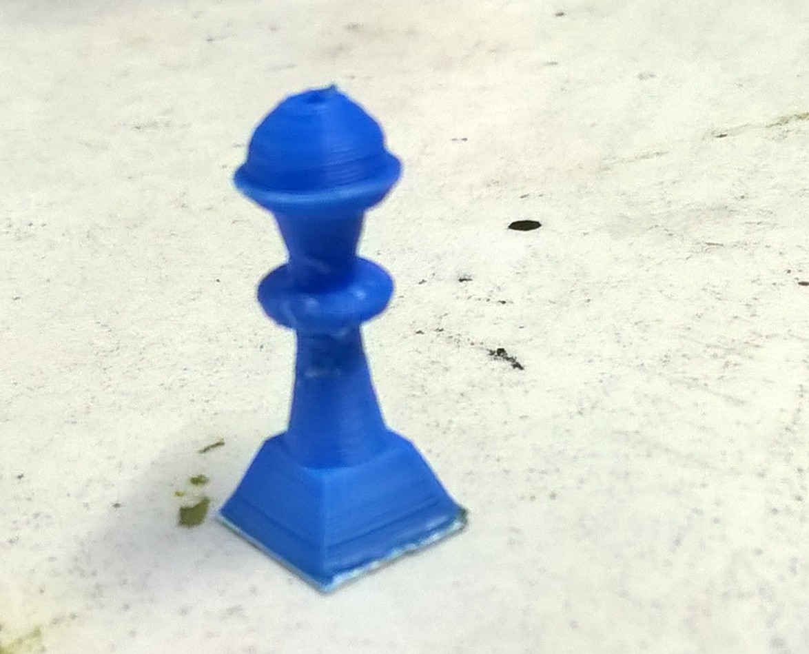

And some finials for a model of Woody Bay station (another group member).

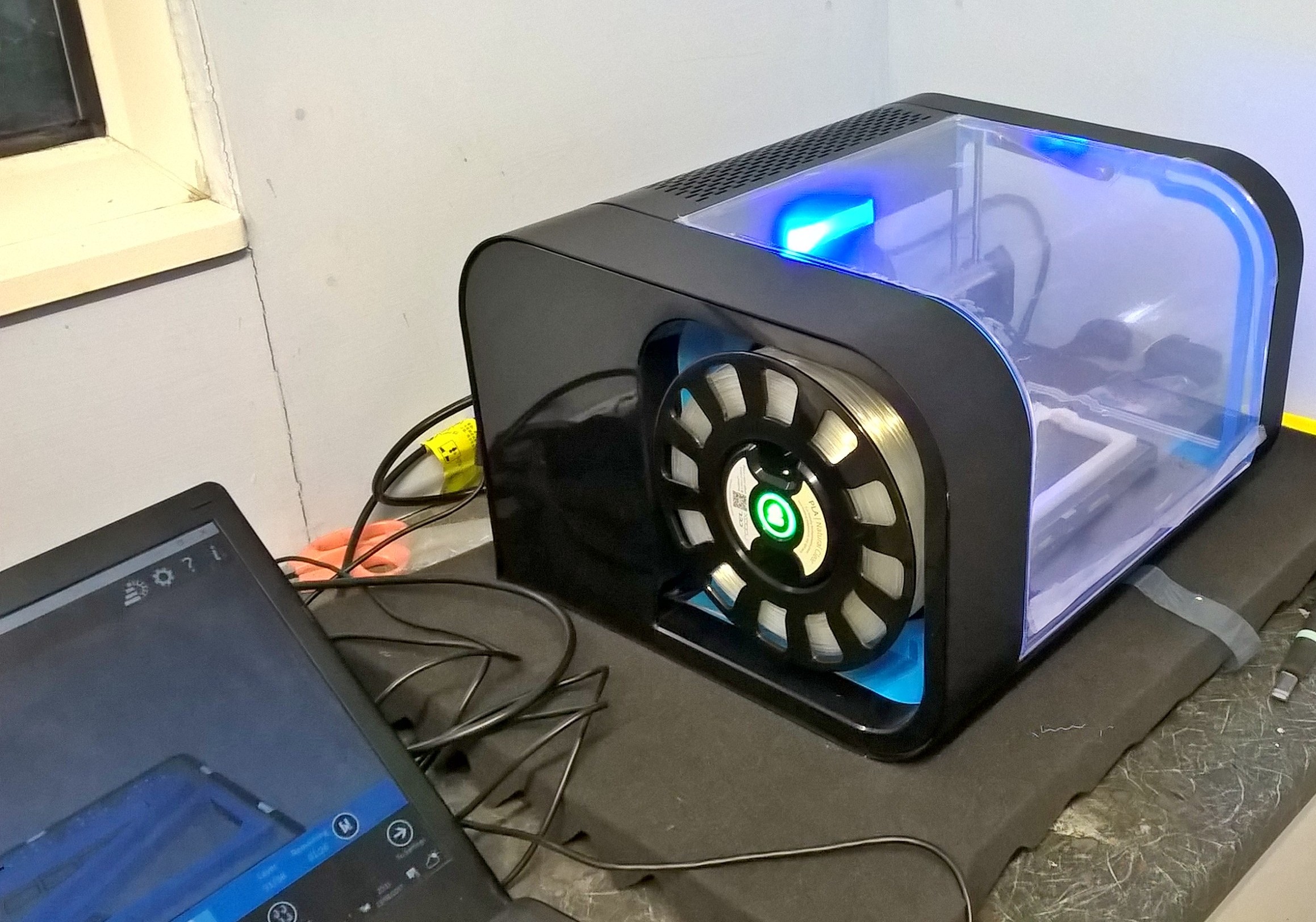

Finally, a picture of the CEL Robox...

They look interesting ( and big!). What filament are you using?
I do like the wagon strapping, very nice.
The finial I am jealous of, I haven't manged anything that complex yet. What material do you use to support the overhangs?

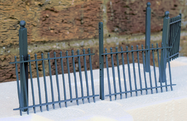

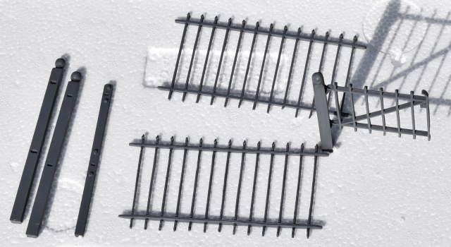

I'm currently wrestling with a 'wrought iron' fence. The verticals are about 1mm x 1.5mm but I can't get the two sides to print as one piece together i.e I get two vertical strips about 0.4mm wide with a gap in the middle which is about 0.2mm wide. The drawing comes up as perfect, when I've checked it, so it must be my machine settings.

I mentioned previously that I was struggling with something that might be a disaster and then a few days ago I said I was struggling with a wrought iron fence. Well, it's still not perfect, but with the 6ft Rule in play I think it's just about acceptable.
Printed in ABS so its reasonably flexible and hopefully will withstand the attentions of Sparrows if not Pigeons and @*&%$! cats.
DSC_0005 small.jpg (246.35 KiB) Viewed 9463 times
DSC_0003 small.jpg (434.69 KiB) Viewed 9463 times
The fence panels will slot into the holes in post faces. The gate hinges do work atm, but I think I will probably glue them when its all in place on the platform.
