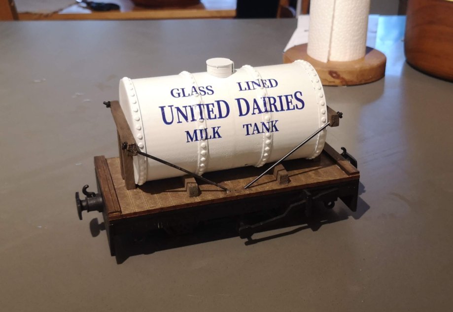

Made a tank wagon out of a North Pilton Works flat car, a 3D printed tank, some bike spokes & some pieces of wood.
Need to figure out some graphics for it but pretty pleased with how it came out!

big-ted wrote: Thu Nov 07, 2019 12:30 am pretty pleased with how it came out!
And you should be Ted, the 3D tank came out well and the bike spokes look good. Every modeller should have some, very handy things at times.

I would be very proud of that wagon myself Ted...Brilliant. :thumbright: :thumbright:

Great looking tank wagon. That 3D printed tank looks high quality. No sign (to me) or ridges or strata. Have you done a lot of filling and rubbing down or are 3D printers getting better?

ge_rik wrote: Fri Nov 08, 2019 7:31 am Great looking tank wagon. That 3D printed tank looks high quality. No sign (to me) or ridges or strata. Have you done a lot of filling and rubbing down or are 3D printers getting better?
There was quite a bit of filling & sanding, though it wasn't so much the "layering" of plastic that I worked to get rid of. If you look closely you can still see that the curvature of the tank isn't quite smooth. Rather than being a cylinder the tank is almost slightly polygon shaped. I don't know if one of the stepper motors was sticking to cause this or if it's sone kind of resolution limit.
The printer I used is, by modern standards, very cheap & basic. The pricier modern ones can produce parts that I'm pretty sure would only need light filling & sanding. We have one at the parent office of my work that prints with carbon fibre reinforcement that turns out super strong parts also.
3D printing definitely isn't the most efficient way to make something large & cylindrical like this, but my lathe skills are pretty rusty. Besides this allowed me to print the rivets on the tank rather than applying them separately after the fact.

big-ted wrote: Fri Nov 08, 2019 12:27 pm If you look closely you can still see that the curvature of the tank isn't quite smooth. Rather than being a cylinder the tank is almost slightly polygon shaped. I don't know if one of the stepper motors was sticking to cause this or if it's sone kind of resolution limit.
I don't know what drawing software you use but I've had that problem with Sketchup, and recently found the answer.
Sketchup by definition doesn't draw true curves, it uses a series of straight lines joined together to approximate a curve.
I recently discovered that by default it draws a circle with 24 straight line segments. With a very small radius this isn't really noticeable but the bigger the circle the more obvious it becomes.It is possible to increase the number of segments to pretty much as many as you want, but only when a circle is first drawn on a new drawing and that new number then becomes the default FOR THAT DRAWING ONLY, it isn't possible to set it as a universal default, for some weird reason.
My Qidi printer then quite faithfully reproduces all the straight lines segments, not a curve!
This picture shows part of something I'm working on at the mo. The one on the right is the standard 24 segment circle ( part of) and on the left is increased to 64.
The angles are still visible but a lot less obvious (the O/A span of the arch is 140mm, for reference). I might try it again with say 120 or so segs, but this object takes about 6 hours 40min to print so I'm not too keen, it might be quicker to get the wet n' dry out!
I don't know, but it is quite possible that other software does something similar.

You could well be right. I'm modeling in SolidWorks, which I'm very sure models genuine circles, but I have to export to .STL in order to open in my printer software (Cura) & i suspect the triangles used by the STL export do what you describe.
In any case, it's only noticeable very up close now that I've primed & sanded it, so I'm not going to lose any sleep over it.

The tanker looks great Ted.. :thumbright:

That tanker is brilliant, the tie bars and end bolsters really set it apart.

I agree about the tanker, that is a great job.
