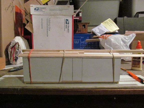

I decided to have a go at building a bogie covered wagon out of Bristol board. The ancestry is vaguely Victoria Narrow Gauge, but that is more in terms of dimensions than anything else.
Roof
Roof
By the time I thought to take any photographs I had got to the laminating the roof stage. The body of the wagon consists of three layers of Bristol board laminated together with wooden corner posts, and further supports at the one-third, and two thirds points along the body of the wagon. There are four wooden roof stretchers corresponding to the wooden stiffeners in the wagon body.

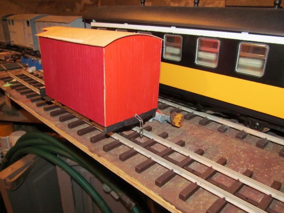

OK, let's stick it on some bogies and see how it looks before painting it... The roof is not stuck down yet as it has to be painted grey whilst the basic colour for the body is red oxide.
Painted - details next
As in this... dummy door hardware and handrails will be fabricated out of various bits of card and wire, painted black, and glued on. It also needs lettering - at least the tare, the load, and running number, even if I am a bit agnostic about the owner for the time being. The picture also shows the difference in size between 15mm scale - the brake van - and Ga. 3/LGB/1:22.5 scale.
