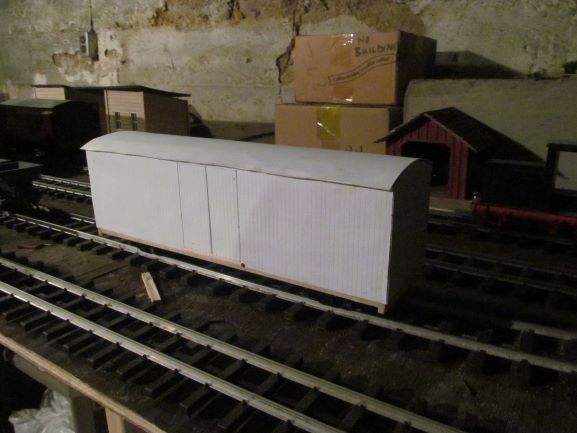

I decided to have a go at building a bogie covered wagon out of Bristol board. The ancestry is vaguely Victoria Narrow Gauge, but that is more in terms of dimensions than anything else.
By the time I thought to take any photographs I had got to the laminating the roof stage. The body of the wagon consists of three layers of Bristol board laminated together with wooden corner posts, and further supports at the one-third, and two thirds points along the body of the wagon. There are four wooden roof stretchers corresponding to the wooden stiffeners in the wagon body.
OK, let's stick it on some bogies and see how it looks before painting it... The roof is not stuck down yet as it has to be painted grey whilst the basic colour for the body is red oxide.
As in this... dummy door hardware and handrails will be fabricated out of various bits of card and wire, painted black, and glued on. It also needs lettering - at least the tare, the load, and running number, even if I am a bit agnostic about the owner for the time being. The picture also shows the difference in size between 15mm scale - the brake van - and Ga. 3/LGB/1:22.5 scale.

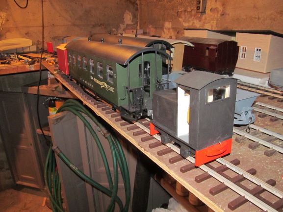

A chance remark earlier in the thread reminded me that I needed to repair the ducket on this Hurst Nelson MER brake van which has somehow managed to get itself transported to the Skebawn and Castleknox Railway.

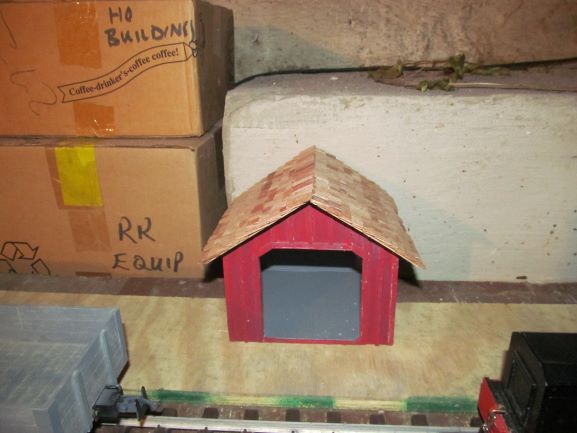

The little Norwegian style platform shelter - halts - for the use of, - has had its roof finished, but still needs a few finishing touches.
The Saxon Coach is a bit of an orphan project at the moment as I built it to 16mm forgetting that I intend the Coverdale Light Railway to be 32mm gauge/1:22.5 scale to represent 2'6" gauge. It may end up allocated to S&CLR&T and running on 45mm bogies. I shall have to produce another in 17/32nds scale.
And I am still trying to get a decent picture of the sentry box van with its red and barn red livery. I think it will get clobbered with the red oxide before long as that is closer to the original NER colours. Looks like Ole has been on the sauce...
Oh, and the Newqidas are back in the mix for conversion into "3n2.5" rolling stock for the Coverdale Light Railway.

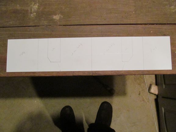

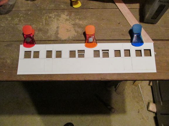

I have made a start on my first 'Ga.3n2.5' passenger vehicle using Bristol Board, though I did build a couple in 5.5mm scale 30 years ago using the directions in a book on model railways that "came out of the ark with Noah." The smaller scale stock was three laminations, but it looks like I will be doing at least four laminations this time, possibly five.
1. The outer skin.
2. Drop light frames.
3. Glazing
(4. Spacer)
5. The inner skin.
This should produce fairly rigid sides and ends. I am thinking the spacer layer will be unnecessary given the stiffness the glazing will impart, but I am still chewing on that fine point of design. However, the various layers will need to be painted before lamination, which means I am on the look out for a warm day - or a sustained absence of SWMBO from the house.
The colours will be maroon, light brown, nothing, and cream, or cream/light brown to reflect the sort of interior 1920s vehicles often had.
After that should come the partitions dividing the carriage into two vestibules, two lavatory compartments, and four passenger compartments. This coach is not symmetrical as the 3rd class half is about a foot shorter than the 1st class. This has driven me quietly nuts at the drawing out stage I basically drew one side upside down in order to get the doors and windows in the right place as that proved to be the easiest to do. I just hope I kept the paper with the dimensions noted on it in case I need to do another composite.
Pics in a day or two.

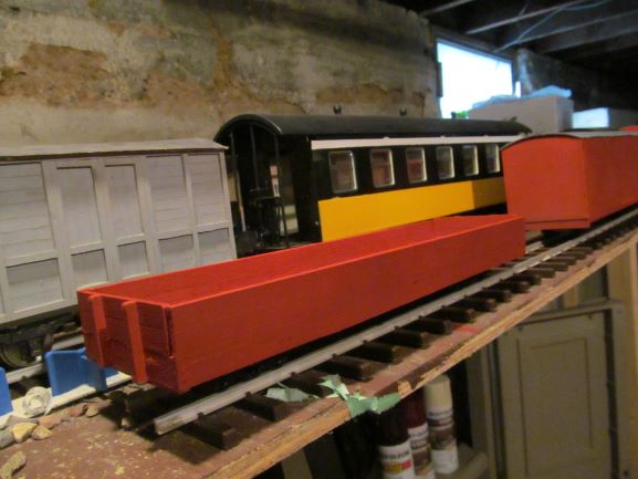

Photo Update - 23/1/19

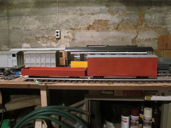

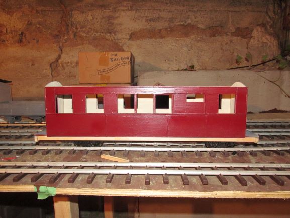

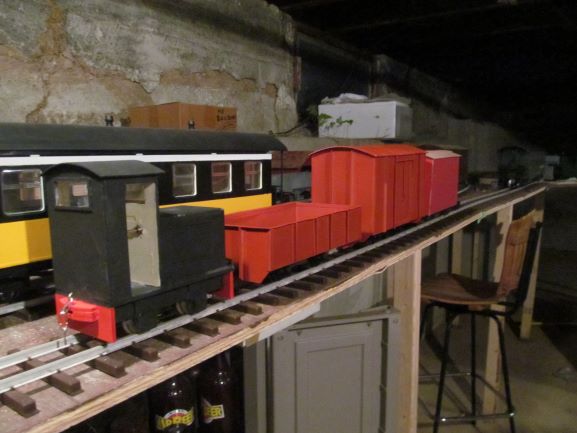

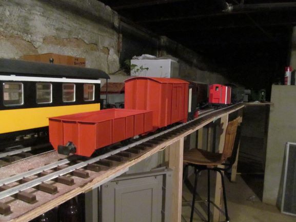

Since the last time I had the camera out, I have managed to get an open wagon body made.
This one is based on the early SAR narrow gauge opens. Needs strapping, but I tend to wait until I have three or four wagons that need doing then make myself miserable for an afternoon. It runs sprung and compensated O gauge trucks, same as the closed. They need bigger wheels - the original are a shade under 17mm, or about 16" in 1:22.6 scale, so I have some 20mm wheels on order, but the trucks may be too small, and in that case I will replacement with something with a longer wheelbase.
Here it is with the bogie van. They also need couplers. Like all colonial railways, the order for parts has duly been sent to Blighty.
The coach I am working on at the moment is based on a Kalka-Simla vehicle that was operating in the 1940s or 1950s - i.e. the generation of small window stock before the one they are currently rebuilding. Looking at various photographs, I would not be in the least surprised to discover that the present bogie carriages are riding on 1920s Leeds Forge underframes that are on their third or four body. I tweaked the design a little bit so that the two lavatory compartments were identical, and the end compartments are both six scale feet. The middle partition is a little off-centre to give the first class punters their accustomed extra space. Here is one side of the carriage jigsaw puzzle with the outer, drop light, and inner layers clamped together just to make sure the alignment is correct - or at least close enough. Here are the three layers laid out next to one another. I had not cut the windows on the inner yet. The light is indifferent in the basement. The floor plan of the vehicle ready for making all those blessed partitions. It is also a useful reminder that the vehicle is not quite symmetrical. It is a lavatory composite to seat 11 first, and 15 second class passengers. The seats will be long ways in the end compartments, and normal in the middle. It is a semi corridor vehicle.
That's it for now!

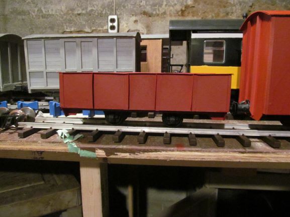

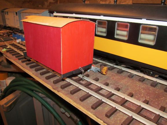

"Iron" Wagons
I had forgotten how much I like Bristol board as a material. It is not everyone's choice, but I got used to it as a skint teenager, and given that even now I have to do my modelling on a shoe-string, it come in very useful from time to time. I have also decided I do not like messing around with 13.5mm to the foot, and have reverted to 16mm, or rather 5/8th" because metric and I don't get along. Very much a case of -
"Rule Britannia!
Two tanners make a bob,
Three make one and six,
and four two bob!"
I'm afraid. Also I can slide between eights, sixteenths, thirty seconds, and sixty fourths for a lot of the measurements. That way I can do most of the maths in my head, and use my favourite very unmetric 18" ruler to do the measuring
Anyway, here are the preliminary results. The first wagon is by Darj out of Kalka-Simla, and is an iron bodied van. Everything except the door bolt, buffers, and running gear is Bristol board. It might get a wiggly tin roof if I can make a decent job of it, but I would want to experiment on something else, and master skills like not cutting myself before there was a major adventure with chopping up bean tins. I also need to give dummy brake gear some thought, or at least a brake handle to give every one the impression, etc., etc.. I have also just realised looking at the photo that I forgot the bally door hinges.
My conclusion on finishing that wagon was 'that didn't work out too bad' so I decided to have a go at an open wagon, which is a slightly bigger version - 12' against 10' - of a Darj prototype. Apart from not getting one of the angle supports quite vertical, it looks OK. I guess they were unloaded the hard way, as I could not find a door on any of them. I might do a variant with a centre "cupboard" doors before long, as that would make rolling things like scale 50 gallon drums of diesel out of the wagons easier. And the two of them together look like this. So how does my little train of 5/8th scale stock look? Well, like this - It is all basic draw it out accurately, then use a steel straight edge, and a sharp knife type modelling. The running gear and couplings are from Binnie Engineering, the ever useful local hardware store provided paint and brass rod, and the lead weights to help give them a little heft came from a gas, beer, bait, and ammo store (one stop shopping for geezers) in the middle of nothing much where we - herself and me - stopped at for a tank of gas and a coke one day. One nice thing about card angle iron is that it tended to adopt the slightly wiggly appearance of hard use naturally, thus saving me a lot of bother.
I think I need to do a few more of each type now, so that the Far End Tramway has a decent amount of goods stock at the start. I am rather enjoying my little break from larger vehicles.
Peter in Va

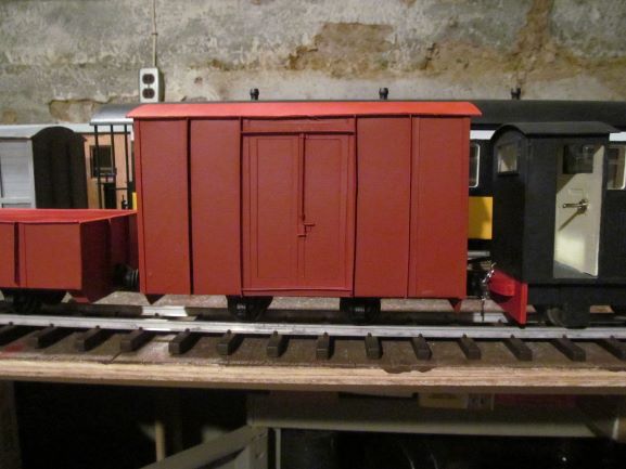

Re: Rolling Stock for the Far End Tramway
Added door hinges
and handbrake levers today in among hands. Apart from some dabs of white or yellow paint on the ends of the brake levers, and a some lettering - basically tare, load, and owner - they are now complete. On to the next wagon or carriage. Pics when I next do a photo round up.
