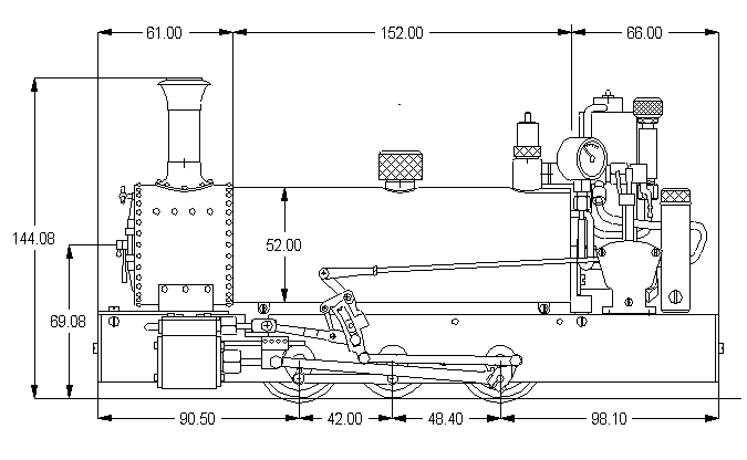

Looking at this Gromit I can see that senior management will have the red editing pen out again on these tender frame drawings.

The lads get stuck into making swarf. Took them all day. The red editing pen was out frequently and the 3D and 2D CAD drawings updated.
