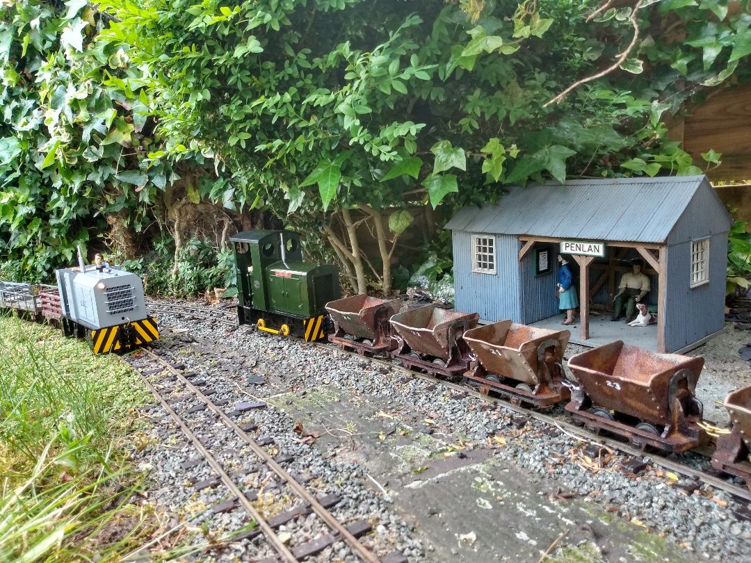

The (WH)WHR took on a distinctly industrial vibe today, with the two RH battery locos in service to celebrate the return to action of No 5 "Margaret" following a battery pack replacement.
Here they are doing their thing between gardening tasks. It was all so nice that I did begin to wonder why I bother with those expensive and complicated steam engines...

Enjoy them while you can - it's planned that the "Hercules" will give up its chassis to a scratchbuilt Kerr Stuart diesel, and if that works out the "Little John"'s body may be replaced by that of an armoured Simplex. All in good time, of course...

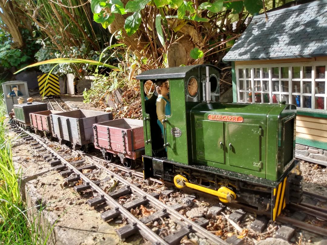

Here's "Margaret" heading up the line with a lineside clearance train - some open wagons, a tanker presumably containing weedkiller, the PW team perched on a flat wagon, and the new guards van. In the background of the first picture you can see the wasp stripes of the Big Black and Yellow Van, the vehicle which actually battered its way through the vegetation, propelled by new-ish loco No. 6, which also had a turn on the wagons later in the day...

All good fun, and the line seems to be in reasonable condition - must run a steamer or two next...

Good to see your back on the straight and narrow, nice pics. those trucks do look the business. I reckon the look on your guards face is saying "I have the power, with a single hand to bring this train to a halt".
Glad you could enjoy the sunshine.
