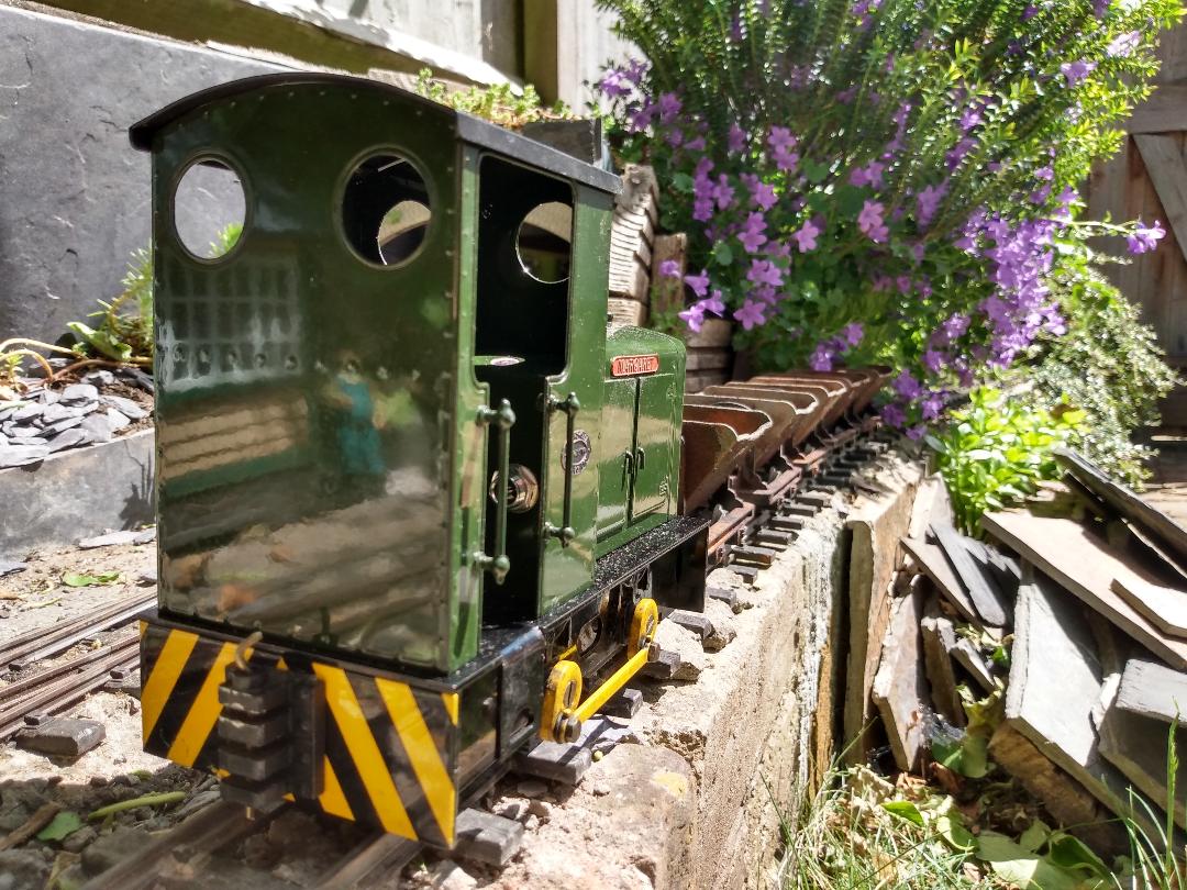

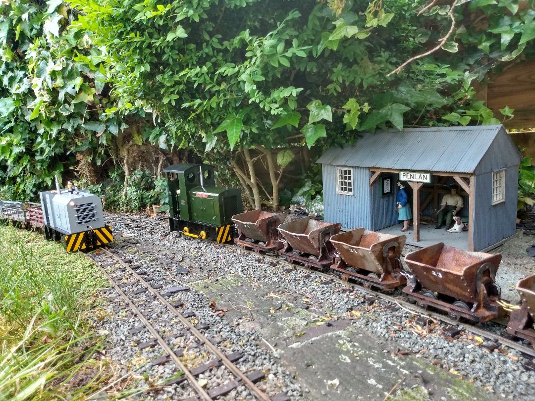

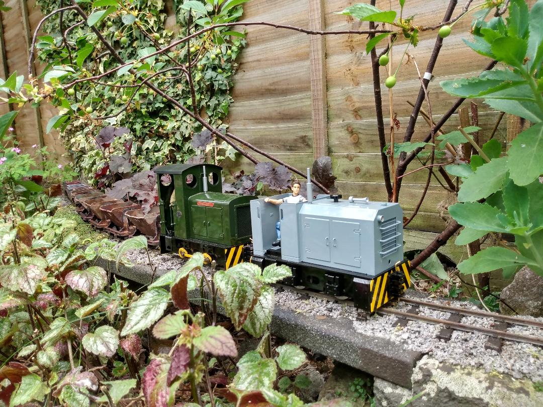

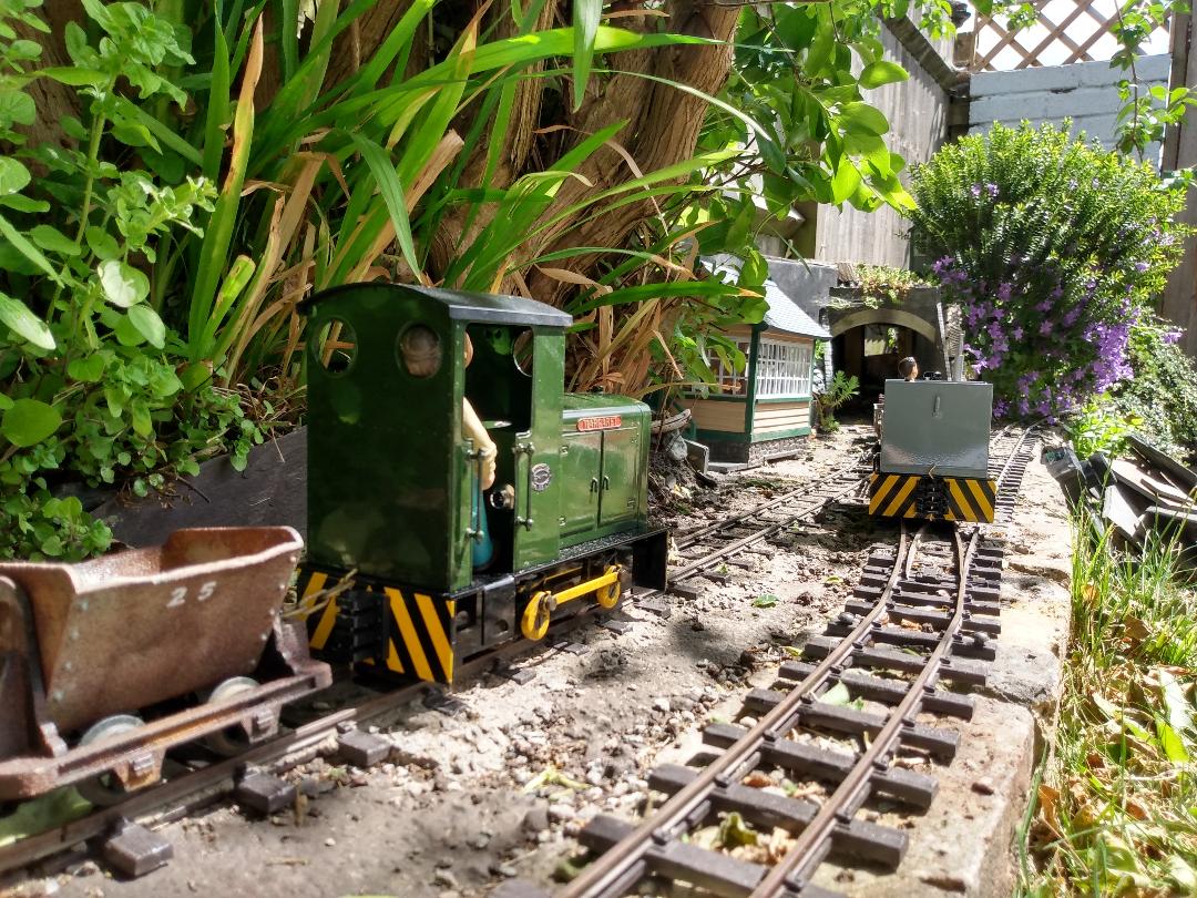

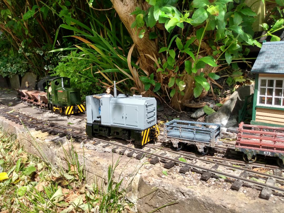

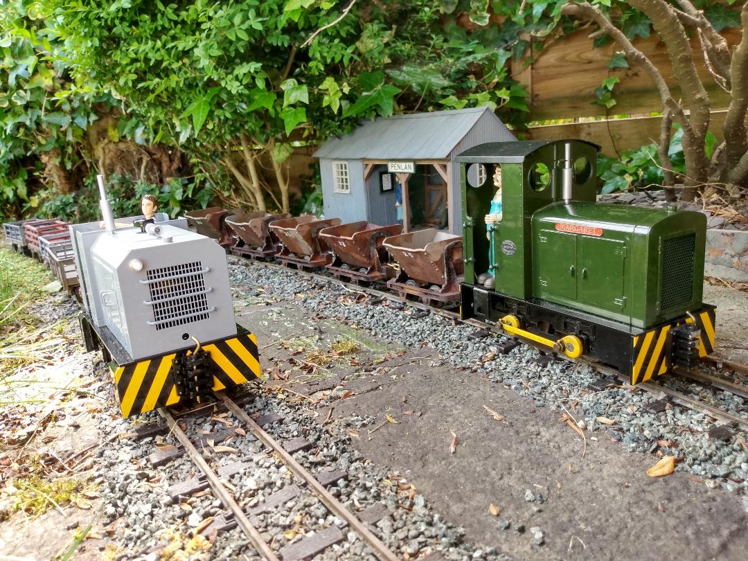

The (WH)WHR took on a distinctly industrial vibe today, with the two RH battery locos in service to celebrate the return to action of No 5 "Margaret" following a battery pack replacement.
Here they are doing their thing between gardening tasks. It was all so nice that I did begin to wonder why I bother with those expensive and complicated steam engines...
Enjoy them while you can - it's planned that the "Hercules" will give up its chassis to a scratchbuilt Kerr Stuart diesel, and if that works out the "Little John"'s body may be replaced by that of an armoured Simplex. All in good time, of course...

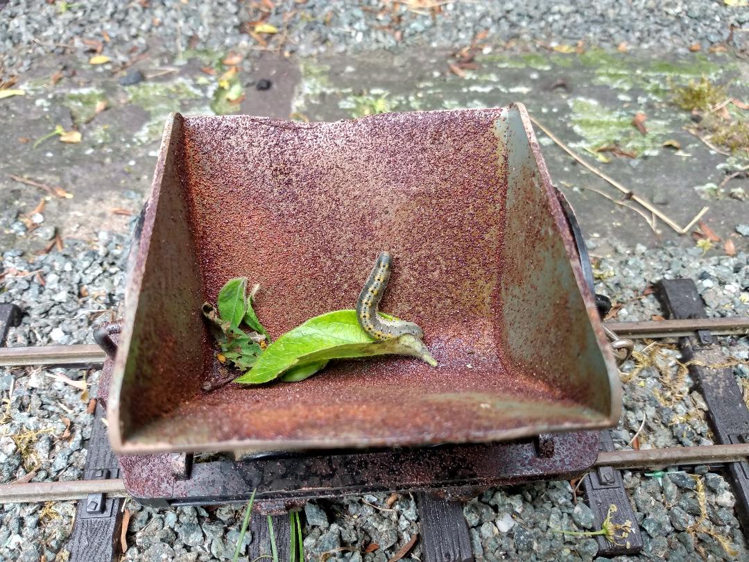

Finally, another in the infrequent and not very interesting series "Wildlife of the "(WH)WHR" - I was surprised to find this little fella in one of the tippers when I put them away. I think he was probably surprised to be there too - I reckon he got blown out of the tree he was feasting on...

You did well to get out in the garden. It's really, really, really windy here! Would have blown my skips off the track.
- Posts: 1868
Glad you got the batteries sorted Andrew, and got to enjoy some running.
- Jimmyb
- Posts: 492
- Location: Weston-super-Mare
Andrew, nice to hear things came out all right in the end

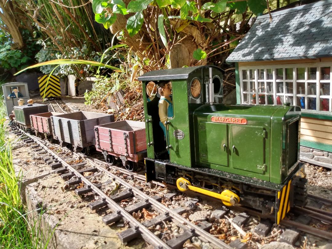

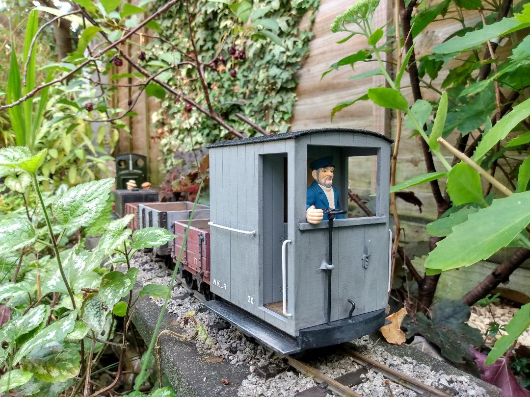

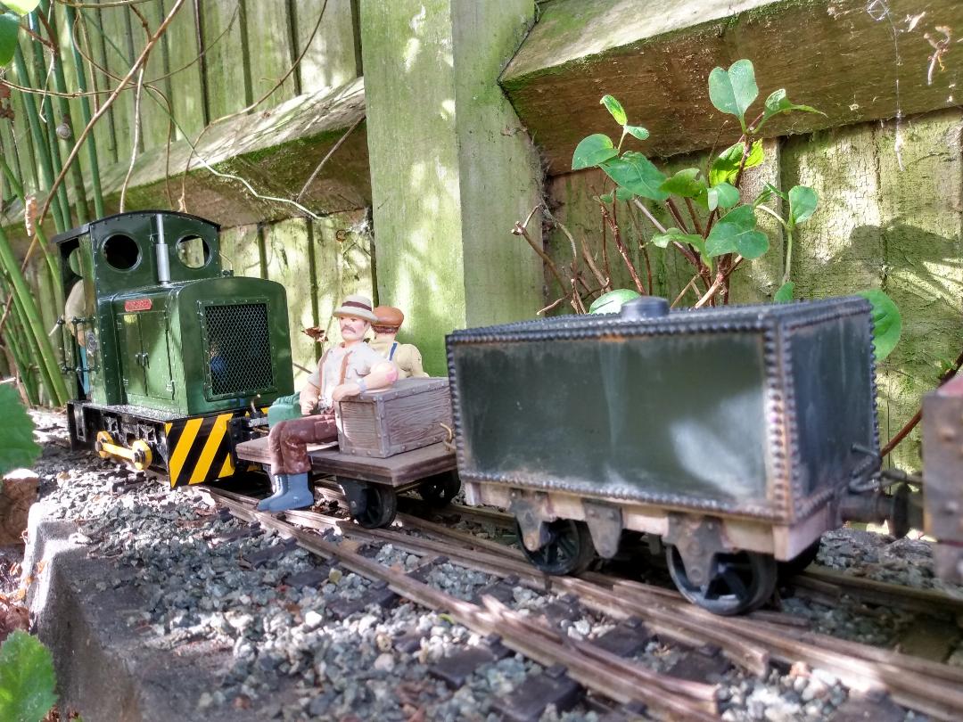

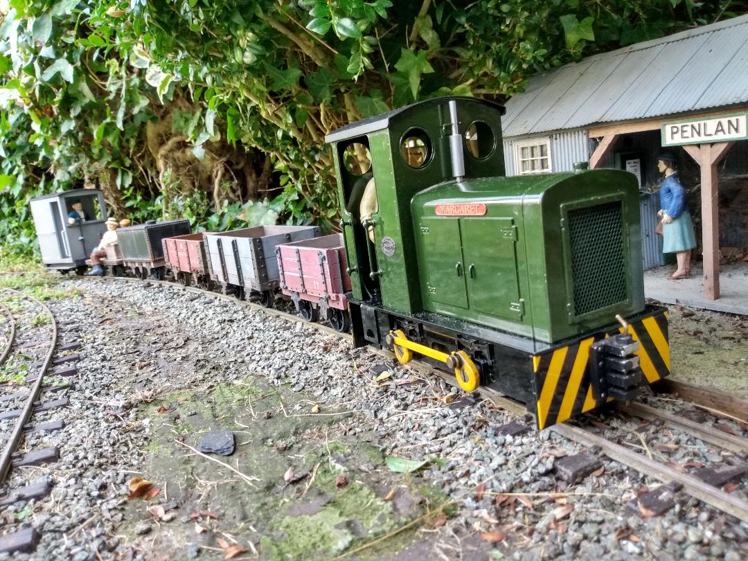

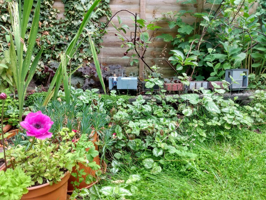

Yesterday evening I finally got round to clearing the overgrown track and operating a train or two.
Here's "Margaret" heading up the line with a lineside clearance train - some open wagons, a tanker presumably containing weedkiller, the PW team perched on a flat wagon, and the new guards van. In the background of the first picture you can see the wasp stripes of the Big Black and Yellow Van, the vehicle which actually battered its way through the vegetation, propelled by new-ish loco No. 6, which also had a turn on the wagons later in the day...
All good fun, and the line seems to be in reasonable condition - must run a steamer or two next...

You should be absolutely ashamed of yourself,Andrew wrote: Mon Aug 03, 2020 12:46 pm I think I did lockdown wrong. Not only did I not learn a language or write a novel, but I barely ran any trains. What was I thinking?!
Good to see your back on the straight and narrow, nice pics. those trucks do look the business. I reckon the look on your guards face is saying "I have the power, with a single hand to bring this train to a halt".
Glad you could enjoy the sunshine.
With hands that big he probably wouldn't even need the brake!LNR wrote: Mon Aug 03, 2020 1:30 pm I reckon the look on your guards face is saying "I have the power, with a single hand to bring this train to a halt".

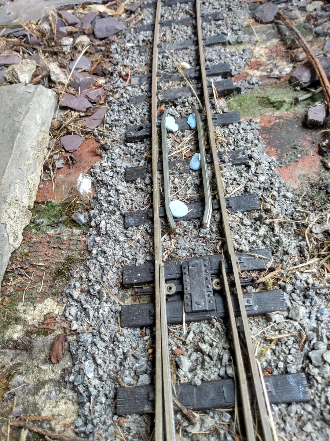

While running with some of my smaller, lighter wagons yesterday, a familiar problem reared its head on the approach to Penlan station: after the loco had cleared the points into the platform road, one or more of the wagons decided to take the other route, heading into the siding instead. I checked the back-to-backs and made some adjustments, which brought some improvement, but not enough.
I think the problem is to do with the alignment of the track here - it looks OK to me, but the wagons just seem to "want" to go straight ahead into the siding rather than take the gentle left hand curve in to the platform. I had some spare check rails to hand, so temporarily fixed them in place ahead of the point, with the idea being to guide the wheels into a better alignment before they reach the moment of truth:
It seemed to work - I think there'll always need to be a speed restriction here for lighter rolling stock, but the results were very much better. I'm tempted to make them a permanent fixture, but before I do I thought I'd ask the experts - is there a reason why I shouldn't? Other than that it looks a bit odd, of course, but I can live with that for the sake of better running...

Why don't you make the check rails into an unmanned crossing?

I've done something similar with a point at Beeston Castle station. I put a barrow crossing across the section which was causing problems. I find with LGB points, the check rails aren't quite long enough for some stock. A different problem but a similar solution.tom_tom_go wrote: Mon Aug 03, 2020 7:46 pm Why don't you make the check rails into an unmanned crossing?

Certainly don't envy the job of chasing up those mystery derailment spots in the track, but I like your solution.

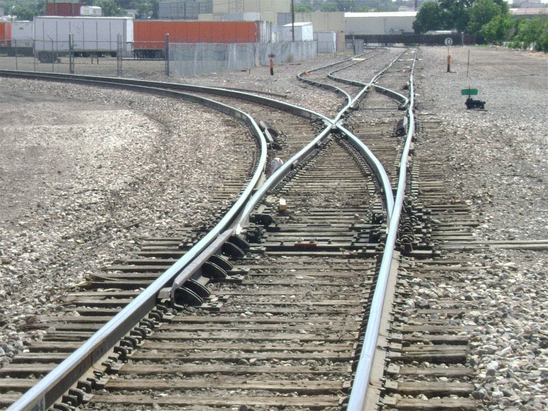

This picture shows a turnout in Longmont, Colorado. The main line is the turning to the left, with straight on being a little-used branch. Note the check rail on the left immediately in front of the point blade, so placed to stop flanges on the right-hand wheels from "picking" the point blade and attempting to go straight on.

Thanks Tony - it's good to know they have the same problem in The Real World! I'll fix my rails in place...
Thanks for the suggestion of disguising the check rails as a crossing too - it's a good idea, but it's not a very prominent location so I'll probably just leave it be...
