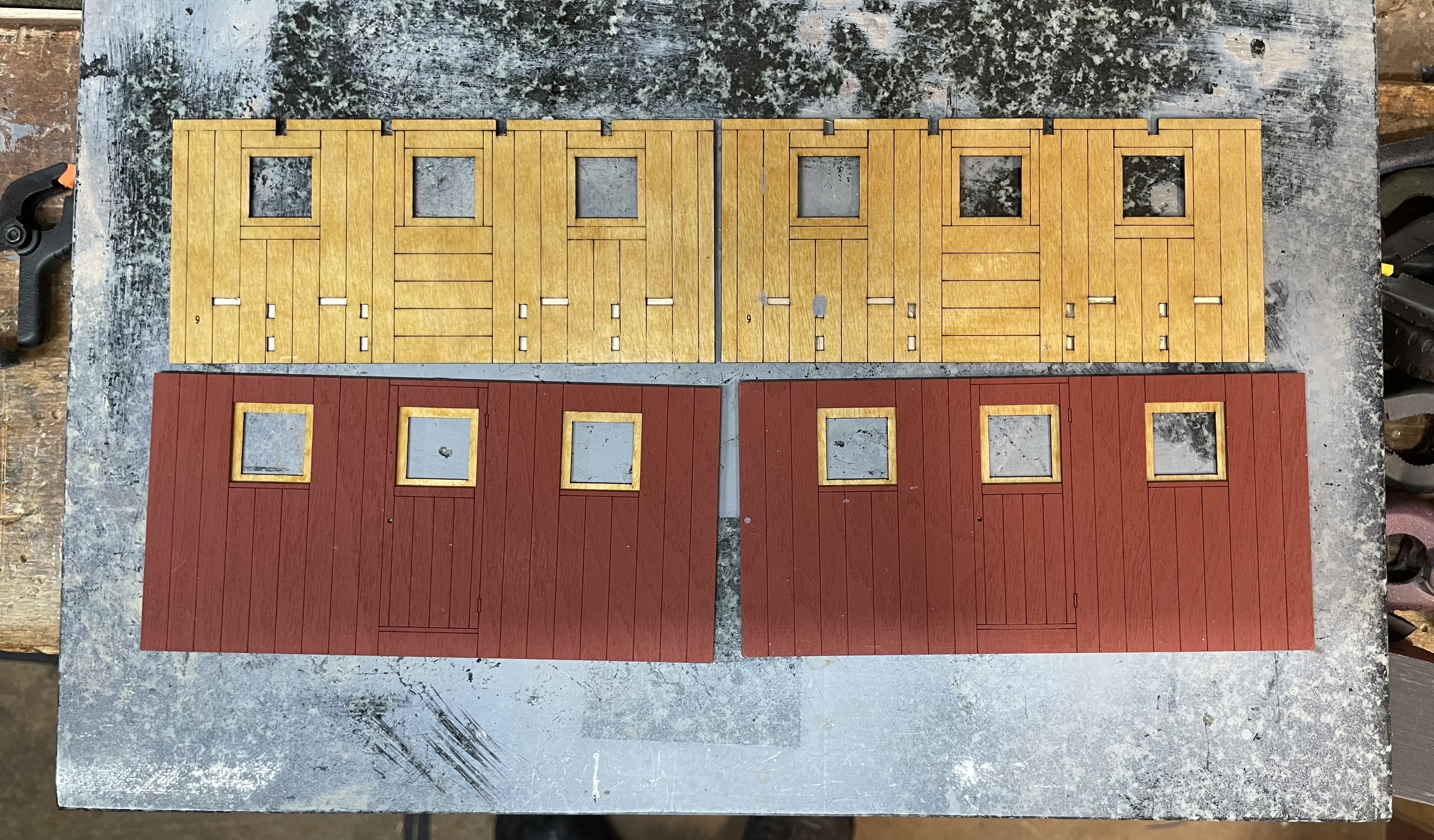

Attention then turned to the sides and ends. Each side is made up of four layers of ply, the ends only two layers. Construction should be easiest if the outside walls were painted before assembly and the interior and droplight frames similarly. All pieces were first treated with a coat of MDF primer, this seals and raises the grain. Once dry they were lightly sanded with fine abrasive.
Here they are drying:-
There are lots!
The exterior was sprayed with two coats of red oxide primer and the interiors given two coats of pine varnish (I have a very old tin half used. It has become very gloopy so I guess I should get some new stuff ere too long!).

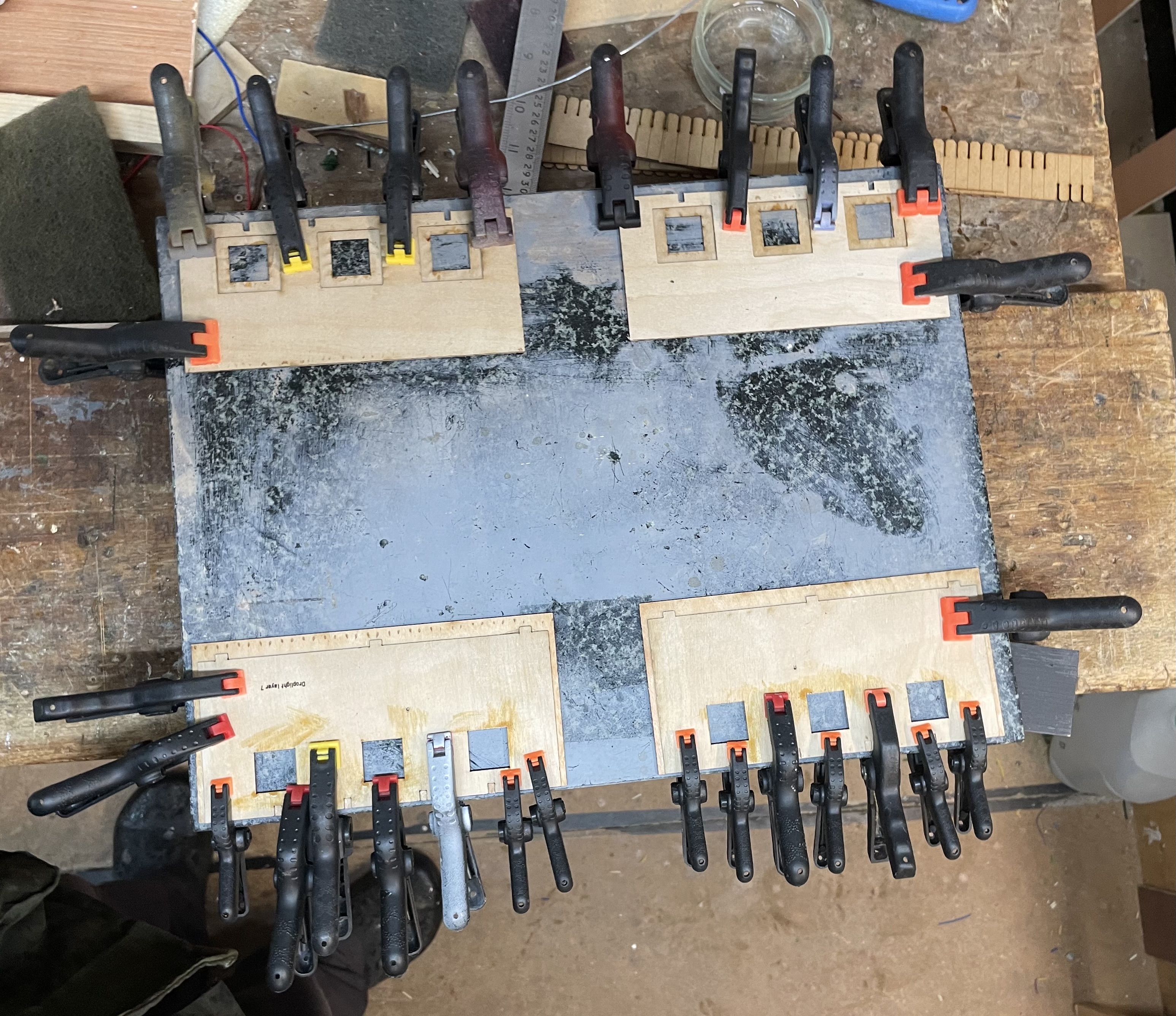

I then glued the inner two layers together, the inner of the two having cutouts for the glazing which was also present, and the two outer layers.
A picture which may be confusing:-
I really should have left the varnish a bit longer to dry more thoroughly I realised having set up this arrangement of many clamps!
to be continued

Having removed the longer clamps and blocks of hardwood it becomes easier to see:-
Inside above showing glazing reveals.
Once the clamps were all removed the outsides were loose, the insides adhering to the granite. Luckily they came loose fairly easily and only one had picked up a trace of grey primer, most of which will be under the seats. I really should clean off the granite slab before doing this sort of thing again and not use it as a painting surface!
