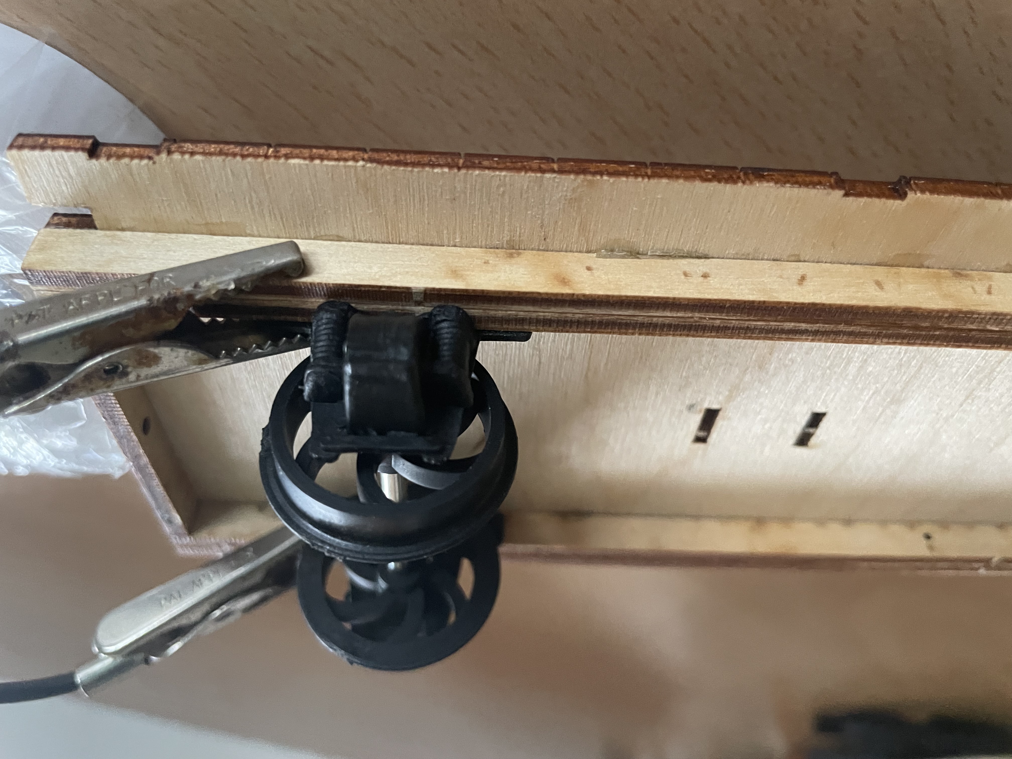

I spent ages looking at the Brandbright website to see what the axle boxes were like, they don't seem to stock the curly spoked wheels so I also spent time perusing Peter Binnie's site. I tend to use his couplings on most of my stock and have some in hand, there were some axleboxes in my bits box but nothing that worked for this coach nor any curly spoked wheels, I found some straight ones, nor suitable axles.
I ordered three styles of axle boxes (£4 for eight of each), three lengths of axles and curly spoked wheels. They came this morning so experimentation soon followed to see what would work:-
These worked well with the 52mm axles and curly spoked wheels. They may not be right to prototype but once the underside is painted black and the coach is on the track it will be perfectly acceptable to me.

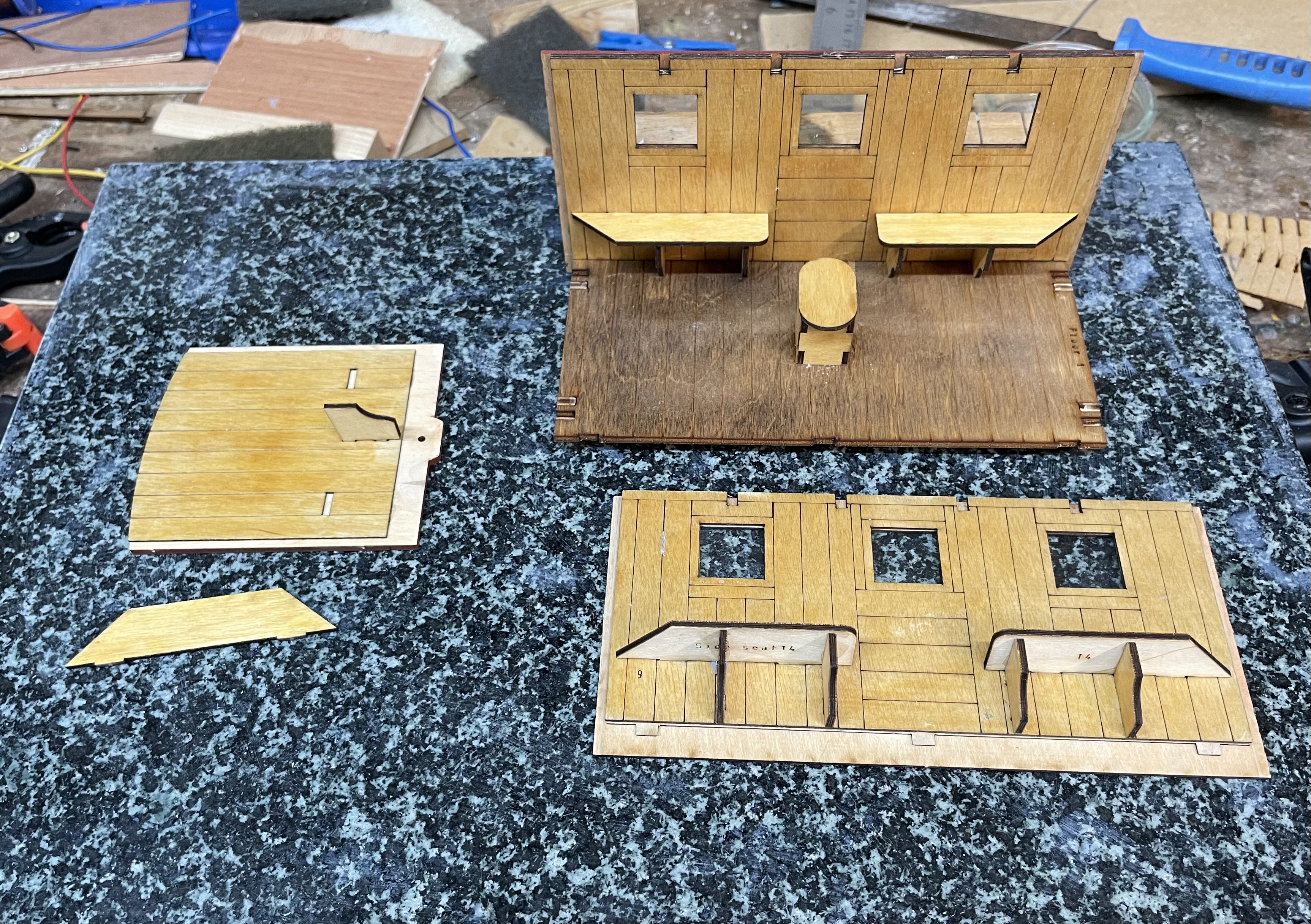

The glazing was added to the inner sandwich using a little canopy glue to hold it in place and then wood glue was used to join the two sandwiches. Once set I added the seats to the sides as it would be difficult to do with the body assembled. At the ends I just added the support in case some adjustment is needed to the seat once the body is assembled. The middle seat has also been glued in place.
The observant will notice I cleaned the granite slab!
