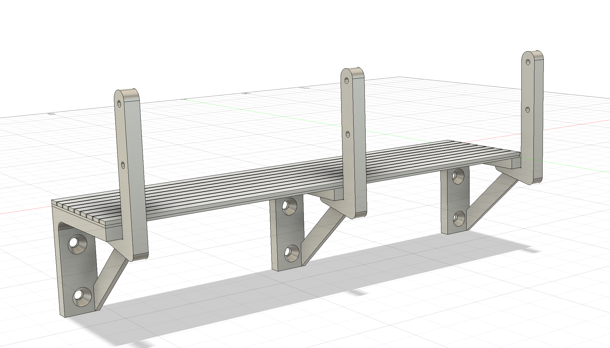

As you will know 3 D printing solves many of my problems, so I wondered if it could solve this one as well. The design for a printable railing( I really do like Fusion 360):
Screenshot 2025-09-14 at 09.41.07.png (489.54 KiB) Viewed 26015 times
It is in three separate parts, brackets to support the walkway, the walkway, and handrail posts. The first sections are printed. The brackets - which are screwed into the sides of the main beams, and the walkway first. The walkway is twice as wide as the previous one (so I hope my coaches will clear it - but I can work that out as I go along). The first section of the viaduct is straight - and that seemed a good place to start. It will take a while to print and fit, and as I get to the curved sections I will have to make each section to fit each place, but it looks OK so far. The handrail posts are still printing. Photos shortly.

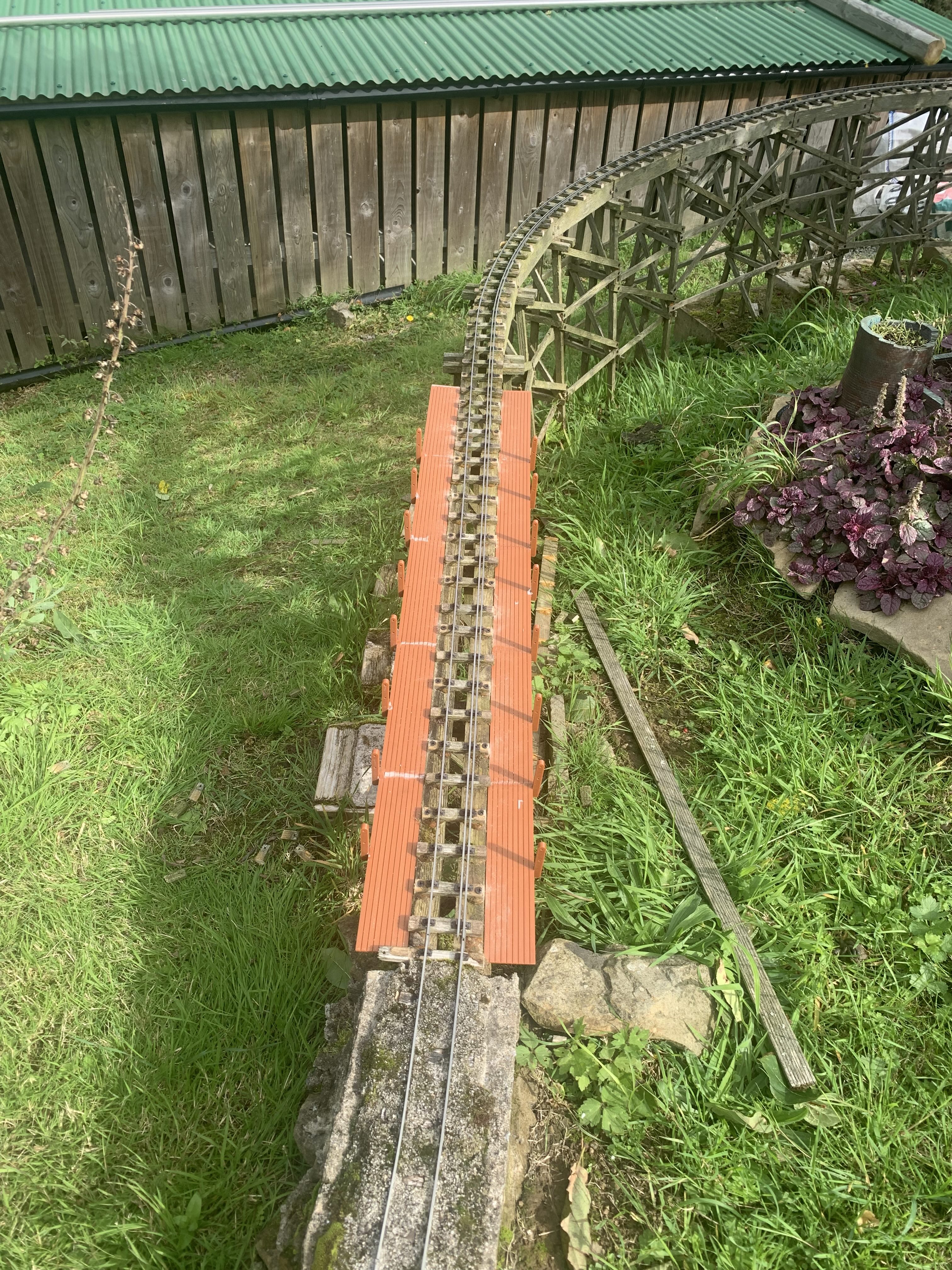

Another section in place:
and the first handrail posts are in place. From now on it's curved, so I will be measuring and making planks for each individual section.
The ends where it fixes to the concrete are yet to be tackled - but I think some printed triangular piece to clamp the ends of the wires to be secured to the concrete with a screw. I'm thinking of using 1.5mm brass wires, to string the handrails.

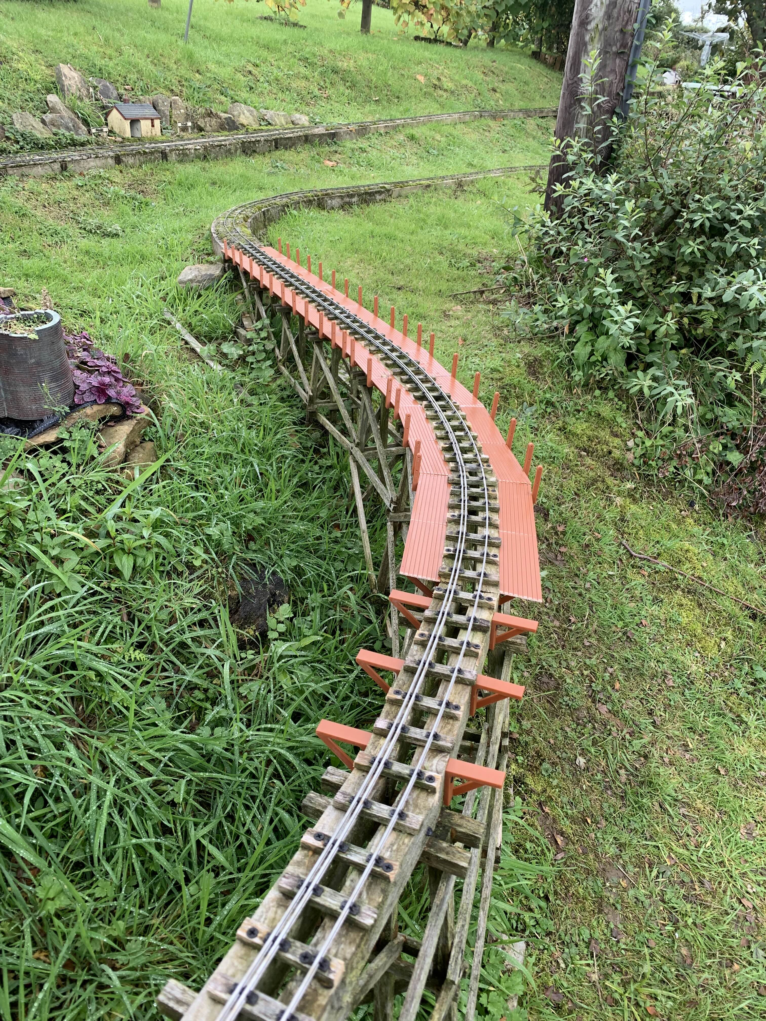

More progress on the viaduct handrails.
I am into the curved section now:
The brackets are going on OK - although I have found that they go on more accurately if I don't pre drill the holes. The sections of decking are all odd lengths and have angled edges. I was going to print each one accurately to size, but I am actually using the first ones I made (for the straight section) and just cutting them to size as I go. I am finding that the easy and accurate way to cut them is on my guillotine - but that does mean marking them and taking them to the other end of the garden for cutting.
Almost half way now.
I think I will paint the plastic when I have finished (before fitting the wires) - it looks a bit "plastic" and artificial as it is.
Posted: Sun Sep 28, 2025 2:07 pm
by gilfachphil
looking good
Posted: Sun Sep 28, 2025 2:13 pm
Yep, I'm with Phil, it does look good. I love the way the lines of posts march off into the distance. :)
I think you are absolutely right about painting them though. I've assumed from the start that you would.

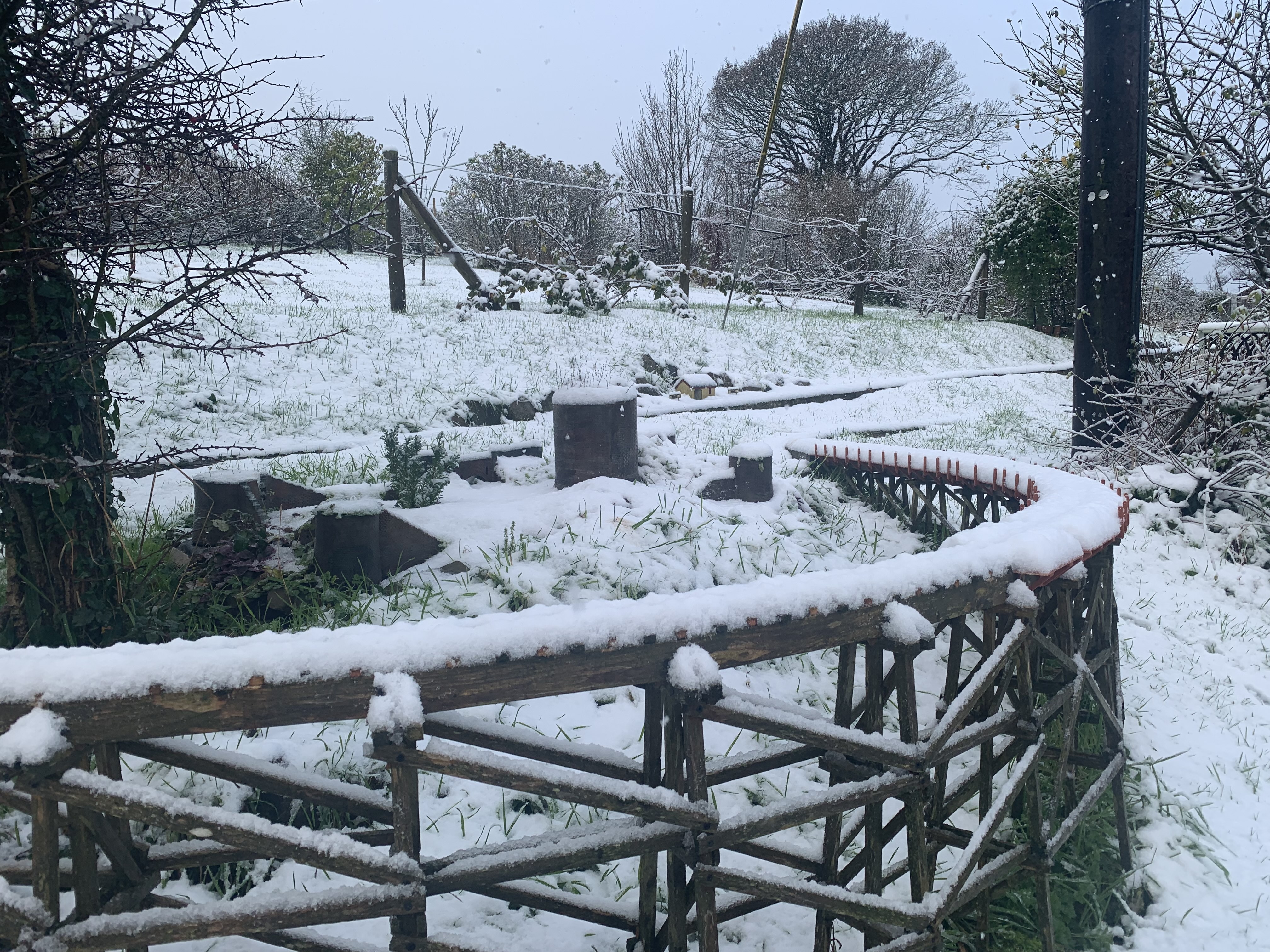

Posted: Thu Nov 20, 2025 10:16 am
by Trevor Thompson
I don't think any trains will be running today!

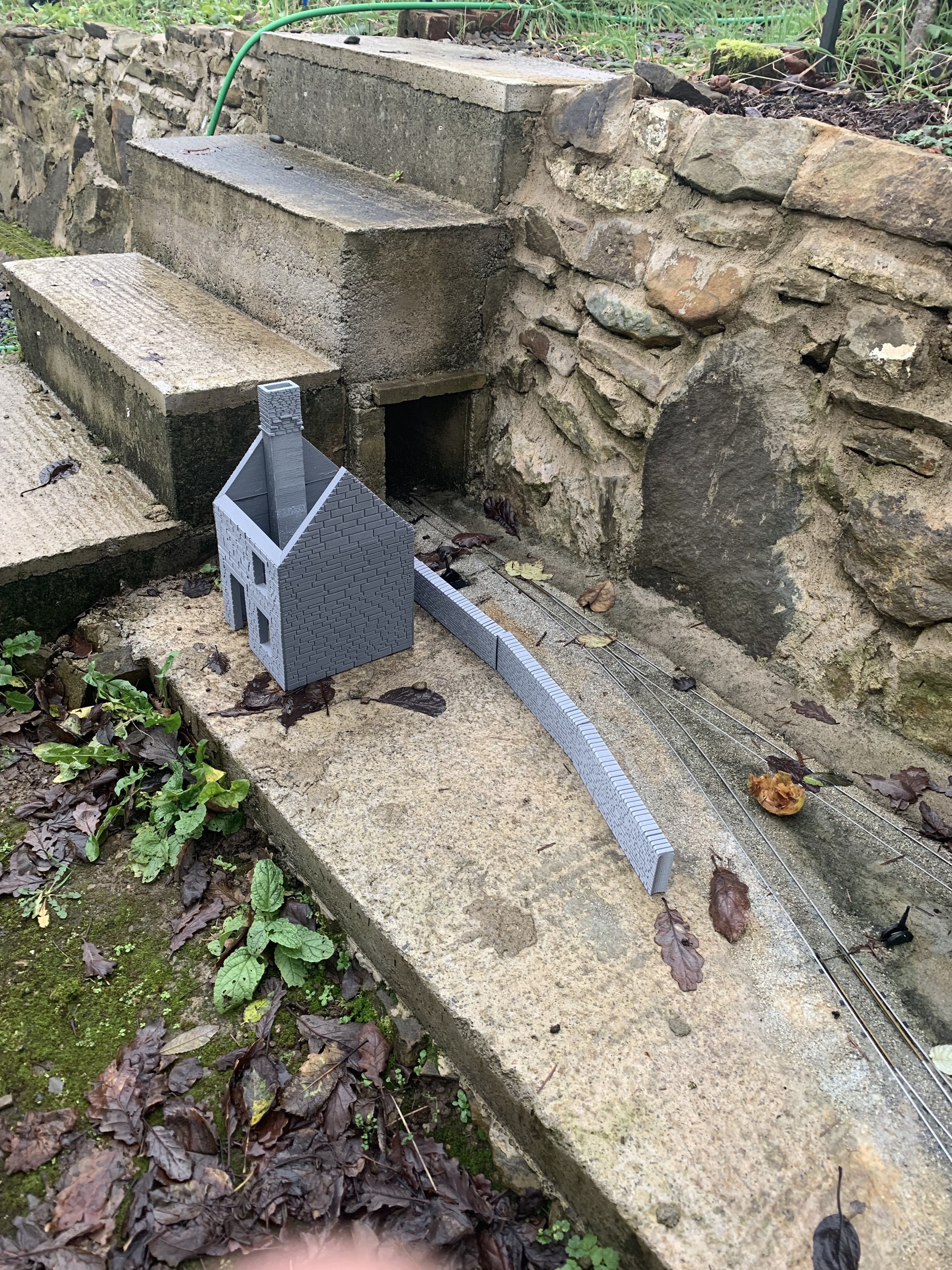

The first buildings to finish off the terminus at Dinas will be cottages under construction, along with the walls separating them from the railway:
The scaffolding and roof beams are being printed, along with another cottage where the walls are only a few feet tall.
Posted: Sat Dec 06, 2025 6:03 pm
Your output over your various projects always amazes me, and this looks to be shaping up well to your usual standards. :D
I know I'm good at having great ideas for other people, but a nice slate tunnel facing to the steps tunnel would finish that corner nicely. Possibly with an angled top face as though the steps were the side of an incline? ( OK, I'll get my coat...!)

Posted: Sun Dec 07, 2025 2:50 pm
by Trevor Thompson
philipy wrote: Sat Dec 06, 2025 6:03 pm Your output over your various projects always amazes me, and this looks to be shaping up well to your usual standards. :D
Yes that tunnel mouth is unfinished. I am grateful for ideas. The only one I have had is from the prototype which has a pedestrian bridge (slate of course) crossing there - but it would disappear into a wall which seems daft - so I have gone no further with it. I will think about the slate tunnel mouth.

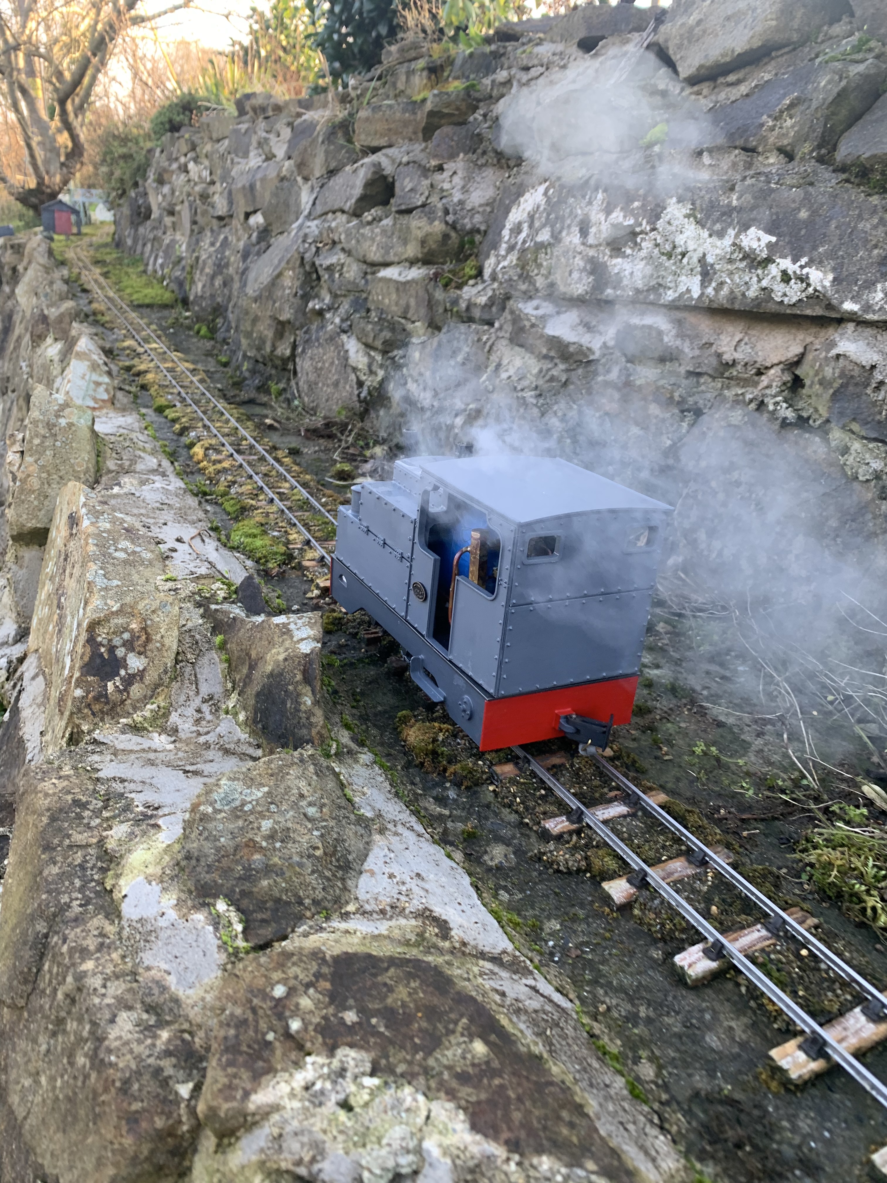

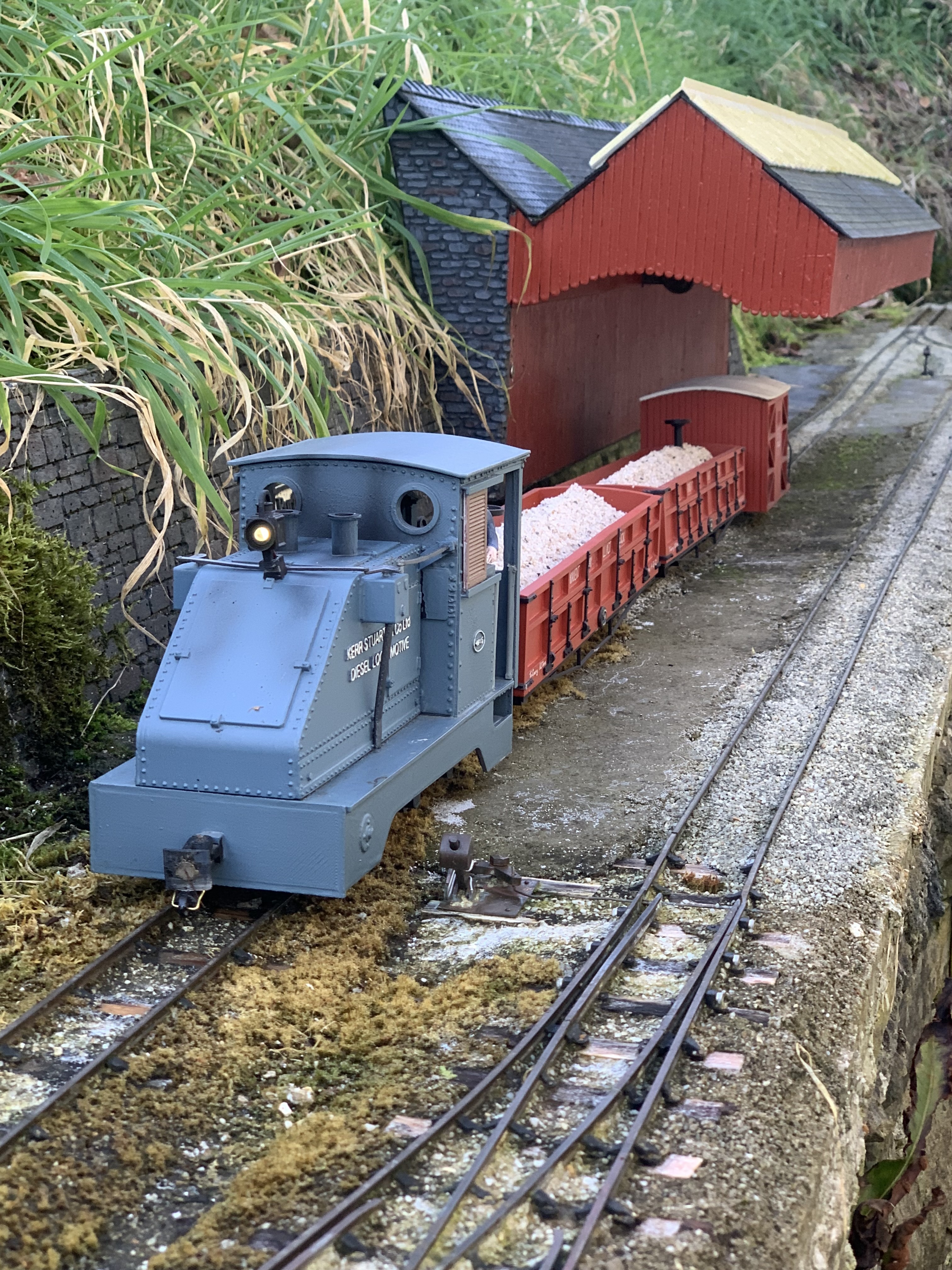

Boxing Day Steamup.
Phil and I started off with the Kerr Stewart sisters ( or should it be brothers) 4415 and 4420. We sent 4415 off up the line with a works train consisting of the bogie ballast trucks, and a brake van while 4420 got steam up.
We soon worked out that the batteries in 4415 were flat. So I went off to fetch Moelwyn - to see if she had enough charge. Moelwyn took the train and set off up the line.
Meanwhile we got 4420 going and sent her off to catch Moelwyn up, with a view of giving her the train to pull.
Unfortunately we had both forgotten that the temperature was only 1 degree celsius, and we were running on Butane. The inevitable happened and she ran out of steam at "Tan-y-Bwlch", when the gas stopped evaporating.
So Moelwyn took the train all the way to "Dinas" ran round and brought it back to the lower terminus.
By that time we were pretty chilled - and we went into the warmth of the kitchen and enjoyed Coffee and Christmas cake by the Rayburn.
