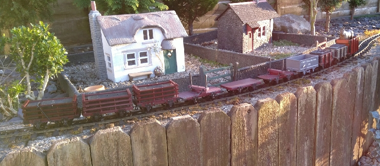

When I saw the first photo I expected to see a snowplough on the other end. Thinking about it, maybe a plough would be useful in pushing aside some of the debris..... :)
Re: (WH)WHR Rolling Stock
Posted: Mon Mar 23, 2020 8:27 am
ge_rik wrote: Mon Mar 23, 2020 8:13 am When I saw the first photo I expected to see a snowplough on the other end. Thinking about it, maybe a plough would be useful in pushing aside some of the debris..... :)
I nearly added a thought about putting a rotating brush on the end, when I made my comment about blades! :D
Posted: Mon Mar 23, 2020 10:54 am
by Andrew
I wondered that... Or a length of draught excluder to sweep the track? Or both?

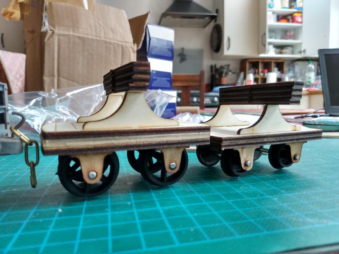

Hello!

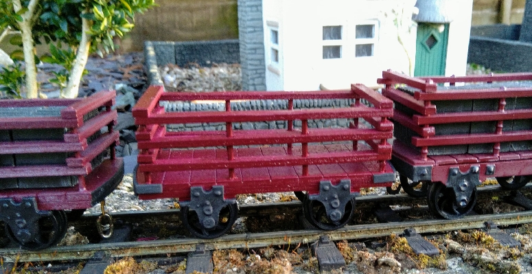

As a relatively rare treat, I've bought myself a kit to build, Lineside Hut's version of the Ffestiniog timber bolsters, which arrived today.
First impressions are that there's an impressive amount of parts to put together, and that they seem well cut, but that for some reason the wagons are expected to ride around on tiny weeny wheels. I didn't like the look of that at all, but fortunately I'd already purchased some Binnie 3 hole disk wheels - that's what the real things have, and the Lineside Hut image of their version features curly spoked wheels, so I knew I wanted to replace them anyway.
There's not enough clearance between wheel and floor to allow a straight swap, so I've had to cut out two additional "sub chassis" to provide the space, which creates a chunkier looking frame. I think that looks OK, but compare for yourselves - my altered version's on the left, with the original on the right, both just held together by gravity for now
Bolster 1.jpg (101.91 KiB) Viewed 11029 times
Those aren't the disk wheels on the left hand wagon, I haven't dug those out of the cupboard yet, but they're the same size. For reference, the original bolsters are here, with a slate wagon between them as a match wagon: https://www.festipedia.org.uk/w/images/ ... er_Set.jpg
Time to break open the glue...

Definitely like your version on the left Andrew, it has the proportions of the very worn ones Peter Butler used to make his models. It also seems to better match the coupler height of your slate wagon on the extreme left of your pic.

Andrew wrote: Fri Apr 17, 2020 4:11 pm Hello!

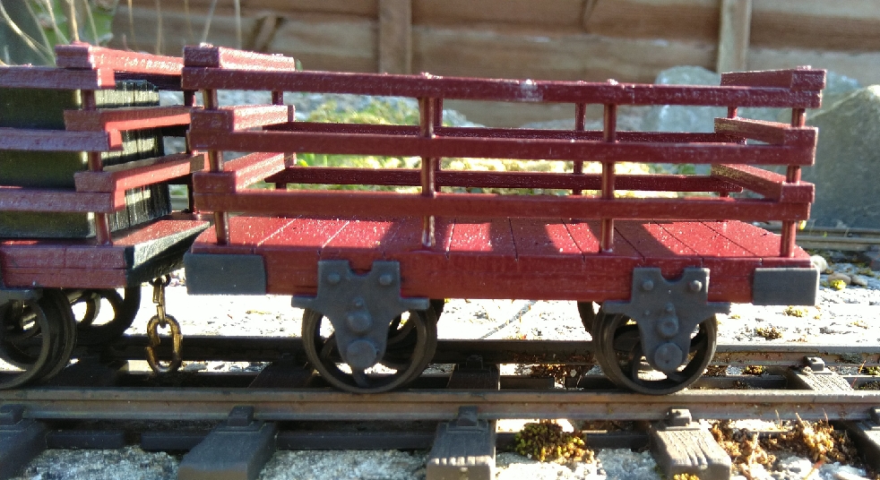

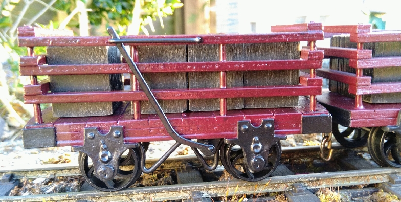

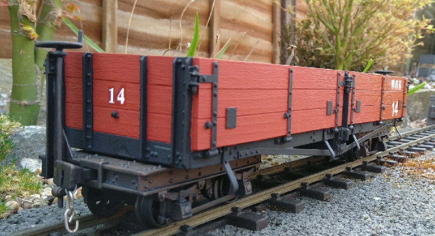

Speaking of Lineside Hut:
Braked wagon. This is just some brass wire...
This was a Lineside Hut flat wagon....
All the Lineside Hut wagons have thickened chassis (using plastic strip), plastic buffing heads and IP axle boxes. The old wheels do not fit using the axle boxes, hence the thickened chassis.

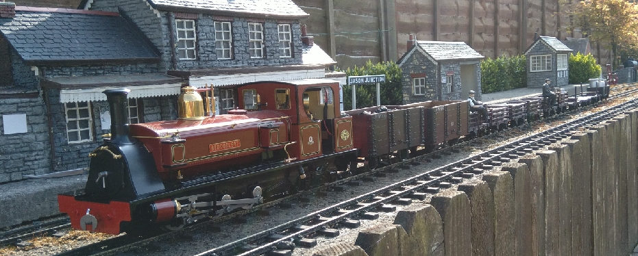

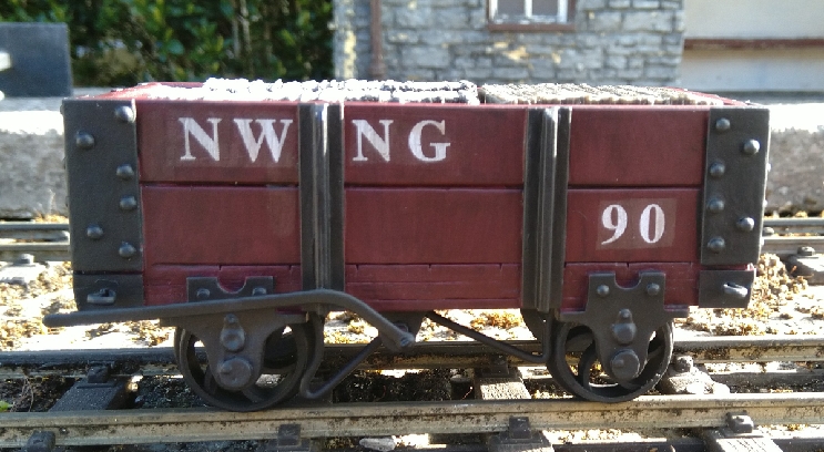

Beddgelert is having to work a bit harder now...
Binnie wagon, representing no. 79, the last FR original wooden slate waggon. It now lives at Gelert's farm museum.
Swift Sixteen WD D wagon liveried as one of the Beddgelert coal traffic wagons. Needs dirtying...
We still have some Lineside Hut kits being modified in the same way. Carriages in the works include replica summer carriage 24 (the red historic carriage on the WHR), porthole bug box 12 and WHHR carriage 6 in red and white livery.

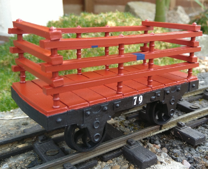

With the larger wheels, and slightly recessed into the floor, i think it looks closer to the real thing.

I liked the very worn appearance so took my inspiration from an old photograph.....
Unsure about the source of dimensions but it might have been a Colin Binnie drawing? Anyway they came out OK.....

Your right Andrew, the left one is looking better by far.
Take some beating your's Peter..Will you make me a couple.... :lol: :lol:

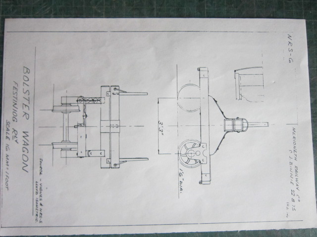

Andrew, I have found my Binnie drawing of the bolster wagon, it might be some help to you?.....

I've been trying not to think about your lovely wagons Peter - they make me wonder why I splashed out for a kit to produce a model that won't be as good as yours! It was the thought of cutting the curves that put me off, and I thought the kit would be a treat, but I'm beginning to wonder... I've just discovered that once the larger wheels are set at the correct back-to-back they no longer fit between the frames, so further surgery will be required. And then there's the question of trying to make the MDF axleboxes run smoothly... If I wanted a treat I think I should've splashed out even more for the Harecroft version... Oh well...

I was tempted, but have persevered with the ones in the kit, partly because I've already replaced the wheels and would rather not add further expense.
I think I've got these running ok now - the biggest problem seemed to be when the axles strayed too far to one side and snagged on the irregularities between the two thicknesses of the axlebox assemblies. That's sorted with the help of some little collars from biro inners - I think you'd struggle to find a model I've made in the last ten years that doesn't include a bit of biro somewhere or other!
They're VERY light and will definitely need extra weight, although a good chunky load should help...

Peter Butler wrote: Sat Apr 18, 2020 12:20 pm Andrew, I have found my Binnie drawing of the bolster wagon, it might be some help to you?.....
Lovely, thanks Peter! Mine appear to be too short, but that adds little chunkiness which I quite like...

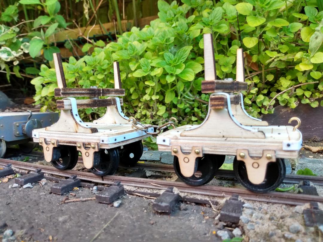

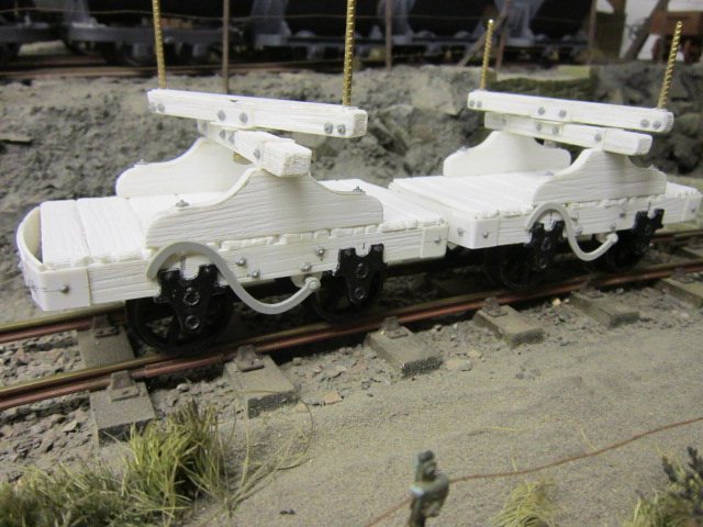

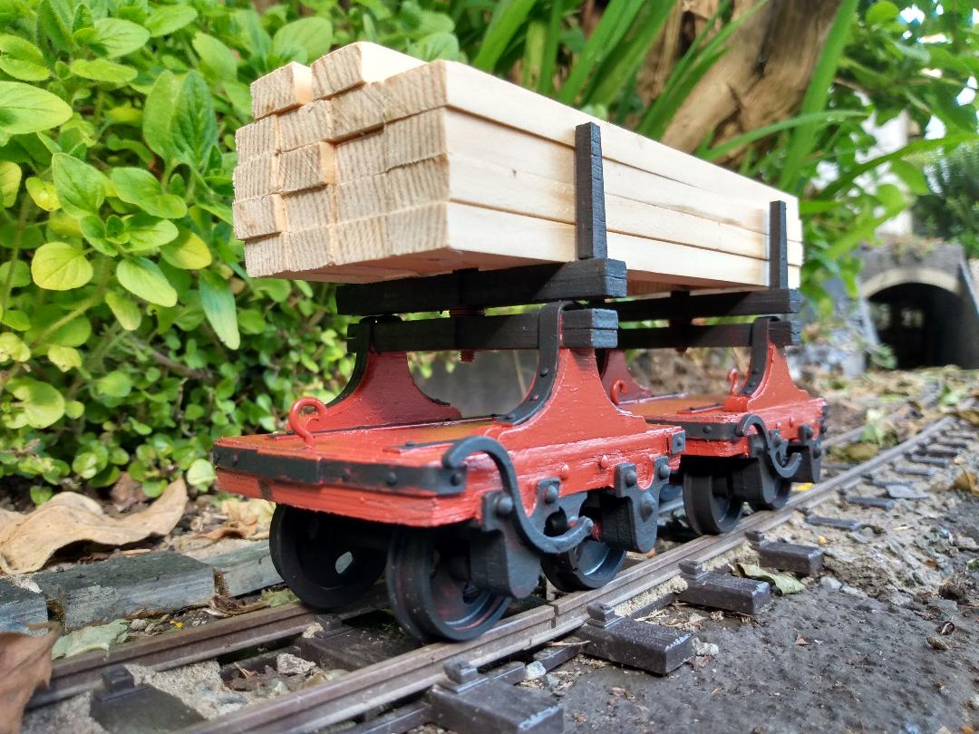

Hello again,
I've added the strapping now. I quickly realised that I wasn't going to get anywhere with the brass strip provided (painting would've been tricky too), so have substituted plastic strip, fixed down with glue and good old Peco track pins:
Bolster 3.jpg (167.24 KiB) Viewed 11856 times
The swiveling part of the bolster itself sits a little high due to some modifications I made to ensure that they would move freely, but I think they'll look OK painted and with a load perched on top.
Adding the rivets in the axleguards caused more drama when I found that they fouled my new, larger, wheels - everything had to come out again for modification. I'm fairly sure there's a reason that most 16mm manufacturers don't use MDF axleguards, but after much tweaking I seem to have got the wheels running pretty freely for now...
Further detailing and painting next...

Your additional detailing has made an enormous difference, they don't look like the same kit.

They are certainly unique and well built.

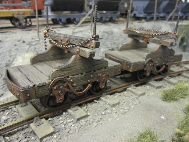

Hi all,
Nearly there with the bolsters:
Bolster 4.jpg (163.09 KiB) Viewed 11760 times
They're not fantastically accurate, more a kind of pastiche of the real thing, but they'll do. They await the addition of numberplates (on order) and chains (purchased from an eBay craft supplier), then a little weathering and they'll be done - then it's on to the next project...
In addition to this load of sawn timber (also awaiting chains), I've prepared a log load too - those are a little longer and will require the use of a slate wagon as a match truck.
