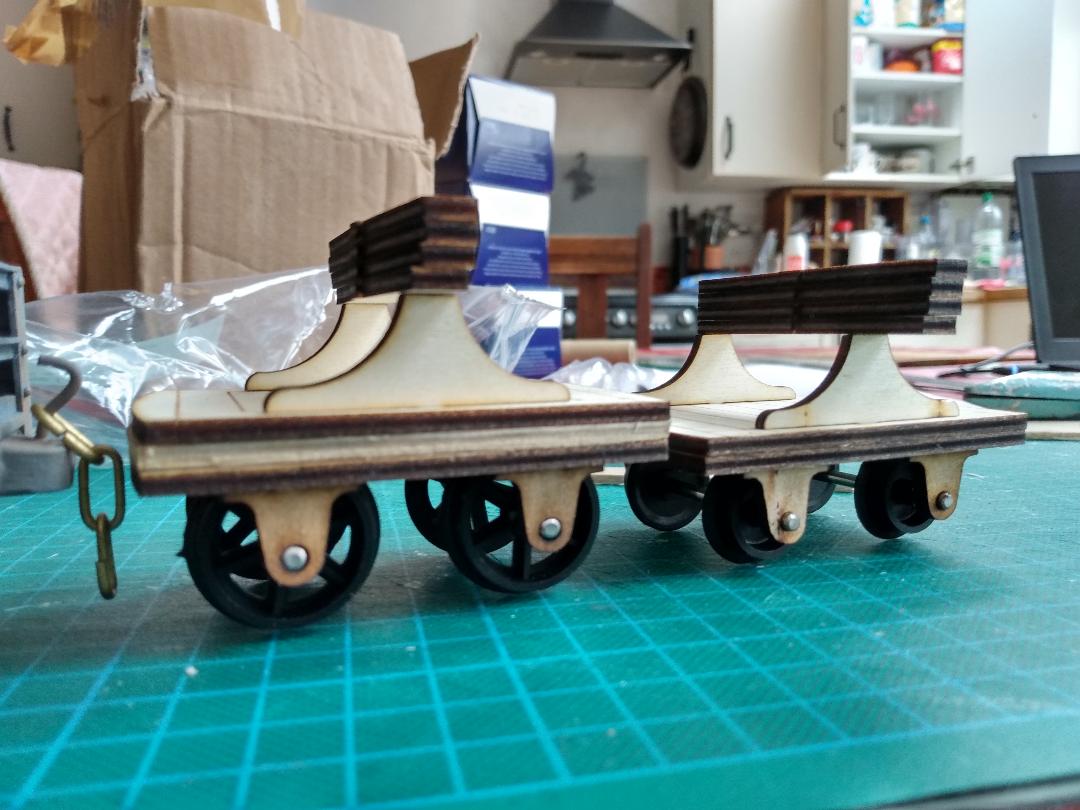

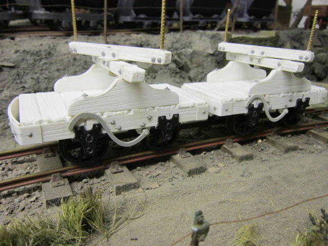

As a relatively rare treat, I've bought myself a kit to build, Lineside Hut's version of the Ffestiniog timber bolsters, which arrived today.
First impressions are that there's an impressive amount of parts to put together, and that they seem well cut, but that for some reason the wagons are expected to ride around on tiny weeny wheels. I didn't like the look of that at all, but fortunately I'd already purchased some Binnie 3 hole disk wheels - that's what the real things have, and the Lineside Hut image of their version features curly spoked wheels, so I knew I wanted to replace them anyway.
There's not enough clearance between wheel and floor to allow a straight swap, so I've had to cut out two additional "sub chassis" to provide the space, which creates a chunkier looking frame. I think that looks OK, but compare for yourselves - my altered version's on the left, with the original on the right, both just held together by gravity for now

Post by LNR » Sat Apr 18, 2020 3:22 am
Definitely like your version on the left Andrew, it has the proportions of the very worn ones Peter Butler used to make his models. It also seems to better match the coupler height of your slate wagon on the extreme left of your pic.

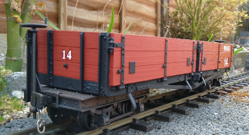

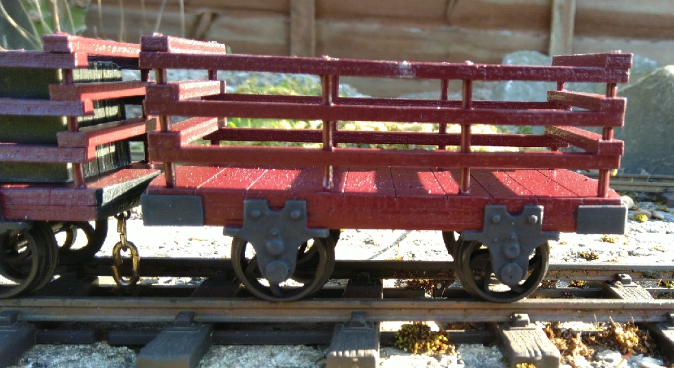

Braked wagon. This is just some brass wire...
This was a Lineside Hut flat wagon....
All the Lineside Hut wagons have thickened chassis (using plastic strip), plastic buffing heads and IP axle boxes. The old wheels do not fit using the axle boxes, hence the thickened chassis.
Beddgelert is having to work a bit harder now...

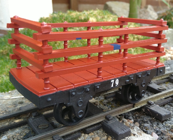

Binnie wagon, representing no. 79, the last FR original wooden slate waggon. It now lives at Gelert's farm museum.

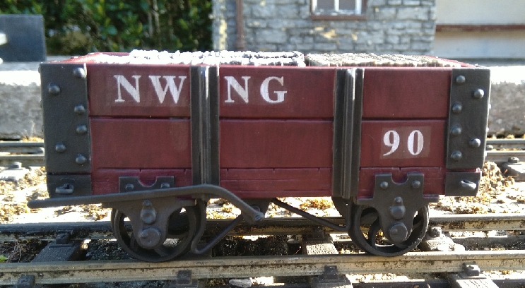

Swift Sixteen WD D wagon liveried as one of the Beddgelert coal traffic wagons. Needs dirtying...
We still have some Lineside Hut kits being modified in the same way. Carriages in the works include replica summer carriage 24 (the red historic carriage on the WHR), porthole bug box 12 and WHHR carriage 6 in red and white livery.

With the larger wheels, and slightly recessed into the floor, i think it looks closer to the real thing.

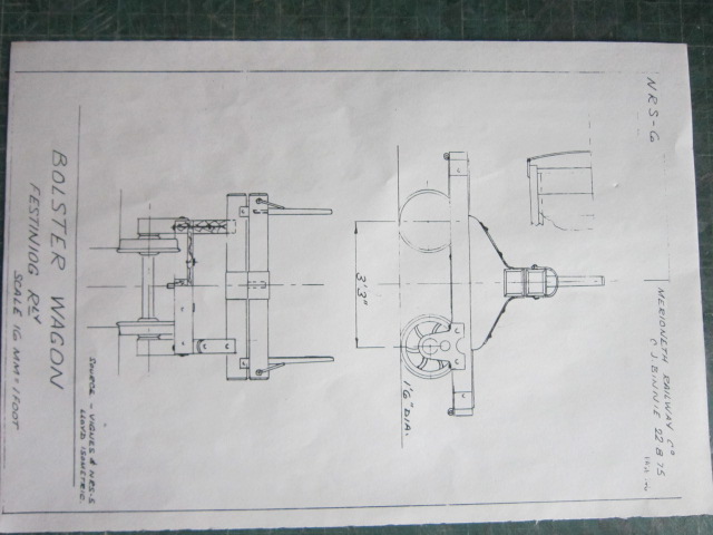

Andrew, I have found my Binnie drawing of the bolster wagon, it might be some help to you?.....

Peter Butler wrote: Sat Apr 18, 2020 12:20 pm Andrew, I have found my Binnie drawing of the bolster wagon, it might be some help to you?.....
Lovely, thanks Peter! Mine appear to be too short, but that adds little chunkiness which I quite like...

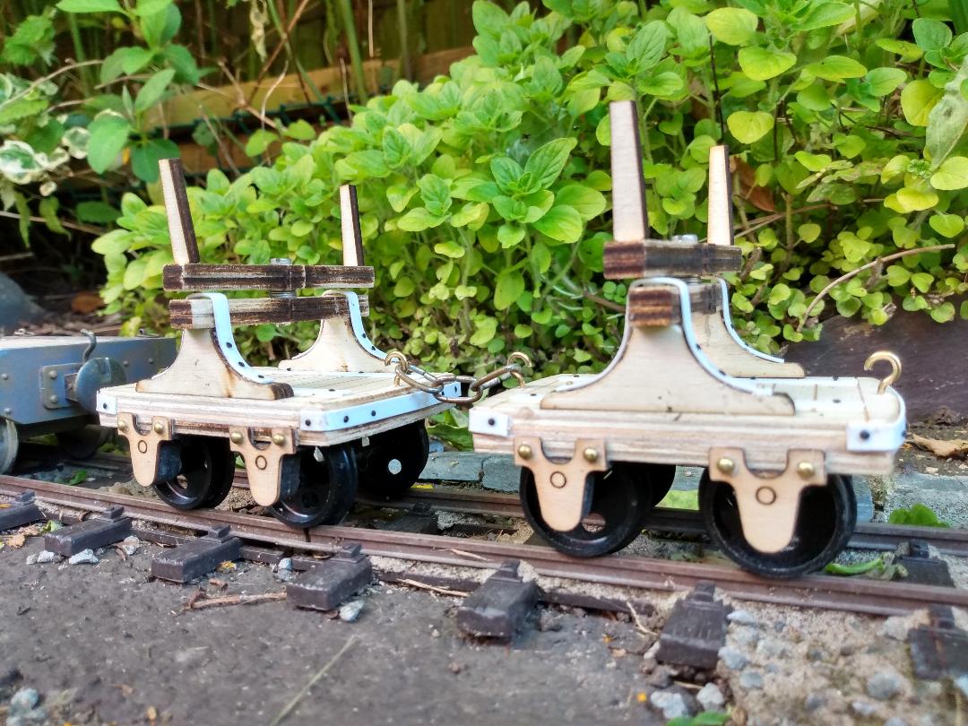

Post by Andrew » Sun Apr 19, 2020 5:28 pm
Hello again,
I've added the strapping now. I quickly realised that I wasn't going to get anywhere with the brass strip provided (painting would've been tricky too), so have substituted plastic strip, fixed down with glue and good old Peco track pins:
Bolster 3.jpg (167.24 KiB) Viewed 11850 times
The swiveling part of the bolster itself sits a little high due to some modifications I made to ensure that they would move freely, but I think they'll look OK painted and with a load perched on top.
Adding the rivets in the axleguards caused more drama when I found that they fouled my new, larger, wheels - everything had to come out again for modification. I'm fairly sure there's a reason that most 16mm manufacturers don't use MDF axleguards, but after much tweaking I seem to have got the wheels running pretty freely for now...

Posts: 5689
Re: (WH)WHR Rolling Stock
Post by Peter Butler » Sun Apr 19, 2020 5:36 pm
Your additional detailing has made an enormous difference, they don't look like the same kit.

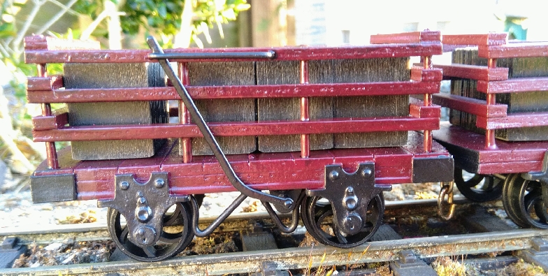

Post by Andrew » Fri Apr 24, 2020 5:00 pm
Hi all,

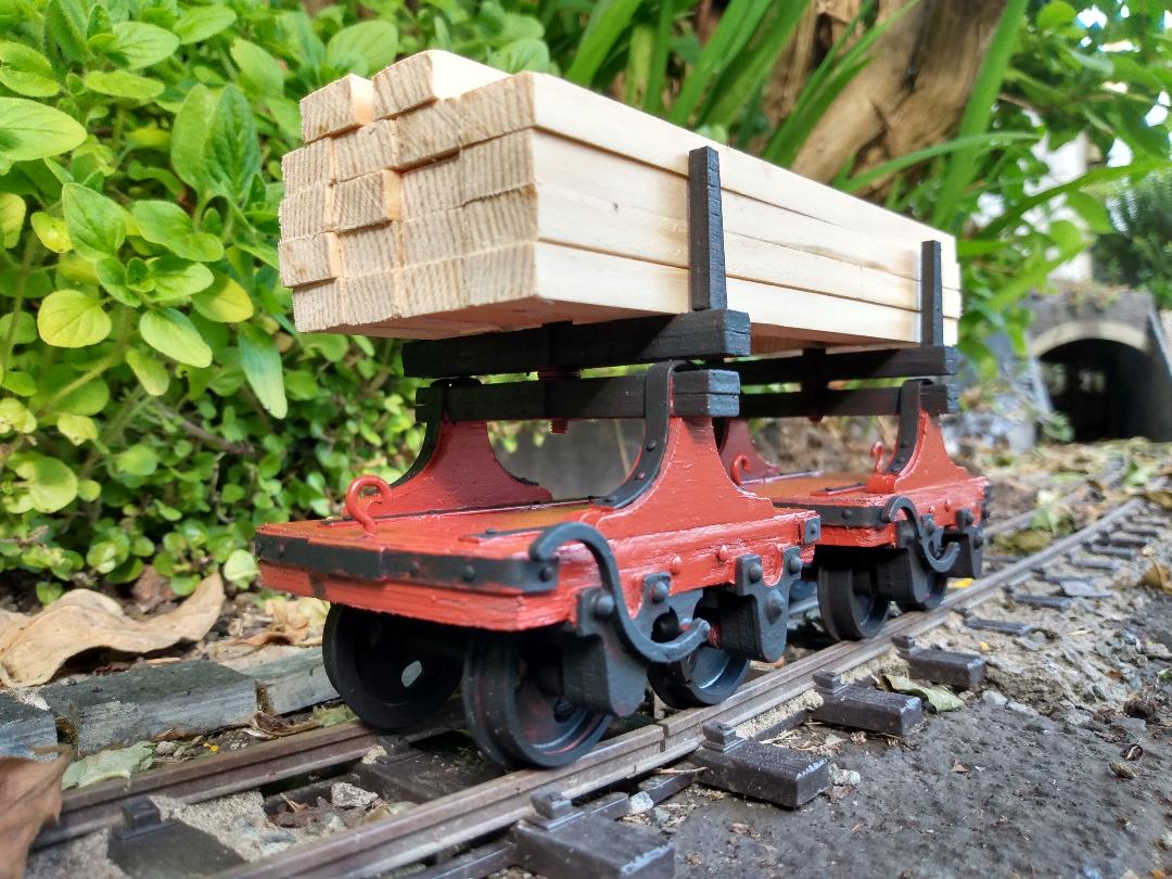

Nearly there with the bolsters:
Bolster 4.jpg (163.09 KiB) Viewed 11754 times
They're not fantastically accurate, more a kind of pastiche of the real thing, but they'll do. They await the addition of numberplates (on order) and chains (purchased from an eBay craft supplier), then a little weathering and they'll be done - then it's on to the next project...
In addition to this load of sawn timber (also awaiting chains), I've prepared a log load too - those are a little longer and will require the use of a slate wagon as a match truck.
