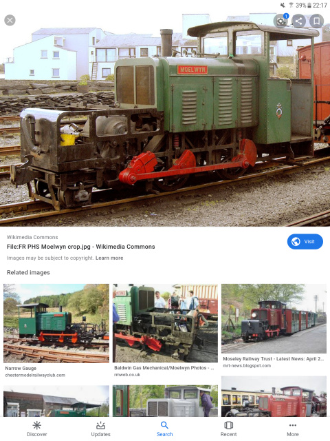

Hi. JMORG.
While researching colours i found these-
See main image and the one bottom right. Both FR.

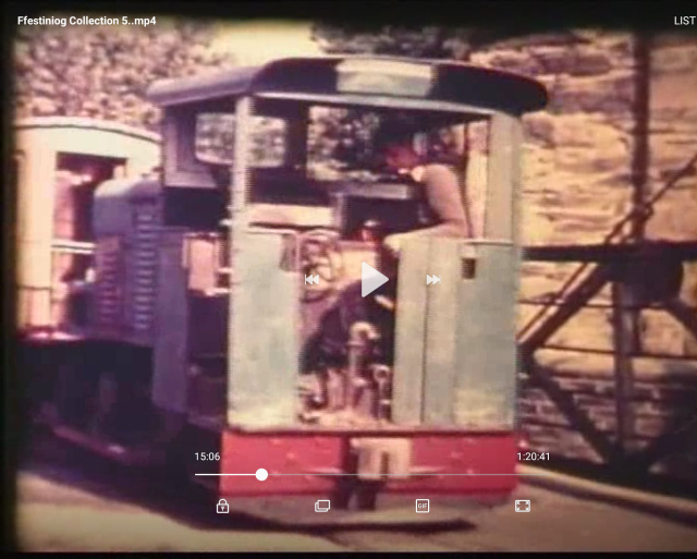

Also -
This is a still from a film from the early preservation days at Bleanau F. Looking at the film clip it appears to be pale blue.
I ended up painting mine maroon :?

According to the 7mm Assoc's book of FfR drawings, "tractors, introduced during the Stephens period, were plain green with black running gear. The Baldwin may have sported red painted rods and fly cranks".
I guess that's either the kind of mid, kind of municipal-looking, green seen in the pictures, or maybe whatever shade of green they came in from the WD?

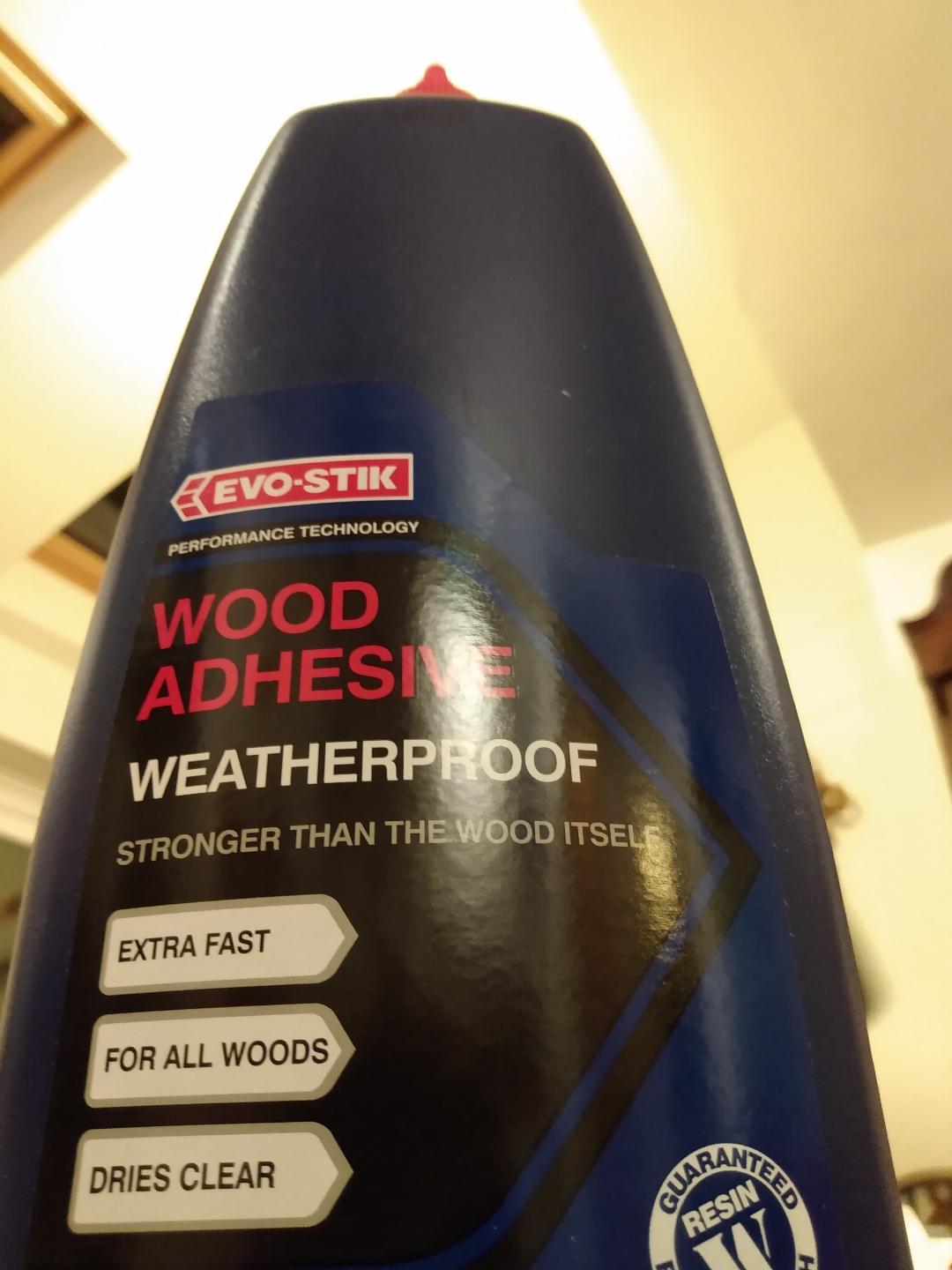

No word from work (a university library) yet on whether (or to what extent) we'll close due to the current crisis, but I'm assuming events will overtake the decision-makers at some point and I'll find myself with a fair bit of time on my hands. There's some DIY to be done, but while I was in Screwfix this afternoon stocking up on paint supplies in readiness, I also bought myself this - THE WORLD'S BIGGEST bottle of wood glue:
There's a litre of it! Should be able to amuse myself with that for a while. Constructing rolling stock, I mean, not sniffing it...

Do you intend to decant into a smaller more usable container Andrew. Just wondering, depending on the glues makeup exposure to air and evaporation, hope you get to use all of it.

Good point, thanks Grant. I didn't actually want one that big, but it was all that was available, it was cheap, and I managed to sneak it out of the household budget... I'll decant it into some glass jars I think...
Re: (WH)WHR Rolling Stock
Post by FWLR » Thu Mar 19, 2020 8:06 am
Those small squeeze bottles you get now that self close would be ideal Andrew.

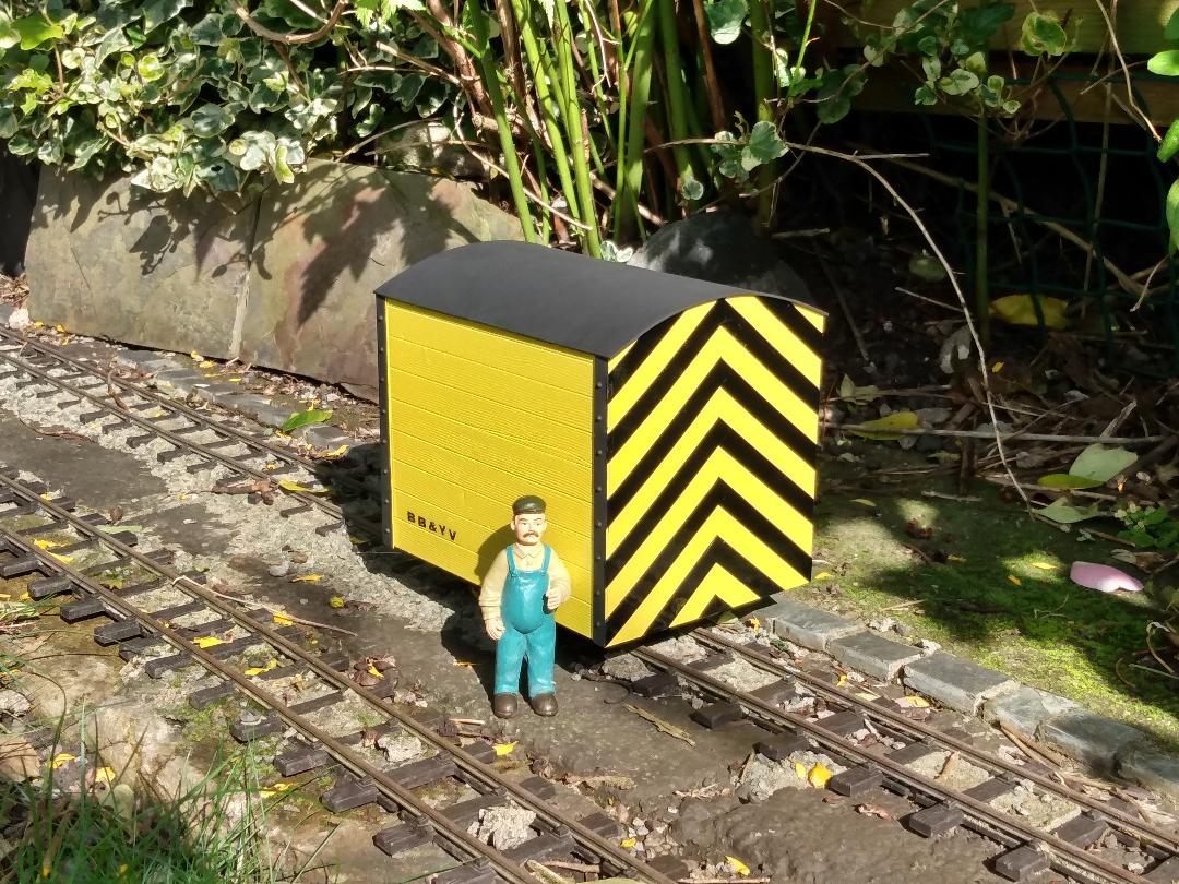

Morning all!
On the whole, I'm not a terribly fast worker. Work, family and other commitments mean that even a simple wagon build can take months to complete, or even longer.
Not this one! This curious beast took me less than a week start to finish:
BBYV 1.jpg (214.15 KiB) Viewed 12714 times
That's not its best side, but even its best side is pretty ugly! It's built entirely from foam board on an old Faller chassis, and has a huge lump of wood inside for weight. As far as I recall, it's also the only thing I've ever sprayed yellow.
So what is it? It certainly doesn't look like anything that ran on the old Welsh Highland, or anywhere else come to that, it lacks detail, is much bigger than most of my other wagons, and with a coupling at only one end it won't be much use in a train...
Well... It's my answer to Network Rail's Structure Gauging Train. I like to have vegetation growing near to the tracks, but find it hard to judge how close is too close, resulting in derailments, damage, and carriages streaked with oil that locos have deposited on overhanging leaves. This wagon is designed to solve that - it's slightly bigger than my biggest loco, so before each run I'll simply attach it to a battery engine and push it slowly up the line, clipping anything that it comes into contact with. I just had a trial run, and it worked really well - those wasp stripes are actually quite useful in spotting leaves etc!

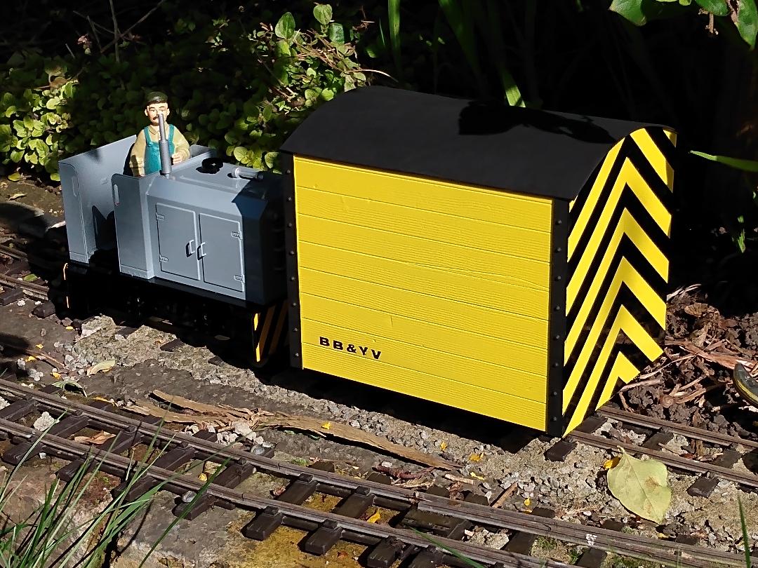

Here it is attached to my new battery loco:

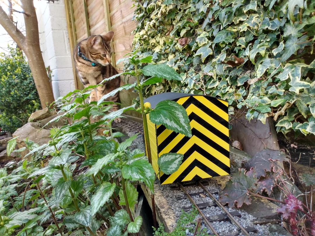

And again, this time in action - ivy can be quite a hazard for trains, as can Ivy, next door's lovely but very inquisitive cat:
BBYV 3.jpg (245.84 KiB) Viewed 12714 times
If this weather holds and find myself at home next week, I imagine I may run the odd train - got to keep my spirits up, eh?

Good idea Andrew, hope the wasp stripes keep everything clear ahead cause that driver needs a periscope :lol:
Post by Andrew » Sun Mar 22, 2020 12:08 pm
LNR wrote: Sun Mar 22, 2020 11:57 am Good idea Andrew, hope the wasp stripes keep everything clear ahead cause that driver needs a periscope :lol:
I did actually considering adding one, or perhaps a window in the end of the van, but the urge to finish this one quickly and crack on with other things was too strong...
