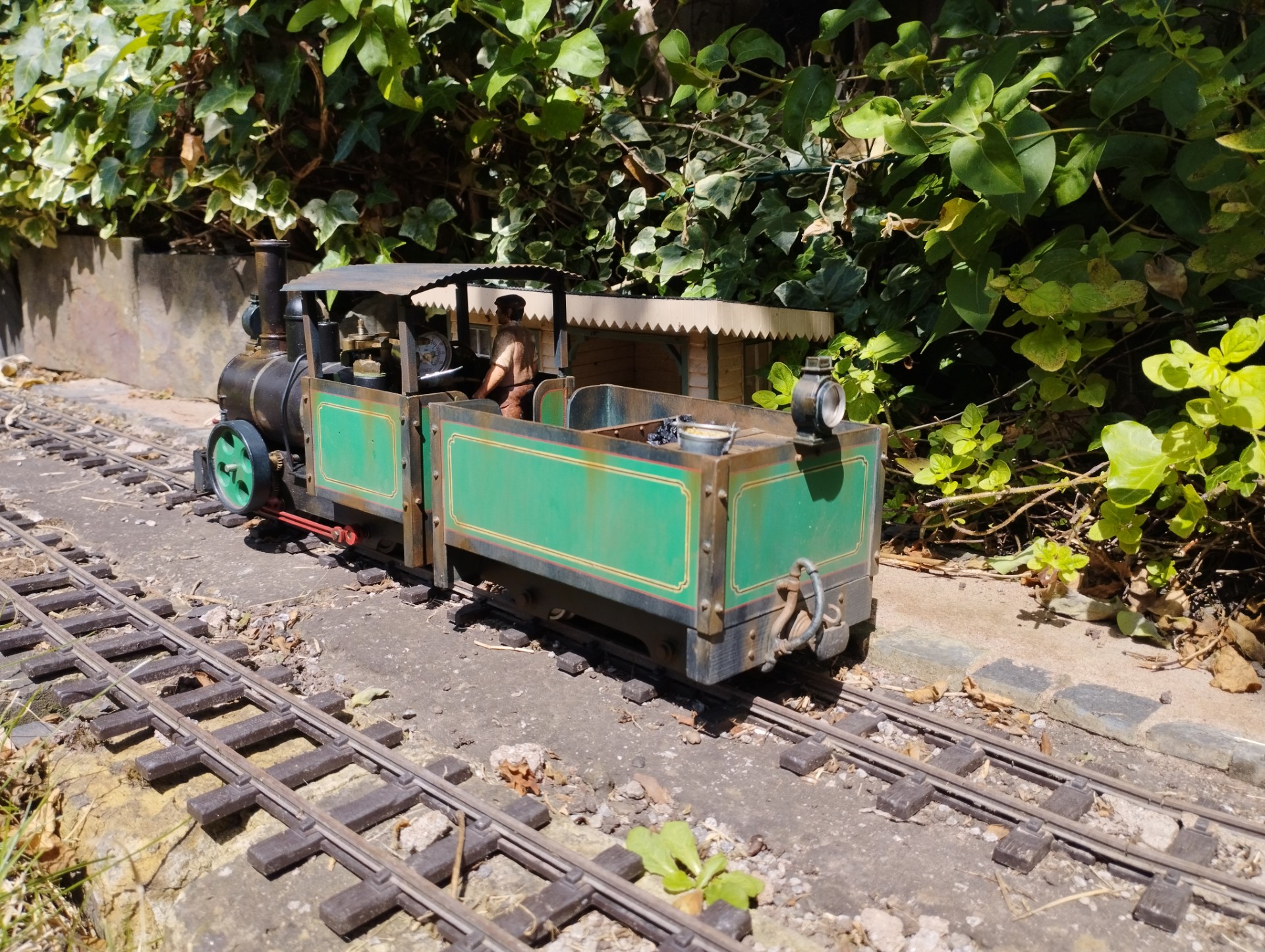

That tender really is quite good; I like the seating in there and the water tank looks very good with the rivets and the coal space in front. I have never had the nerve to try lining- I must say yours looks as good as any I’ve seen.

Another little masterpiece in the making Andrew. Love the woodwork and, as others have said, full marks on the lining. I'd never be able to hold my breath long enough to manage even one line.

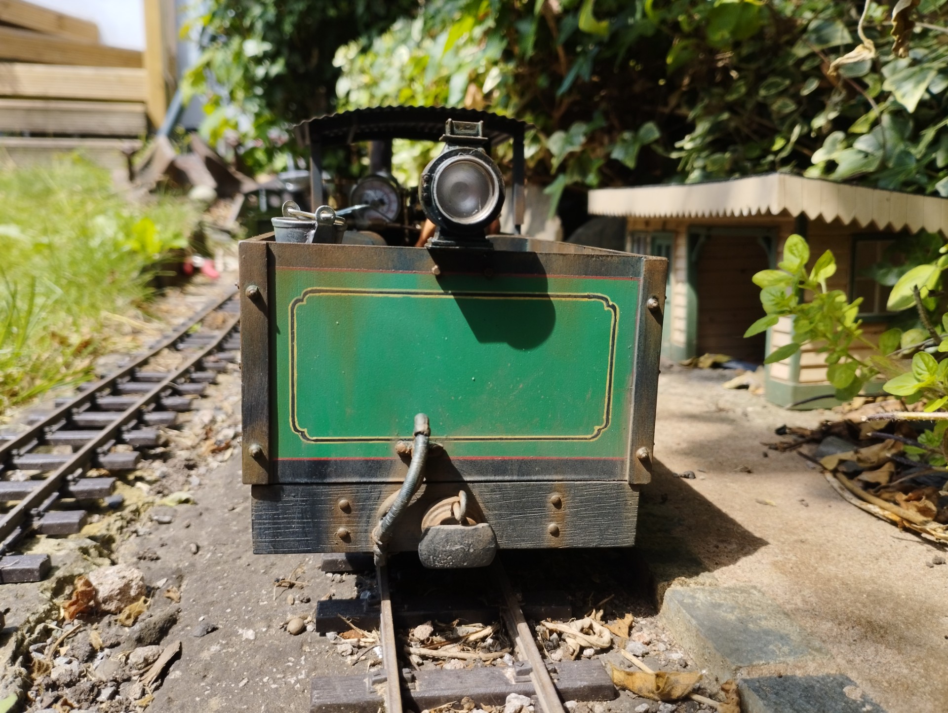

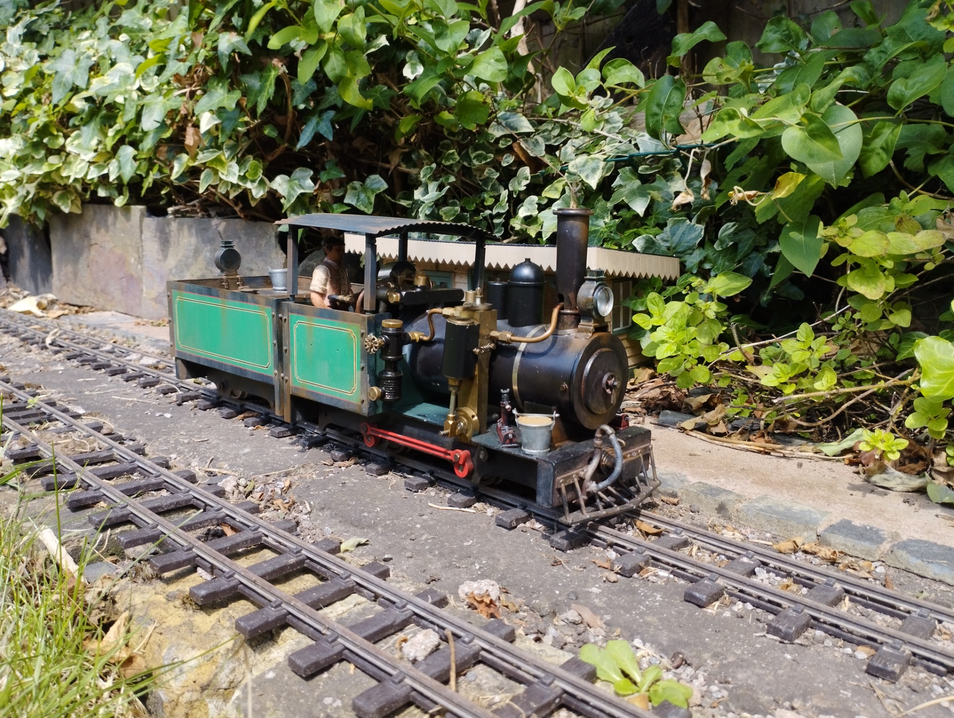

The Regner revamp is almost complete, with the loco posing for official photographs yesterday:
I honestly don't know what "Daisy" represents exactly - a German/US/colonial loco that's inexplicably painted like a Victorian express engine, yet allowed to get covered in grime (which looks a little more subtle in real life!). There's much about it that suggests industrial service, yet it has vacuum brakes. And a very generously proportioned tender...
In reality, when I spend a good chunk of my modelling time trying to recreate actual historical stuff fairly accurately, I think it's just nice to mess about sometimes!
Alas, the test run wasn't a huge success, with the loco really not happy pushing the tender in reverse, which is kind of essential on my end-to-end line! The problem appears to be the coupling between the two where both theory (that a solid link between two multi-hight couplers would prevent buffer locking when, in reality, it just swivels out of the way) and practice (I didn't get 'em at the same hight) were flawed.
For now, I'll revert to running without the tender, but in the medium term I think big old semi-circular Dareeling-style couplings should do the trick...

Re: Daisy, Daisy...
LNR wrote: Tue Jul 30, 2024 1:03 am Hi Andrew, just love the weathering on the loco. A top job.
Regarding your problem running tender first, I have had similar problems in the past, and in my experience it comes down to the length of the solid coupling bar. I couldn't push the extremely light timber bogies in an unloaded state with scale length coupling bars, so made longer ones and fixed the problem. Short bars seem to use the slack in the gauge to quickly move to a jack knife angle and a derail is the end result. Longer ones don't allow the extreme angle to happen. If you could move the pivot point on the tender further aft (can't see if its a bogie or fixed wheel) like the bogie pivot point I'm sure it will eliminate the problem. Hope I've explained that well enough!
Hi Grant, and thank you!

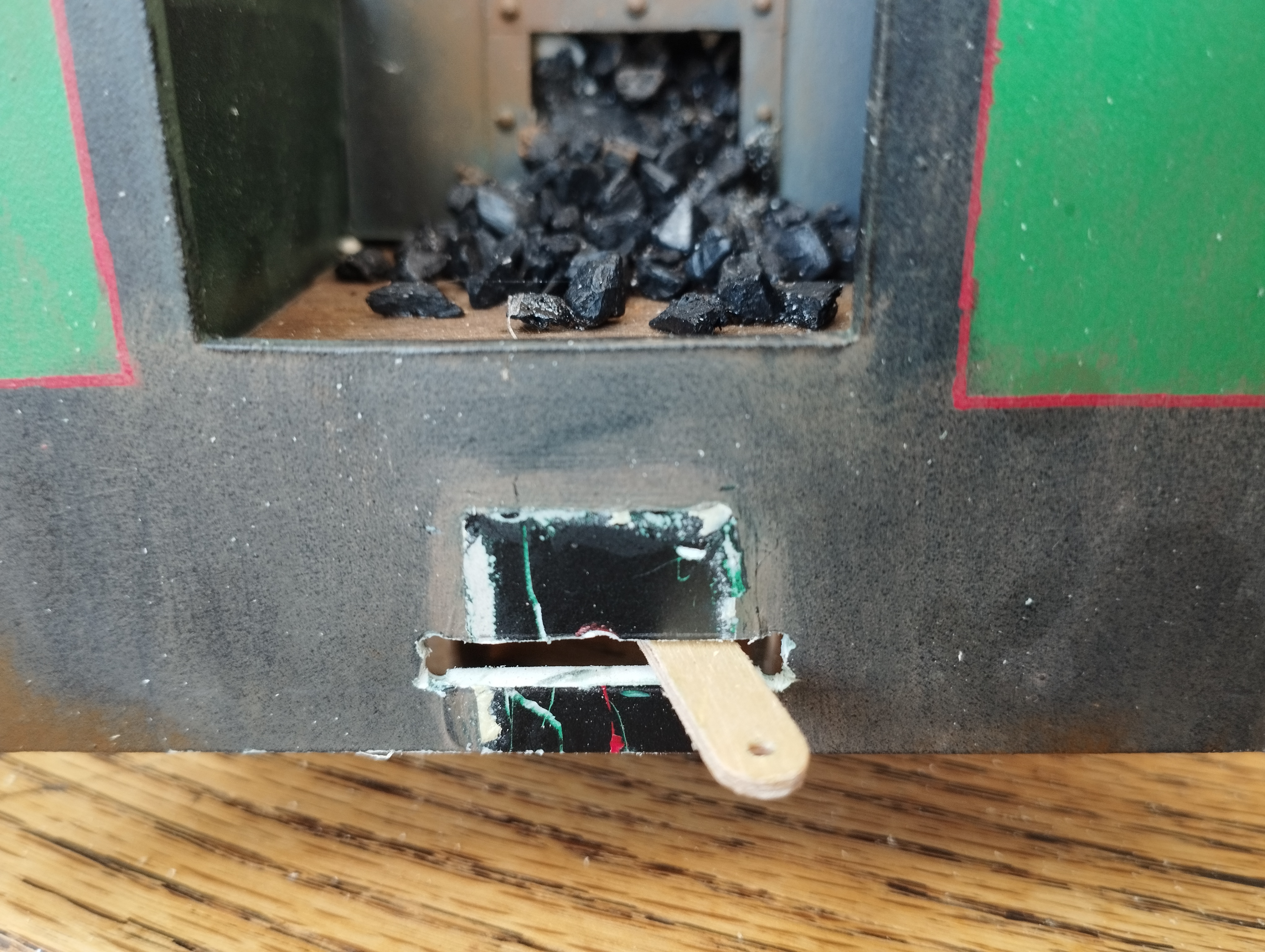

That makes a whole lot of sense. I happened to have this afternoon off work, so I've made a rough version of what I think you were suggesting - I removed the buffer/coupling from the tender, cut a slot instead, and added a new, much longer drawbar, pivoted about 3/4 of an inch back.
It's all temporary and untidy for now, but if it works ( I may not be able to test it for a while) I'll tidy it up and find a length of brass strip to make a permanent drawbar. Keep your fingers crossed!

Hi all!
I'm pleased to report that I managed a quick test run this afternoon, and things are looking up...
There were far fewer derailments, and the loco and tender can now traverse even the tight reverse curve formed by the pairs of small radius points at the outer end of each run-round loop. That leads me to think that there's not much problem with lateral movement of the new set up.
There was still an issue every now and then, however, seemingly where the track is particularly uneven. I think the coupling is too rigid to allow the loco and tender to negotiate these undulations - given that they're now happy on curves, I think the issue might be insufficient vertical movement between them?
Potential solutions seem to include making the slot in the tender buffer beam deeper, loosening the screw that forms the pivot, enlarging the holes at each end of the drawbar to allow more play - or all of the above?
Further thoughts would be most welcome!

- Posts: 1897
Re: Daisy, Daisy...
I agree with all of those points Andrew, our little locos do need a lot of freedom coupling wise in both the vertical and the horizontal planes. Copying the Fowler coupling blueprints shows both a vertical pivot and a lateral one given the uneven track work they had to negotiate.Andrew wrote: Sun Aug 04, 2024 8:39 pm Potential solutions seem to include making the slot in the tender buffer beam deeper, loosening the screw that forms the pivot, enlarging the holes at each end of the drawbar to allow more play - or all of the above?
