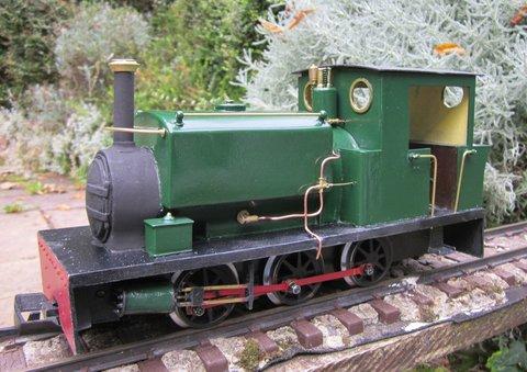

Here's the finished loco btw - I probably could have got away with a less smooth finish to the boiler as it's largely hidden by the sandbox - but I would have known it was there!

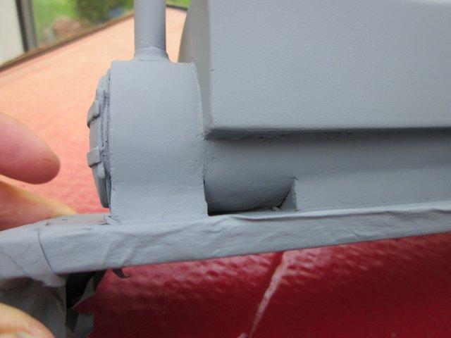

Here's the same area just before the primer was rubbed down.

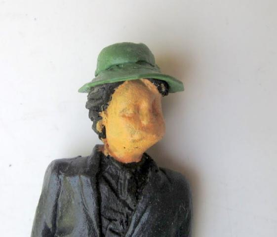

I've used Green Stuff in a limited way to modify figures (a la Wargaming). Mostly I've added hats or lengthened dresses/skirts to make bought models more appropriate for the 1930s - eg
