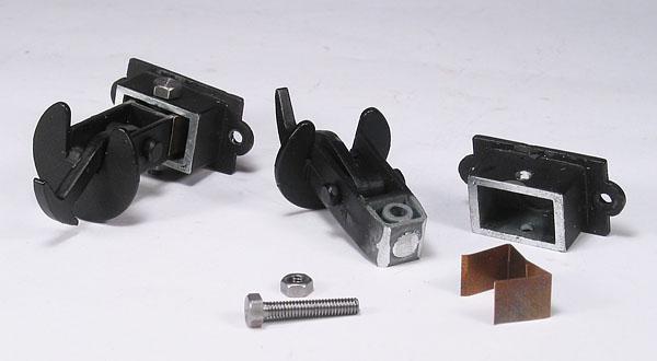

Thanks Tom,tom_tom_go:76453 wrote:here are the pics of the modified coupler you wanted (sorry it took so long!)
Interesting, the W&L couplers have less metal around the pivot than the L&B type.
I shortened the couplers on my locos last week, but only managed to reduce the overall length by 1/8". I ended up fitting side control springs, made out of phos bronze sheet, to keep the shank centred. The spring is the W shaped bit in the photo.

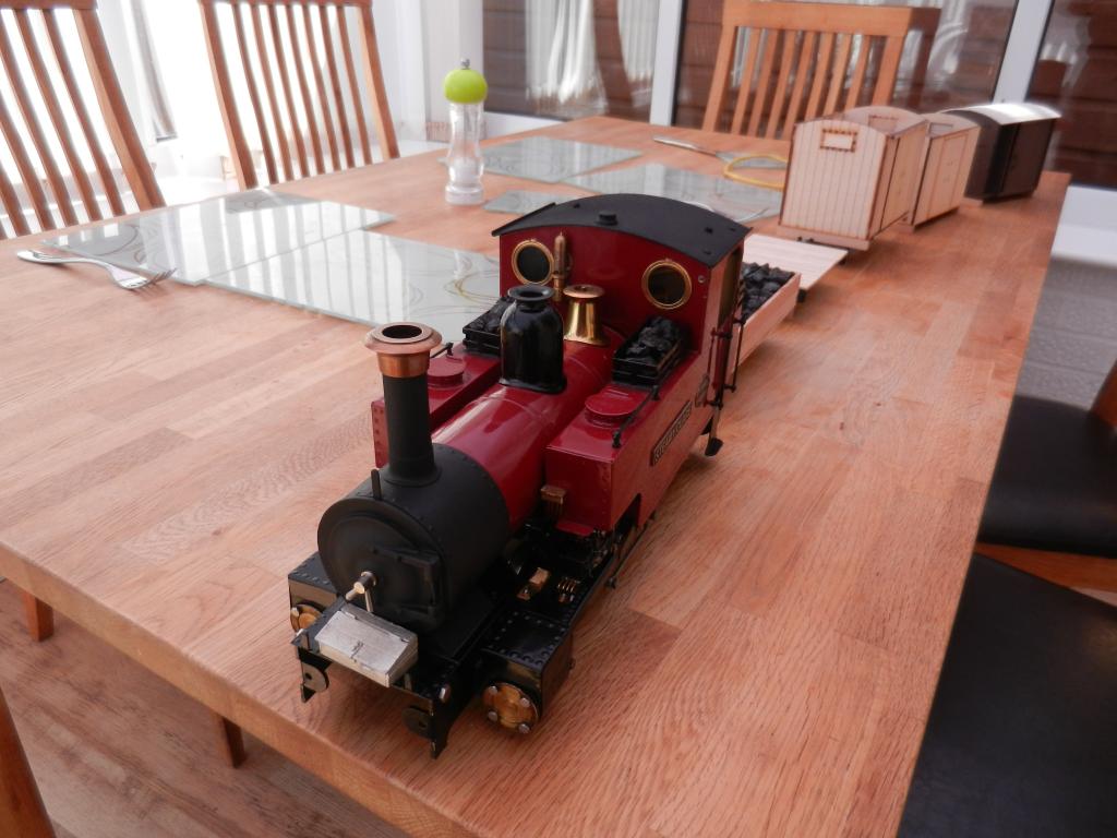

Don't use Wickes Heat Shield Spray paint as it is complete rubbish for locos as it does not cure until it reaches at least 315°C. I only found this out after spending ages spraying the smoke box for my SL and now every time I touch it just starts to rub off depsite being in the oven for a hour! I did degrease and key the surface first so I can only assume it is the curing that is at fault.
I have ordered some gel paint stripper to remove it all and then will spray with Hotspot Stove and Fireplace paint instead which cures at 250°C which is a temperature my oven can reach.
Hopefully, I will have some pictures of a success soon!
Da dah!
(Thanks to Chris Bird for his advice along with his paint guide!)

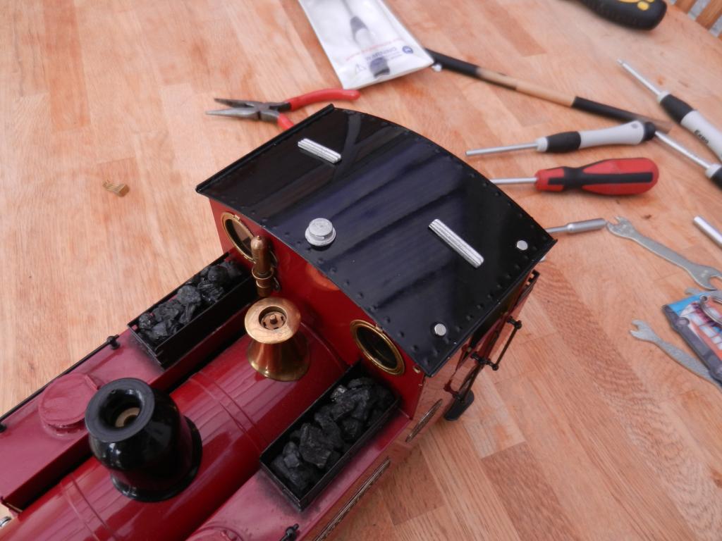

I am going to paint the roof the same colour and mod it as shown as I do not like the imitation sliding roof vent that RH use and the big hole that is drilled for the aerial to poke out of (the front roof vent covers this now as in the picture):
The little vents you see cover the holes where the original battery box use to be fitted (mine is now a smaller battery pack in the bunker).
I have tested the aerial fitted under the roof and it works fine from a fair distance so I don't think this will be a problem.
What do people think?
