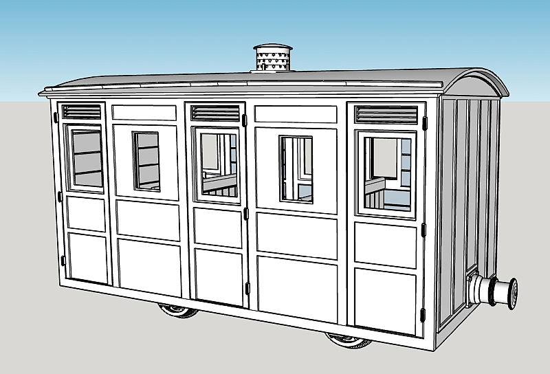

Since I can't do anything else to the loco for now, I've spent the last couple of weeks drawing up the coaching stock to go with it. :D
This is the All Third, but I've also drawn the Brake Third and the 1st/2nd Composite.
Screenshot 2025-02-07 16.32.07.jpg (170.13 KiB) Viewed 40018 times
Again, there doesn't seem to be any info on livery apart from the lettering visible on the few photos, or internal fittings. So I'm doing them in the same red as the loco and guessing at internal colours. The 1st compartment is known to have had a carpet and curtains though!

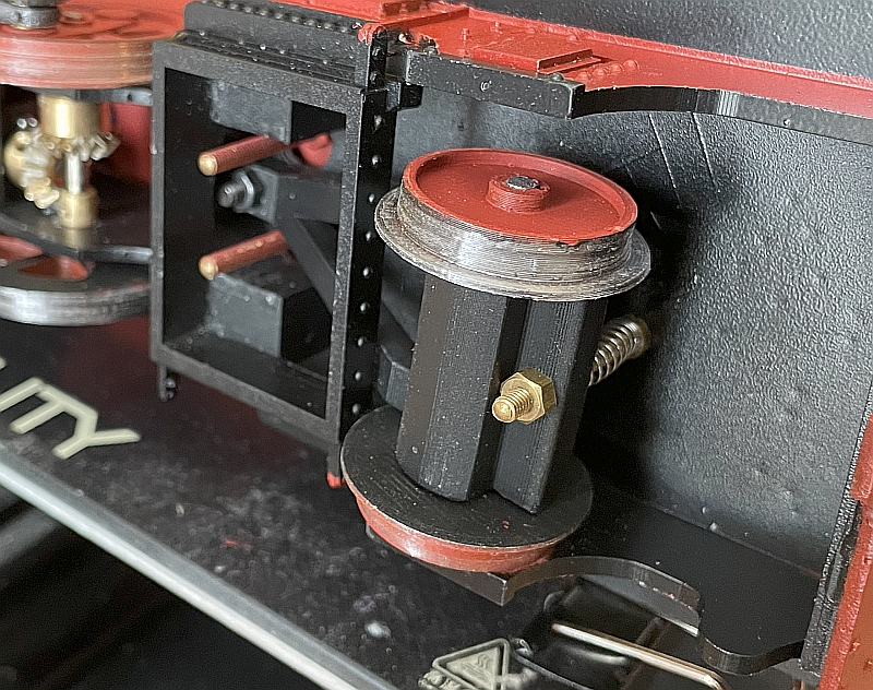

The truck works fine, Graeme. In this pic the pivot is towards the LH side - black nut on the screw under the front edge of the open bottom firebox/ashpan. The two long screws either side of the pivot are the charging connectors. The brass nut on the spring does need just a tweak to loosen it a little and allow the truck to drop a mm or so, but I'll do that when it has all the bits and pieces in place.
The loco weighs in at 912g at the mo, so probably just about 1Kg all up in due course. It has a roll of lead flashing in the smoke box end of the boiler and the battery pack fits in the space between that and the front of the firebox. That shifts the cg to just in front of the rear driver and there is room for more weight at the front if necessary. The Rx sits in the saddle tank, on top of the weights.

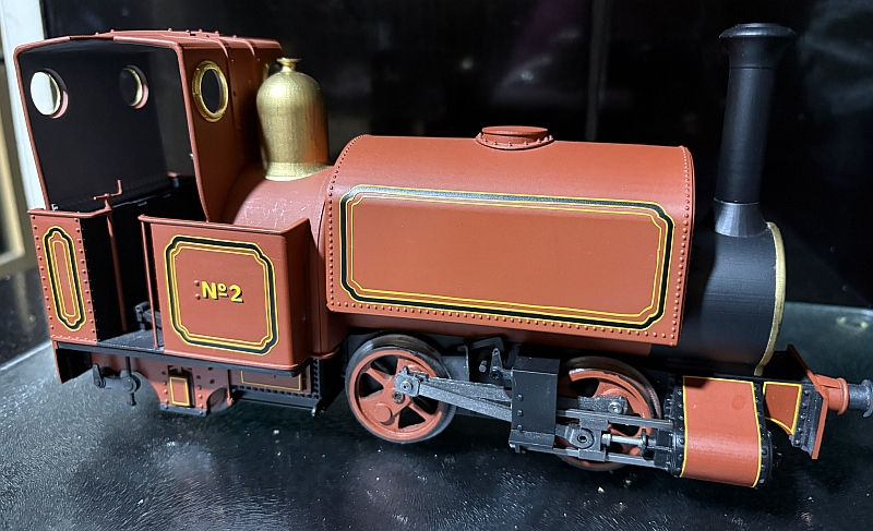

It's been a long time since I posted on this project, unfortunately, although I have been making slight progress with small details and painting, plus I've printed and painted the crew. However the small bits haven't been attached yet until the painting and complex lining was done ( there are still some bits of lining to complete on the frames under the cab floor), to make that as easy as possible.
You may have seen that I commented on the use of a Cricut m/c for lining etc on one of Durley's threads a couple of days ago, but to keep this project complete, I'm re-posting it here:
I got the basic Cricut m/c ( Cricut Joy) ages ago, just to try to do my own lining and lettering. It does have some limitations but I'm not sure if the more expensive versions would be any better. The problem I have is that if it has to do multiple cuts, i.e inside and outside of a rectangular shape, and especially with the reverse curved corners of this loco, the registration goes a bit to pot. Trying to cut the vinyl lining for my F & B loco, the narrowest I could get it to usably do is 0.4mm, because it tries to do some at 0 mm and some at 0.5mm, when the registration slips. To do 2 or more colours requires matching cuts and fiddling to get them together accurately, see the drop shadow on "No.2".
This is the loco, so far, and I'm debating whether to put lining on the wheels ( The various components are not yet fixed together):

philipy wrote: Wed Dec 17, 2025 11:32 am This is the loco, so far, and I'm debating whether to put lining on the wheels ( The various components are not yet fixed together):[/i]
The loco has come up nicely, especially now it is lined.
My two bobs worth..... I think it would be worth lining the wheels, provided you can do it without having a nervous breakdown.
However, you've convinced me to stick with a ruling pen for lining. No half-baked proprietary software involved......... :roll:

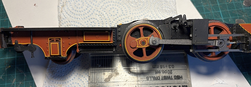

I've had a go at one wheel, and although it isn't perfect it was actually easier to do than I feared and it does look better and more harmonious with the rest of the model, I have to agree. The biggest problem was, of course, getting that thin line round the rim to look something like circular! When the wheel is going round the imperfections are virtually unnoticeable, I think.
I did try using a bow pen initially, but although straight lines and simple curves are fine, the double curves at each corner of the main panels are impossible to do decently just once, let alone the 84 that there would be in total!!! :shock: :shock: Plus it is impossible to get the pen into the tight spaces on the frames between the cylinders and back of the buffer beam and under the cab floor.
John, I tried using the transfer tape because this would be an ideal use for it, keeping everything in the right spacing and circular. Unfortunately it doesn't seem to stick to the "Smart Vinyl" that the Joy uses. I cut it all and weeded out the unwanted stuff and that was fine. The Transfer tape stuck to the backing sheet where it was exposed and then peeled off when pulled, but the actual vinyl itself simply didn't even try to stick to it.
Edited to add: according to the Cricut website it should stick, so I'm wondering if at 0.4mm wide, the surface area is simply to small to allow it to grab.

philipy wrote: Fri Dec 19, 2025 10:33 am The Transfer tape stuck to the backing sheet where it was exposed and then peeled off when pulled, but the actual vinyl itself simply didn't even try to stick to it.
I would be tempted to clean the vinyl sheet before cutting with IPA and see if that helped adhesion.
