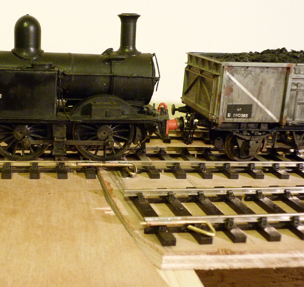

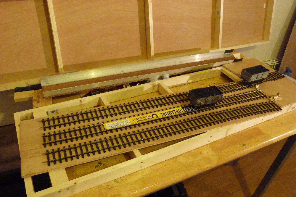

Sector plates are quite simple to make compared to traverser tables
sector plate 2.JPG (386.92 KiB) Viewed 64141 times
In the second image i have soldered brass tube to the rails and used brass wire as a bolt to lock the track in position.
sector plate.jpg (470.56 KiB) Viewed 64141 times

Preseli Chris wrote: Tue Aug 06, 2024 10:35 am Sector plates are quite simple to make compared to traverser tables
Hmmm. Maybe - I'll have a measure up and see if the space/geometry works for me. Thanks.

Thats actually a pretty neat idea Chris. :salute:

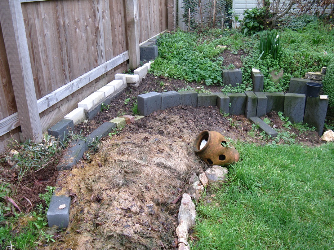

The photo below shows the south or garage end of the steaming up/cool down station yard. A new wall was built as a ‘counterscarp’ to the garage wall itself, to reduce damp problems. A dividing wall was constructed to parallel the existing (low) patio wall and act as the second base wall for slabs. The space in between was filled with flint rubble and some tatty old bricks, once compacted this forms a secondary supporting base for the slabs and allows any water percolating through to drain away via weepholes I created in the old and new walls. The strip next to the garden wall was excavated and much vegetable matter and rotted manure mixed in – when I’ve finished repointing the wall and it’s painted (spring 2026?) then I’ll plant a couple of climbing plants and some lower ground level items.
The height of the slabs now is around two blocks (laid on their largest face) and mortar layers below the ‘cat flap’ in the garage wall. I plan a ‘spine’ down the [central] edge of the slab for the main line and will add support for the loop and sidings when I am clearer as to exactly where they are going. The idea is that when everything is built and tested, I’ll put some earth/gravel/compost in the spaces in between and this will let me grow some ground cover plants in the station area so it’s not all bare stone and track. The slabs are laid on a slight slope so water should drain towards the path. I hope that this and various weepholes I’ll include in the track support walls will stop these areas being too boggy.
On the other side of the garden, I had to attend to other significant civil engineering works due to last year’s Storm D’arrrgh. Two retaining walls (and much drainage!) were installed for the raised flowerbed in the corner. The boundary side of this has been planted with hazel and hawthorn, together with some wild flowers – experts might be able to spot the Red Campion and Herb Robert. Some bulbs are in there too. Somewhere!
Backtracking towards the photographer, the line of blocks went in on an approximate five foot radius curve – these are not the finished PW but placeholders, so plant roots will not be disturbed when the time comes to lay the track permanently. I expect it to be two years or more before I reach this corner, it is down in Stage 3 (of 3) of construction.

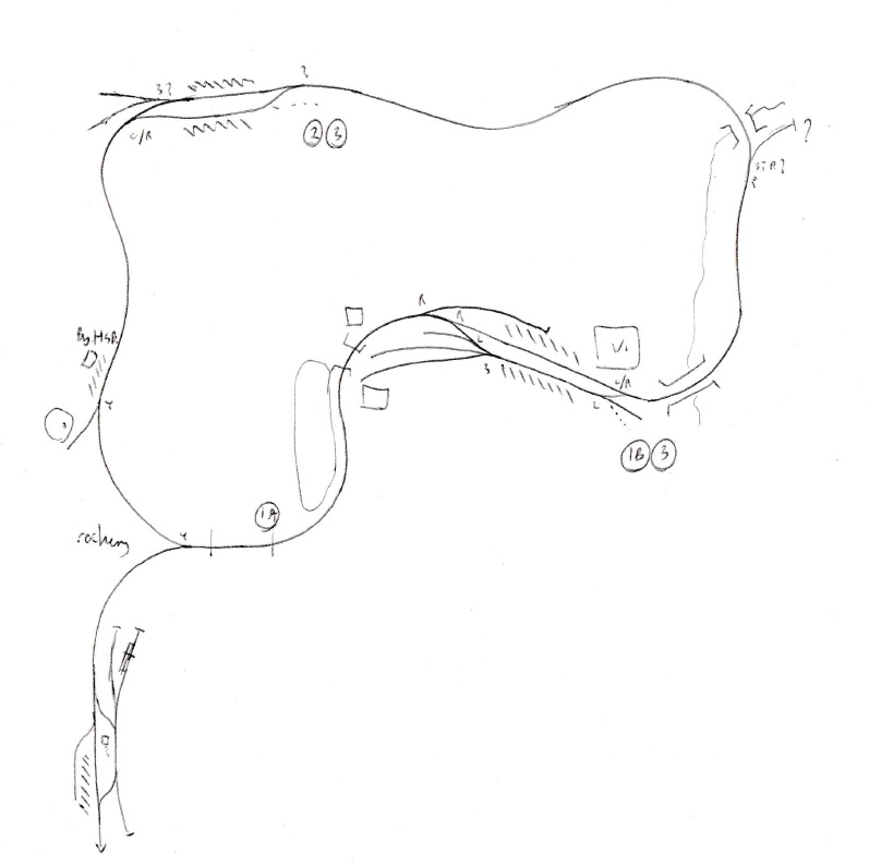

I attach a revised plan – this may well change again when construction springs out of the garage ‘bridgehead’. The main change is the expansion of the ‘other’ station in the corner – I thought two or three extra sidings would be very useful both for extra operating interest and for coping with guests’ stock on running days for the local group. I do wonder how popular an end to end (‘I’ or ‘Y’) system will be until I can finish the circuit? We will have to pay attention to our signalling. Provisionally, I plan to adopt Tal y llyn practice, with limit of shunt and ‘U’ boards going in on the trackside. I don’t mind acting as a blockman or bobby but I seem to be in a minority in the local group there, so I’m working on most signalling and point changing being done by the driver(s).
new plan.jpg (53.75 KiB) Viewed 38880 times

Have you thought of putting a triangle junction where the terminus joins the main circuit? It would give a few more options operationally.

ge_rik wrote: Thu Dec 25, 2025 9:00 pm Have you thought of putting a triangle junction where the terminus joins the main circuit? It would give a few more options operationally.
Morning Rik,
Yes to both. Triangular junctions/stations have an appeal for me and I spent quite a bit of time trying to work something out for a station there instead of a few feet closer to the garage. But the problem with that is a very large bush/small tree - which I don't want to lose and in any case would be serious effort to remove - is smack bang in the way. One possibility may be to put a chord in using small ground spikes and planking for the track rather than the blocks I plan for 80% of the rest of the trackwork. Though if I do, it would have to curve round the trunk of said shrub and that messes up the geometry of that corner. It would also have a cascade effect on the rest of the trackplan next to the house, which is on a tight tolerance already. I see why you (and one of my local group) have suggested it and I'm not against the idea in principle. Never say never and I have a few months before I'm going to be at that stage of construction but if I do, it will have to be something ingenious.
