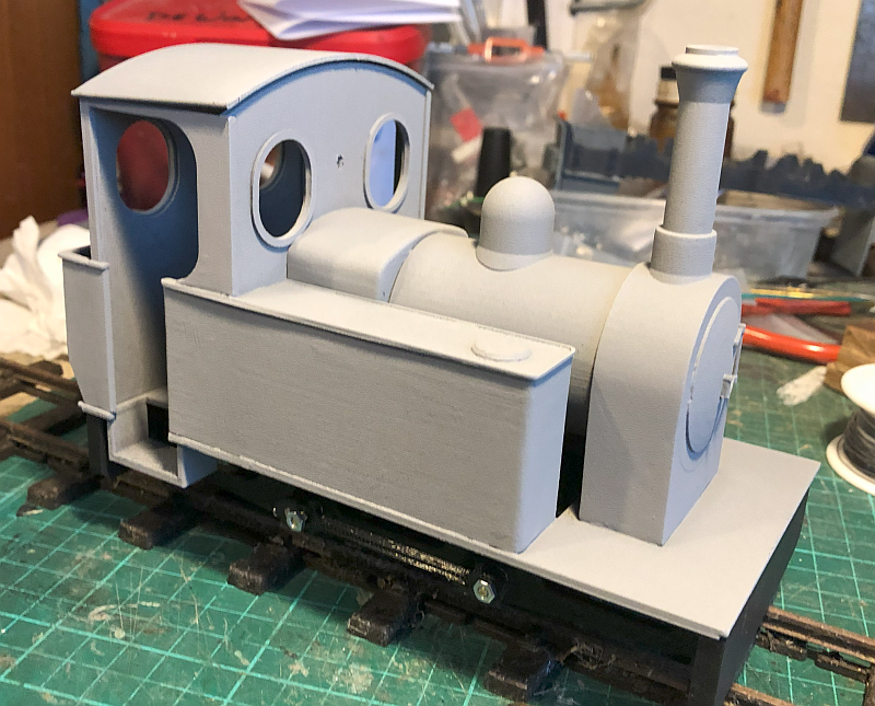

Well, over the weekend I've fixed the cab window frames and been filling, rubbing down, priming, etc, the body, although still a little bit left to do. For the time being the roof is left separate so that I can get in to paint and fix things( I 'm debating whether to glue it or screw it when the time comes). I have actually installed the on/off switch in the cab and wired it already, so that I can work around it without damaging anything later.
I also looked at both the original Thomas the Tank book pictures and the LBSCR E2 that he was based on. It struck me that Thomas seems to be shown with two whistles but no safety valve, a highly dangerous practice, although I guess you might get a split second warning from the whistle before the boiler blew up! :roll: :lol: Anyway, I had a look in my "Gash prints" box and dug out a spare spring safety valve, left over from another project, so that will go on top of the firebox in due course, and I think I'm going to mount the whistle on the cab front rather than the firebox.
Mechanism-wise I've reprinted the cranks with slightly a smaller hole in the small end, and tapped that M2.5. I had to order some M2.5 csk 8mm brass bolts for the crank pins, which arrived yesterday evening. Next job is to cut some small brass sleeves as bearing inserts for the rods. I also have on order some M2.5 domed nuts which I plan will sit on the end of the cranks pins and finish it all off nicely and allow me to get at things if, for instance, a rod breaks one day.
I've spent all this afternoon fighting the *@##%^ quartering and atm I CANNOT get it running smoothly enough for my satisfaction. It may help when I can nip the rod retaining nuts up tight, because at present they keep trying to unscrew. Once they are tight I'm hoping that the last tight spot will bed itself in. To be fair it isn't very noticeable now, it's just that I know its there!

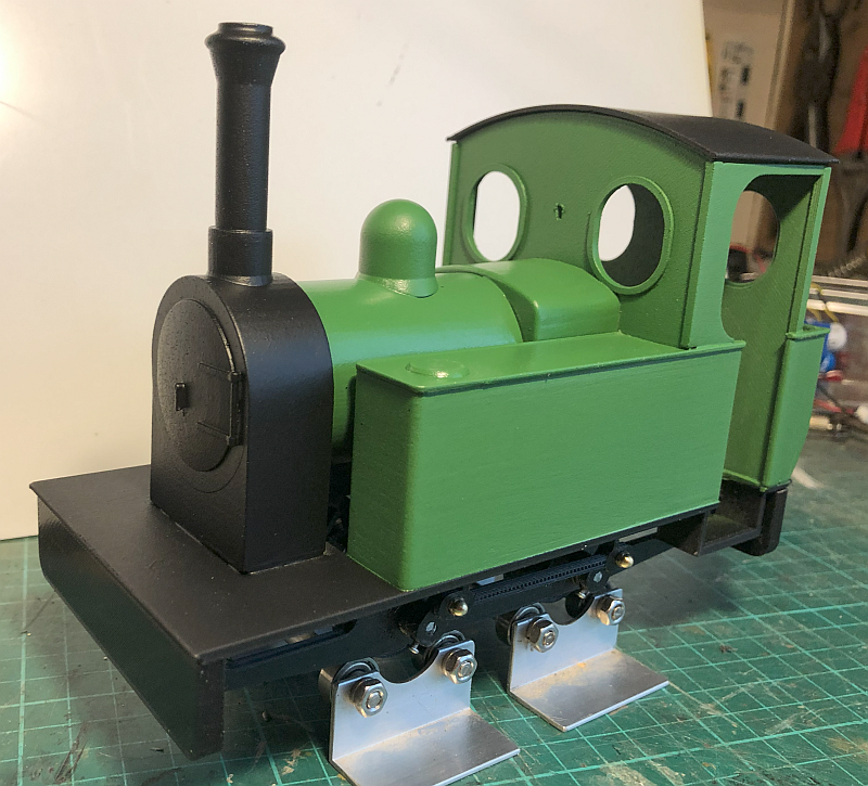

Yesterday morning, I attacked the sticky motion again with little success so I went back to basics. I took all the rods and cranks off and then just offered the rods up to the ends of the axles. The first one dropped straight on but the other side just didn't want to know. Checked with the vernier and discovered that the axle centres were 0.73mm different, one side to the other, and I also noticed a slight twist in the frames. I think that when I glued the frame that had been screw fixed originally, and then cut the slot in the other frame, things must have got a bit distorted. :oops:
Anyway, I decided that there was no point in wasting more time trying to correct things and so I set the printer working again! However, before printing, I actually added a strengthening rib along the top of both frames and drew up a couple of longer frame spacers to assist with keeping it all square with no distortions. 6.5 hours later I had the components for a new chassis. :roll: Glued it all up and left it overnight to set.
This morning all was nice and solid so I transplanted the motor/gearbox from the old chassis and refitted the cranks and rods...lo and behold, it runs...in both directions!
In between things over the last day and a half, I've painted the body in the E&D standard loco green and I'm quite pleased with how it looks so far. There are still bits and pieces to add and the cab interior to do.

That looks really good now, and a tidy paint job too!

Agree with Peter, looks very smart. Can't wait for some spare time to start mine. I will confess I am currently in the process of putting some paint on the NGG16, after over a week, I only have paint on the cab, boiler and smoke box, not even started the tenders and they are the hard bits. Well done for such a quick turnaround on this one, especially with a redesigned and rebuilt chassis!

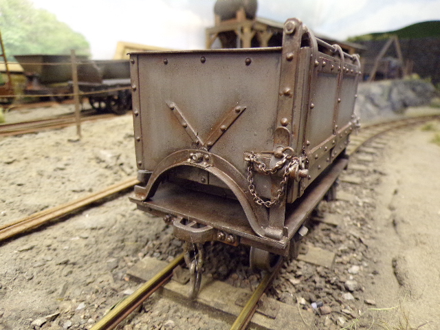

BertieB wrote: Fri Nov 10, 2023 10:06 am ..... the loco looks lovely. Really makes me appreciate the extraordinary scope of 3D design and print. Cutting up plasticard looking increasingly crude and clumsy!
Sorry Bertie but in the absence of a 3D printer I have to make do with good old-fashioned Plastikard, perhaps one day I'll get it right???

I'm just as much in awe of Peter's abilities with plasticard as anyone, but IMO, the real skill/ability is his painting and weathering techniques, which magically transform a good model into a representation of the real thing. Cutting and gluing styrene sheet is something that can be learned but the painting is an innate artistic ability that 60-odd years of practice have never imbued me with. :roll:

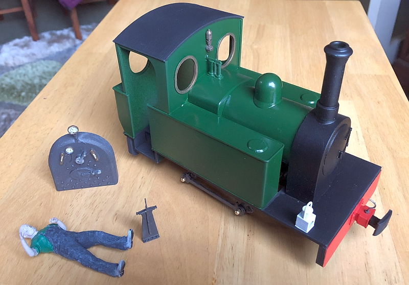

Bit of an update -
Over the past few days I've been fiddling about and making very little real progress, but.....
I've fixed the SV and whistle.
I've painted the backhead ready to go in the cab once I've painted it inside.
I've printed a generic type reversing lever.
I've got the driver half painted.
I've printed a couple of loco lamps ( not Drew's because I already had the stl for one which fits some 5mm LED's that I have in stock.). I'm currently trying to decide whether to put a 2nd lamp on the bunker, using the Rx65b's ability to automatically switch between them depending on direction.
I've painted the buffer beams.
I'm fitting magnetic couplings using the basic design from '3Minutes of Fame' a few months back, but modified with two magnets in each so that they are universal. I've also slightly modified them to double up as link and pin. I found some small brass tube and cut a short 10BA thread on one end, then soldered a pin into it with a 10BA nut at the join. The protruding pin was then bent into a standard type hook so that a chain can be hooked on if a vehicle hasn't been magnet fitted. The brass tube drops through the magnet head housing and acts as the pivot and a nut screws on the cut thread at the bottom to retain it.
The cab window frames and whistle are using my recipe for tarnished brass, as per my last post.

Wonderful Philip, great paint job and the tarnished brass effect looks just right.
