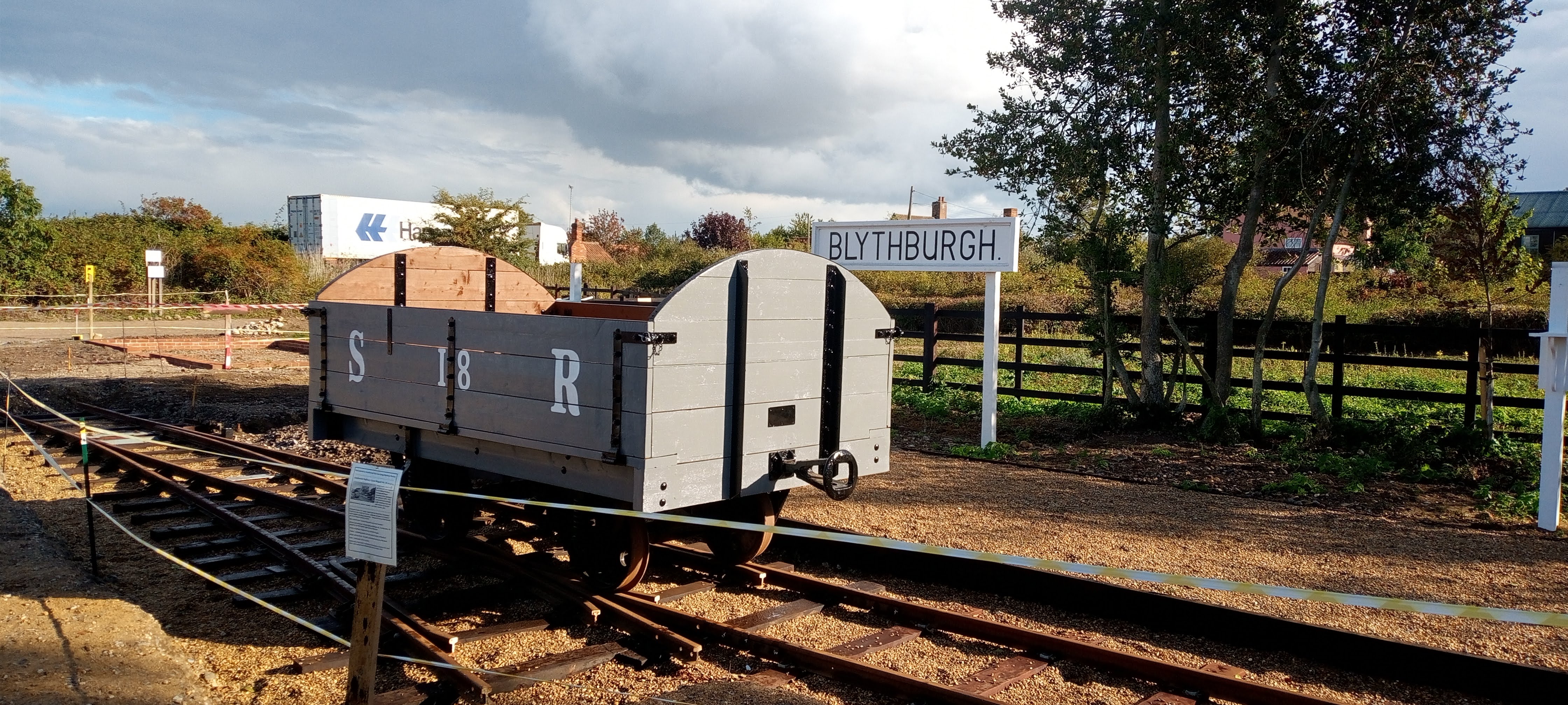

Something that has been worriting at the back of my mind since early on has now risen to the top of the heap.
This mobile sardine tin has a very odd looking centre buffer, but I can see nothing that looks remotely like a coupling of any kind. It clearly did have a coupling, one of the pictures shows it towing a line of skips and we know it worked on the Ffestiniog, etc. The centre buffer face has a hole in the middle, so I wonder if it had some sort of removable bar that went through the hole with a pin at the back. Any suggestions anyone?

philipy wrote: Fri Oct 14, 2022 6:18 am Something that has been worriting at the back of my mind since early on has now risen to the top of the heap.
Didn't that sort of buffer use a bar with loops at each end (figure of eight style) with removable vertical pins holding it in place behind each buffer? I've been trying to find a photo but not found one as yet.

This replica of a Southwold wagon at Blythburgh Station has a similar coupling which I was reliably informed came from an Admiralty wagon rather than the chopper style couplings used on the SR

Thanks Rik,
Thats kind of what I had in mind, but I've not come across it before.
Looking at the A-D drawings and photos, it looks like there could be a pivot behind the buffer head to allow it to swivel, but equally it could be the housing for a pin.
