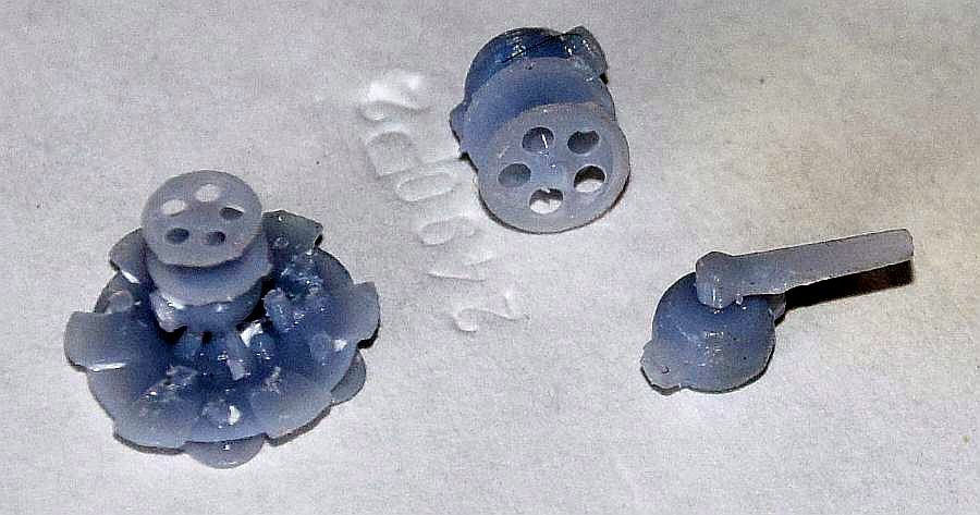

I've been playing again, just to se what I could do, although it is relevant.
I said earlier that printing the backhead pipework didn't work, but I wondered if I could print the individual components, and this is the result ( obviously some cleaning up required).
The LH one is a 4mm diam handwheel, the centre one is 5mm and the lever one is the same basic body.
All have a 1mm diam hole both sides for pipe entry. Given how exposed the backhead is on this loco, I'm not sure these will be robust enough to actually use. I suspect that with a few mins the hand wheels would get knocked off.

I'm impressed that you made those with a consumer grade printer......philipy wrote: Sun Jan 16, 2022 10:05 am Given how exposed the backhead is on this loco, I'm not sure these will be robust enough to actually use. I suspect that with a few mins the hand wheels would get knocked off.
The valve spindles will be the vulnerable point, as acrylics are brittle. Are there more flexible resins available?
Or, do you have a manufacturing jeweller in your area? I've seen prints used for lost wax casting by investing the print itself, instead of using it as a pattern to make waxes.
- Posts: 6062
Re: Contractors Loco Project
I saw one recently on Amazon that claimed to be similar to ABS and I was going to get some to try. Then I saw a lot of reviews saying that it used to be very good but had suddenly changed and was now a waste of money...!
As for casting, we are only an hour or so from the famous Jewellery Quarter in Brum, but to get the few that I need for this, it really isn't worth the time and money to go that route I'm afraid. Good thought though.
I think what I'll probably do is print a few handles with a central hole and glue them to pieces of wire mounted in holes drilled in the backhead. A blob of glue will then look enough like the valve body to get away with it when all painted.
