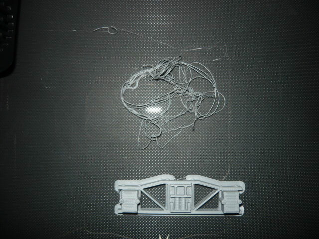

After 20 minutes setting up the bed level I tried to print a file and it failed.
Tried another file and success.
Tried to repeat printing the same file again and fail
Same settings nothing else touched, time between prints less than 5 minutes.
This is an example of what is causing me so much frustration the success at the bottom the fail at the top.
The PLA was just dragged off the bed by the nozzle and this while printing the brim.

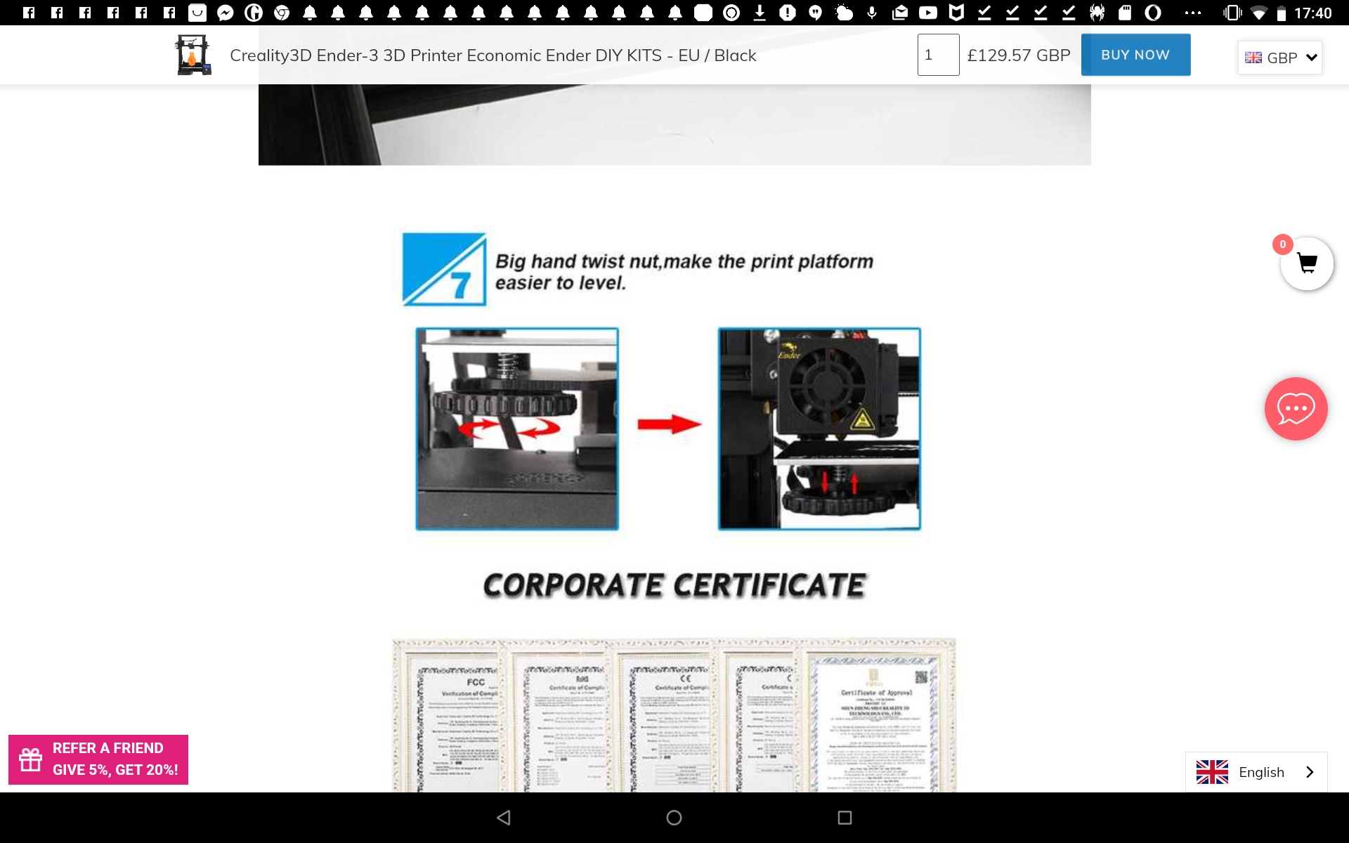

I've just been looking at the Creality website. I'm thinking of Christmas coming and see their cheapest Ender 3 (the DIY version) is just £130. Very tempting. I also noticed this picture in the blurb
It shows the springs being very tightly compressed which is what Steve suggested. Are yours as compressed as this?

Rik yes my springs were compressed as that but as I adjusted the bed they became looser and did not provide enough tension on a couple of addjustment wheels.
I replaced the original springs with the one I bought and that problem went away.

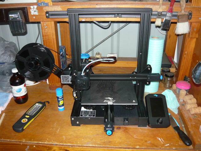

After sitting the printer in the naughty corner and ignoring it for about a week (I went outside and built some track on the cane line) I returned this afternoon and;
1. Cleaned off the glue from the bed and,
2. pushed the wire tool up through the nozzle (it was printing in a vertical wavy pattern) to clear any obstruction.
Before cleaning off the glue I thought about how it applied and it was lumpy and did not lay with an even thickness, surmised that as it was in SWMBO's craft box it may be to old.
I purchased a new stick and voila!! it spread smoothly and with an even thickness.
The next thing I looked at is the angle of the feed for the filament into the extruder assembly, the filament was stretched taut and had a near 90 degree bend before entering.
A quick look on the net revealed that the roll on top of the printer can lead to laying down issues as the roll can wobble the frame because it is top heavy.
I downloaded a file for an extension that takes the roll off the top and lets the filament feed in from the side. With no weight on top of the frame the chance of the reel wobble upsetting the extruder's travel is alleviated.
At the moment this is happily printing with the filament sticking to the new glue, nothing else was done to the bed level settings, so fingers crossed I may be able to start printing successfully.
It appears that I may have made every rookie error in the book, here's hoping the mistakes I have learned from are the last ones I will come across.

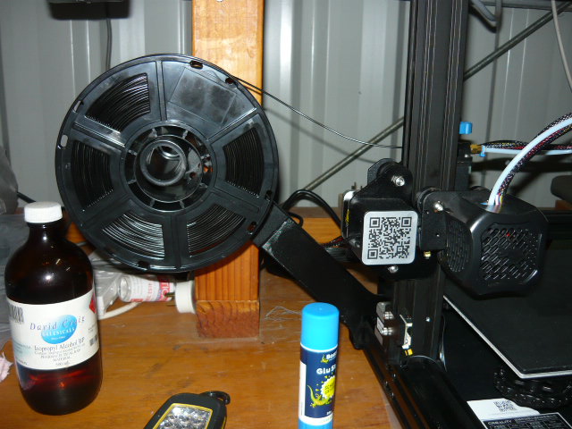

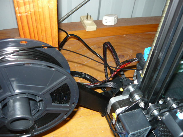

Just remembered I did make one change with the last print and that was to click the "recommended" button on the Creality slicer. I have no idea what else I had changed from the recommended settings other than selecting a brim instead of the skirt that is recommended. I might reslice all my files using recommended and see how I go.
Also think that I may have had a clogged nozzle even though I pushed the wire tool up into it a number of times, what I did differently this time was push it up for its full length and then forced filament through the nozzle till I has along string (found how to move the Z axis up via electronics rather than by hand).
Pictures of my filament roll relocated from the top rail to on the side.
It does make the printer footprint wider but the trade off is that I can now move the printer away from the edge of my bench as the roll is not hitting shelf (plus I get access to the shelf back).
The other benefit is that the filament feeds straight into the extruder assembly with no tension or sharp bends.
