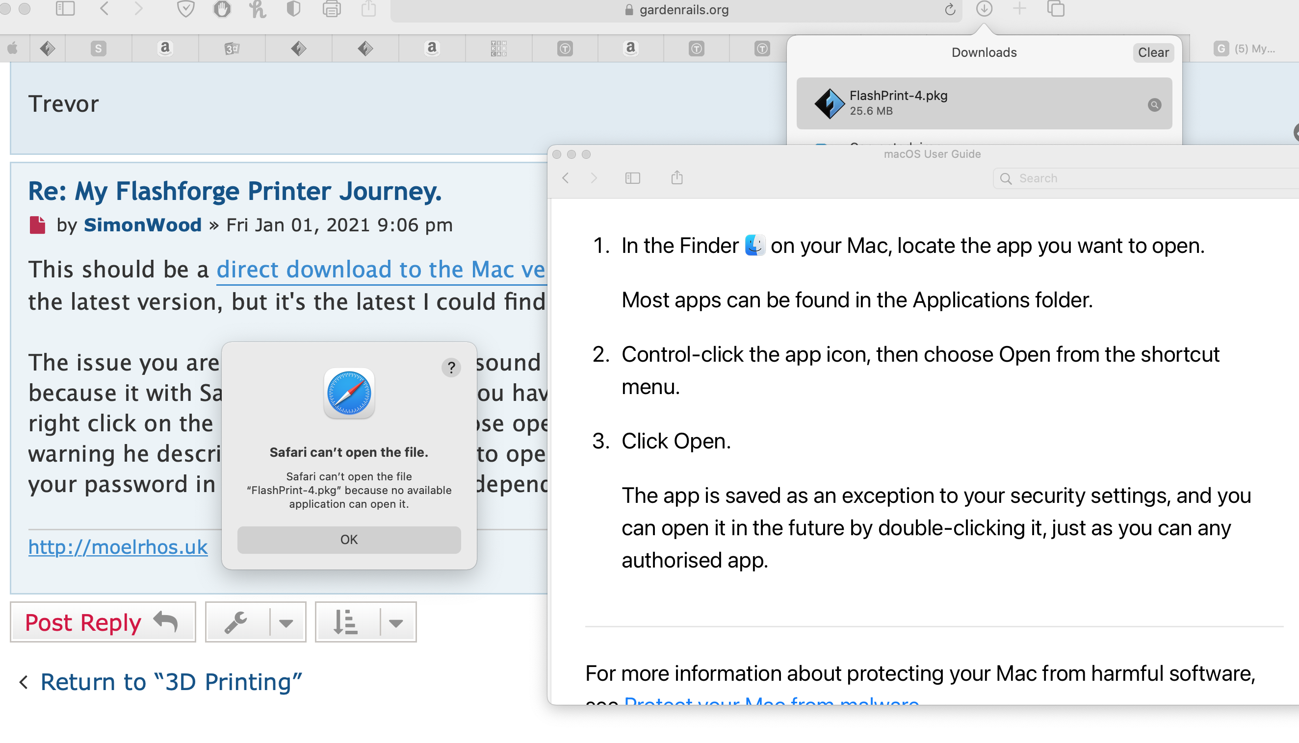

Downloading flashprint.
When you try to download it you should get a warning that it is from an unknown source as you say. That warning should also have a link to go to settings where you can temporarily override the safety feature which stops it downloading.
It will then instal flashprint.
Simon i more of an expert with a Mac than I am so I will let him follow up on this advice.

Re: My Flashforge Printer Journey.
This should be a direct download to the Mac version of Flashprint 4.5.1. It's not the latest version, but it's the latest I could find on their website!
The issue you are having, Rod, does not sound like what Trevor is describing, because it with Safari not macOS. But if you have the issue Trevor describes, right click on the app in Finder, and choose open. It will then give you the warning he describes but with an option to open it anyway - you may have to put your password in to authorise it (this all depends on your Gatekeeper settings).
Thanks Simon, I did get to load that version. It still came up with this...
So I went to finder and opened it and it put the install pop up onto my screen. Loaded it and it worked....Weird why it wouldn't load earlier. Oh well, I have it now.

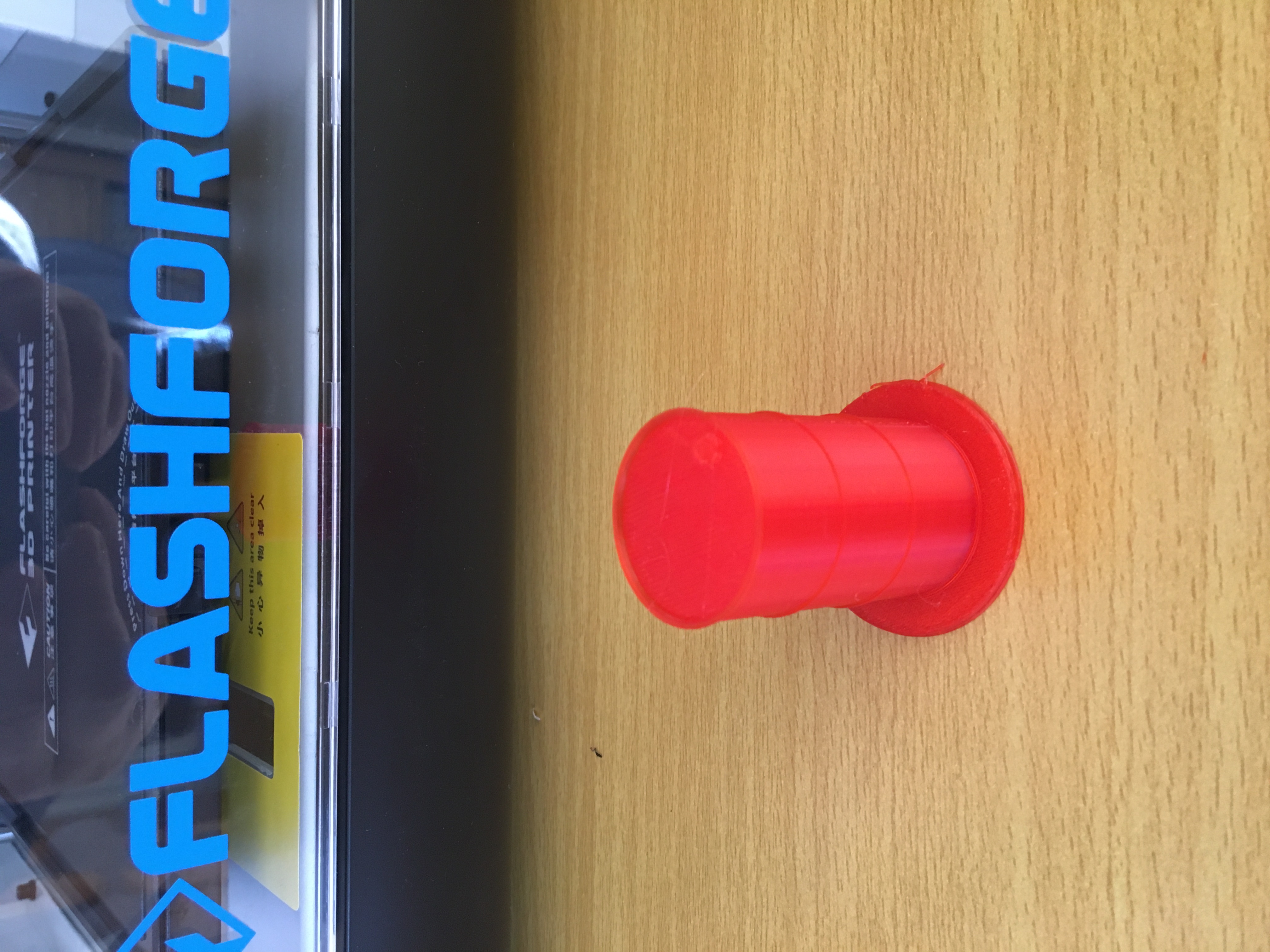

I have printed off the barrel, but it had an awful lot of filament on the bottom of it. So I loaded it again and put some linear supports on it. I got this....
Why is there supports on the side of the print.

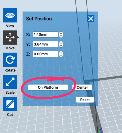

I wonder if your barrel is on the bed?
Click on "Move" twice and a pop up for 'Set Position' will come up. The Z position should be 0. A quick way to ensure this is to hit the 'On Platform' button.
Personally, I would print the barrel without any supports. But that's only through my own experimentation. As I say, I'd try things out - expect a (good!) few failures and appreciate them as learning opportunities!
I have printed it has is in the file Simon and it came out with a huge 2mm thick raft.
I will need to use my Dremel type tool to take if off and for me it's a lot of waste isn't it Simon.
Couple of points
Simon is right about the supports. I was just trying to get the basics across.
You won't need to use a power tool to get the raft off. It should just peel off in your hands. If it doesn't run a knife blade down the join between barrel and raft CAREFULLY.
The raft shouldn't be looked at as waste. It is an essential part of the way this printer works. When you have more experience try without it - but for now just accept it.
S{lease stop worrying about waste - you will make plenty of waste if you try to eliminate it.
If it is difficult to separate the barrel from the raft you can lift the barrel off the bed by 1 mm, add supports and print. With supports at the default setting you should get no supports up the sides - just underneath the barrel. Any bits of support left after separating the barrel can be sanded away.
Yup, that's normal. I find I can usually snap them off with my fingers, though.
It is a lot of waste and you can try printing without one - but as Trevor mentioned elsewhere, because that increases the chances of a print failing, it will very probably actually increase the amount of filament wasted!

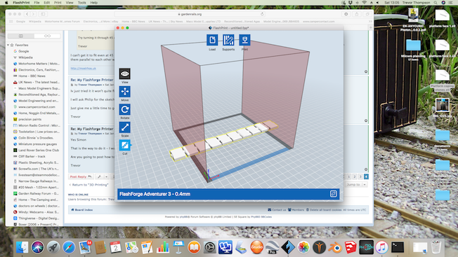

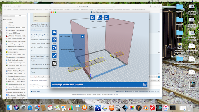

I can't get it to fit even at 45 degrees. I'd be tempted to use the cut tool in Flashprint to cut it into two blocks of 5 and then use the move tool place them parallel to each other within the bed area.Trevor Thompson wrote: Sat Jan 02, 2021 12:53 pm Regarding the comment about the platform face, and how to make it fit on the bed.
Try turning it through 45 degrees so it lies diagonally across the bed. It looks like it might just fit.
Iv just tried it it won't quite fit.
I will ask Philip for the sketchup file and modify all three so they fit on our printer beds.
Just give me a little time to get the file modify it and send it to you.

Yes Simon
That is the way to do it - I wasn't thinking straight.
Are you going to post how to do that or shall I?

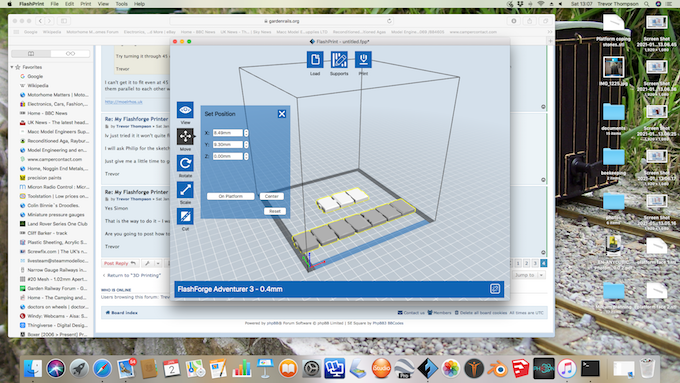

Follow this sequence:
