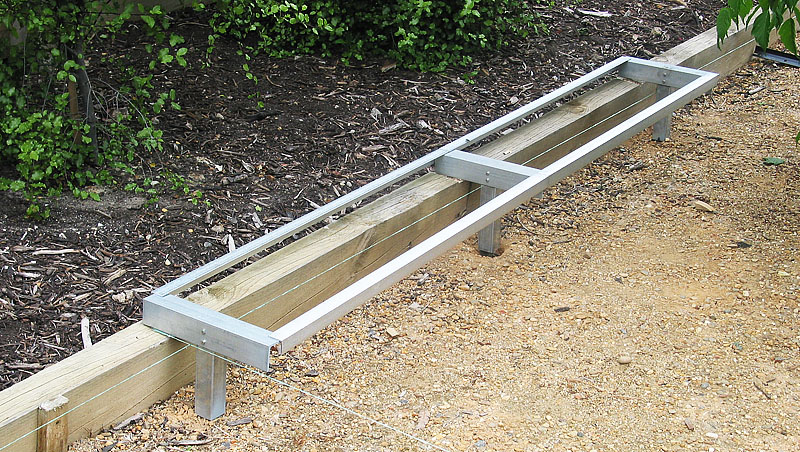

The pic shows the first 2m of track support that was installed this week as a test piece. The design was easy enough to assemble and is strong enough for the job, so the test has been signed off and work is now proceeding on extending the track support around the raised area of the backyard.

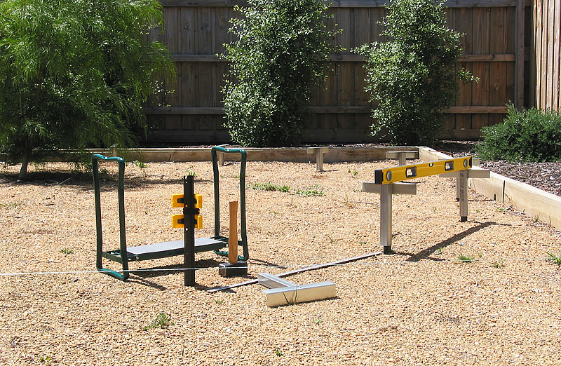

The material needed to build the supports for the first stage was delivered Friday and this pic shows them stacked on the garage workshop floor. The car that normally occupies that area will be parked in the drive for some time I think.

Track Supports-5.jpg (104.59 KiB) Viewed 11026 times
The actual support posts are star pickets hammered into the ground at 1m intervals, with just enough sticking up for the T-support to slide over the star picket and sit at the right height. The T-support is a piece of 50mm x 50mm galv angle bolted to a piece of 40mm square galv RHS tube. The longitudinal supports are 30mm x 30mm galv angle glued to the cross piece of the T-support. The star pickets have a black bituminous coating to provide some rust protection and the above ground steelwork is galvanised for the same reason. The deck will be made from Weathertex cladding boards, which are stacked on the left of the above pic. This is basically a heavy weatherproof version of Masonite, designed for external cladding of buildings and to resist the Aust. climate.
When I started designing a track support structure, it turned out that using galvanised steel for the support frame was the same price locally as building it in timber, so the choice was a no-brainer. The steel has to be bought through a steel distributor though, as the same stuff from hardware stores is twice the price. The corrosion life of the galvanised steel will outlast me as it isn't buried in the ground, plus it doesn't warp and the termites can't eat it. Same goes for the star pickets. Although it is made from Aust hardwoods, Weathertex is termite resistant and is also well above the ground, so harder for them to reach.
Building the test length suggested I can erect about 3m in an afternoon without killing myself. The first production length was successfully laid today, so the installed length is now 6m. I may make the completion target yet if the weather co-operates, but I'm still not saying 'which' Easter it will be finished......... 8)

Been trying various bits of steel tube as a fit on star pickets, was looking like the order of 1 7/8ths ID. Did think of square tube but didn't have any big enough. Glad you got it sorted though, a circle by this Easter surely.
See you Friday.
PS 30 X 30 angle glued! glued! glued! what's this glued, a mechanical fastening to come later perhaps?

LNR wrote: Sun Nov 04, 2018 1:55 pm Been trying various bits of steel tube as a fit on star pickets, was looking like the order of 1 7/8ths ID. Did think of square tube but didn't have any big enough.
See you Friday.
48mm id pipe would have worked, but there's no galv steel pipe/tube anywhere near that. Star pickets aren't a precision rolled section and neither is 40mm SHS tubing, so some posts fit and some don't, but nothing that can't be adjusted with an angle grinder.
If modern adhesives can glue a jet fighter together, they are strong enough for this job. If it doesn't work, the fallback might be the electric glue gun.......

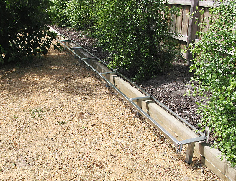

The pic shows progress yesterday and a few more posts went in today. With the weather the way it is (not a cloud between here and Adelaide when the photo was taken), I can put in three posts in the morning while it is still fairly cool, then retire to the workshop to make the three posts for the next day. The yellow gizmo on the partially driven star picket is a post level so the picket can be kept vertical as it is driven in. A 4lb club hammer isn't ideal for driving them, but the posts are too short to use the normal type of star picket driver.

The original plan was to use a flexible adhesive to join the longitudinals to the cross pieces, but that idea hasn't worked out. I trialled Fix All which the maker claims works on zinc coated steels, but the galv steel also has a lacquer coating and the adhesive bond wasn't strong enough, as the joint easily broke when twisted by hand pressure. I've now dug out the old mains powered hand drill and it's drill stand, so the longitudinals can be drilled in place and will be bolted as well as glued. When the nuts and bolts get here.........

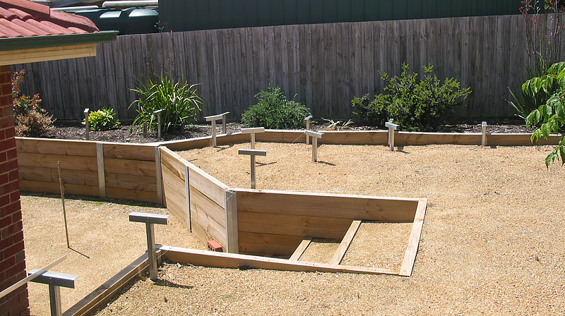

This is the track last week looking south towards the big curve, which is 9' radius.

Next is looking north the next day, just after the last post went in. This shows the area where the wye junction and the bridge will be installed.

The last pic was taken a couple of days ago and shows the longitudinal supports in place on the wye. About 1/3 of all the posts used on the track and about half the work required to fit longitudinal supports to all of it. It is easier working on plain track, so a day later and I'm around the curve to the right and starting on the long straight toward the south end.

The curves on the wye are 7'3'' radius, which is dictated by the position of the access steps. This scales out at 2.2 chains in 1:20.3 which is just over the scale minimum curve on the VR narrow gauge lines. It's also just large enough for G1 locos if my interests move in that direction, as I'm running out of ng models to make. :roll:
Most garden railway modellers would probably fill this space with plants, hillocks, rocks, buildings etc. and lay a lot of track at ground level, but that's not what I'm looking for. I can't stand gardening for a start. This is more in the style of a typical G1 track, where I have somewhere to run a train when I get the urge and which has easy access for manual running as I get older.
