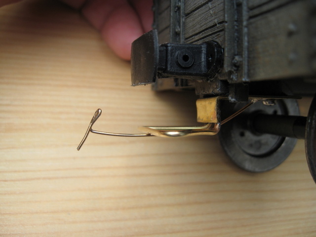

Latest update
Must admit, this development has been on tickover, lately. My excuse (sorry reason) is that I have been evaluating my various versions of my coupling to see how they perform. As a result, I have enlarged the loops (the smaller previous versions were difficult to align for reliable coupling-up), I've modified the hooks (provided a lower 'tail' to improve latching on to the hook), and simplified the mounting bracket because my limited metal-working skills were not up to doing a double U shaped fold with any degree consistency.
Version 3 (or maybe 4) couples with tolerable reliability to LGB style couplings
It is also compatible with itself (thank goodness) :?
The hook now has a tail (as you can see) which means there is now twice the amount of leeway in alignment with the loop
And the bracket is a lot easier to manufacture (and requires less brass)
I am in the process of testing and evaluating this version to ensure it lives up to expectations and if so, I will replace all the previous versions before rolling it out across the entire fleet.

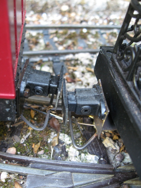

Slowly progressing with replacing couplings with my version. However, I worked out that the buffers on the bogie coaches would have to be widened to cover 3/4 of the buffer beam if they needed to be propelled over my R2 (Trainline) crossover. I therefore decided to attach the buffers to the bogies as well as the hooks and loops.
As can be seen, the buffers continue to be in contact with each other through the crossover.
Not sure if there is a precedent for this on narrow gauge railways. Be interested if anyone knows how the couplings on bogie stock are made to negotiate tight reverse curves on the real thing.
Re: Couplings
Posted: Sun Aug 05, 2018 11:45 am
by IanC
On the "real thing" the couplings are attached to the chassis or drawbar. To facilitate tight curves they are in a horizontal slot and pivoted. This allows the bogie to travel freely and guide and support the coach as intended. In our smaller scales this is not too important unless particularly bad trackwork is encountered in which case derailment can occur.

Hi Philip
For the loops, I'm using 1.5mm brass rod. For the hooks I'm using 22SWG (0.711mm) phosphor bronze wire from Eileen's Emporium - https://eileensemporium.com/index.php?o ... thway=1036
If you're doing a direct replacement for LGB or HLW couplings then these are the dimensions I work to for the bracket (0.7mm thick brass sheet).
Coupling dims.jpg (64.81 KiB) Viewed 11804 times
I've made simple wooden jigs for bending the loops and soldering the loops to the brackets.
Let me know if you want any further info.

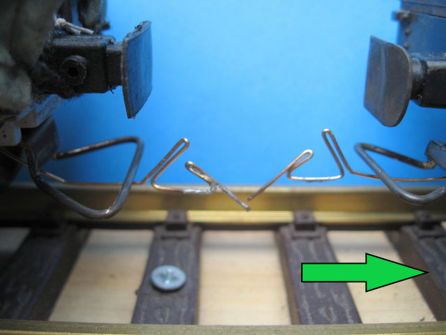

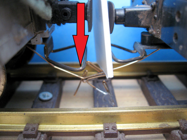

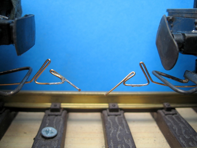

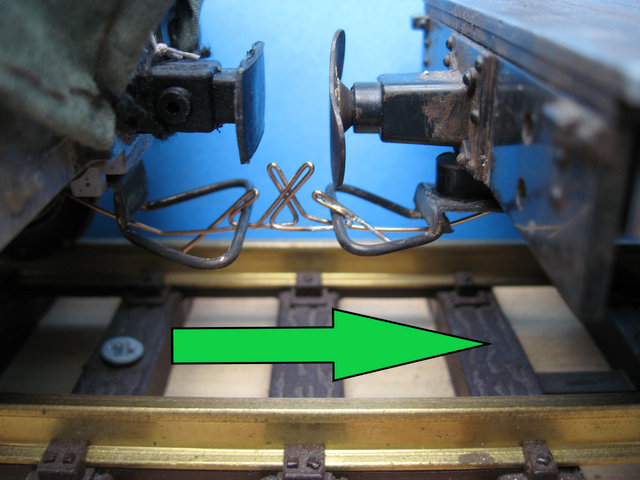

Well, after a bit of head-scratching and some experimentation, I have achieved my objective of creating a hook-and-loop coupling with delayed action uncoupling. However, I'm not sure how practicable it is (more later).
The loops are as before but the hook has been modified to include a forwards facing larger hook behind the normal hook. I'll call this the "delay latch".
The coupling hooks couple-up in the usual way. Push one or both wagons together ......
... and the hooks latch on to the loops and away we go.
To uncouple, the wagons are propelled backwards (or one is propelled backwards and the other is stationary).
The couplings are then pushed downwards to disengage the hooks from the loops. At the same time, the 'delay latches' on the hooks force the wagons apart slightly as they meet the loop on the other wagon.
The uncoupler is removed and the wagons continue to be propelled backwards. The delay latches are now the other side of the loops on the opposite wagons.
When the wagons are pulled apart (or one is stationary and the other is pulled away from it), the delay latches slide under the loops, .......
...... preventing the coupling hooks re-engaging with the loops.
Thus the wagons are uncoupled when they are pulled apart at any point after they have been uncoupled.
I have tried using magnets to do the uncoupling by soldering steel droppers to the underside of the hooks. However, I've not found magnets which are sufficiently strong to pull the hooks down and keep them held down while the delay latches come into force. I might need longer magnets.
Whilst all this is fine in theory, in reality, it's tricky getting the delay latches to work reliably. If the wagon being uncoupled is too light when the hooks are depressed the wagon springs away under the pressure from the delay latches and then when the propelling is continued the coupling hooks re-engage. If the wagon to be uncoupled is too heavy (eg if there are several other wagons behind it), then it's difficult to push the hooks down as the delay latches have to force the wagons apart slightly to work.
So theoretically, the delay latches are a workable concept - but in practice they are not really viable. If I could get the delay latches to hinge upwards somehow and then drop down again to cover the hook then it would work - but it will make the hooks too complicated to construct and might end up interfering with the coupling and uncoupling process.
So - I'll stick with the status quo - ie uncoupling wagons at each location where I want them to remain.
