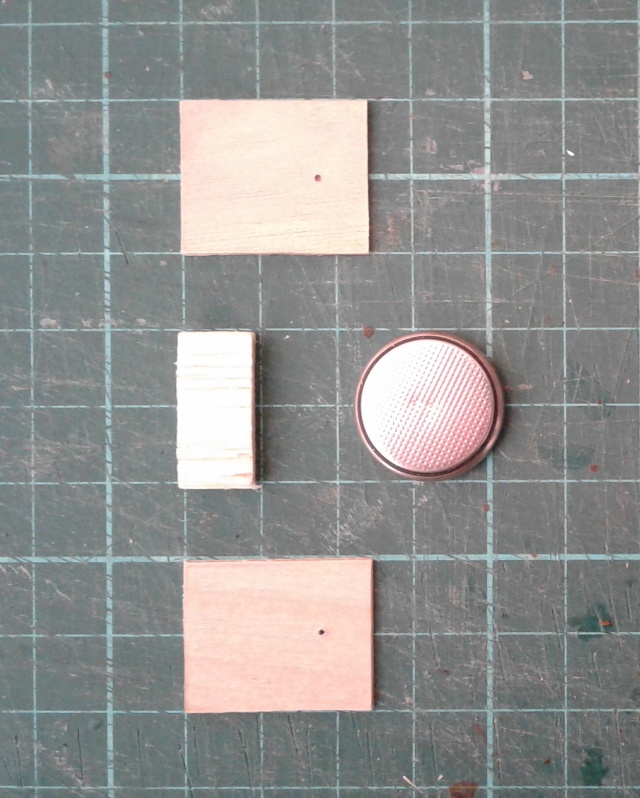

As said previously i need to sort out the lighting in the roof so that i can then get the compartment partitions to an acceptable height. So this is what i have been up to over the last few days.
Firstly get the items together for this part of the project. 3 battery tealights (3 for 1 pound from local pound shop) to give me 3 flickering orange leds, a button battery with 2 spare and a small sliding switch with 2 spare.
A small amount of wire for connecting the leds etc.
Small pieces of wood to make a thin battery box.
Thin brass (or copper) wire for making the connections in the battery box.
3 lamp globes (plastic tops from fruit shoot bottles).
Piece of thin ply cut to size for the internal roof panel.
The battery box is made of a small piece of balsa the thickness of the battery (3mm) and two larger pieces of thin ply for the sides. There is a small hole in each of the sides through which the thin brass wire is threaded to make contact with the sides of the battery. The three pieces of wood are then glued together allowing the battery to be slid in. I also wrapped a piece of masking tape around the box to help hold the battery in place. The battery can be replaced using a pair of pliers. A photo may help to explain all this.

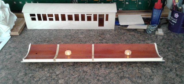

Re: NWNG Railways No.1
Have to agree with everyone else, that internal shot is as close as it gets.

Hi all. Latest update.
Partitions now cut to size, scribed boarding and stained with teak stain. The two centre partitions for the 1st class compartment are full height while the two outer ones that are positioned under the two outer lights are cut to allow the two compartments either side of the 1st class to each share a light. Now is time to make a start on the beading. I may do a few trial pieces because although i have put beading on some of my coaches before, never with curved corners (and almost every corner is an internal curve).
I'll keep you updated.
David.
David.

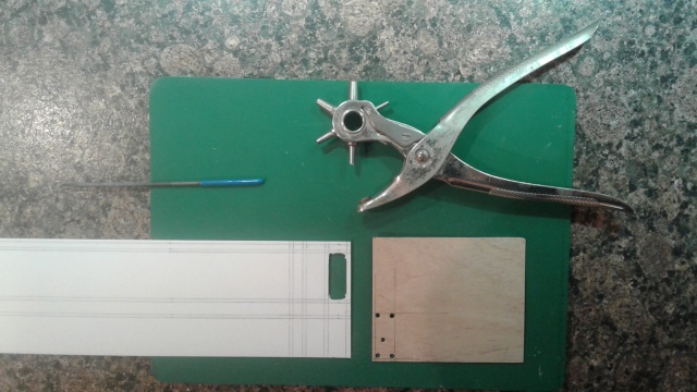

Hi all.
Not getting on so good this evening but i am sure i can work round it. The main problem is cutting rectangular holes with round corners in thin plastikard. I have tried punching a hole in each corner with a leather punch and with a hammer and punch and then cutting between these corner holes with a knife. The problem comes when i try to clean up the round hole with a small fine needle file. The p.card is too thin to allow the file to cut neatly and it vibrates a lot. The punch also stretches the p.card slightly downwards resulting in the piece not being perfectly flat.
So- I have now also tried using the thin ply i use for my coach building (0.8mm) and i seem to be getting on much better. The photo shows my trial results with the p.card and plywood before i stopped for the evening and made a coffee. Using the leather punch works better in the plywood and it is much easer to hold when filing the holes and gives a much neater hole. I will try cutting the straight lines tomorrow with a sharp knife but i think this will be the way to go. Hopefully more tomorrow. I might try drilling the holes with a fast running Dremel tool to achieve the neatest hole.
David
David

David, a suggestion but it's really off the wall. Have you tried chucking a wad punch in your drill stand setting it to a slow speed and keeping the plastic wet with water. I did use this once, but my material was probably thicker than you are using. It has to be a wad punch as they cut to the inside (leather punches cut to the outside, hence the stretch). Might be worth a try!
