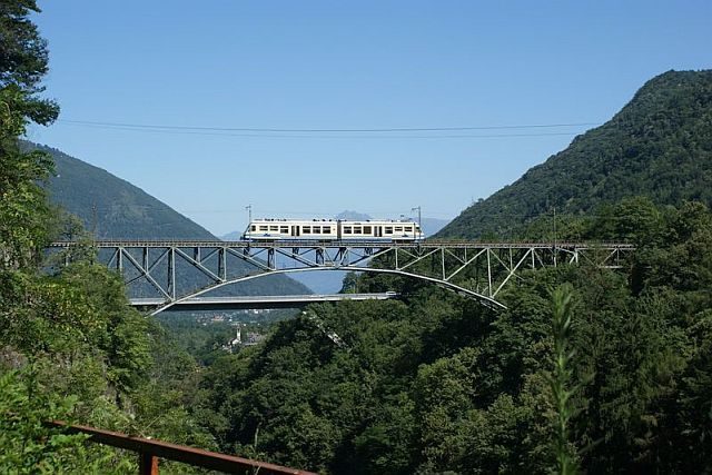

Looking great, Daan. The bridge sections look very prototypical. Always amazes me how strong spidery looking structures can be. To my mind, tower cranes should buckle the moment they attach those concrete counter weights and as for girder bridges! Those on the Centovalli in Switzerland should have fallen down years ago!
