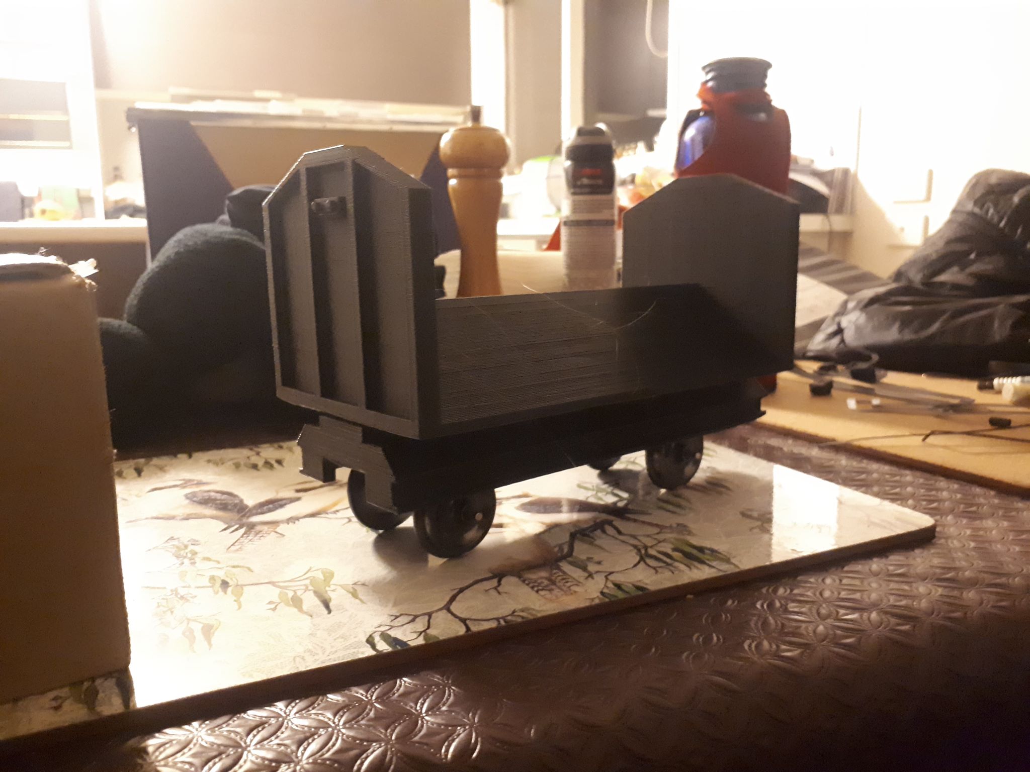

I've just run off a couple of sets of my own standard chassis design 3d prints, for some new wagons.

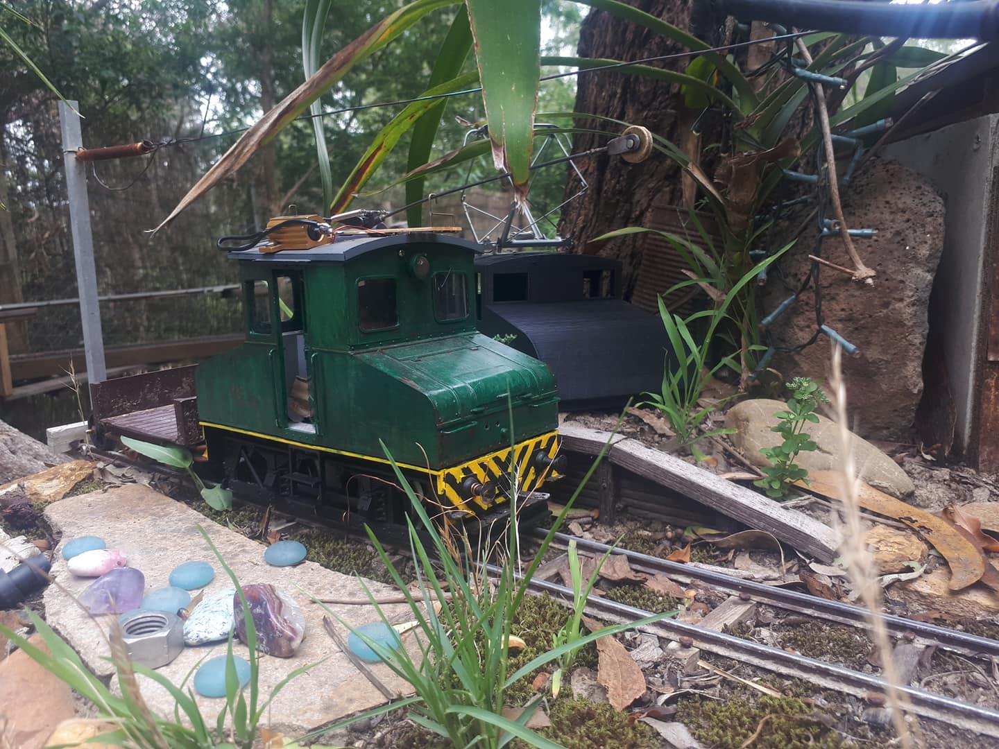

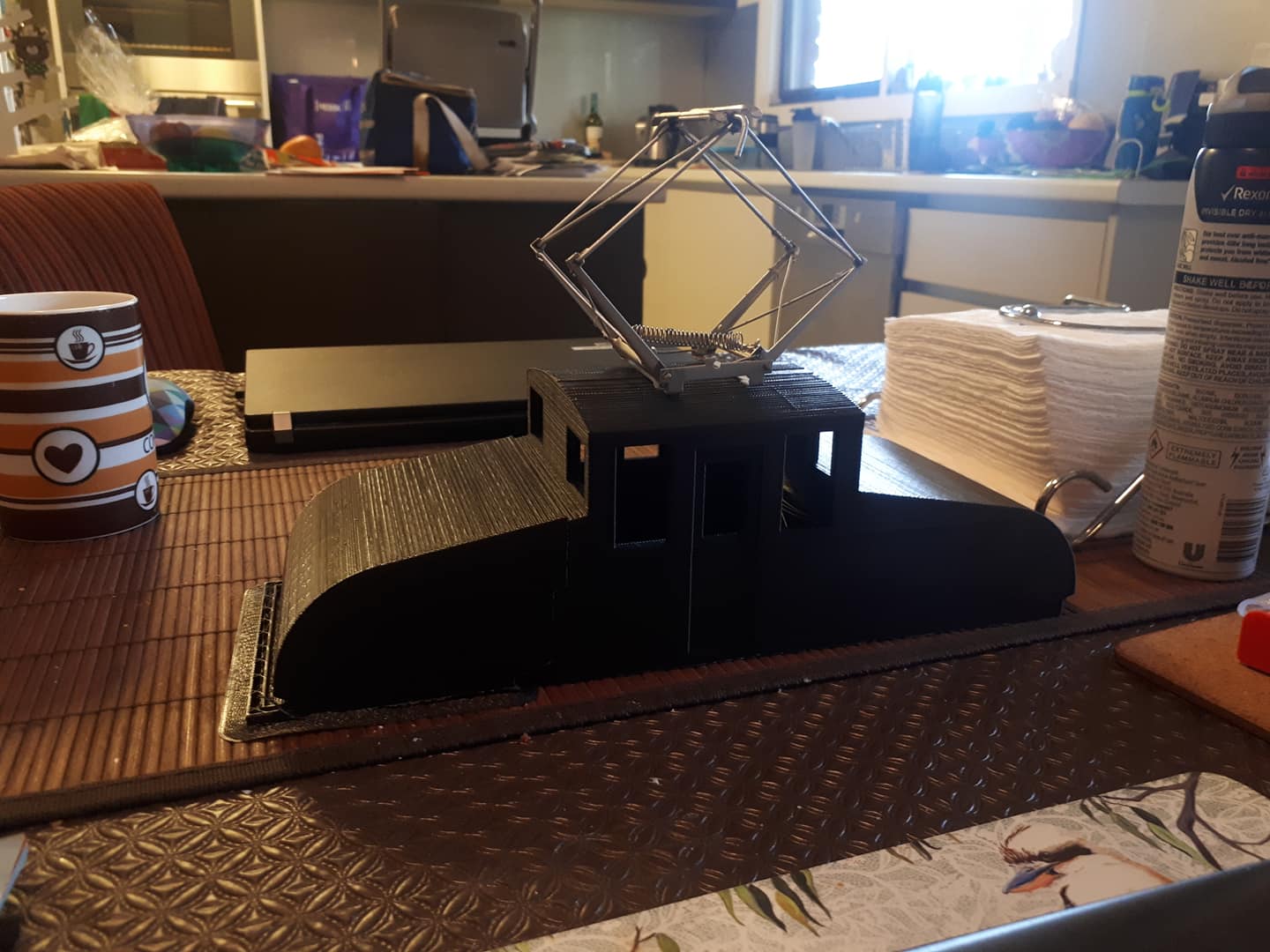

Hi all, I have a few different kind of wagons but the main type is a "near enough" copy of the wagons used at the Australian Portland cement railway in Geelong. The line boasted 3 Garratts (2 beyer peacocks and G33 one of the infamous "Australian Standard Garratts") along with a fleet of elderly Hudswell clarkes, 2 perrys and 2 extremely stocky Vulcan 0-6-0 Saddle tanks all on 3 foot 6 inch gauge. The pinnacle of motive power at Fyansford was D1 a 67 ton Clyde/EMD G8B model Diesel with dynamic brake which could manage 16 trucks on its own (4700 tons a day). It was sold to the VR when the railway closed and became T413 and still runs tourist trains to this day. I'm lucky enough to have seen most of these locomotives operate at the Bellarine railway in Geelong where I volunteer and so I'm rather fond, if you want to read more the Light railway research society have got some lovely articles online http://www.lrrsa.org.au/LR222_3-10.pdf
https://flic.kr/p/vuuJ2Q
https://flic.kr/p/4TP2ge

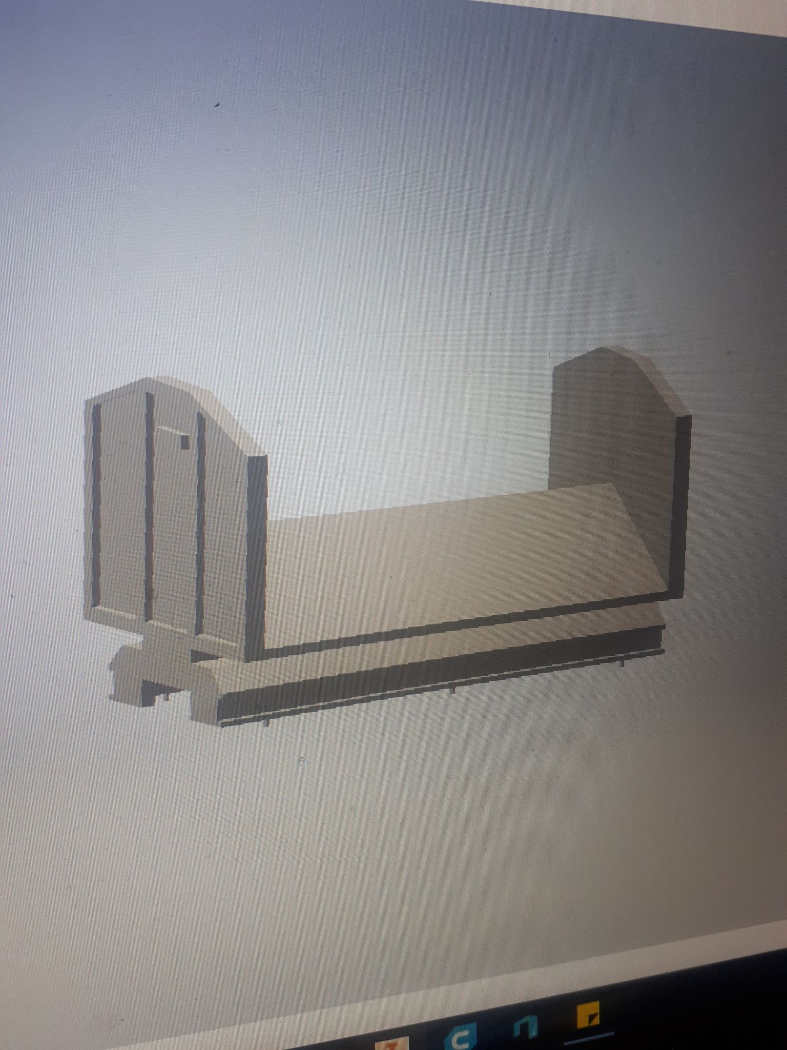

This is a bit of a preview, I need to make the axle boxes bigger and finish designing the doors before I start production printing. It also turned out to be quite large even in 1:24, which is fine as train lengths were extremely short on the prototype anyway because of the long 1:37 grade up through the tunnel from the quarry floor.

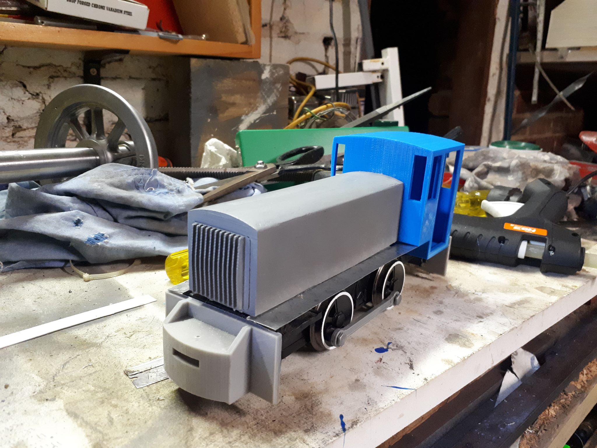

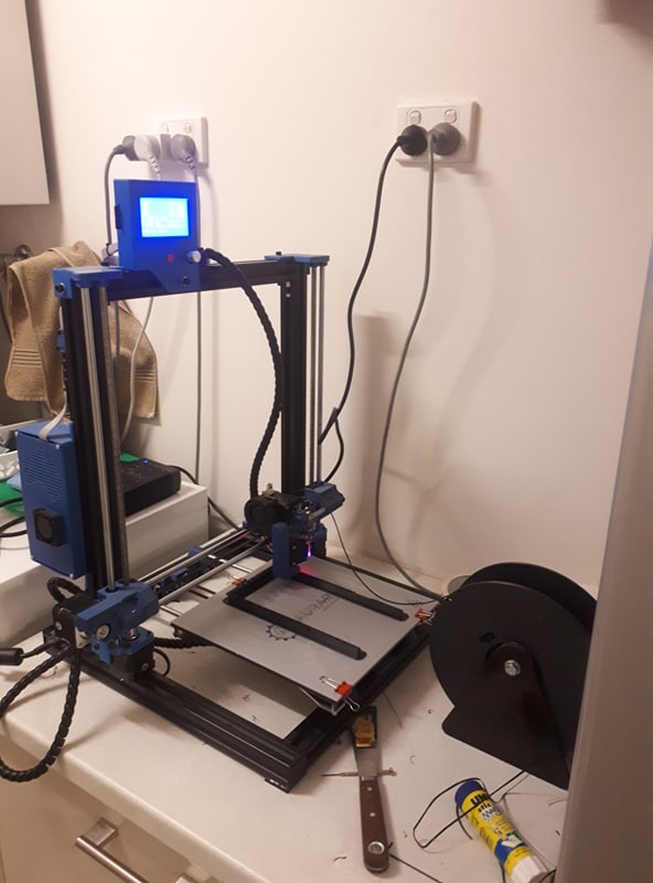

This is my wombot Drafter, print dimensions are 250x250x310, I actually have two of these machines but the other one is still being commissioned. I havent had a great experience with these to be quite honest and next time I'd much rather spend my money on an UP or Makerbot. Two samples of locomotives ive printed, the top one (a TGR V class) is fairly similar to a UK class 03 but with outside frames. Regards

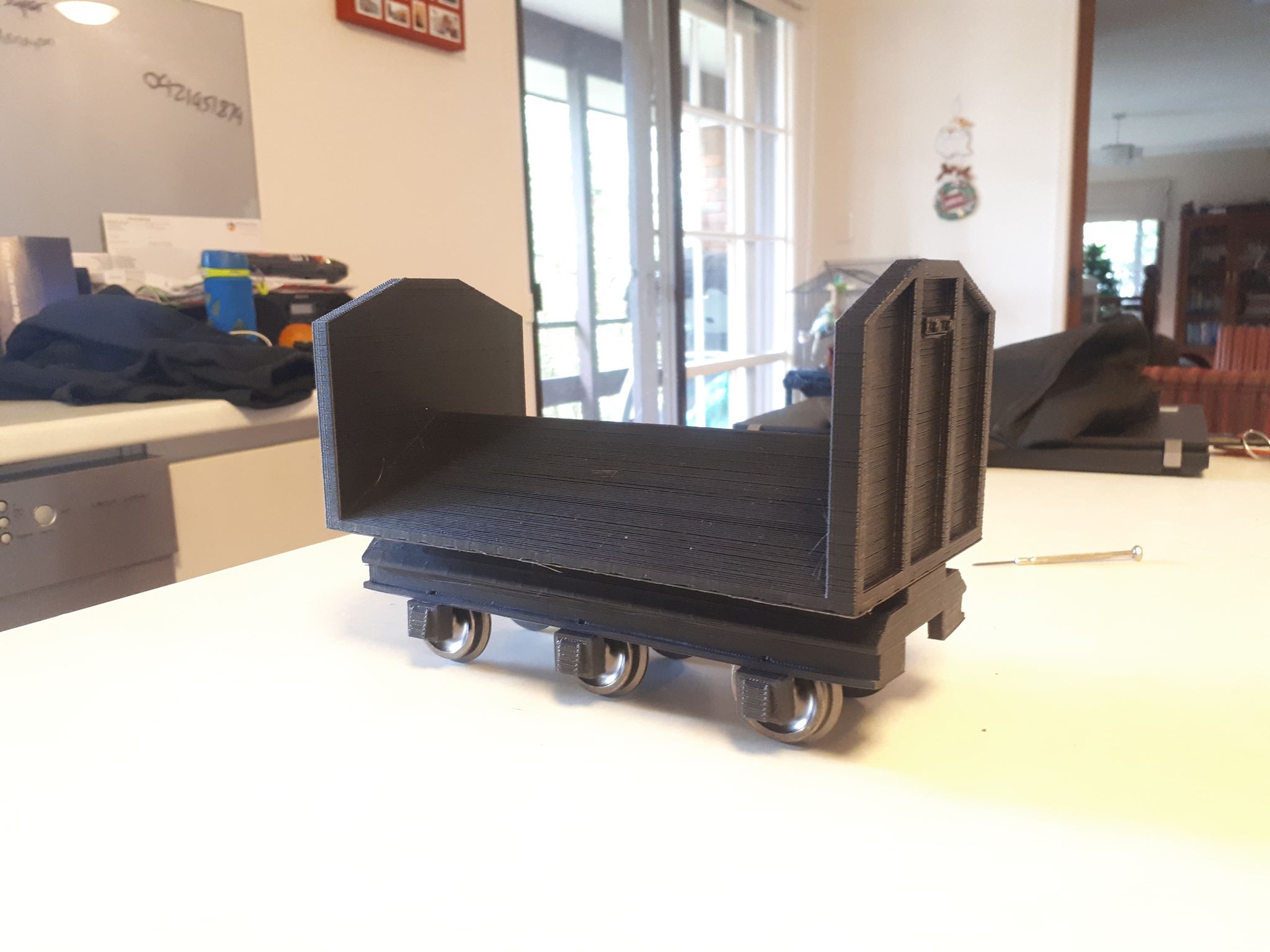

Actually, I'd love to know how you manage to get the surface so smooth on your prints, it's something I struggle with in a big way. Looking at the pictures of the hopper and the white loco body, they look almost perfect.

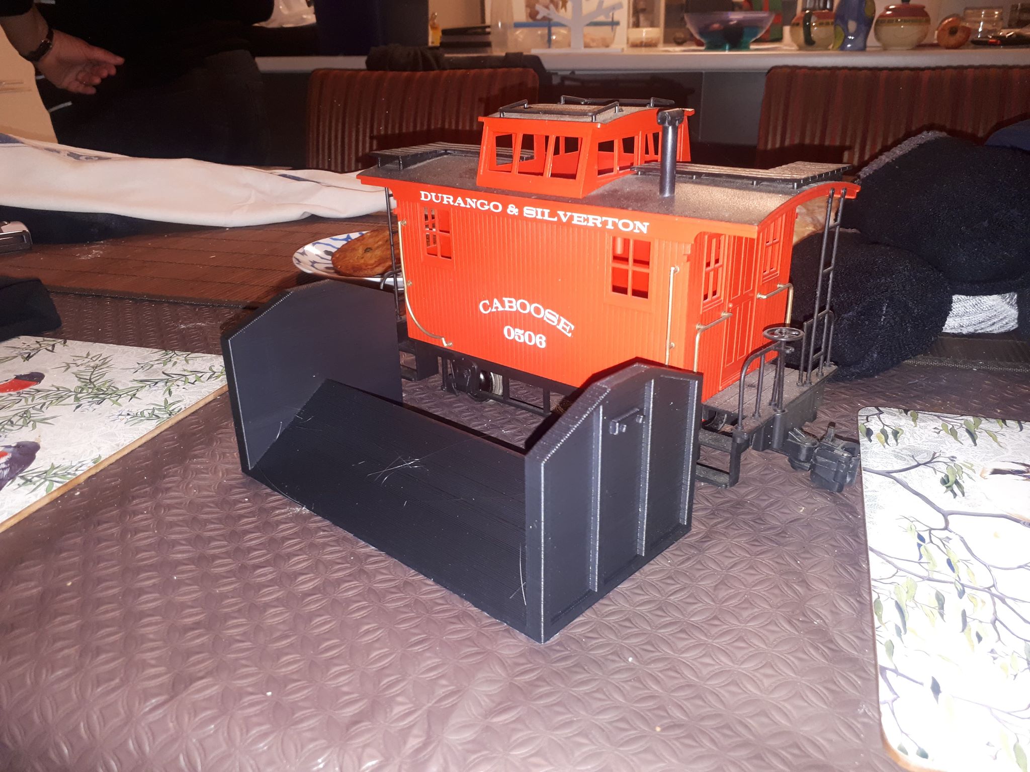

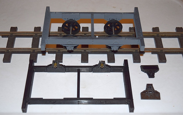

Anyway, here is a pic of my wagon underframe. Printed as the frame, plus 4 axlebox/spring assemblies separately, all the bolt heads and spreader plate are printed as part of the frame print. It wasn't until I put the first one together that I realised I had boobed by not making the buffer beam deeper, but that's easily corrected with some plasticard on these two, and a minor mod to the drawing for the future. The axle boxes on the primered version are only glued on one side, leaving the other loose so that I can remove the wheels until final assembly

Hi Phillip, no secrets here! the malcolm moore (4 wheel diesel) got a bit of car body filler on the top of the bonnet otherwise my trusted technique is about 6-10 coats of the cheapest primer I can find. My prints are usually printed at .2mm per layer for stuff like buffer beams, doors etc but lately I've been printing at .3 - .4mm layer height just to cut down on time due to the size of the prints (.1mm less per layer ends up being a 3 hour difference with one of the fyansford hoppers) its all about the application!

Hi Jake,Tropic Blunder wrote: Thu Dec 06, 2018 10:38 am Hi Phillip, no secrets here! the malcolm moore (4 wheel diesel) got a bit of car body filler on the top of the bonnet otherwise my trusted technique is about 6-10 coats of the cheapest primer I can find. My prints are usually printed at .2mm per layer for stuff like buffer beams, doors etc but lately I've been printing at .3 - .4mm layer height just to cut down on time due to the size of the prints (.1mm less per layer ends up being a 3 hour difference with one of the fyansford hoppers) its all about the application!
Your underframe looks fantastic! I love all the bolt and strap detail you've put into it which is something I really need to work on for my own models. What wheels are you using?
I tend to print at 0.18mm layers for pretty much everything. I know it takes longer but needs much less fettling afterwards. It's also the solution to the fine detail which you commented on - the curved strapping plates and the bolt heads are simply sticking out from the side of the frames by 1mm and at 0.18 the printer copes quite happily with a quick sideways flick as it goes past that point, no need for support. The thing to bare in mind though, is that the more surface detail you add, the harder it is to smooth the surrounding surface, especially if you are going to blast it with half a dozen layers of primer!
Part of the time problem can be solved with lower infill density, I usually set it at 20%, although on very small/ thin parts its more or less 100% anyway by the time its printed the top and bottom layers and both side walls! However 20%, or even 15%, does make a big time difference on larger items, saves on filament too!
The wheels are Swift16 with 3mm axles cut from silver steel rod from ebay.

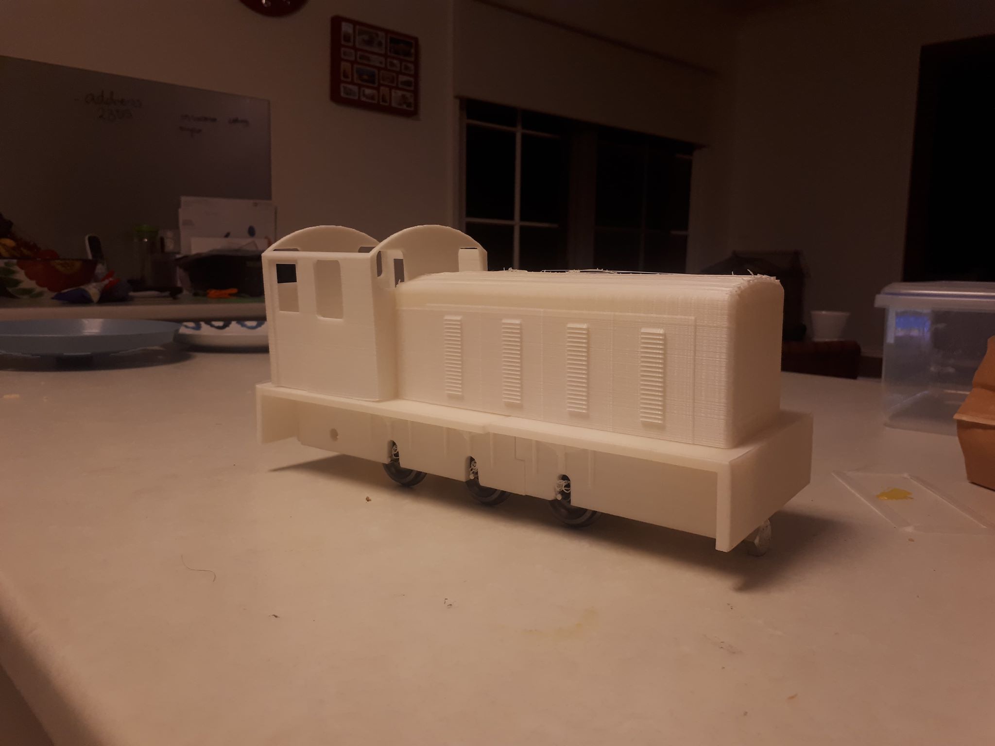

I modified the axleboxes and the underframe and this week the first Fyansford hopper broke cover. Unfortunately I've just discovered how they tipped and so its back to the drawing board for a redesign
On its first test run hauled by D1, no problems were observed so it'll return back to the workshop for fitment of doors and a paintjob ready to be accepted into traffic.

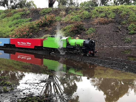

In the meantime heres some photos from my local miniature railway. We had our last runday of the year today and in typical Melbourne fashion it absolutely bucketed (despite it being summer!) The track isnt normally surrounded by water btw thats just how bad the rain was!
