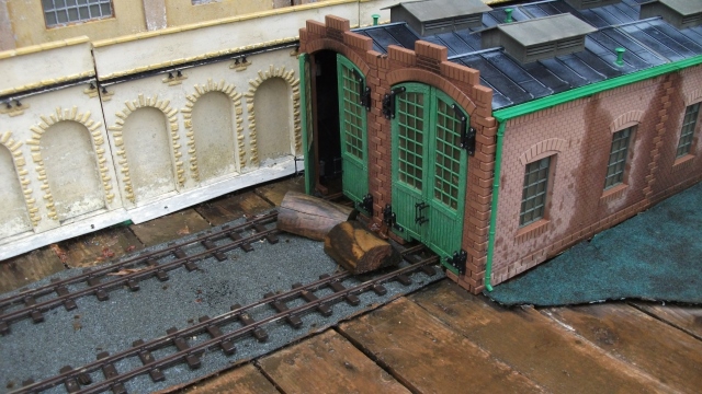

I do like the weathering on the door. Just where everyone's overalls would create scuffing and dirt upon entering. It's the little things that count.

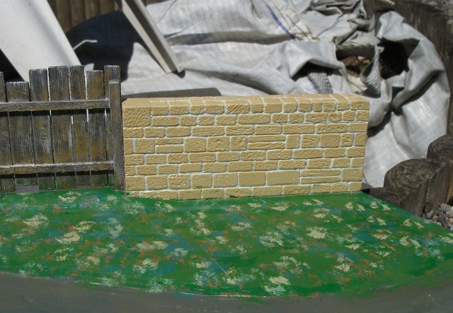

Yes Rik, and playing around with the different inserts can give you a few different finishes.
Don't start with a whole building, just do a bit of a wall to get the feel of the stuff, as here,
JOhn
JOhn
- Posts: 7788
Re: Recent Stuff on the FBGR
Excellent. Really impressed (sorry about the pun) with the worked-stone finishes you've achieved on that wall - I'm really fired-up to have a go myself.

I know this post covers how you do it (mainly on page 1 folks ) BUT the next time you are doing a wall or something, could you take a few photos as you go, starting with the board unmarked, showing a pic of you scoring the mortar courses marking the sone etc - then your painting technique - will help me and i guess others so much - my brain needs to see pics to help do something new

Yes markoteal, I could do that, and it would probably be best as a separate topic – next time I start something mainly foamboard perhaps, although the story of me filling up my scrap-bin until I have enough pieces that happen to fit together, and then slowly spilling paint over it may not suit everybody.
