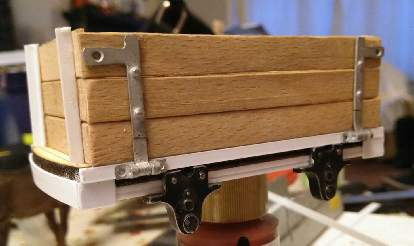

It looks nice, but gee, rather you than me.....Andrew wrote: Fri Nov 29, 2019 10:35 am And so, to celebrate Black Friday, here's a grainy photo of the latest progress on my brine tank wagon, taken this morning before I left for work, when the sun still hadn't risen properly:
You've done a good job of applying those things close together, and in a straight line no less. I tried something similar once in HO, but with three ersatz rivets disappearing into the carpet for every one that made it to the model, I admitted defeat and bought a rivet press. Not long after that Archer Transfers released their first rivet decal sheets, didn't they.....

Thanks! It occurred to me as I was sticking on all those gems that this wagon's the perfect candidate for 3D printing!JMORG wrote: Sat Nov 30, 2019 8:27 am Brine tank looks good! I made a 3D printed brine tank a while back, need to dig it out and finish it!

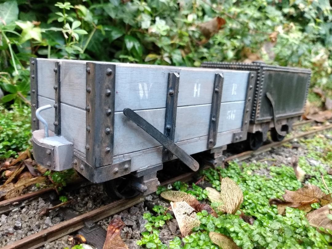

I've also been busy on the wagon front, out-shopping these two today - the Ffestiniog brine tank and the second small WHR open:
I've been out tidying up the garden a little - these two might just get a test run tomorrow...

This all looks terrific. The weathering (and the rivets) are completely convincing. Seduced by all of it, I went and bought a load of Nail Art stuff, so I could plaster rivet heads over everything. But itβs a nightmare! I canβt imagine how you all manage to organise and glue the damn things into neat, equally spaced rows. I canβt even pick βem up...
Re: (WH)WHR Rolling Stock
Glad you like 'em, thanks!BertieB wrote: Sat Jan 04, 2020 4:56 pm This all looks terrific. The weathering (and the rivets) are completely convincing. Seduced by all of it, I went and bought a load of Nail Art stuff, so I could plaster rivet heads over everything. But itβs a nightmare! I canβt imagine how you all manage to organise and glue the damn things into neat, equally spaced rows. I canβt even pick βem up...
For the wagon strapping etc I make little jigs to get the gems in the right place - usually just holes drilled in offcuts of thin ply. I use a pen to mark the part (a fine permanent marker if I can find one), then apply plastic cement, then add the gem with the tip of a knife blade. The tank was more of a challenge (!) but I discovered that the gems can be placed in more-or-less the right places then pushed into a straight line with the edge of a ruler while the glue sets. If you can't use then in your modelling you'll just have to stick 'em to your nails as intended...
